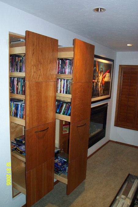

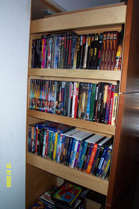

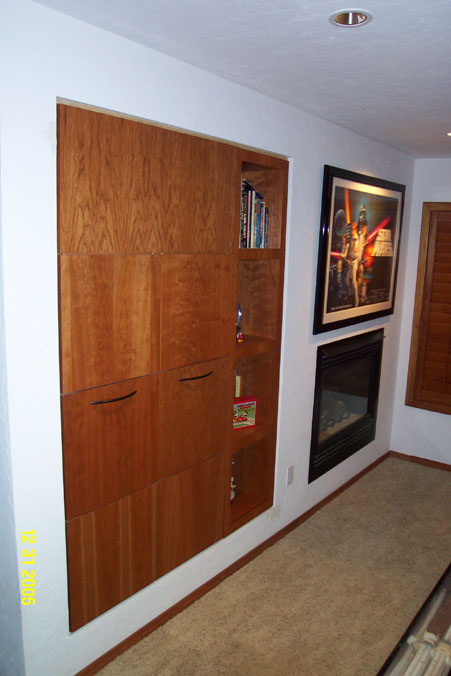

                  Pull-Out Media Cabinets
                  I designed these media pull-outs in Corel and had a local cabinetmaker build 'em, back in '98. Wood is cherry. Top half holds DVDs, front and back. Lower half holds LDs, but proved too heavy after a few years of the ol' "in out, in out" and broke the lower shelf pins. Not that it matters; we need more DVD storage now anyways. When I find some free time, I'll retool 'em for all-DVD storage, top-to-bottom, front-to-back.

                    Nice Dave! I like that. :T
                    The only drawback to that arrangement is finding a deep enough cavity to recess the shelving into.

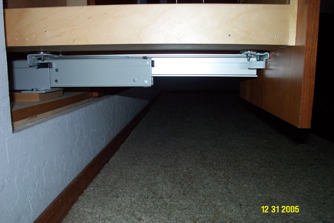

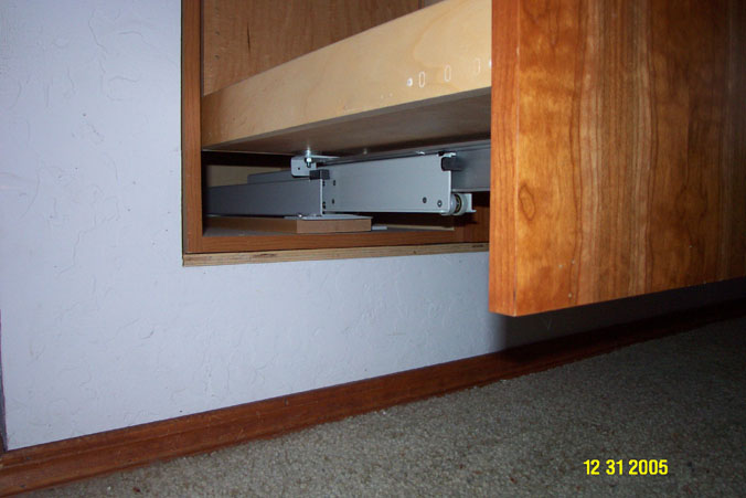

                      ...and Clearance
                      Yes, and also the clearance of the cabinets from the wall. The initial design incorporated standard sliders and didn't clear the wall, leaving 1/4 of the discs awkward to reach. But then, the weight of the LDs immediately broke those sliders anyways. [Don't you just love DIY projects?] We ultimately swapped out the more typical sliders for some heavy-duty German sliders recommended by the cabinetmaker. They're terrific, even if they still don't clear the wall by an inch or so. See pics. Cabinet is fully open in all shots.
