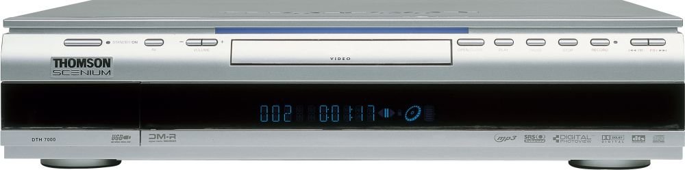

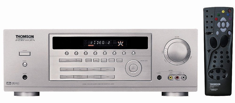

    The setup I have at the moment is:
    Thomson Scenium DPL 2000 (5.1) AV Amp with the Thomson DTH 7000E DVD HD Recorder. I have a Sky Box plugged into it for satallite programmes. I have at present B & W 703's as the front pair & I'm working on getting B & W 705's as the rear with the HTM7 as the centre. The sub I'm going for is the ASW750 (Yep, B & W). I have a 36" TV.

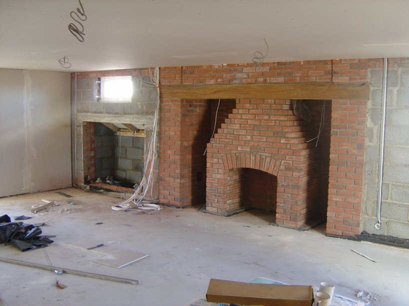

    The "Home Theatre" room it's in is 26ft by 20ft, with the front speakers central on either side of a 12 foot fireplace (Well, it will be once I put the wooden floor in-new build). All the AV stuff & the rest of the electrics will be in an alcove to the left of the fireplace (See pic). I have hard wired the rooms for speaker connections, each connection allowing for biwiring.
