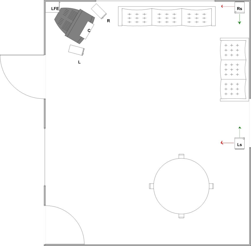

          See attchd, I would mount the RS speakers on the side wall 2-3 feet above the ear level and for LS I do not have a side wall and will use the back wall mount to direct it towards the RS spk.I do not have space on the back of the sofa.
          My only question is that should I be facing the direct radiating speakers towards the people( in green)/eachother or towards the TV (red). Would a better ambient surround sound be created if I face them towards the TV.

            Saurabh, direct radiators should point at the listening position. Di-poles and bi-poles point away from it.
