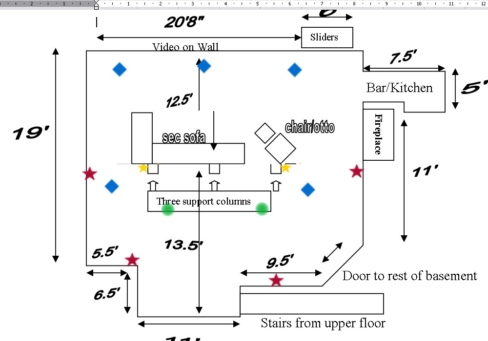

                                                      No i tried to copy specs of my space from Word..did not work and i guess did not come through. still going ahead as mentioned above..found a place that carries all of my options and will visit on Friday.
                                                      • cvinci
                                                        • 23
                                                        Lost in the Woods Contd
                                                        Here is my basement specs.

                                                          Went to a very good shop yesterday that carries B&W and Vandersteen. Listened to all series 1C, 2Ce and 704, 804...For my budget the best overall in terms of value and my listening preference were the 2Ce..Fantastic midrange and clear open surrounding sounds..Also listened to some $20,000 B&Ws and all i can say is WOW....Ok here is the latest lineup;
                                                          Pioneer Elite 1120HD(checked projection out etc but only hold one vote in house and other half vetoed do to darkness requirement etc)
                                                          Rotel RSP-1068, RMB-1075, RB-1080(RB-1070)
                                                          Denon 3910
                                                          SVS PC Ultra
                                                          Vandersteen 2Ce, Vcc1, Sides VSM1, Rear Ceiling B&W CCM65
                                                          APC Line R Power
                                                          Pronto Remote
                                                          Feedback appreciated on selections etc. I enclosed basement diagram above and only thing I am concerned about is surround sides..shop suggested wall on right and left but concerned about distance of right..it is very far from listening area.

                                                                Those columns sure are in the way aren't they! If you can I'd move the seating slightly to the right if you can as long as it doesn't throw you to far off the screen. I've edited your diagram showing where I'd put the furniture (more centered with the columns/room) as well as the general locations where I'd likely put the speakers. The blue squares are where I'd put the 5 main speakers if they were all freestanding. The red stars are where I'd likely wall-mount the 4 rear speakers, the yellow stars are where some di/bi-pole speakers might work mounted to the columns though I think it's likely to close to the listening area. I also prefer direct radiators in that position mostly for music but also for movies. The green dots are where I'd ceiling mount the back surrounds if you go with in ceiling speakers for them.
                                                                As far as your display if you can't go with a projector is there any real reason you need to go plasma? RPTV's (especially CRT based sets) generally perform better for much less money (again, especially CRT based sets). Is the extra 1'-1.5' you'll save really worth a drop in performance and a huge increase in price?
                                                                I also wouldn't mix the Vand's and B&W's. Buy all one brand and preferably one line of speakers for a more cohesive sound and similar voicing.
                                                                Other than that, it's an impressive list of toys! :T

                                                                    Aud&Shane, thanks so much for your thoughts. Here are my issues and hopefully you can steer me some more given your expertise;
                                                                    I experimented many times with location of furniture but we want to keep the area away from fireplace and bar area so as to not take up the whole room. Reason being that want flow to be good so as to come down stairs make right and be able to progress infront of fireplace into bar area and then out to sitting area. We thought about putting furniture on right side in between second and third column but decided not to because wanted to keep view of fireplace open and permit flow into and out of bar area. I want to stay away from 4 towers as i see it to be too much for room and the right side becomes a problem as it would be in middle of space between column and wall leading to fireplace and bar area. Four walls would work as you showed but the vandys are pretty big and seems a lot against 4 walls. Hence my vision of them on sides and B&Ws on ceilings for rear. Also I am very concerned about the right wall speaker being very far from listening area. Will calibrating solve the problem? Do you know of any ceilings that would compliment the Vandys better than the B&Ws? When you say same lines you mean not a good idea to use towers with walls and ceilings or three way front with two way rears?
                                                                    Concerning the Plasma vs Projection vs RPTV. I have a high probability of getting the plasma at an incredible price. I looked at projections last week at a few stores and found the prices to be twice what i would hopefully being paying for the plasma. I did not view the Sanyo Z3 as recommended above but all the rest were in the 6k-10k range and getting a premium screen seems to be costly.RPTV is an option but as i said the price would be about the same for me. Look forward to your feedback..thxs as always
                                                                          I have an odd room(no basement) like this and It seems to work. I am calibrated
