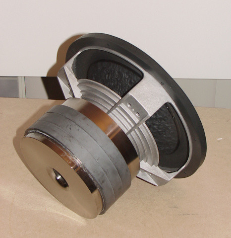

      Now, built to order is available in several performance levels. The biggest difference is that to extend the excursion and output capability, you must have a longer voice coil, which means at any one time, more of the voice coil is out of the gap. There's a bit more to it than just that, of course, or you wouldn't see drivers built like this:
      But getting that extra 3-6 dB of performance does exact a cost penalty in efficiency and construction, if you want to do it with a single driver.
      Even the highly regarded Blueprint 1503/1203 series is not as linear (I have some of them, and they're excellent drivers).
      OTOH, if you have the lucre, other products you could look at include the Areal SW 12, and the Paradigm Servo15. Products like the Servo 15 perform very well, and use motional feedback to overcome driver linearity and enclosure size issues. But, this performance comes at a price. Rel also has a very good reputation, though more music than ultimate HT oriented- focus is more on the above 25 Hz performance. Not inexpensive, either.
