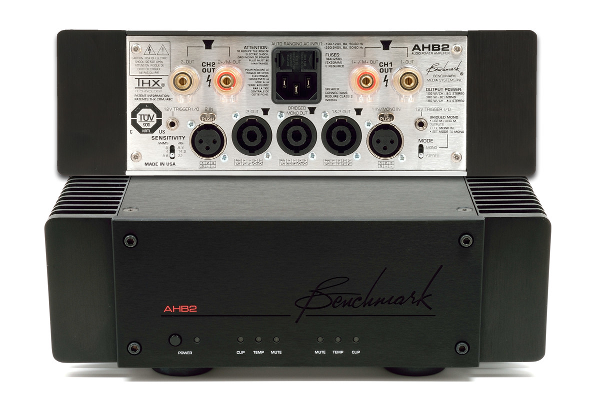

    The Benchmark AHB2 is a nicely proportioned little amp that seeing just a picture of the front may not tip you off to how diminutive it is... but seeing how those XLR and SpeakOn connectors fill the rear panel, you realize this is pretty itty bitty for an analog power amplifier (to be fair, it does use a very sophisticated resonant switching power supply, though).

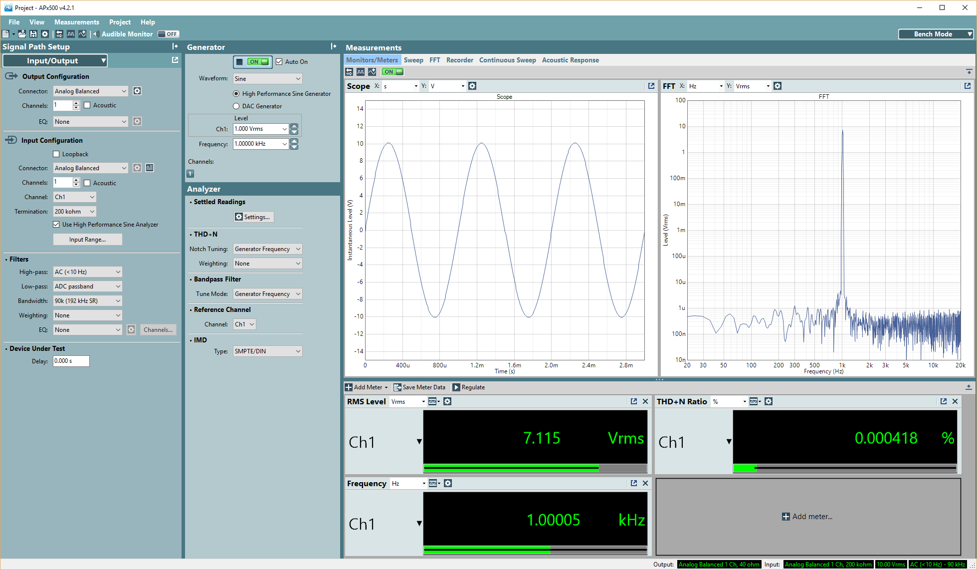

    No, you didn't misread that; at 6 watts output power, the THD+N (Total Harmonic Distortion + Noise) is just 0.00042%. Just think about how quiet the front end on this has to be to reach that level of performance... and about how your preamp does or doesn't match up to that!
    So, is this a "First Watt" design? optimized just for low Power? Let's take a look. (Keep in mind I DIDN'T use the Pro level input setting, which requires even more front end drive, and improves the SN ratio further- this middle ground setting will work fine with most good stereo preamps, say, units comfortable driving up to 4 or 5VRMS out). So don't expect to see as low numbers as JA published. This is a little more real world... :W

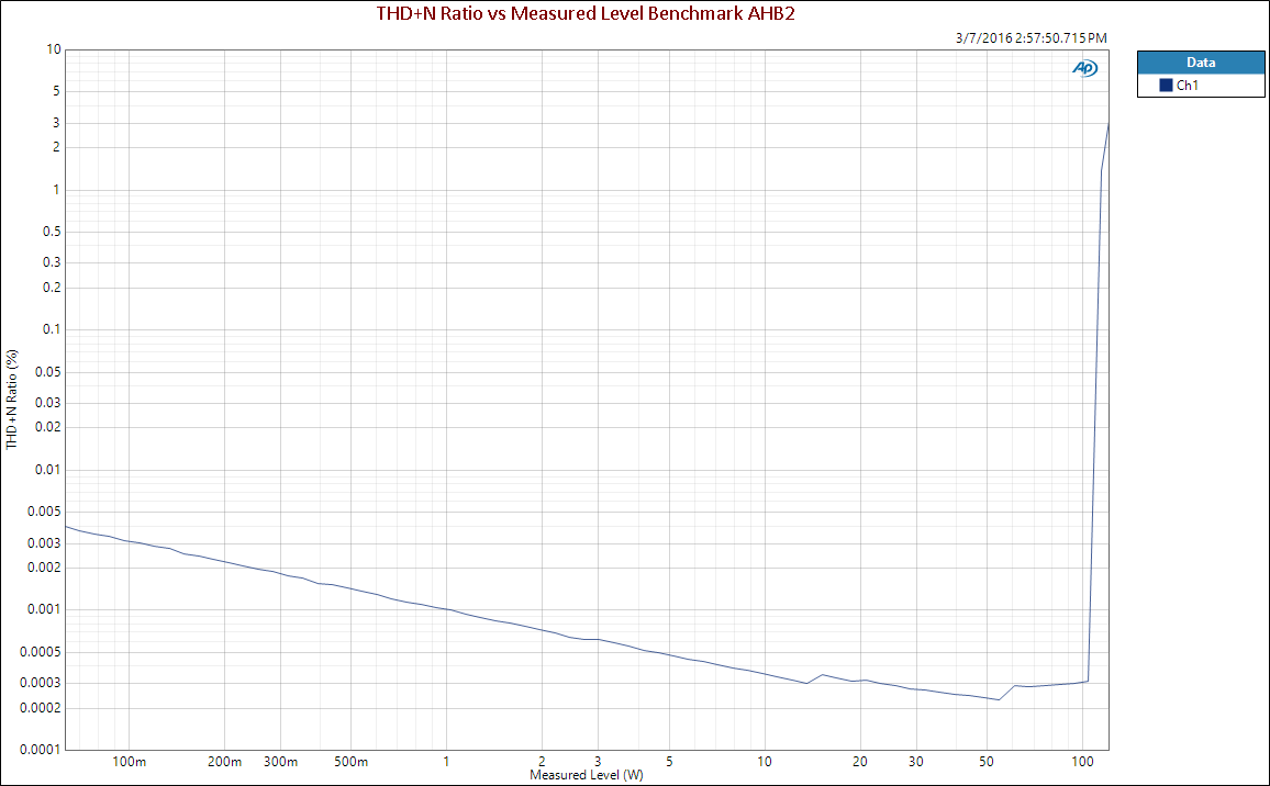

    One of the things one ought to do to appreciate this amp is compare what it's THD+N figures look like at 100mW compared to may other "high end" amps out there- here, we're coming in at 0.003%, and I've seen many amps for 10X the money coming in at 0.02 to 0.07% at 100mW. For a speaker that's 90 dB efficient, 100mW is a conversational playback level.
    By 1W we're down to 0.001% THD+N, and 20W we've reached 0.0003%! Yes, three zeros in front of that 3!

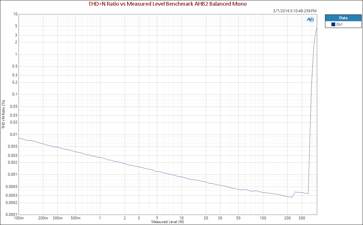

    OK, that's impressive, but what about that bridged mono mode? Benchmark supports in directly with a separate SpeakOn output connector, and using the balanced inputs and stereo-mono switch. Move the SpeakOn output connector (you did get some of the Benchmark Speaker cables, didn't you?) flip a switch, and voila, a miniature bridged mono block amp.
    Click image for larger version  Name:	25304297340_edacc3396b_o.png Views:	5 Size:	34.2 KB ID:	958293
    Now we're seeing a bit past 350W at the clipping point- because the two channels are being added in series, the noise floor is doubled, but we're still looking at less than 0.001% at 10W output.
    Let's widen the frequency range of investigation- but keep in in bridged mono. It's a very competitive $2995 mono block, given the overall performance.

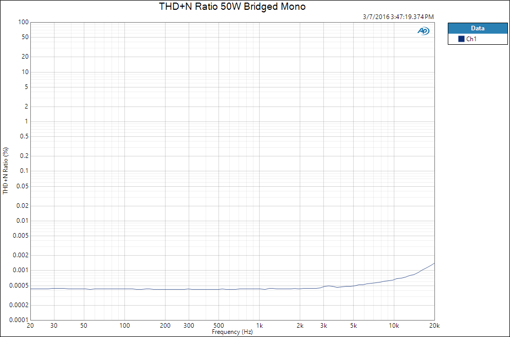

    Next up some frequency sweeps at different power levels.
    First, at 50W RMS.
    Click image for larger version  Name:	24969414214_13a5a4c7af_o.png Views:	5 Size:	23.9 KB ID:	958294
    Just under 0.0005% up to 5 kHz, rising smoothly to about 0.0015% at 20 kHz.

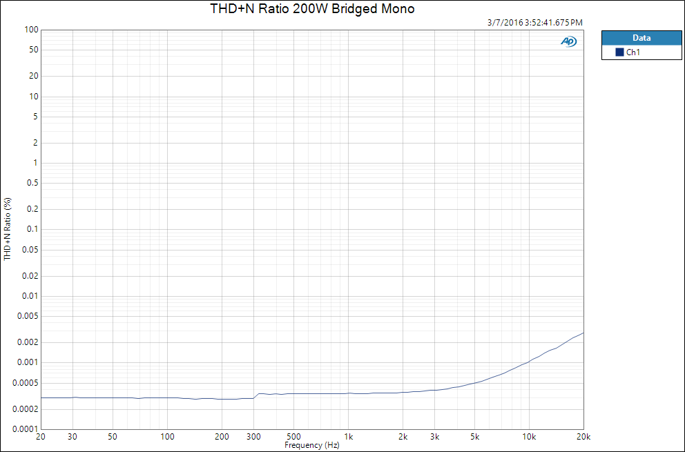

    Let's push it harder- 200W now.
    Click image for larger version  Name:	25507204281_fa5e3938ce_o.png Views:	5 Size:	24.6 KB ID:	958295
    Now we're seeing the effect of the noise floor dropping further, with lower THD +N below 3 kHz, but perhaps at this higher output level and higher frequency range, the feedforward error correction can't quite work as well, and the distortion is rising to a peak level of 0.003% at 20 kHz. Tsk, tsk. :W

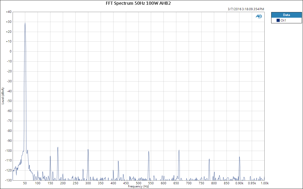

    I personally like FFT's more than summed distortion measurements like this- the latter show the large trends, the former the nitty gritty detail. Let's try some low and high frequency examples.
    First, 50Hz at 100W output in bridged mode. This is interesting because it can reveal both signal related harmonic distortion and power supply related noise, with harmonics related to the line frequency. Keeping in mind the output signal is at +30 db rA, 2nd harmonic is essentially none-existent, and 3rd harmonic at 150Hz is -135dB from the signal output level. There are some power line related spuriae; at 180Hz, 300Hz, 420Hz, etc, but generally not above -130 dB relative to the 100W output.
    Click image for larger version  Name:	25573786596_a145b9df4a_o.png Views:	5 Size:	34.2 KB ID:	958296

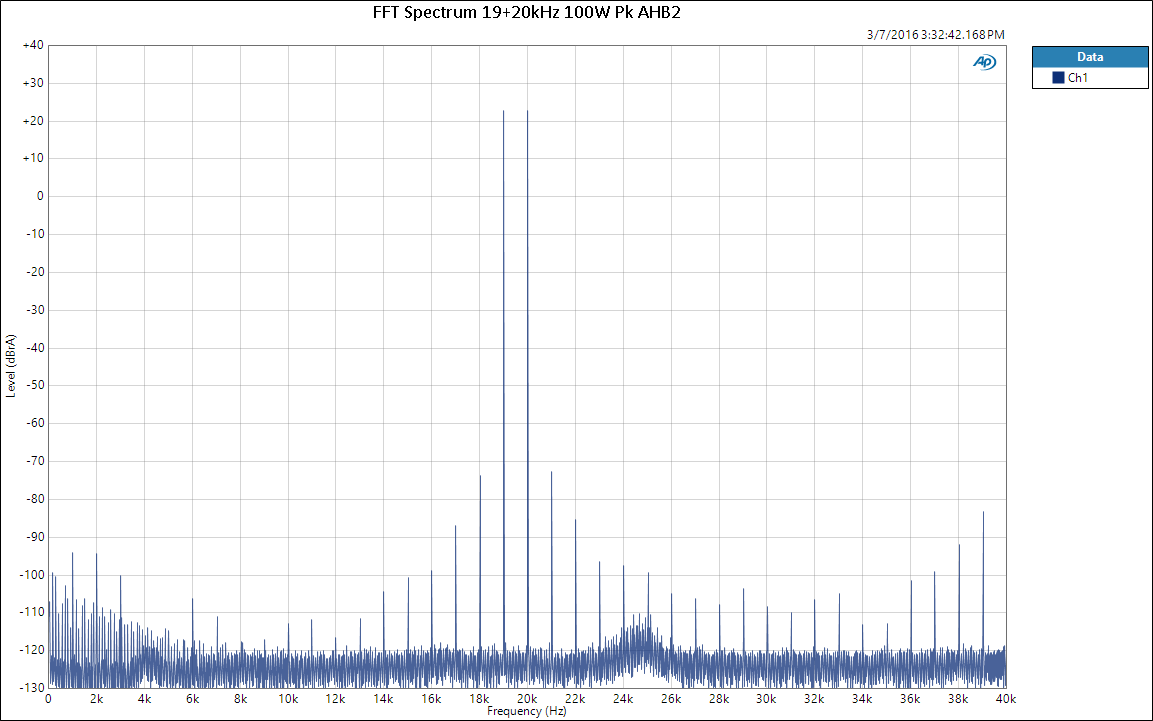

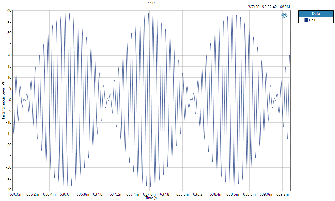

    Considering the rise in high frequency distortion, an obvious avenue of investigation is two tone CCIF Intermodulation distortion, with 19 + 20 kHz. They're mixed at equal levels, and setup to reach a peak output of 40V, equivalent to the peak level for 100W RMS output. Needless to say, this would be very quick death to almost any tweeter, but it's a good stress test for HF distortion, both harmonic and intermodulation.
    Here is what the test signal looks like:
    Click image for larger version  Name:	25599893445_243d6a50a7_o.png Views:	5 Size:	71.7 KB ID:	958297
    And this is an FFT of the results, plotted from DC to 40kHz. Ideally there would only be the two spikes reading out at 19kHz and 20kHz, but we can see a variety of side band components at 1 kHz intervals, both around the test signal, and at an image at the 2nd harmonic of the test signal. There are also difference tones present at 1 and 2 kHz.
    Click image for larger version  Name:	25599891625_95f2fd42f2_o.png Views:	5 Size:	43.0 KB ID:	958298
    Let's keep in mind that most of these are below the -100dB point, which means they are 122.5db below the actual signal! The worst case components, at 18 and 21 kHz, are about -95 dB relative to the actual signal peaks. This calculates to a percentage basis of 0.0017%. This is a very low number compared with most power amplifiers.

                                                You know, sometimes you know right away good things are happening. In this case, there is no mystery... I've seen the other reviews... I've seen John Atkinson's measurements on Stereophile...
                                                Click image for larger version  Name:	25600407555_c96026eea3_o.jpg Views:	4 Size:	184.7 KB ID:	958290
                                                And I've listened to these for hours and hours since just before Thanksgiving, last November. But nonetheless, when I finished connecting one of these to the AP, set the gain control switch to the mid point (adjustable between true Pro levels, a compromise level, and consumer input level- I went for the middle ground) and fired it up, and default it's showing a moderate level output signal (7VRMS with 1VRMS input), reading out the levels and THD+N, with a default FFT window, and right away, you know there's something special here... something one might have not believed could exist commercially for under $10K or $20K, much less for $3K.
                                                I took delivery of my AHB2, along with the DAC2 HGC, last November and have been totally pleased with the pairing. Encouraging to see my choice measures so well. I have just the one AHB2 and it's coupled to the DAC2 with balanced interconnects. I have the gain of the AHB2 and the outplut level of the DAC2 set where Benchmark recommends. Sounds just fine. The single AHB2 is more than enough power for my realtively efficient Spendor D7 loudspeakers. I have seen the power amp's clipping indicators wink only the once. And that was because I was trying to do so. I couldn't ever play music at that volume. It's neither musical nor bearable at that level.

                                                  You're welcome Derek.
                                                  I've brought this pair to Munich, and they do quite well driving a set of Egglston Works Savoy Signatures here; it's actually humorous to see the AHB2's sitting in front of some big Halcro's; even more humorous hearing how good they sound compared to the Halcro's, which are no slouches. Will post pictures after I get back- I'm in Munich until the end of the week.
