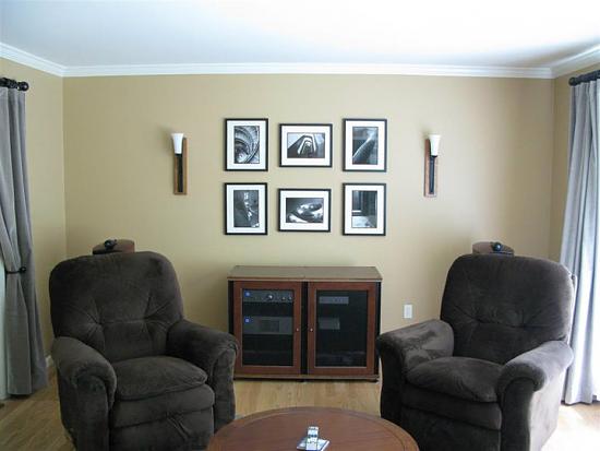

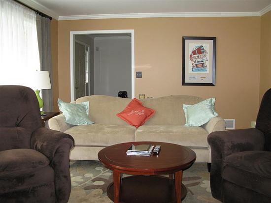

            The room has hardwood and a window that is 14 feet wide!!! The rooms adjacent have hardwood and tile. But I’ve done as much as possible to soften the room. I’ve added an area rug and thick velvet-like curtains over the huge window.
            The room has dual-purpose:
            1) Living room & entertaining area
            2) Listening to music
            In this picture the room is setup as a living room.

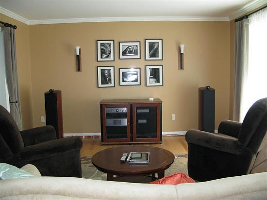

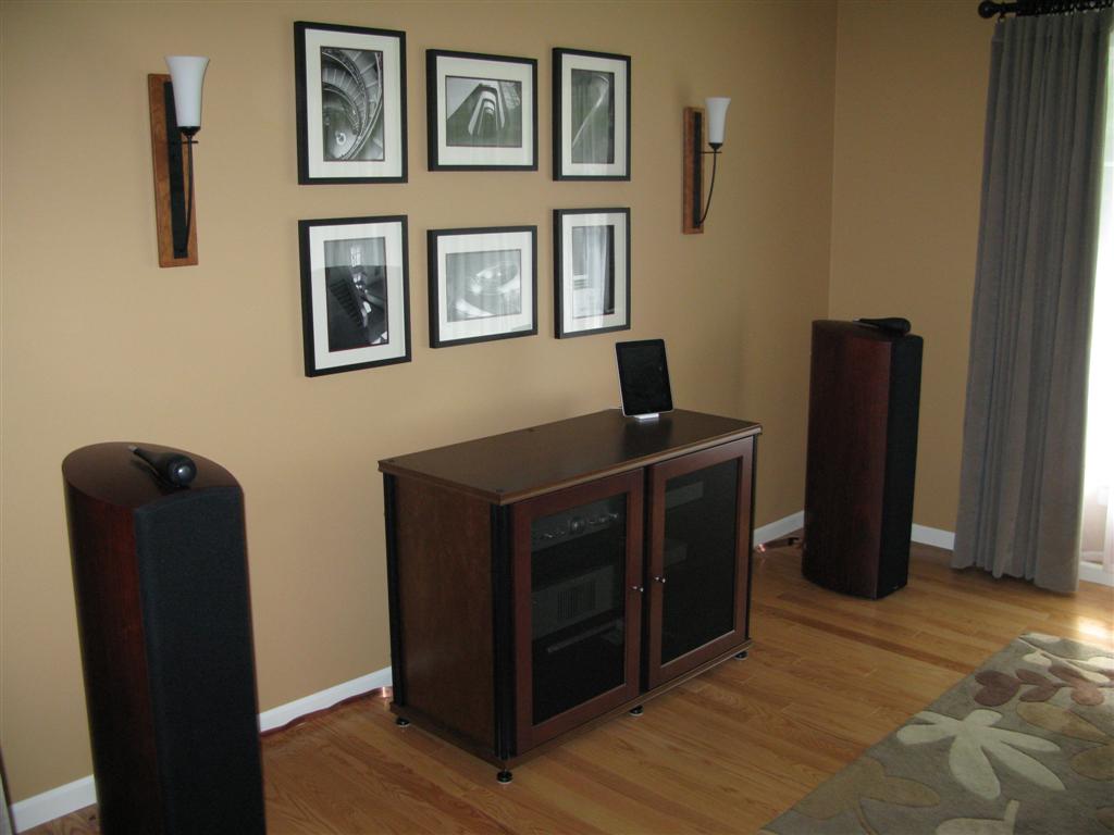

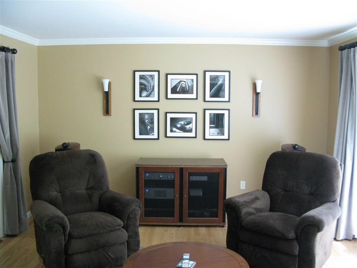

            The chairs can move and swivel and it’s setup as a listening room
Name:	IMG_2994 (Large).JPG

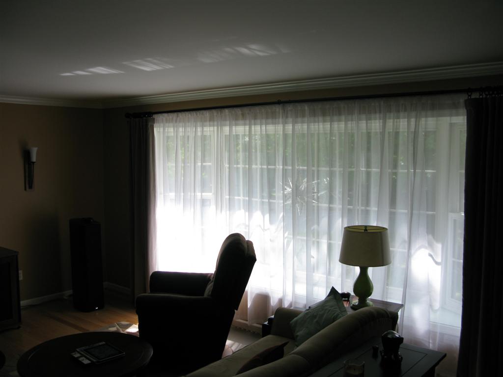

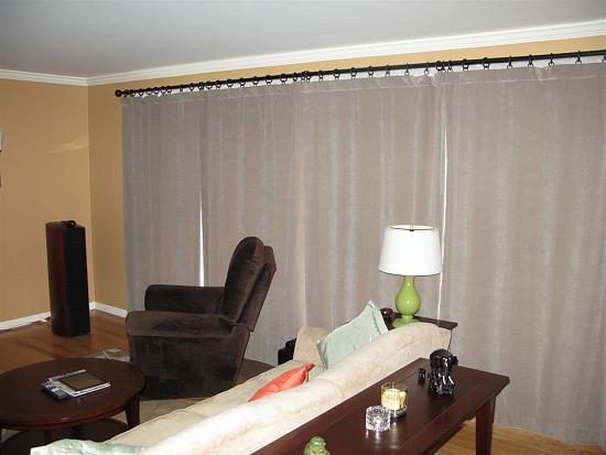

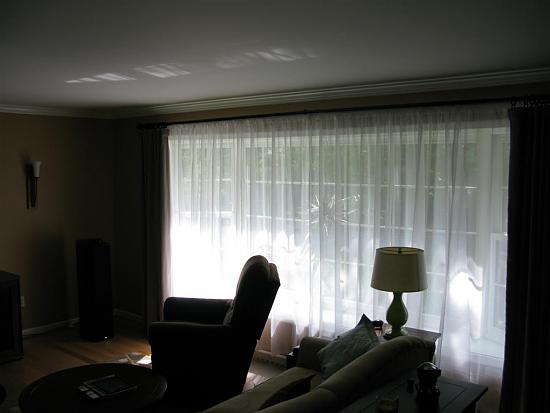

            This is the huge window which runs parallel to the speakers.
Name:	IMG_2996 (Large).JPG

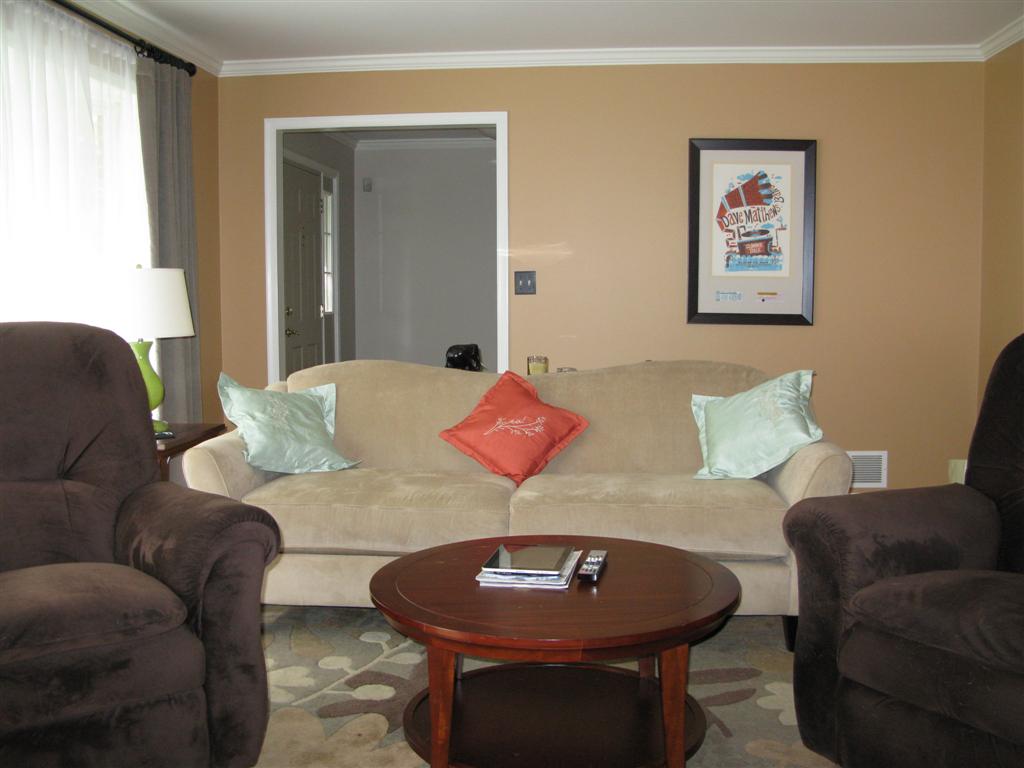

            Doorway to the dining room
Name:	IMG_2997 (Large).JPG
            The back of the room. Notice all furniture is cloth.
Name:	IMG_2998 (Large).JPG

            • stuofsci02
              • 1241
              Originally posted by mb225
              Thanks stuofsci02, this is very helpful.
              I've already done a lot to tone-down the room. I'll see if I can upload some photos of the room later today. Without adding acoustic panels (which I really don't want to do), I'm not really sure what else can be done.
              Again thanks for the response. I'm really glad someone with 803s/804s has some feedback on the DacMagic.
              It sounds like the amp might have a bigger impact on the kit. Just curious, did you get a chance to try out a McIntosh amp when you were looking at the Chord amps? I would be interested in your opinion since I don't have any Chord dealers near me.
              If you have done everything to the room you can, then it might be the electronics or maybe it is just too bright for your taste (this is always possible). I would also suggest trying something other then the optical output to the DACMagic.. Maybe you can try coaxial if possible, or just try a CD player via Coaxial. In most instance people prefer the Coax to optical.
              I have heard the Rotel class D stuff with my 804s and it was fine, but seemed a little thin. I have not heard the 1582 before, but it seems like a capable amp.
              I did not have a chance to audition Mac with the 804s. When I bought my 804s they were the only ones left in my area (Last Dec), and so I could not go and listen to Mac.
              For me this was ok since most people find Mac to be a warm pleasing sound. This is fine, but it was not what I wanted. I like an amp that is fast and neutral, if that makes any sense. Some might find my Chord cold if they are used to a Mac, but I really like it. It has exceptional control of the speakers and is so lightning quick. I have not heard anything better to my ears with B&W speakers.
              I would also steer away from moving them closer to the walls. This might cause your bass to be boomy which might give the feeling that the top end is tamed a bit, but IMO you will just be removing the preciseness of the 800 series speaker. I agree with you dealer... Let em breath..

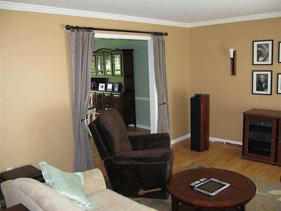

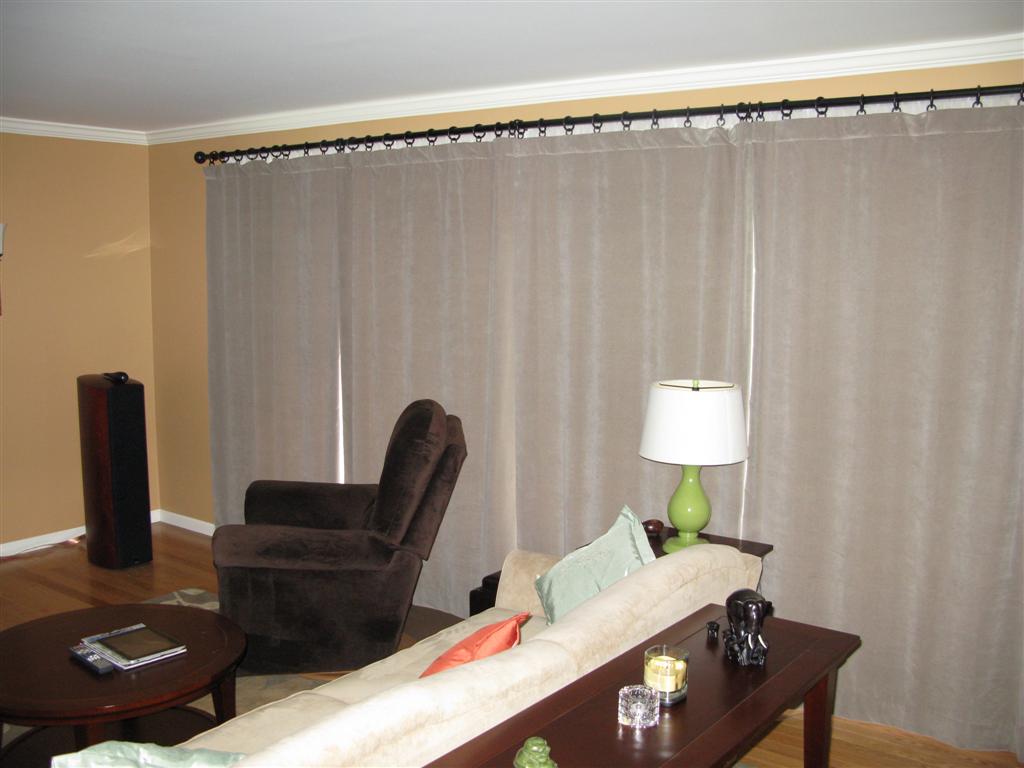

                Window curtains close when listening
Name:	IMG_3000 (Large).JPG

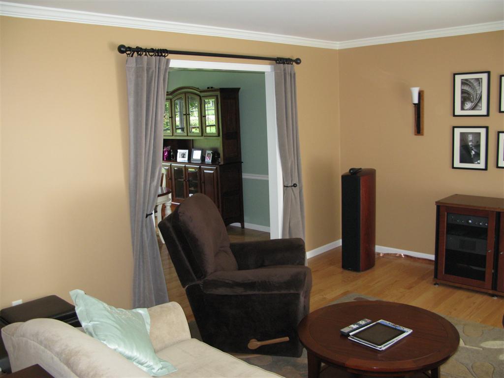

                Doorway curtains close for listening
Name:	IMG_3002 (Large).JPG

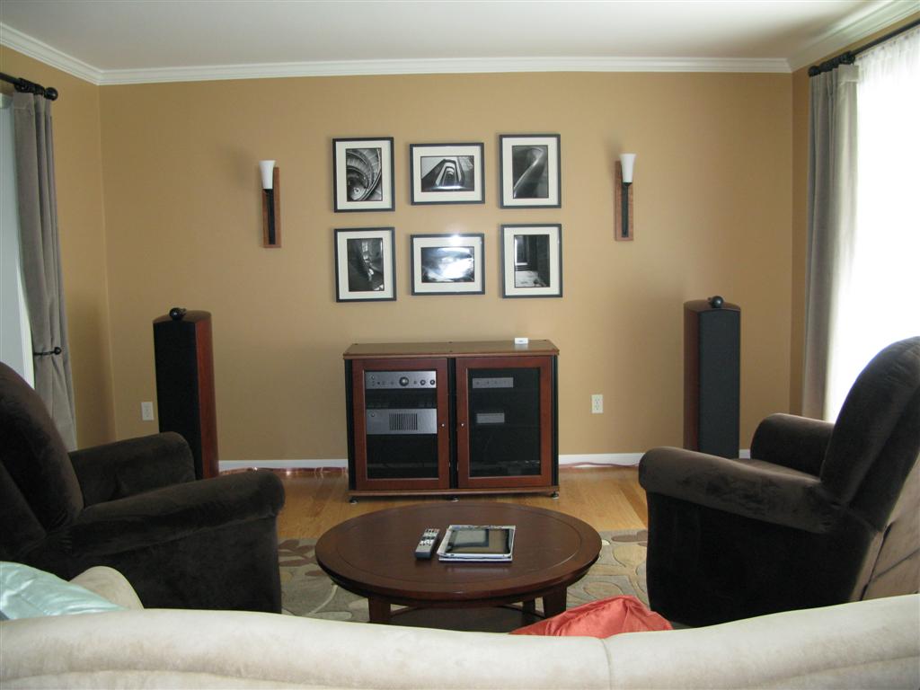

                This should address the first reflection points!?

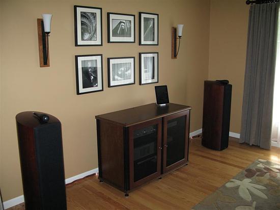

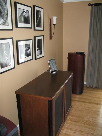

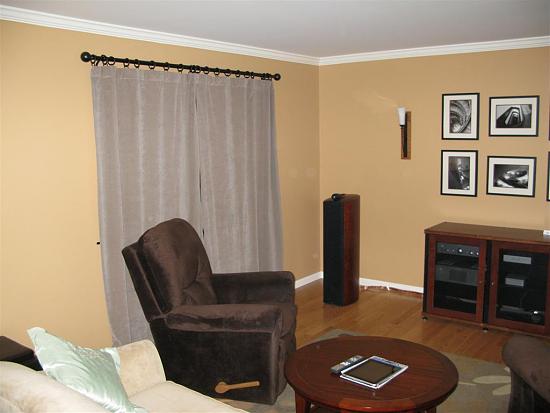

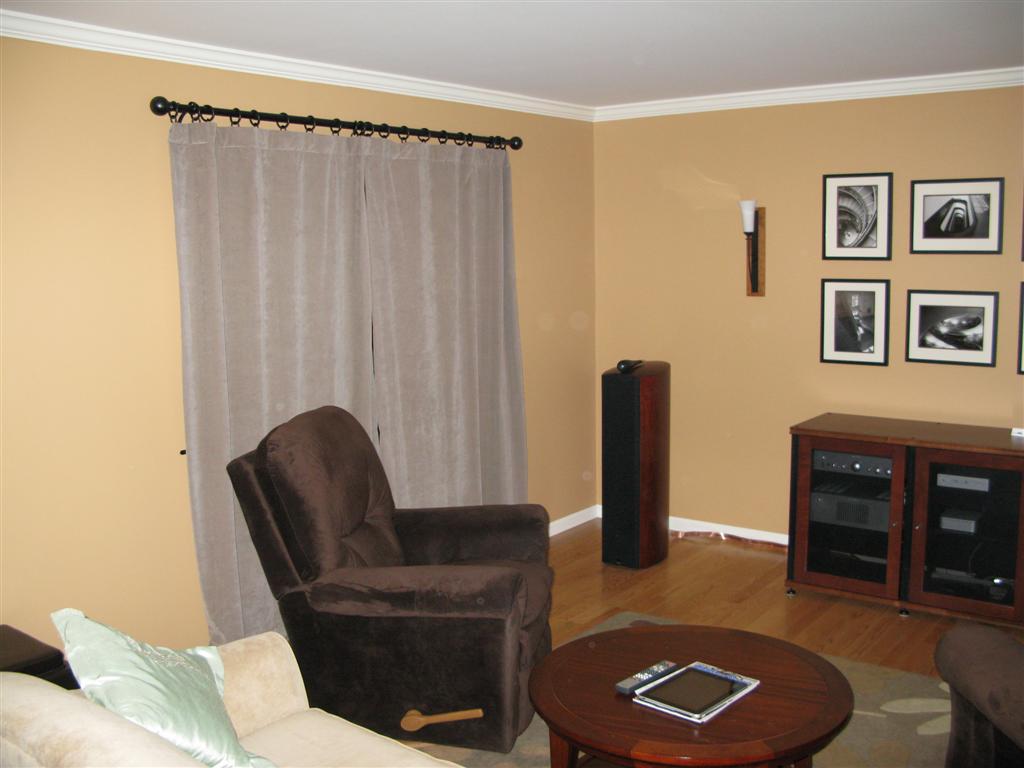

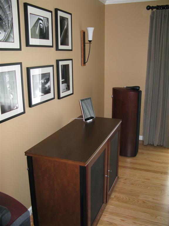

                Current speaker placement
Name:	IMG_3003 (Large).JPG
Name:	IMG_3004 (Large).JPG
                I welcome comments on the room. I think I’ve done more than enough to flatten out (without acoustic panels). But maybe I’m wrong.
                Thanks again everyone!
                • stuofsci02
                  • 1241
                  Ahhh.. I see pictures now...
                  Nice home!
                  I really like your speaker positioning. I wouldn't change that at all except maybe toe in a little if you prefer that.
                  I think though that your bright sound may still be caused by your room. You definately have a lot of flat refective surfaces. I think the biggest culprit is that back wall. Even if you could take care of that I think you will have a big improvement.
                  Also I cannot tell but from the look of the pictures the ceiling is flat with no texture (stipple/stucco). This might be problem number two, but something you can do little about without ugly ceiling panels..
                  Lastly, when you listen are the blinds closed? *Edit*.. I now see the closed curtains..

                    • stuofsci02
                      • 1241
                      I see now the second post.. I began typing my comment before you posted those, but submitted after.
                      I think a simple thing to try would be to get something like an old piece of carpet or rug and temporarily hang from the back wall to see what this does.
                      I think that your room is fairly large and so bass should be nice a tight and not overly loud, but the room is also reflective in parts (like back wall). High frequencies reflect the most. My concern is that you hear the highs twice. The first time when they pass your ears and then a little bit of reflection a fraction of a second later. This would IMO make it sound bright and a bit harsh/hollow. This combined with the tight bass would make your speakers sound brighter then they really are..
                                        Turns out you were both right.
                                        1) I pinned an old comforter and a mattress egg-crate to the back wall. That made a huge difference! In fact I think it was too much. It made the back of the room sound dead. It no longer sounded like I was "in the music". I sounded like the music was coming from the front and going past me.
                                        2) I tried moving the speakers closer to the wall. This did exactly what you predicted. It made the bass come out more and that masked the treble more. Unfortunately, now I understand why my dealer told me to give them as much room to "breath" as possible. When moving them closer to the wall it balanced the tone more but also made the bass very boomy.
                                        After I moved the speakers my wife came in to see what I was doing and ask about the old bedding on the wall! :alol: She said... "why does the bass sound like that? it doesn't sound tight anymore."
                                        Which leads me to my conclusion. It's most likely the room acoustics. I'm going to need some panels or something.
                                        What I find interesting is when I had the bedding on the wall I found the treble was under control but... I still thought it lacked a little warmth in the vocals. Maybe this where equipment comes in. I still think acoustic treatment is my next step and undoubtedly will offer the most improvement.
                                        Question:
                                        Does the wall that the speakers are against matter for acoustic treatments? After putting the egg-crate on the back wall, it sounded like the front of the room was too lively. I will need to find a good balance.
                                        I am glad you found the possible culprit.
                                        I would definately advise against deadening the whole back wall. I think you only want to remove the first reflection points.
                                        The simplest way to do this is to sit where you would normally listen from and then have someone with a small mirror move it along the side and back walls. Where ever you can see the tweeter of a speaker is a good spot to put a panel or some other sound deadening material.
                                        The wall the speakers are on are IMO the least important of the 4, but a lot of people will put a 48" x 24" panel behind each speaker.
                                        As for warmth in a voice I cannot comment as I do not know what you are listening to. That said it may just be the recording, unless you know for sure it sounds different on another system.
                                        Cheers
                                        Stuart

                                              I was on the same boat you're in a few months ago. I was considering the Benchmark and Bryston DACs. I'm using a Sony ES, Denon 5910 and an old Adcom 5 disc changer - I flip between them all the time, honestly, they all sound pretty good. The Denon sounds the best - but the difference is not night and day.
                                              I decided to tackle room acoustics - the difference is night and day! I have a dedicated room, so your situation is tough with the wife acceptance factor. But, trust me, if your wife is like mine, she aint gonna be too happy with you spending 2k on a DAC
                                              By the looks of the pics, its very possible that the pictures you have above your gear and the bare wall behind your listening position are your biggest culprits of the edginess you hear. Auralex, ASC and other companies now offer wife friendly products that might fit your bill. In my experience, the front wall (behind the speakers) and back wall reflections can make a system sound hard.
                                              Here are a couple of suggestions that I have no doubt will improve your sound instantly.
                                              Treat the front and back wall - I use medium sized indoor plants to handle the sidewall reflections. Check http://www.auralexelite.com/ or http://www.asc-hifi.com/picture-panel.htm .
                                              Move your gear from between the speakers - this will improve your imaging more than any DAC or cable will. Reflections from your gear in the middle might be causing a comb filtering effect that might be leading the edginess your hearing.
                                              For music listening, move that table between the chairs out of the way, again, reflections from the hard surface do not contribute to the musical presentation.
                                              Check out the "spouse friendly" section in real traps sight http://www.realtraps.com/products.htm . Your room looks beautiful the way it is - some of the products listed on these sites can be worked in to your decor. You will be amazed how great your gear can sound.

                                                                        Looks like you don't need to find a new DAC!
                                                                        The curtains will certainly help a bit (although strange to have them pulled shut during the day!), but they need to be pretty heavy to work for sound absorption.
                                                                        I would also suggest as an another option is to use the back wall for books or your CD, DVD or Bluray collection - it'll help with some sound absorption rather than the reflection you currently have. Although these 'home improvements' will need a bit of negotiation with the missus ;x(
                                                                        Speaker toe in will help with your focus of sound, not the bass.
