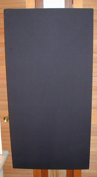

                            For 1st reflection points I ended up using 2" Bonded Acoustical Cotton from Sensible Sound Solutions. Bought my own wood and fabric and made my own. These 6 panels I made replaced Auralex I was previously using - what a great improvement it was over the Auralex.
                            For bass trapping I have used the GIK 244 product and have been very satisfied with the results.
                            With these panels, they can be hung up so they are not permanent. This way you can experiment with placement and/or amounts and if you find it is too much, then you can remove some. Most do not realize what great sound you can get with the treatment of your room. Room affects on your sound is far greater than most realize.
                            I have my setup in my "audio bunker" - a partial basement with concrete all around me. I have 8 of the 244 panels in the corner, 3 more 244 along the back wall behind seating positions, and 6 of the 2" homemade ones - 2 of them on front wall behind speakers, 2 on side wall right next to the speakers, and 2 more on side wall at first reflection points. The 244 really helped with bass in the room - concrete really loves to accentuate the bass - and the 2" panels helped with sound depth, width, and left/right channel separation - and of course comb-filtering reduction.
                            It has been some of the BEST money I have spent on my setup in terms of sound improvements to $$$$ spent. Here is a picture of one of my homemade 2" panels (they are 2' x 4' in size).
