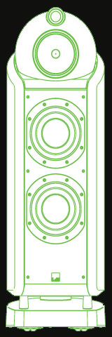

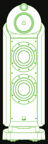

                  I took a graphic from the b&W site and played with it. Take it if you want.
