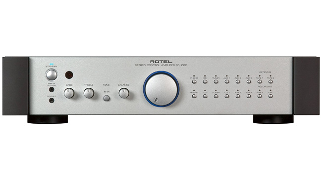

                                                      Alternatively you could try the Rotel RC-1082 preamp that I've just bought. It's got two old fashioned knobs on it called Bass and Treble.
