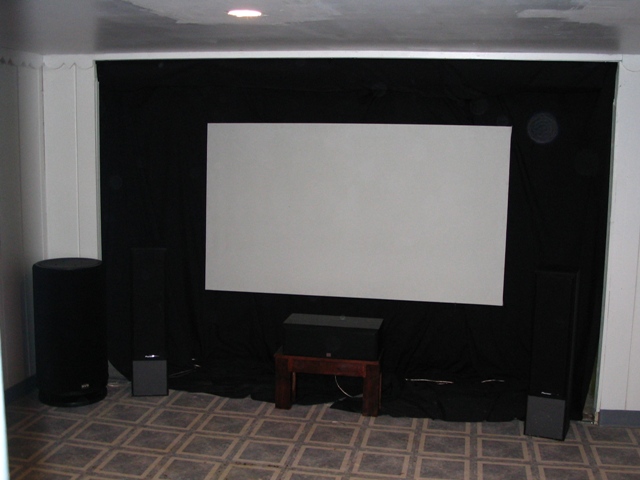

    okay,
    my question is this, in my home theatre room, on one wall there is a large closet, currently that is where all my gear resides. the screen is hung, and all the speakers sit inside it. The closet is empty, and the fronts of the speakers are flush with what would be the fronts of the door, currently there are the L-C-R and the subwoofer, however I recently got a new subwoofer so will be moving that to just outside the closet into the corner (to corner load it) What i am thinking about doing is to build a frame around the back of the closet, and sides, and cover the frame in black fabric, leave the screen where it is (hanging) and put the speakers flush with the screen. I would consider moving the screen to against the back wall, but that would put the speakers about 3' in front of the speakers, and im not sure how that will sound.
    any ideas?

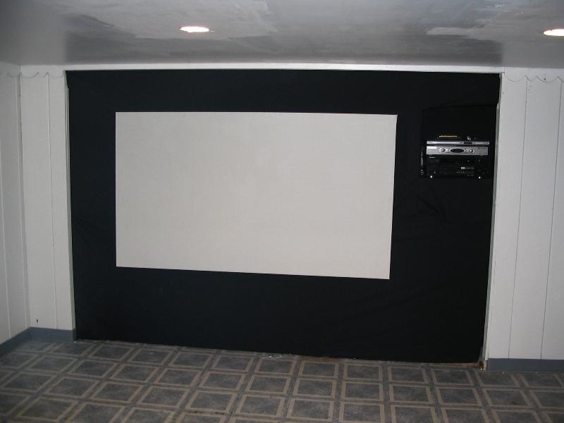

            okay,
            I have taken a few quick pictures.
            here is some backround.
            When I put the theatre stuff in, I didn't know a whole lot about sound and what not, so I tried a few different things. What I ended up with was stretching fabric across the entire doorway, and placing the speakers behind the fabric. it's almost a sheer fabric, but I have a feeling it is doing wonders to destroy sound quality. The center channel is sitting behind the screen (which isn't accousticly transparent)
            all these things are known no-no's, and will be corrected. However I wanted to take pictures and get everybody's idea of what should be done to fix it. I have attached a few pictures...
            as you can see, it's a large closet and it's almose the full width of the room, it has no doors. to give you an idea, the screen is 90" in diagonal...

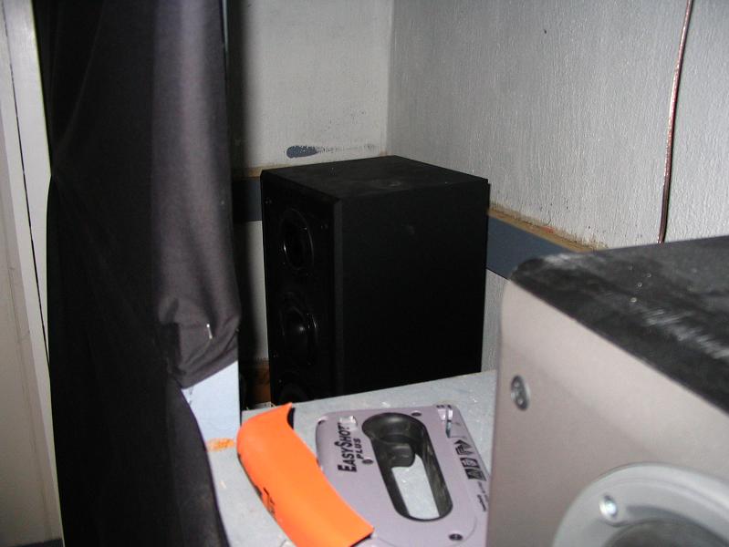

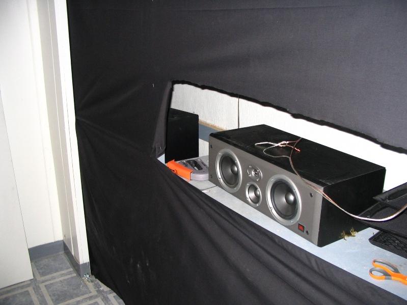

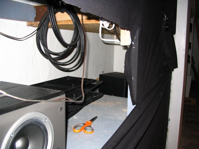

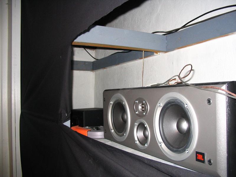

              here are a few pictures taken with the screen removed and it shows what the closet looks like behind the fabric. The center channel is a JBL EC35 which has a bad driver, and needs to be serviced and the speakers are some non-descript floor standers. All the speakers are being replaced with new speakers, I am probably going to use DIY speakers, but have not decided on exactly what kind yet.

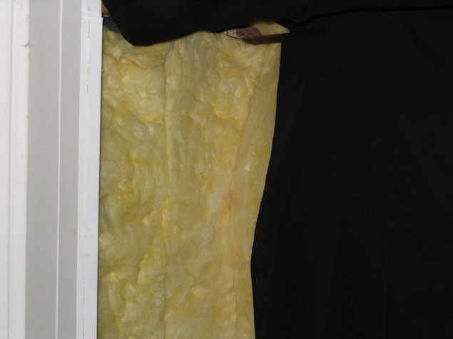

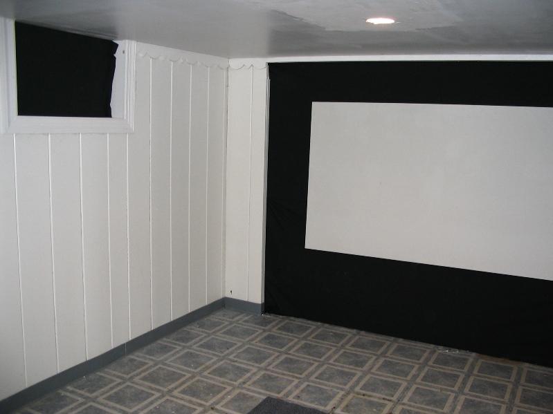

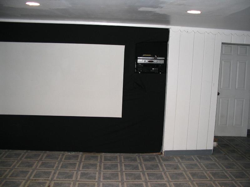

                    ***update***
                    okay, I have finished the speaker build. I have redone the closet with advice from people over at DIYaudio, and lined it with insulation that faces outward, and then draped black fabric over that. It sounds much better. I also upgraded the subwoofer along the way. Going from a JBL E150 (10" 100watt) to an SVS 25-31 passive (12" tube sube, powered by rythmatic 350watt plate amp) this subwoofer shakes my HOUSE...
                    The work on the room is still far from completed. I still have to repaint the room, install carpet, and close it off on one side. then its time to upgrade to some new speakers.
