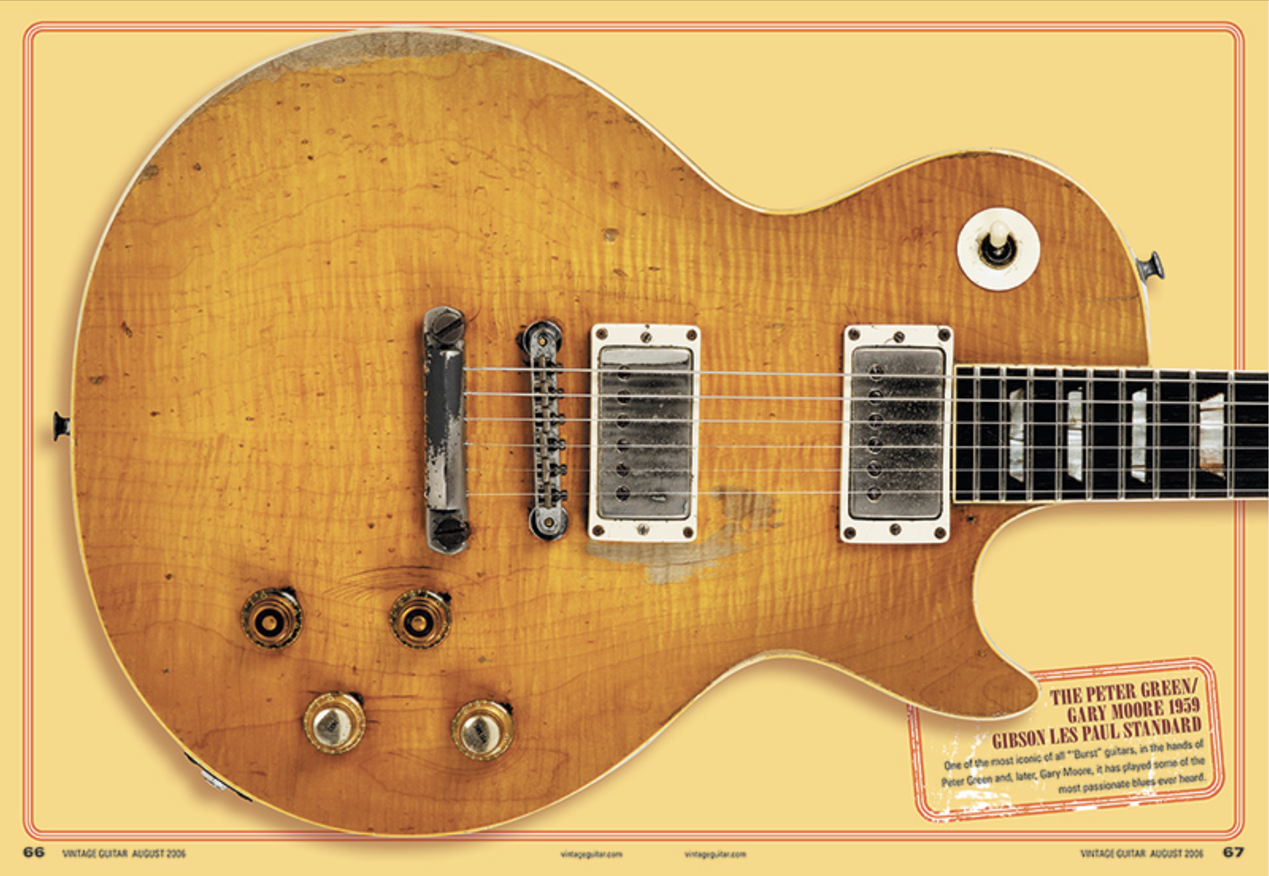

    • So, just what is a "Greeny"? It was/is Peter Greens 1959 Les Paul with the relatively rare lemon burst finish, and far more rarely, with the magnets installed backwards in the front pickup. By mistake. What happened from that is that if you used the center pickup selector switch position, and varied the levels of the bridge and neck pickups, you could get some unusual and interesting tonalities which are evident on his recordings from that period.

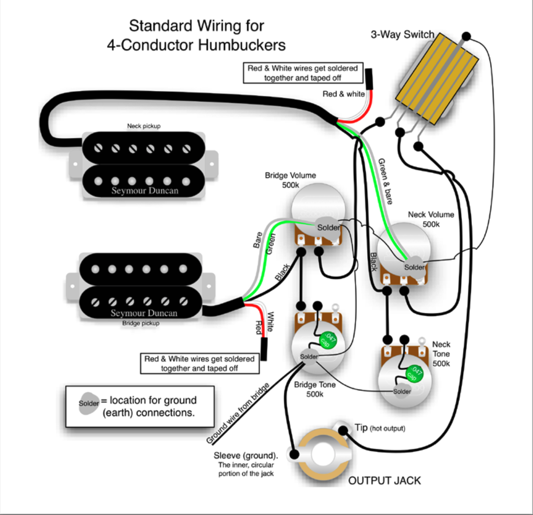

    • And, one of the finest after market pickup operations I'd found was Seymour Duncan, who offered period exact replicas of '59 humbuckers, EXCEPT that they were wired like a professional microphone, or like the pickups in my Les Paul Professional (had one back in the 70's, bought a replacement with the 2013 re-issue), in that they had balanced isolated signal wiring, and the ground shield separate. SO, it's possible to reverse the phase on a Seymour-Duncan pickup without any noise pickup issues.
    • And, just to add a bit of heresy to the process, I've always been fond of a Bigsby vibrato on Gibson models, like the Johnny A signature model I have, so... why not?
    Here's how the Seymour-Duncan pickups have to be wired up:
    Click image for larger version  Name:	Std Seymour Duncan 4 balanced wiring.png Views:	0 Size:	450.0 KB ID:	951492

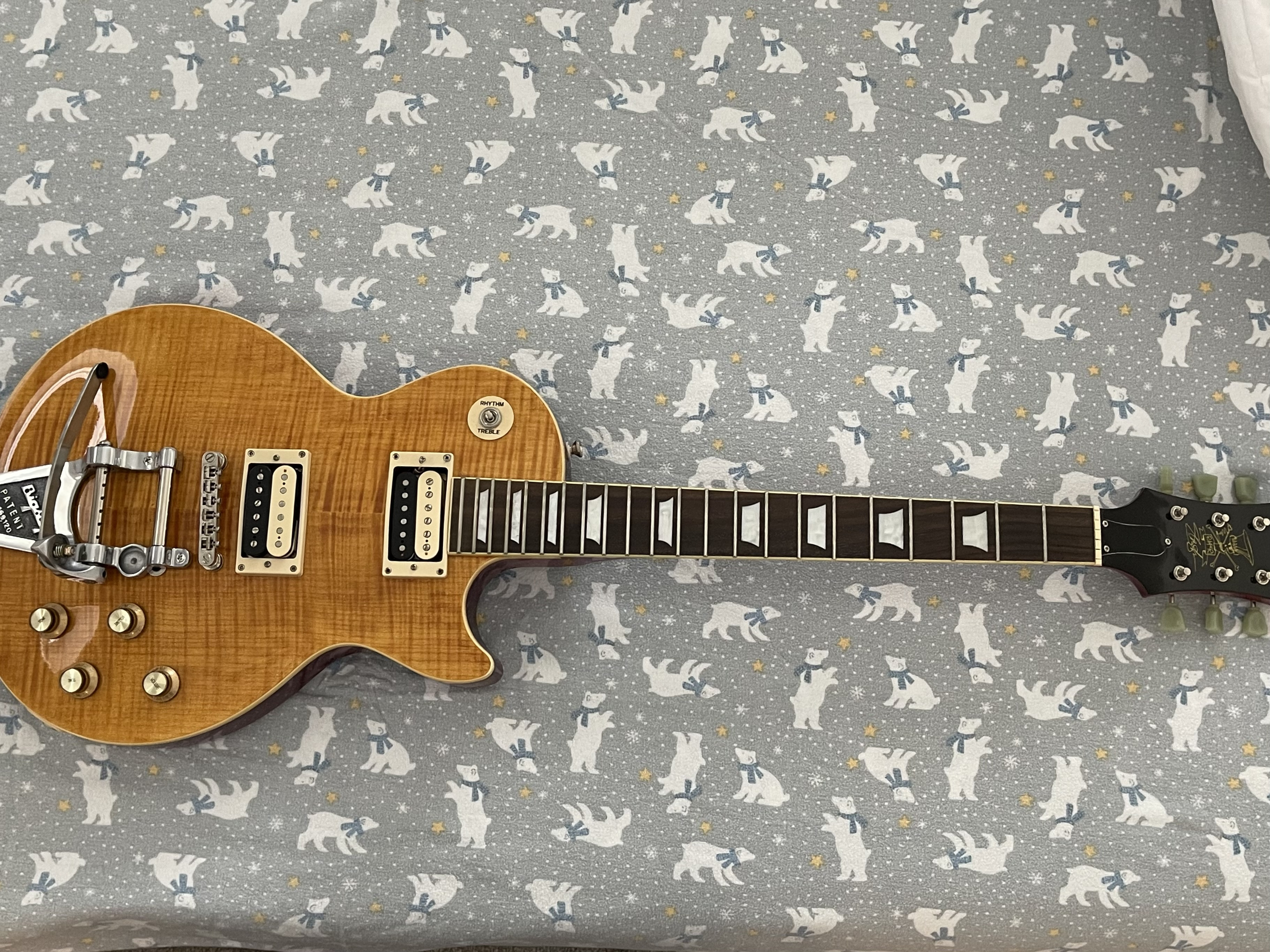

    This is the NOT RELIC'D result:
    Click image for larger version  Name:	My Slash-Greeny.jpg Views:	0 Size:	2.39 MB ID:	951491
