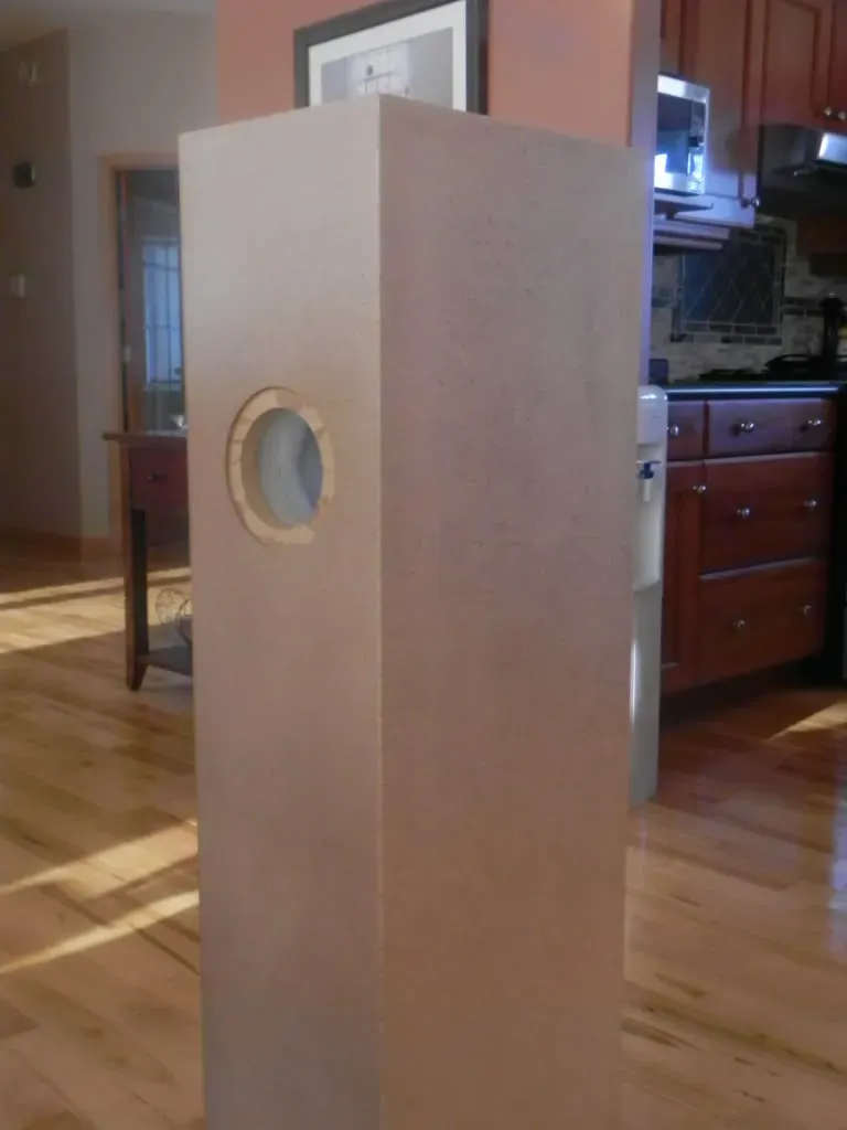

                                                All good ideas here, I would point out that MDF is a substrate material never design to be a top coat. It needs something harder and more stable for a true finish surface. I don't tend to prefer gloss black but if I did I would treat the final surface to something harder. Those folded miter production corners are convenient and allow the use of just 1, 3/4" layer of material. I did a Muodula MTM for a friend some 5 years ago that he want modeled after some Audio Tectnica's. and that had 1 1/2" front baffles and 1 piece wrap around veneer. Asked if he can see joints 5 years later and he said no they a great.
                                                To give them a real hard substrate I used real hard board, the 1/8" peg board stuff not MDF (big difference). Now I only had a front rounded surface to deal with and a seam at the top and back. I call it a seam as the 1/8" hard board doesn't behave like a MDF joint.
                                                Jim I know you said you have used 1/8" wrap before but I think if you cover bottom first, back, sides, front and then top you should only have a seam at top top that is visible. In this case if you seal that round over in an epoxy you should have a paint joint you never see.
