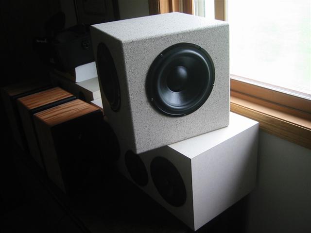

          and will be painted.
          Apply a generous coat of high-solids primer-surfacer... wait a few days and sand. It will fill MDF edges perfectly.
          If you're doing a clear finish, you can use a high-solids lacquer sanding sealer, but it may take a few coats to completely fill the edges.

            Wow how long did it take you to get that glossy finish? Did you use a sprayer?
            • technimac
              • 233
              My guess is that he probably used the one in the first photo :W
              "While we're at it" - the four most dangerous words in Home Improvement
                Yeah my bad I overlooked it Still wondering how long it took to get a finish like that though.

                    Yup, I spray almost everything. I have a couple of production guns and some touch-up guns. Old fashioned, not too expensive models from Home Depot. I haven't gone the HVLP route yet.
                    This post https://www.htguide.com/forum/showpo...0&postcount=13 from my build thread on those subwoofers covers some details on the finish. The "secrets", if there are any, are
                    1. Perform sanding steps with a large, unbacked (or thinly backed) block. It helps keep the surfaces flat. MDF is, of course, flat to begin with but the process of trimming edges during build can result in divots and "wavyness". I have a variety of power sanders, but I most often sand with a full sheet of sandpaper wrapped around 7" x 11" slab of 1" MDF. My large hands grip this comfortably.
                    2. High-solids automotive primer-surfacer. Great stuff. Fills well, dries very quickly, sands easily into a fine powder.
                    3. Inspect the primed surface carefully before final finish. Fill imperfections with spot putty and sand or do another round of primer-surfacer. Final sanding with 320 makes imperfections easy to see in reflected light as the surface is almost "polished".
                    4. Give the surfaces plenty of time to dry and shrink before final finish. A couple of days is good, a week is better.
                    5. In warm temperatures, lacquer can be difficult to spray without getting a dry, pebbled finish, especially on larger surfaces. May need to go to a "slow" thinner and/or retarder... or wait until shop is cold.
                    6. Apply plenty of finish - three full wet coats minimum. You DON'T want to cut through later when polishing. 8O On the other hand, be careful to not overdo it on non-horizontal surfaces which will result in runs & sags.
                    7. Color sanding takes some practice to completely smooth the surface without cutting through the finish. Pause to clean and inspect surface often. As soon as 90% smooth, STOP. Polishing compound will take care of the rest.
                    In the end, a hand-polished finish takes more time than applying and finishing veneer, but not much more. If you have access to a spray booth or dust-free work area you can get almost the same results with modern two-part acrylic enamels and basecoat/clearcost systems... without the color sanding and polishing.

                      Sorry Dougie, last post was a long-winded way of NOT answering your question.
                      Finishing process takes about a week, with most of the time waiting for drying. I probably have about 20 man-hours in the finish of those subwoofers, with color sanding and polishing taking at least 8 of those (10 surfaces and 24 rounded edges just takes time).
                      Also in the above post, steps 3 and 4 should be reversed. Let primer dry and shrink before sanding.
