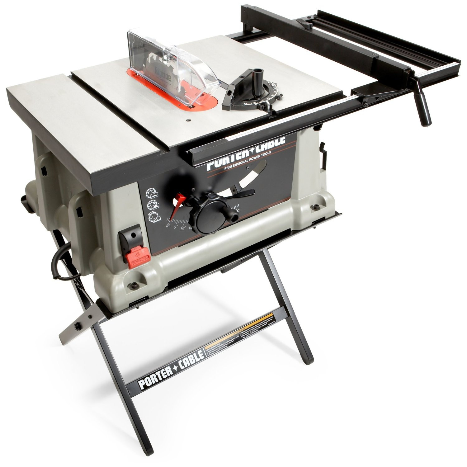

    Hey folks! Thinking about upgrading my table saw. I'm starting to get into furniture building in addition to the amps/speakers/etc. that I've been dabbling in. So I think it's time to upgrade from my dinky Porter Cable table saw.
    And getting the 36" version of this:
    I thought about the contractor version since I want to get it in and out of my shed. But it's actually not much lighter, and surprisingly, it's deeper since the motor hangs out the back instead of underneath. And once you add in the upgrades like cast iron wings, the price isn't all that much different either.
    It seems a bit strange to have a full cabinet saw sit outside of my shed and I'm a little worried about rust (beyond just getting the thing in and out) but I think I really want to invest in the saw stop technology and I might as well get the big boy if I'm going to get one.
    So... anyone have any thoughts about my rationale? And perhaps more importantly, anyone have any thoughts about keeping it in tip top shape given shed storage and outdoor usage? Is that just stupid?

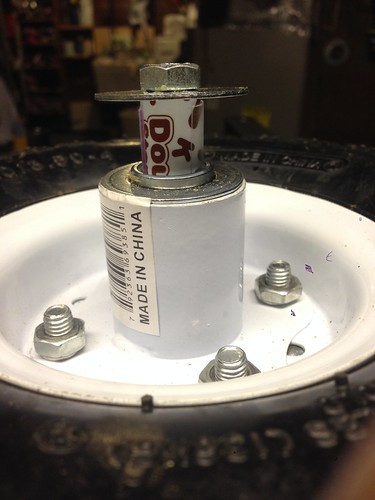

                                                  I got some parts from Home Depot today to rig up my DIY base. 4" long 3/8" diameter bolts will go through washer --> wheel bearing --> washer --> saw base --> washer --> and then into a 2x2 wooden "axle". The two things I need to work through are that the bolts are too small for the wheel bearings (wheel bearings are about 5/8" dia) AND slightly too small for the hole in the saw base (by about 1/16") I really just need some appropriately sized spacers. But they don't exactly make those so here's what I'm thinking:
                                                  For the wheel bearing, I thought I could buy some 5/8" dowel and drill it out. It's not exactly a high speed/high stress operation so I think that will work ok.
                                                  To make up the difference in the saw base, I may just cut out a piece of plastic soda bottle and wrap it around the bolt once or twice. It will be trapped by fender washers and also won't need to put up with too much stress so I'm guessing it will do ok. I think it's worth a shot anyway. At least it's free. And I could always do it differently if I have issues.
                                                  Anyone have any other ideas to improve upon mine?

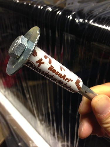

                                                    New approach for the spacers. First, I found some dried out markers that I cut to length. Then I cut up some fat straws that are used for bubble tea (it's just a straw that's about 5/8" in diameter) to make up the remaining gap.
                                                    There isn't too much wiggle room actually. At best, I probably would have gotten a spacer to within maybe 1/32". These are at least that good. Would I prefer a billet aluminum piece milled to 0.001"? Sure... but this was free and I think more than adequate.
                                                    Now just need to cut and drill my wooden axles and bolt everything up!

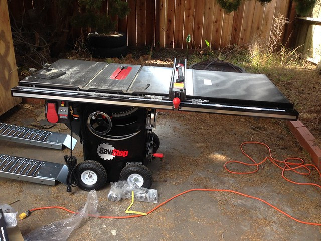

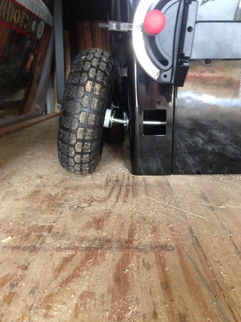

                                                      ATV table saw:
                                                      Tomorrow, I'll get it on the floor and see how it rolls. Also, I got the 220V contact box so I'll get that installed. Then, it may be time to start putting the wings, rails, and fence together! If I'm lucky, I may be able to actually turn it on soon.
                                                      Last edited by theSven; 28 April 2024, 09:50 Sunday. Reason: Update image location

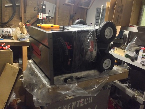

                                                        I got the 220V contact box installed. It's exactly the same except the contact switch mechanism and the reset button are rated for higher voltage (and lower amperage interestingly enough.) It's a deal for $40 I think. All the cables and hardware are duplicated and the build quality and materials are top notch. Also rewired the motor for 220V which was very straight forward. Also, I have the 220V dryer cable terminated with a 220V twist lock plug which mates with the corresponding plug I installed on the extension cord which is now terminated on the other end with a special 220V plug that mates with the saw plug. A little confusing, but it works. I'll post a picture later to show the chain.
                                                        I also got the saw on the floor. The wheels work ok. But I'm not super happy with it as the weight of the saw as is already creates a bit of sag. And I'm going to be less happy with it once I get the extension wings, rails, and fence installed. I'm not quite sure what the solution is. If I had a lathe, it would be a simple thing of just machining a precision axle. Will have to noodle this one a bit.

                                                          • 16203
                                                          That is ONE chunky Monkey of a saw! Very manly, but as you see, not at all easy to "go mobile" with. that's always been a problem for me, and kept me away from buying a more robust saw. I hope you get this figured out to your satisfaction- you're getting close, but maybe still a little more compromise. Wonder if you could take this job for a precision axle to some kind of shop?

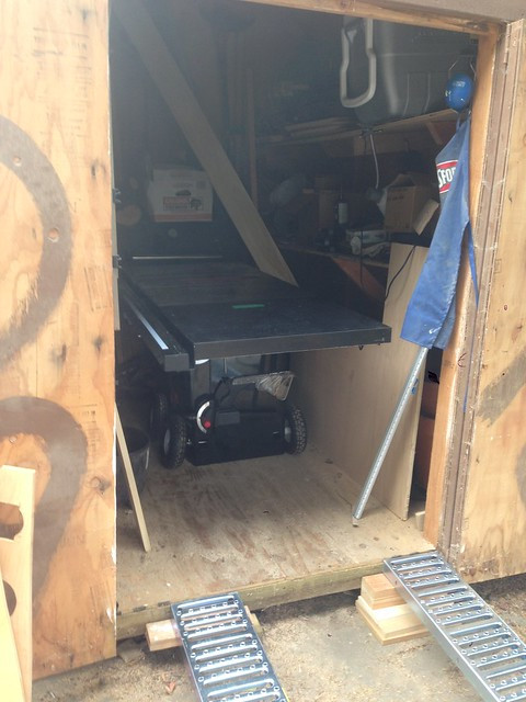

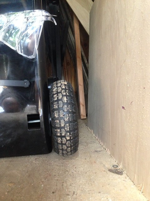

                                                              Table saw is in the shed!

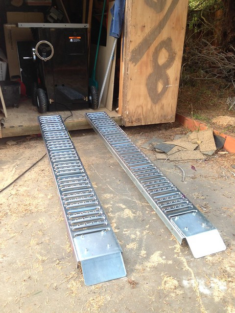

                                                              The ramps worked reasonably well. Except the saw base kinda gets hung up on the ends since the transitions are not entirely smooth. I should be able to fix that with a few scraps cut to size. Still not super happy with the wheels themselves. But I haven't had time to come up with a new solution yet. So for now they'll do.

                                                                Why not just build a ramp that's permanent?
                                                                • oneplustwo
                                                                  • Jan 2010
                                                                  • 666
                                                                  I considered that. But what you can't see in the pictures is that my yard basically ends a few feet beyond the ramp (big bush, then fence... yard is 25 feet wide in total). So that doesn't leave enough space to roll it out and have it sit on flat ground and have room for the table extension. I could make the ramp steeper and thus shorter, but I'm not sure I can roll nearly 500 lbs up a steeper ramp.
                                                                  Another idea is to forego wheels and just put a shaft through the holes with large bearings outboard. Then I could build some rails for the bearings to ride on so that the saw itself would sit on the ground properly instead of on pneumatic wheels. That rail system would have to be pretty beefy and somewhat complex compared to a basic ramp though.
                                                                  Open to other ideas!

                                                                    • 3815
                                                                    Those ramps you have are backwards. The ends you have on the concrete are meant to go up on a truck tailgate so you can push a four wheeler or whatever up into it. They're built for a much steeper incline (hence the large notches meant to help keep traction on the way up). If you did as Dougie suggests and just built a small ramp (ironically using that wonderful new tablesaw) out of wood, it would not need to be nearly as long and would have a much smoother transition. Just my $0.02.
                                                                      Yes, you're right. I had them backwards because the saw bottom got hung up on the other end that doesn't have the rampy things otherwise. I might go ahead and do as has been suggested and build a dedicated shorter ramp. It would be relatively cheap to do so if it doesn't work out, no big deal.

                                                                        Right, you wouldn't even really have to build much, just a correctly sized sheet of 1/2" plywood and a few well placed 2x4s would probably be plenty just to try it out.
                                                                        -Chuck
                                                                        • oneplustwo
                                                                          • Jan 2010
                                                                          • 666
                                                                          Quick update. Turns out just using some scrap wood under the ramps I bought makes them work pretty well. Also, I bought some 3/8" zinc plated steel rod to act as the new axles. The previous setup was just waiting for a failure. Should have a chance to get them installed this weekend and take a few pics for those who are interested in how this ends. And who knows... maybe I'll even get the blade in and make some cuts!

                                                                              Well, I got the wheels on and the extension wings/table, rails, and everything else. I left the extension table legs off since I wouldn't be able to get it in and out of the shed with them on. I likely won't need them anyway since I don't cut stuff that big and heavy that often.
                                                                              Getting in and out of the shed works reasonably well. It actually fits with a couple inches to spare:

                                                                              I would like the tires to be just a hair larger in diameter to provide a little more ground clearance. Maybe an extra inch would be enough. And I'm not super happy with the 3/8" axle either. You can see here that since the cabinet curves on the operator side, I needed to position the wheel more outboard than would be ideal causing much more bending moment on the axle that is probably healthy.

                                                                              So more thought needed on whether this is a safe way to go in the long term. I can see that shaft failing half way up the ramps and then I have 450lbs of saw I need to content with. I may just put some plywood across the ramps in which case, a failure just means that it leans over a hair and it's stuck. Another option I've been toying with is just leaving it outside but covering the surface with a big piece of hardboard, draping the rest, and being diligent about rust control (kinda miss my last saw's aluminum table). I could also do a little research and see what the fatigue resistance of zinc plated steel rod is. It's been about 20 years since I went through that in college so my conclusion may not be reliable! Any Mech E's here that can do this in their sleep before I break out my old text books?

                                                                                Congrats on having the first stanced table saw.
                                                                                I agree that the axle is not up to snuff.
                                                                                  • 16203
                                                                                  http://farm4.staticflickr.com/3691/1...75cdca1f_z.jpg
                                                                                  Ouch! Maybe with a new but shorter axle, so there isn't the possibility of such a large bending radius? I'd be going back and looking at an off the shelf solution like you pictured earlier- they have worked well for me.
