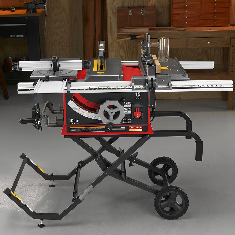

                                          • brent_s
                                            • 89
                                            If you get the Craftsman pictured above, or find a used Ryobi BT3000/3100, you can add the wide table kit for $80, essentially doubling the rip capacity.
                                            For all you ever wanted to know about the Ryobi/Craftsman BT3K series, www.bt3central.com.
                                            -Brent

                                              The Craftsman was on sale this weekend for <$400 with tax and in-store pickup. I ordered one. :B
