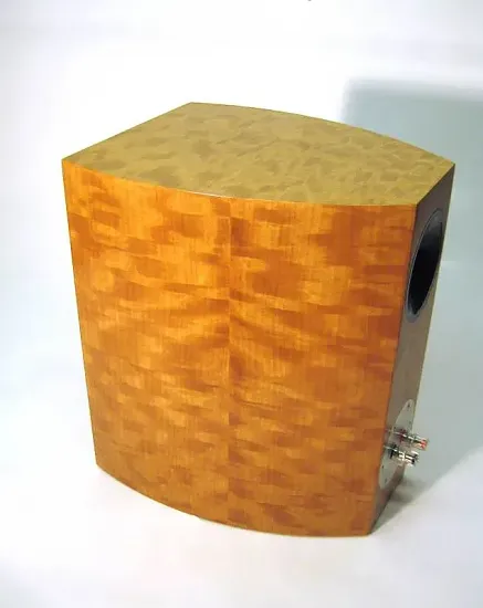

                          If you want less expensive prices and are willing to spend time learning, www.certainlywood.com sells unbacked veneer. It's the route I've gone over the years. I would NEVER recommend someone get into unbacked veneering without a vacuum press though. I've tried many different techniques with unbacked and also learned many, many hard lessons.
                          I like the fact that the edge detail is unmatched by any veneer that has been backed, and also that I get to create my own seams.

                            VERY nice, Rolex. Unfortunately I've never had the time to learn nor the desire to get into the vacuum press thing. Obviously you've mastered it.

                              That IS very nice looking indeed.

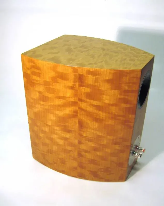

                                                  Highlighted in the image below is the seam that I created when I joined two leaves of veneer. This was necessary because the flitch of veneer was not as wide as my cabinet. Therefore I needed to make my own piece of veneer that is wide enough.
                                                  Creating your own seams allows for a lot of creativity. You can create different patterns with the veneer, or hide the seam almost completely if you are using the species of veneer that allows it.
