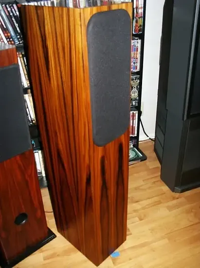

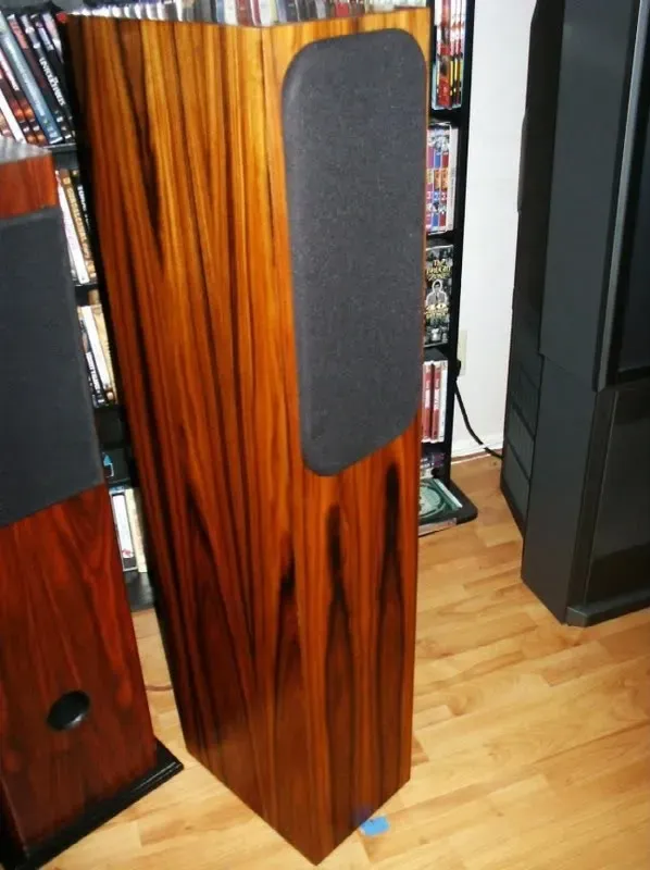

                                  That's similar to my hand-rubbed Danish oil finish. I use U-Know Who's wet-or-dry and lots of Danish oil - keep the veneer wet. I hand sand with 400-grit WITH the grain, add oil, sand, wet, sand. Let stand for 15 minutes, then wipe off excess oil ACROSS the grain only, wait a few minutes, wipe again. Next day 600- grit, next day 800-grit, next day 1000-grit, then, depending on the veneer, maybe 1200-grit. So smooth and shiny, it's been mistaken for poly finish. Here's a low-res photo:

                                    Hank, I like that finish! I had to send it to my blackberry to see--we're image poor at work :roll:

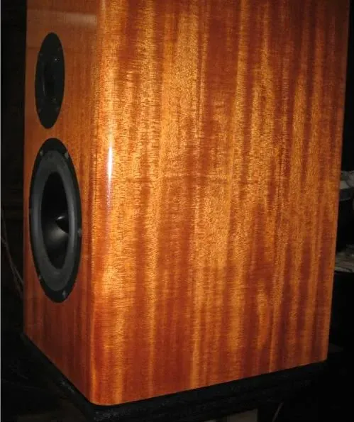

                                                      Yep... it is a lot to do a shellac only finish... but they are very nice. Sounds like you've done one since we got together long ago? :T
                                                      Brushing is a challenge, maybe I didn't spend enough time to develop better skills when I was doing my Modula MT's... but I eventually gave up and got a HVLP spray rig... helped a lot with the layer consistency, but it was still possible to get runs if I tried to do too much per layer.
                                                      Block sanding, I actually did with water and Micro Mesh sanding papers... Was shocked originally by the idea, since water and shellac do NOT normally go well together. But, this was from an award winning woodworking guy... thing is you don't leave the water on the finish that long. Other non water lubrication can be used as well.
                                                      BTW, the Micro Mesh products are VERY nice... little to no corning while wet sanding... lasted forever... cut fast and clean. Look for a kit of grit sizes. Rockler used to (still?) sell a pack of smaller squares from about 400 up to 2000 equiv grit. More affordable than buying 3" sq pieces...
                                                      (edit) Something I forgot to mention that was very helpful, look into Scrapers. The Scraper was what generations used before sandpaper. A flat blade of steel with a turned edge, you hold it in your hand and shave the surface with them. Because it's a wide and has a flat edge, it's VERY good for shaving off high spots, runs, etc, on a finish... and without removing much of the lower areas. I started using one partway thru the project, along with the block sanding, fixed up a lot of my earlier transgressions.
                                                      Here's a slightly fuzzy pic... nothing but African Mahogany and Zinnser's Seal coat:
