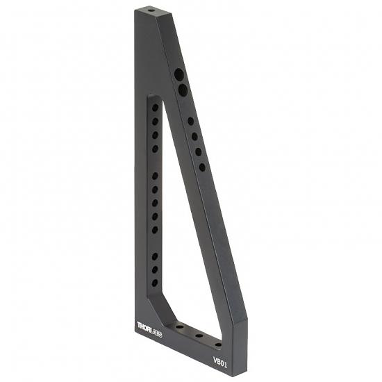

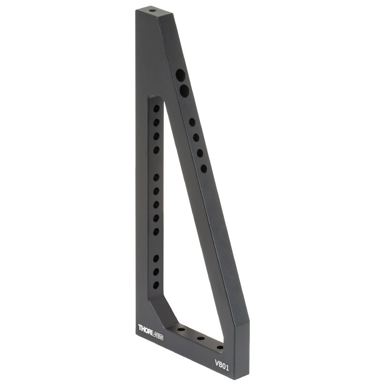

              I'm currently building some Statements.
              I glued and clamped my MDF using two 90 degree precision aluminum brackets that are perpendicular to 0.003". They are normally used for precision optical assemblies. The brackets remained clamped in each glue joint overnight (I work slowly!). I use Titebond II.

              In the end, the top of my cabinets were off by about 3/32" to 1/8" from perpendicular (this happened with both of my cabinets). I ended up covering the entire top with bondo to level the top. Then I covered the bondo with another 3/4" MDF board. My cabinet is nice and orthogonal now...it's just 3/4" taller than planned. Luckily the baffles and rear panels I cut are oversized (by 2 inches in height), so I didn't have to make new panels.
              I'm still not sure why the pieces didn't remain perpendicular when unclamped. I wished I had used some temporary bracing that could be removed just prior to finishing the cabinets.
                          The glue makes the pieces sliding off unless you have good corner clamps to hold them down well. This happened to me before. I've learned my lesson by checking my gluing baffles every couple mins to make sure they're not sliding off. Also, it helps if you place some heavy objects right next to your baffles to keep them from sliding either sides... On my first diy sub, I used glue and screws to joint all the sides together cuz' at that time I only have 2 clamps (still dont have enough now). That works pretty well. Just take more work on pre-drill those holes.

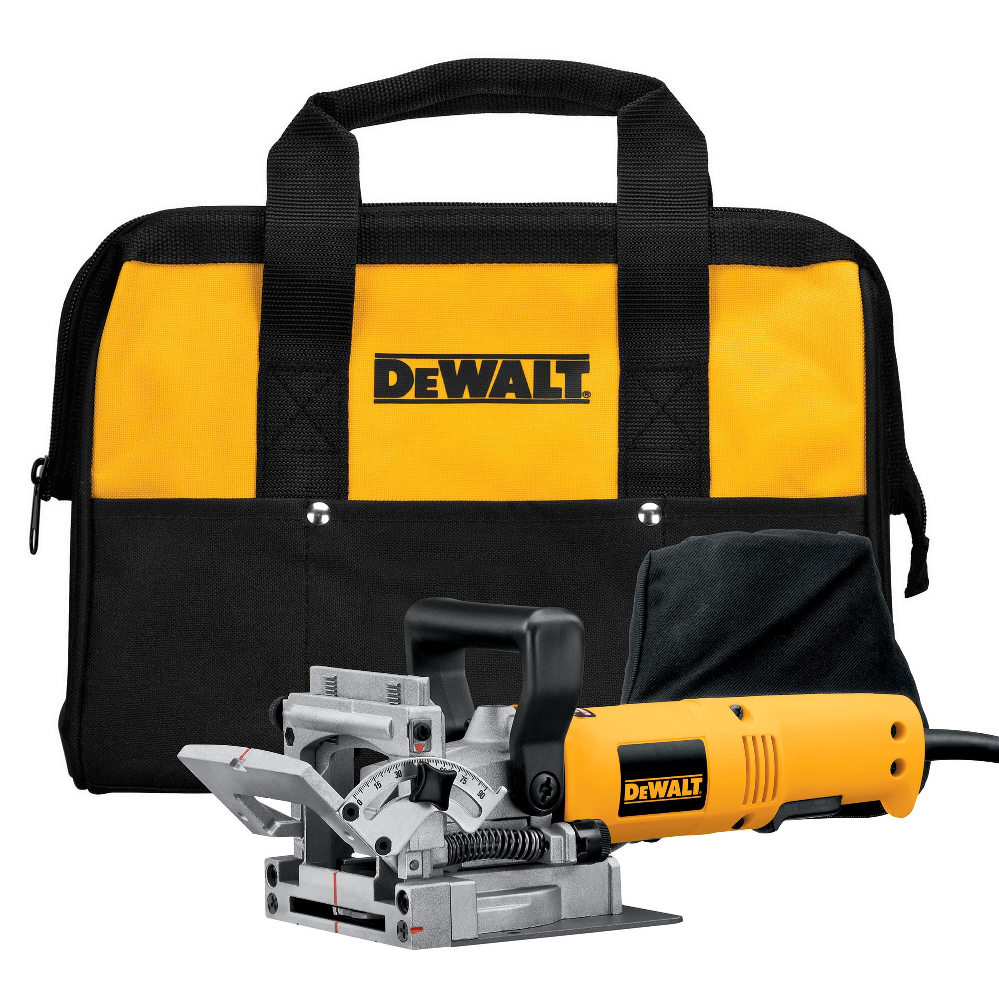

                                    Some of us DO have biscuit jointers (technically, a Plate Joiner, DeWalt DW682- it's a honey!) and do use them- naturally to be "featured" in the skilled hands of ET for building the Ardent.

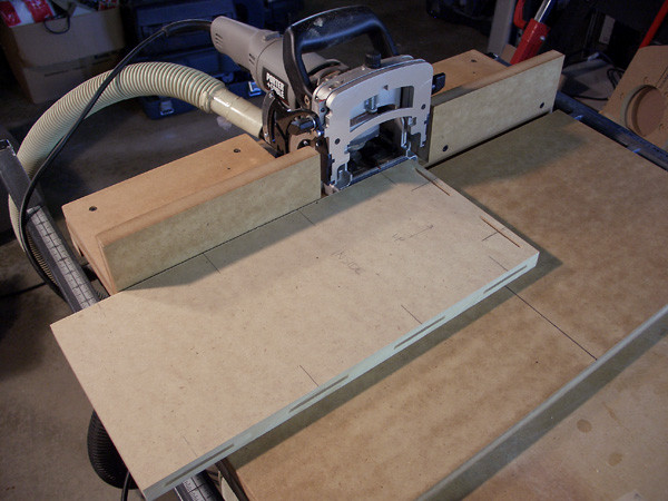

                                        • Bill Schneider
                                          • 158
                                          Heh, I have a biscuit jointer and made a jig to make sure material is held square (and the jointer itself WAS off from the factory), but STILL have trouble getting things perfectly square when glued up.

                                          Thank goodness for 80 grit sandpaper to mitigate errors!
                                          And a big rubber mallet when clamping.

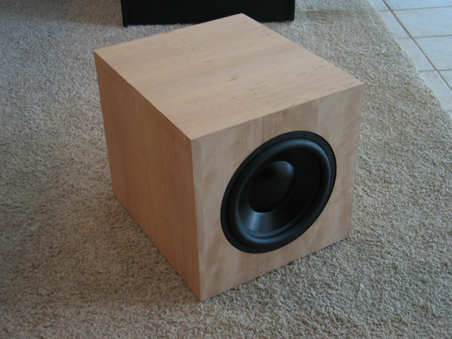

                                                                                          Crisis averted:
