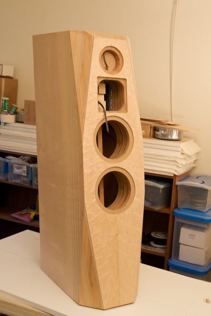

      It's coming along pretty well.... measure many times, cut carefully! Design it to be aligning as it goes together...

        There are some very special "rooms" reserved for those of us who are so meticulous with bracing, cabinet non-resonant construction, resulting two-man carry cabinets, etc, etc.
        Yes, one of the rooms in "One Flew Over the Cuckoo's Nest".
        Nurse Ratched will be bringing us our meds any minute now...
          Yeah, and I'm really getting tired of seeing that old crone!! And it seems the meds aren't keeping me from getting a bit cranky these days!
          But boy, are these cabinets solid!! OCD all the way!! 1.21 jigawatts won't phase these babies!
