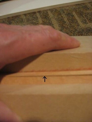

    I have this wonderful birds eye maple veneer that I bought for my Trilliums. The only problem with it is that it is very thick (perhaps 1/32 inch). It has two or, most likely, three layers of wood backing. This results in a rather conspicuous line at the corners (OK, go ahead, call me obsessive). Here's a poor attempt at a photo with the arrow showing the line:
    The only idea I've come up with to not have this line show is to miter the veneer at the corners, but I fear this requires precision way beyond what I'm capable of. I'm not even sure how I'd make the miter on each side, much less getting them to line up and be tight.
    Any other ideas?

    have you considered Hardwood edges....router out the corner
    and put maple into the corner...then either leave it squared up,
    round over it or Champfer.

      So, the problem, I take it, is the wood backing? If the maple itself is 1/32" thick, then why not stick the veneer, maple side down, to some flat wood with double sided carpet tape (might want to protect the maple with blue tape), and then pass it through a thickness planer to thin the backer until it won't be conspicuous? I've never heard of anyone doing this, but it sounds like it might work...
      You'd have to have it very flat, but given the thickness of the maple, you could probably sand out any high spots.
      -DWB
      • Paul Ebert
        • 434
        Yes, the problem is the backing. The maple itself is rather thick, but since it's the same color, it is not a problem.
        Hardwood edges could work. I'll have to think about it - it would be a lot of work given the Avalon style front baffle.
        It also occurred to me that there might be a way to crease the veneer over the 45 degree corners of the facets. I imagine I'd have to score the backing somehow to make this work. I've also considered buying some not-so-thick veneer for the baffles. For both these solutions, I'd still have to deal with the sides, top, and back, but maybe I could live with the line there (or use the hardwood idea).
        I wonder if there's a way to remove the backing near the edges? I wonder if a router could do that. If I could remove, say, a half inch of backing and then do some judicious sanding of the backing to smooth the transition of the backing thickness, perhaps that would work.
        It would have been nice if they had used similarly colored wood for the backing...

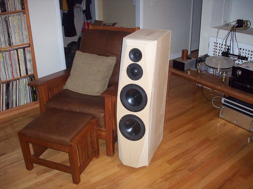

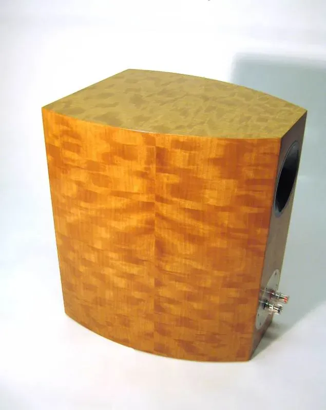

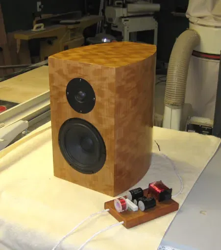

                            Yes, there are many differences in my opinion. First, I would never iron on raw veneer. Too much expansion/contraction in the veneer and cracks are very, very likely. Raw veneer is much more unstable than backed. In my early days of veneering I started with backed veneer, thought raw veneer was the exact same (and cheaper), so bought a bunch. I ruined a number of speakers and blew a bunch of money before I figured out the difference between raw and backed. You may have to seam some depending on species. Lately I've been buying stuff that is 10-14 inches wide, so it has not always been a necessity.
                            A caul system, or a vacuum system is the best and only way to go in my opinion. Though I still use PVA. The hardcore guys won't touch PVA, they say there is too much movement. Urea resins are what the big players are using. Unibond 800 comes to mind. I'm nervous to try it in my basement (odors).... Lately I have been using the vacuum system with great success. I bought the smaller pump and bag, which works great if you stick with stand mount speakers like I do. Attached is one of my latest projects. This pair I had to book match seam the side panels. The veneer is block mottle anigre...

                              Very handsome work.

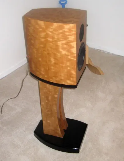

                                A very nice looking project; Paul's problem is that he has a rather large pair of speakers that would not be amenable to vacuum veneering at this point.

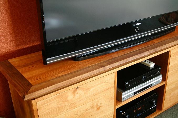

                                                  This is where I was a few years ago.... I decided to get a bag and pump that would allow a 2 foot by 8 foot capability. I recently had a project where I had some beautiful cherry and macassar ebony that I wanted to use for an entertainment center project. I've included two pictures... one shows the top (which is the cherry veneer with a "faceted" walnut border) the other shows a front shot where you can see the ebony as a dark band under the top. With a vacuum veneer press and pump this was a relativly simple project.

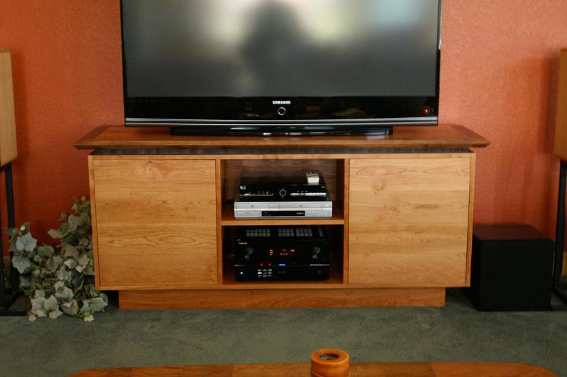

Name:	E Center.JPG
Name:	E Center Front.JPG
                                                  I'll be using this bag on my next couple of DIY speaker projects with a couple of "tricks" I'll pass on as I start to build.
                                                  Tom

                                                            My gosh, are you going to be busy!!! That Festool looks pretty nice. :T
                                                            My Ryobi setup (BT3100 + 81829) can do 3-1/2" cuts, so we'll see.
                                                            IF all goes as planned, I'll even be bringing them out to Denver during RMAF in October so maybe you could come out and critique them. :W
                                                            That would be fun..... I'll bring some of this for you and ThomasW.
                                                              • 16170
                                                              You have NO idea.... everyone should learn a lesson here...............
                                                              Tom's wife (looking at furniture at local high end store): "Sweetie... we need a new entertainment center for the family room"
                                                              Tom: "Whatever"
                                                              Tom's wife: "What do you think of this?"
                                                              Tom: "$4000.00 for something that isn't even solid wood!! Heck I could build you something twice as nice for one tenth the cost!"
                                                              I now have close to 10 "projects" in various stages of development for various family members. I should have kept my mouth shut.....................
                                                              Colorado "Where'd all my free time go" Tom
                                                              And as Paul Harvey would have said, "And now you know the real story!"
                                                              No good deed goes unpunished, you know....
