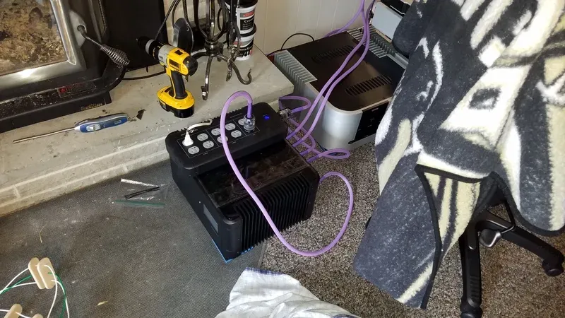

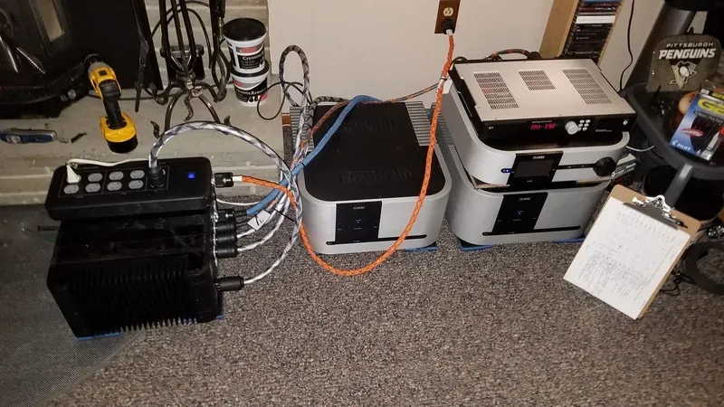

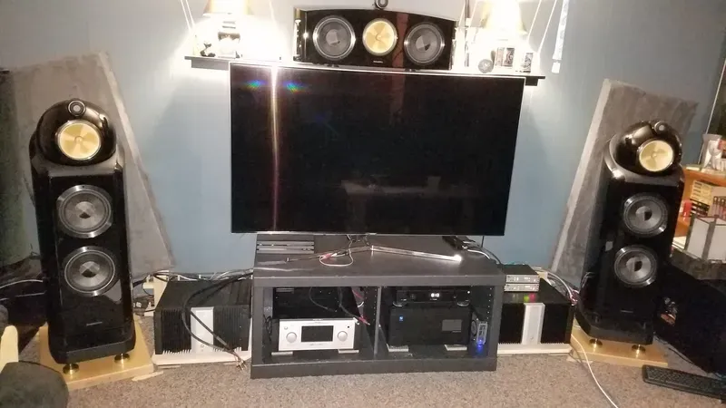

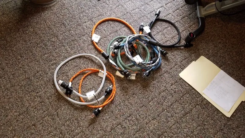

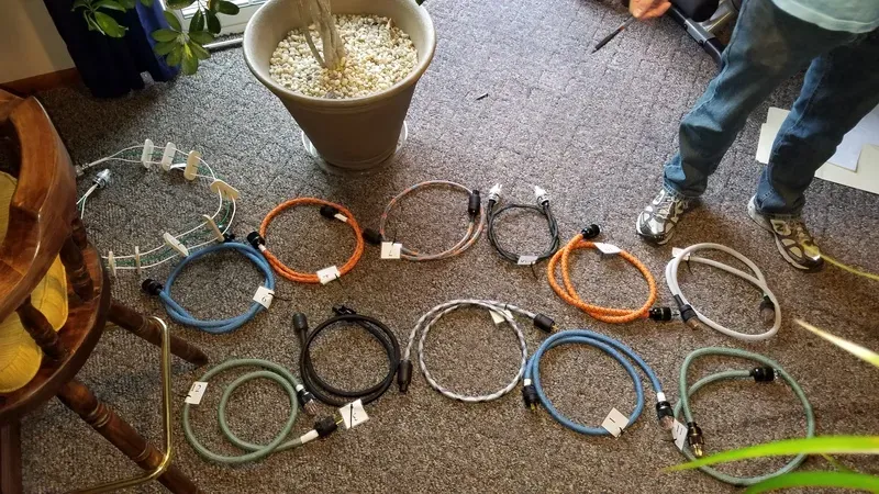

    so yesterday my gang conducted a power cable test session.
    over the last few months we designed & built various pc's (power cables)
    some were hand wound from various types of spool wire including pure cooper, silver tinned cooper & various gauges.
    various jackets, shielding were also used.
    some were just commercially available finished cable like Cardas & Neotech, which we terminated with plug-ends.
    various plug-end terminals, from solid cooper to rhodium, to silver or gold plated cooper were used.
    others were fully assembled audio brand, Signal Cable & Nodost, et.al.
    four of us did a double blind evaluation with the help of a V tolerant & understanding wife of one of the participants.
    each of the 12 cables was evaluated as we played snippets of 6 different tracks of muisc varying from orchestral, techno, jazz, a Capella, et, al.
    the tricky part, as found after the test, was that rating the cables performance was somewhat difficult from the standpoint of individual tastes.
    for example while a cable would display obvious differences, those differences may have been pleasing to some, but considered deficient to others.
    any way, we learned a lot.
    about how complicated developing a test plan is along with an evaluation criteria is, to how much & little difference there can be between cost & overall performance.
    we are going to spend a few weeks analyzing the data & modifying the testing methodology, then give it another go.

    Sounds like you guys had a fun time .... out of curiosity what's in the walls behind the receptacle, upgraded wire, dedicated circuits, etc ...... I'm always curious how changing power stuff in the room interacts with what it's connected to. You never see much on that side of things.
      The house has the original 15 amp service.

          Indecently, Dan will be running two audio-dedicated 20 amp lines in the V near future. The recent acquisition of two mono-block Classé amps has made that a requirement due to the higher current demands.
          one quite surprising detail regarding our testing.....
          we used Dan's PerfectWave P10 Power Plant.
          it takes the AC input, converts to DC, then back to a 'clean' AC 60 Hz sine wave.
          we inserted the power cables between the wall & the P10 & still were easily able to recognize differences. :scratchhead:
          edit added:
          the equipment we used for the testing was B&W 802 D2 speakers, the Classé CA-M400 mono-blocks & CP-800 pre, & the Bricasti M1 DAC fed by Dan's custom-built NAS music sever.

                        Boy it looks messy! ha ha.
                        Yes the house wiring is just the normal wiring in the house, nothing special. The only benefit of what we did is the wall outlet the classe amps were in is the same line as the normal home theater where the other PS Audio P10 and Media PC is plugged in. So "essentially" it's all the same line. I can't wait for the two 20-amp lines to get done... hopefully in the next month or two.
                        Our testing basically (or our thought no testing) was that we would make everything behind the P10 regenerator the same cables (the second picture with the Purple BlackSandsAudio Violet Z1 MK2s 1.5m) as it was either using those or Nordost Red Dawn 1.5m... since those were the only ones we had enough of. I don't like stock cables so we decided to not compare against those. I've done enough to know the stock cables are never too much quality. I do wish PSAudio would throw in one of their better cables with the P10...but I understand that's a cost to do that.
                        The most interesting thing to me was that out of all of our designs, there was no clear winner, we all liked different cables as our #1, but in all of ours (though early analysis) we were pretty consistent on our picks that the top 5 cables made the top 5 and both 5 made the bottom 5. Well except for Bill, we learned that he graded cables somewhat differently and/or hears differently then the other three that listened.
                        If you look at the last picture the cables were ranked from left to right top to bottom in the picture (except for the 3 wire with maple spacers) which we all agreed was the worst of all of them...which was a design Bill was hoping would be good... so we feel bad about that.
                        The take aways we have from this is:
                        - Power cables don't sound all sound the same.
                        - Power cables aren't "better or worse" - they are tone controls in how they effect one's system.
                        - There's no "best" way to build a cable (I think there was a total of 6 different build styles).
                        - Quality of the copper doesn't seem to signify quality of sound.
                        - Why changing a cable in front of the regenerator changed things, is somewhat of a head-scratcher as to why it does.
                        - It may be better to test on a single piece of equipment, however my initial test before in my system this placement (between the Surge and P10) made the most noticeable change.
                        Overall this was a fun experiment (still on going) and it really brings some ideas into my head how to "maybe" produce a better cable at a very reasonable cost.

                                    3) A synergy of the type of connector (metals used) to the metal used in the cable is where we seem to find the cable we all prefer the most.
                                    4) Power cables are definitely a tone control very similar to interconnects when we talk about copper vs. silver.
                                    5) Shielding definitely is a key factor in the construction and killing off unwanted noise and interference.
                                    6) Ferrite core filters on a cable can have a positive effect on a cable.
                                    There are probably other observations we made, but it's getting late and I'm sure I'm forgetting things.
                                    We did find out that we ended up liking two types of cables the most and for the cost to build them oneself, they can definitely compete/best a higher priced cable. We are at least at the moment seeing performance in the range of 4x the cost of building the cable (when we compare against those cables that we have... unfortunately some of the really nice and exotic cables we can't get our hands on to compare to as we are just having fun and limited to what our "play fund" allows.
                                    Over all this has been a very entertaining experiment and I have definitely raised the level of performance of my own system with what I'm using in my system now. Which means I'l l be having some nice cable sales in the near future to recover the cost of purchasing cables that I do really like, but can build better for cheaper.
                                    Who would've thought power cables can make such a difference in one's system.
