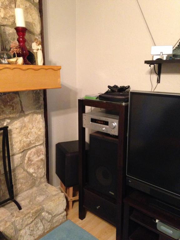

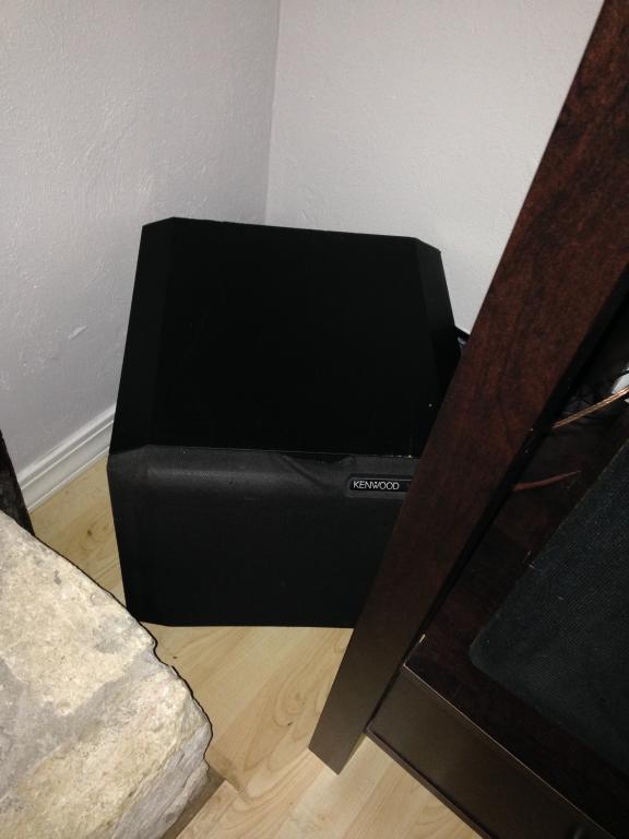

    sub placement problems

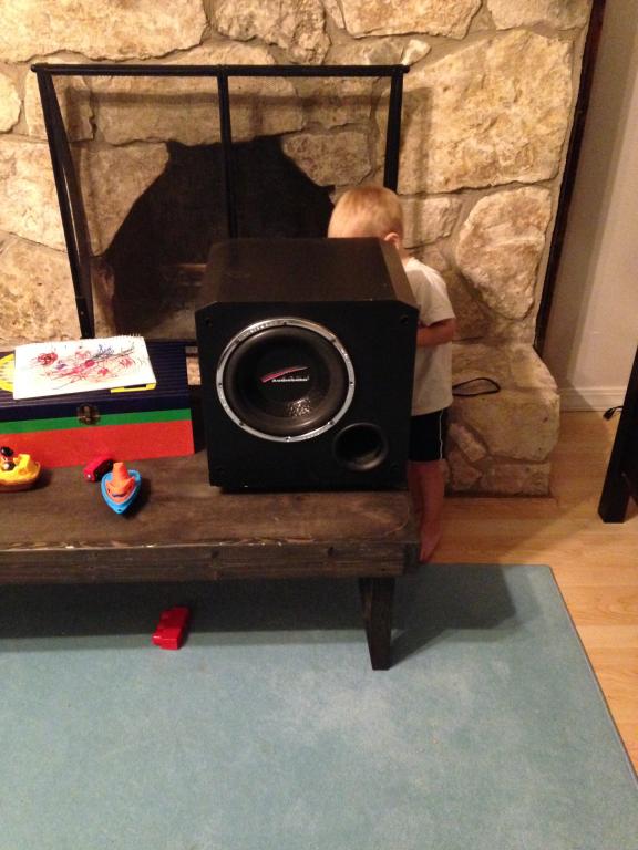

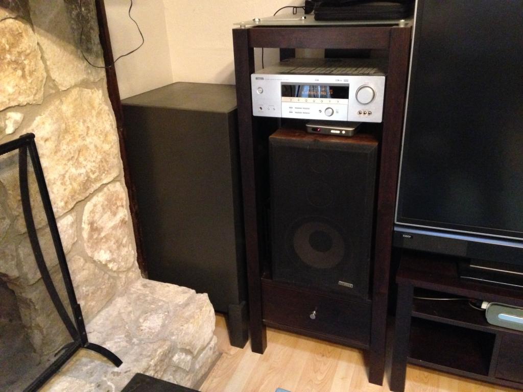

    I am having issues with my sub placement. I understand that I might be out of luck and will have to make do with what I have but wanted to run this by and see if anyone had any suggestions.
    The only space I have available is a corner of 22" by 22", problem is that due to the shape of my living room I dont have much option on where my couch goes and I believe I am in a null. Everywhere else in the room, or house for that matter, you can hear the bass rather well. I wish I could move the sub but WAF and toddler is prohibiting. I tried raising the sub off the ground to see if it would change anything using scrap wood. That seemed to help just a little but not enough. Eventually I would love to do a Sonotube Sub but I fear that it would be in the same predicament.
    Any suggestions?
    Corners tend to be the best place to put subs so you're on the right path with that. When you say you're sitting in a null, what you really mean is that you're probably sitting in a null for one specific band of frequencies. The best way to solve this kind of thing is to get another sub and to position it elsewhere to fill in the null. If you move the sub to give you better bass in one position you are obviously going to make it worse in another. If you can measure and find out where in frequency the null occurs, then you will be better primed for fixing the issue.
    I say the last thing above because the second sub, by no means, has to be a large thing. If you're problem is occurring at around 40Hz, then you don't need any more extension than is required to fill in the gap. A simple, small sub built around one of tang bands 8" sub drivers might be all that's necessary. Certainly having one main sub, that gives you really deep bass, in the front corner + a couple of small, well placed, subs with much less extension to fill in the gaps, is the way to go if you can accommodate them.

        So thinking about what I could do about another sub placement, just playing around. I know most people put subs low towards the ground mostly because of the size of the subs themselfs but if I do use a 8" in a smaller enclosure would sticking up ontop of a shelf cause any issues accoustically? An 8" sealed enclosure should be fairly small just need more power I suppose.
          There's no issue with doing that at all Unless it makes the thing it's placed on rattle!
            • 16194
            The unfortunate thing is, you have placed the sub in a quite optimum position, so if you're getting issues with your couch and listening position, it's most likely that which needs to be changed! In the old days I'd fire up a PC program RPG acoustics developed which allows one to analyze and optimize both the speaker and listening position characteristic for a given set of room dimensions and some boundaries for placement. If you could get a cheap measurement microphone and some freeware software like ARTA, it might be illustrative to do limited range sweep measurements of your sub (say, 20 or 30 Hz to 100 or 200 Hz) in a variety of positions in the room near your acceptable listening position. Might be very educational...

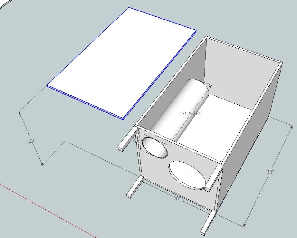

              Thank you for the ideas they are most helpful. I have been going design crazy trying to figure out what can I do with the most bang for buck. I know I should really get a mic but this has been a lot of fun for me.
              Going the 8" route does seem mighty enticing but I did not like the look of the sealed specs, not saying they are bad just was not for me. This is a design around the Infinity ref 860 which seems to get fairly good reviews and not costing an arm and a leg. Took me many hours to learn it but I think I got it down.
Name:	infinity ref 860.jpg
              Going that route I would have to buy the driver and the wood. Just playing around I decided to design a box around a car audio driver I already have. Even though its not as efficient and huge! it actually gives me a little more flexibility on room placement because it is down firing. It also has the added advantage of being a box specifically designed around the driver and not just thrown in as a replacement because the original driver needs a replacement surround ops:
Name:	audiobahn 10 downfiring.jpg
              I am still learning a lot every day and I appreciate the feedback that I have received, thank you!

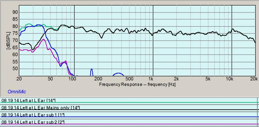

                                                  Originally posted by Tomato
                                                  So I made a cd of 10hz to 100hz and to be honest I should have done this in the first place. Playing each hz at a time I stood by the sub and from 30-90 no problem. I did the same sweep sitting on my couch and pretty much the entire 40's are gone . Its quite interesting to me, I can pretty much draw a circle on the ground of where the null is so its rather easy to sit outside that area. The problem is that the null is right in prime sitting position (of course it would be). I guess I do need to subs :W
Name:	FR today.jpg
                                                  (1/24th octave smoothing applied)
                                                  My mains (black) are quite capable of good response below 45hz, but the room null starts there and down to about 30hz. Sub1 (blue) primarily I use to fill the gap so speak. Sub2 (purple) for just a tad more smoothing resulting in the composite or overall graph (green).
                                                  These are all measurements at the listening position.
                                                  Just my story and antidote to something similar as you describe.
                                                    I would say that in most standard sized rooms that 40Hz is probably where the last main room mode is. Excite it in the wrong way and you get booming bass, get a null there and get nothing ;/

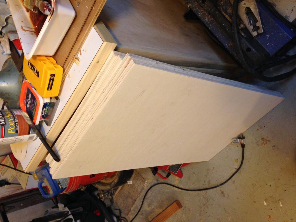

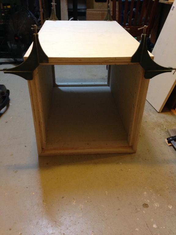

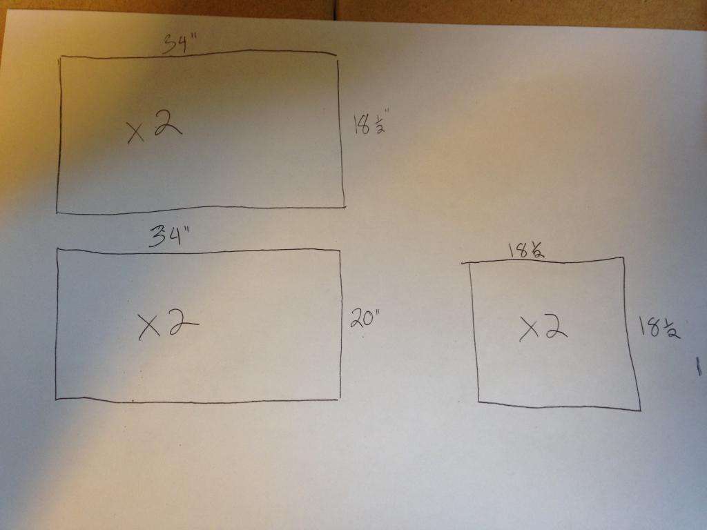

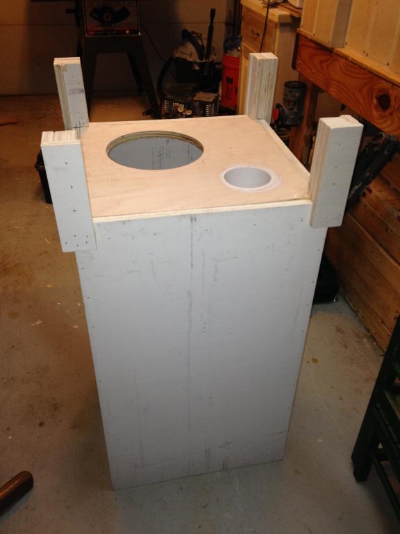

                                                      Many moons have passed and I finally got a sheet of plywood.... for free! Well I worked for a friend and he paid me in plywood. I decided to go with the second plan above due to cost. This will have to be a super cheap build due to school and work and school cutting into my work hours but hey! It will be good.

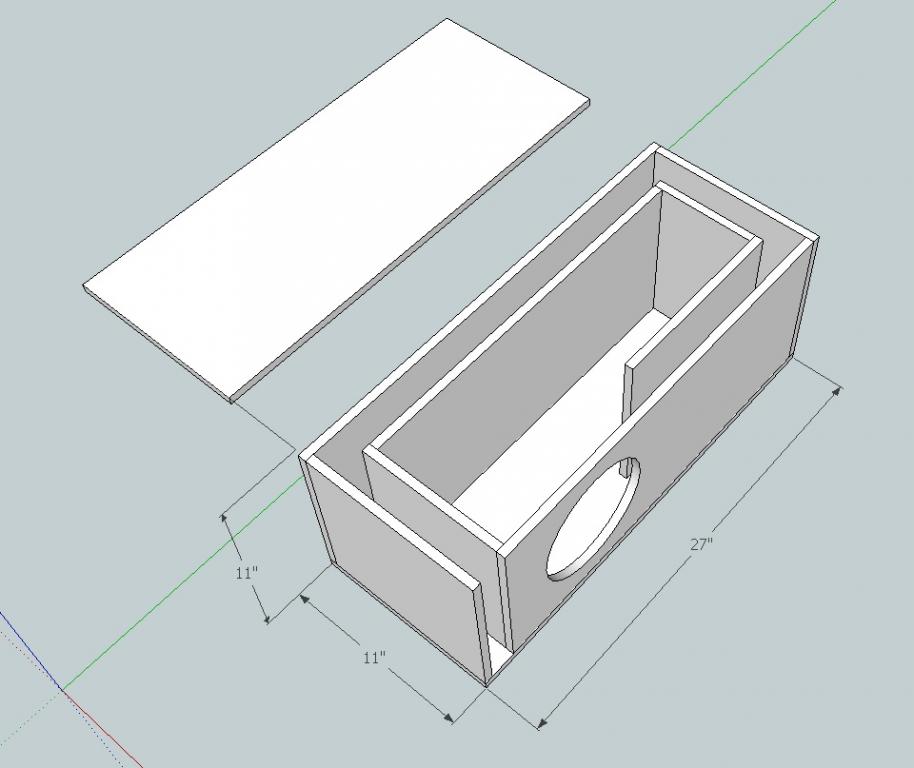

                                                      Drew up super complex plans!
                                                      cut some wood

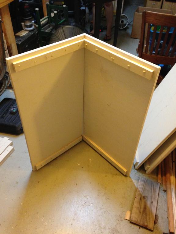

                                                      started to put it together

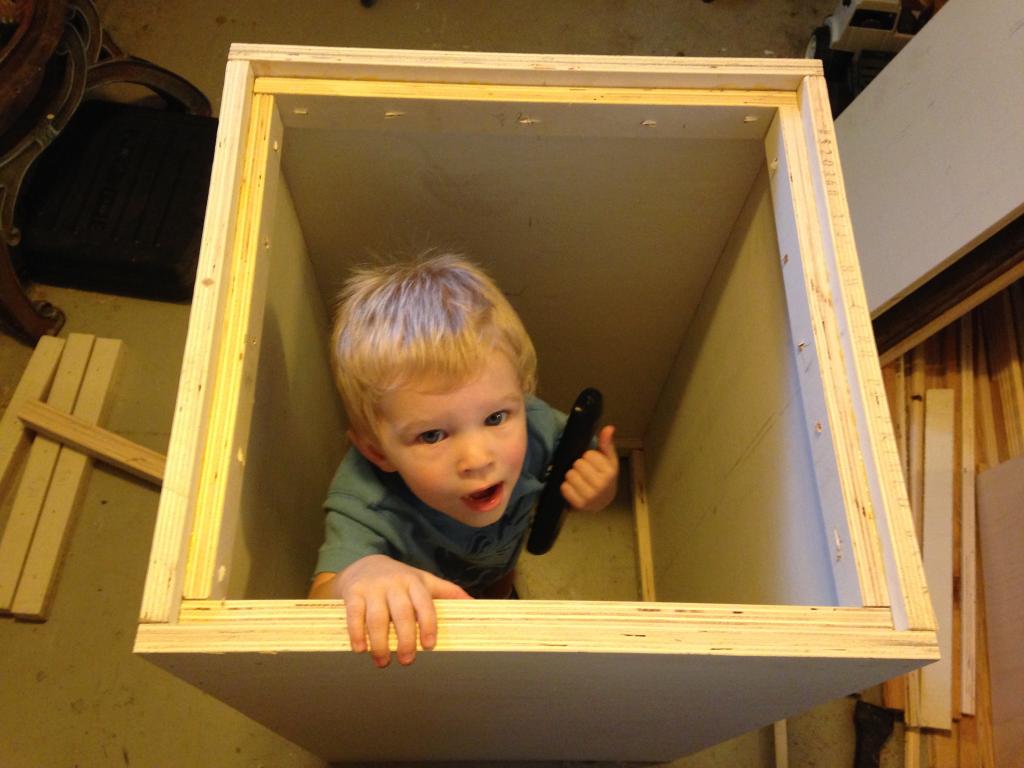

                                                      Threw kid in

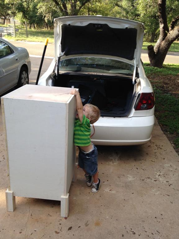

                                                      So its considerably bigger than that cube I have currently. I had to make a small adjustment on the port though, apparently 6" pvc pipe in my area is only available in 10ft sections at $45 and when I only need 20" of it I opted to go a smaller diameter. Adjusted the port in Winisd and using a 4" id port I just need 7 5/8" and I was able to get a 2ft section for $8. Much better on wallet. More to come!

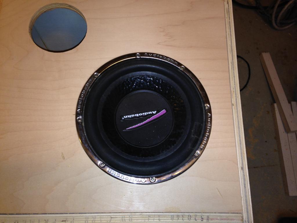

                                                              home made circle jig, because cheap!

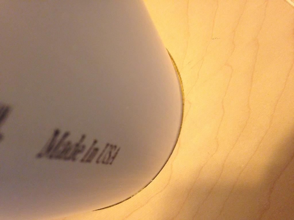

                                                              test fit, it looks a little loose in the picture but I made the circle 1mm smaller and its a perfect fit, I had to hammer it home when it was done.

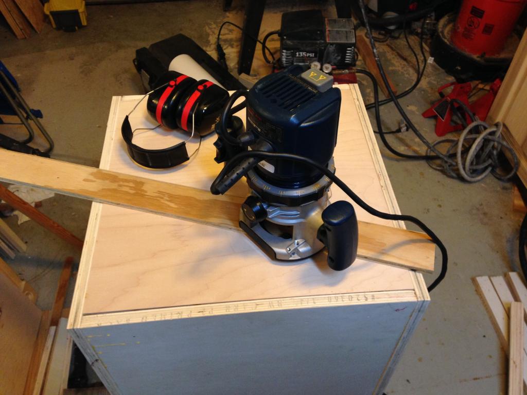

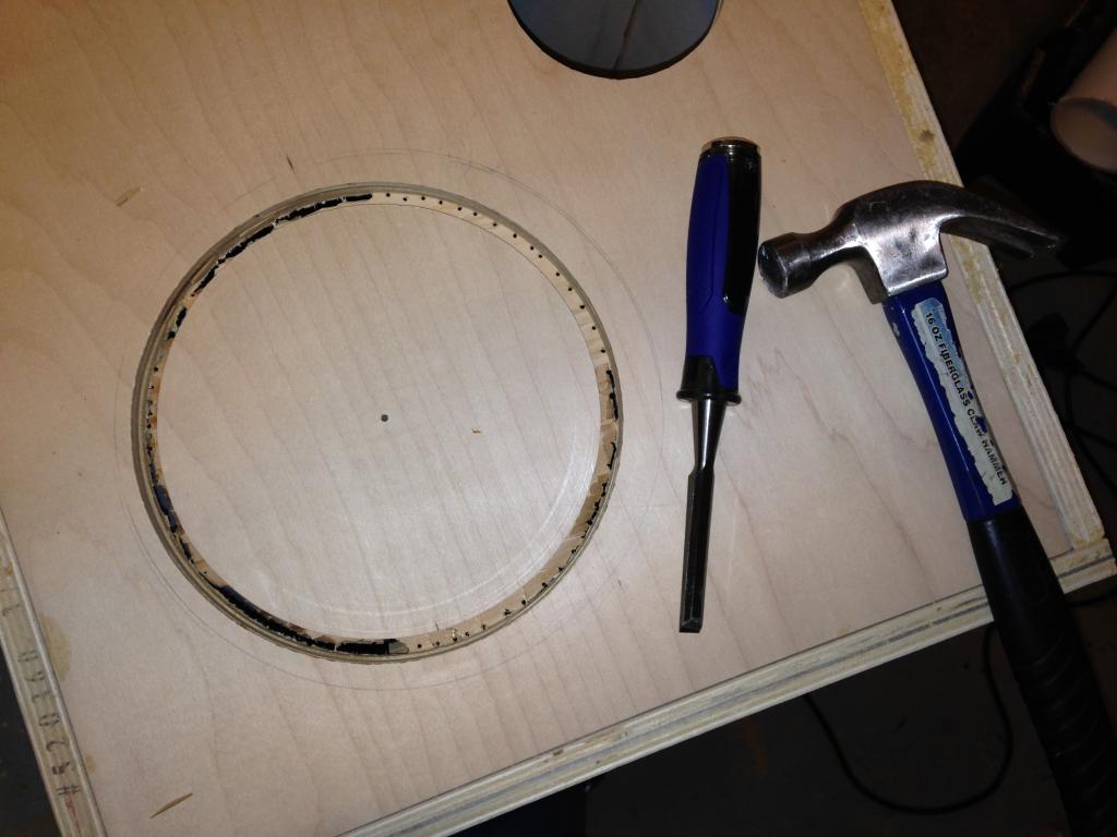

                                                              my router with the home made circle jig was just shy of going all the way throught the 3/4" ply so I just decided to drill a bunch of holes and chisle/hammer it out. Hindsight I should have just pulled the bit out just a wee bit to go through but sanding took care of the tear out, and oh boy was there tear out ops:

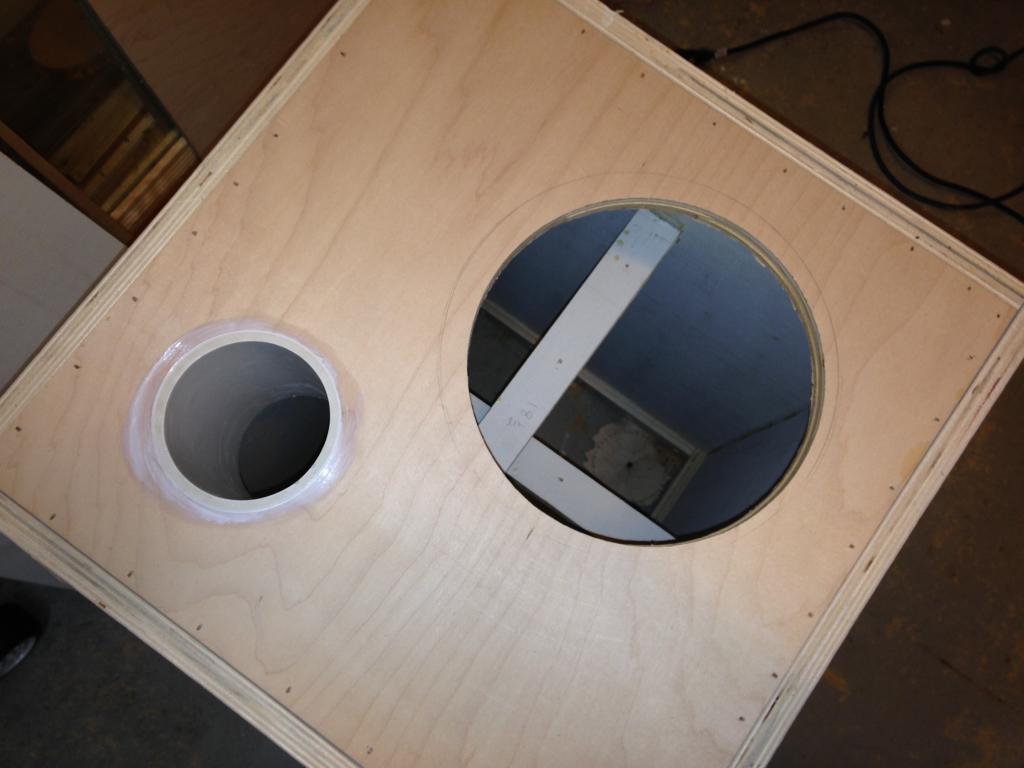

                                                              here is the car audio sub just layed in for a fit. It just needs a bit more sanding and it will be perfect. For this sub I am not going to double baffle or anything, again I just dont think its worth it in this situation. Also you can see some bracing in place, there is more but I ran out of wood glue.

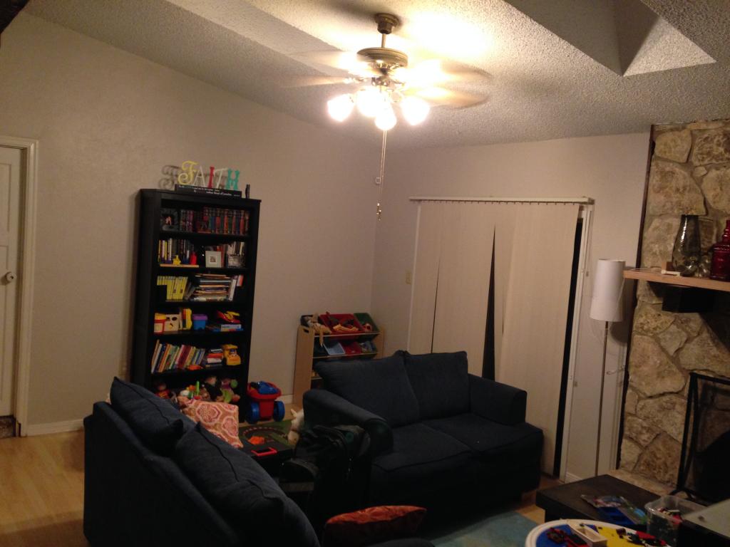

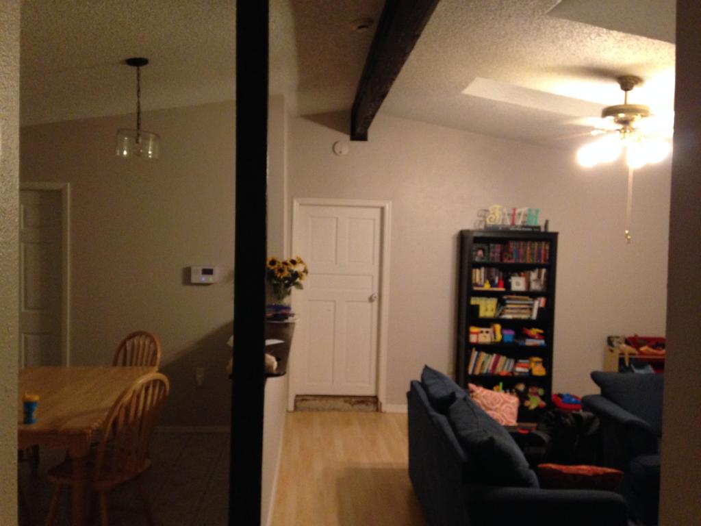

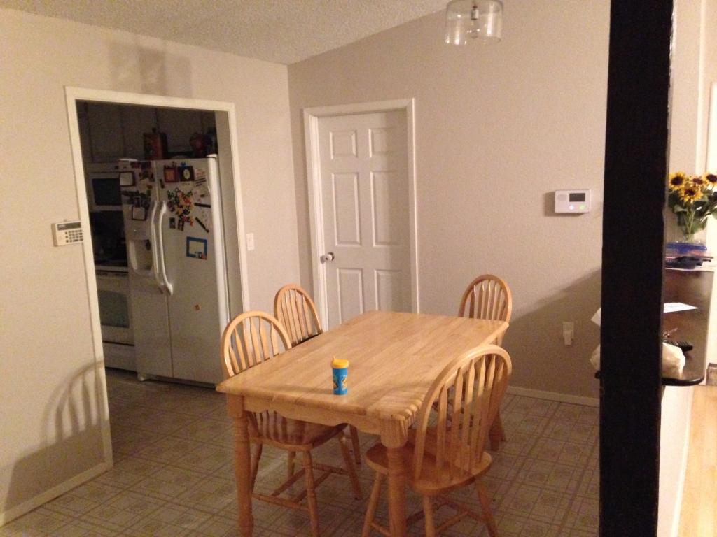

                                                                    Here are some pictures of my living area ( sorry for the poor quality ) and I totally forogot to get measurements.
                                                                    This is a picture from the hallway, you can see the half wall and there are skylights above the couches
                                                                    This is just a more detailed looke at the living area, it is a drop down ( wahoo :cry living room with terrible fake hard flooring
                                                                    also that black bookshelf in the back was the original idea to put a small sub up top

                                                                    And here is my tiny dining and amazingly small kitchen everything hard laminat flooring. But not bad for a first home and surley not bad for one under 100k
                                                                    so for sure there are alot of reflections and I dont know how much I can do about them but any suggestions would be appreciated.

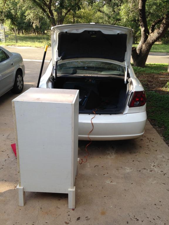

                                                                        So close I can almost hear it.

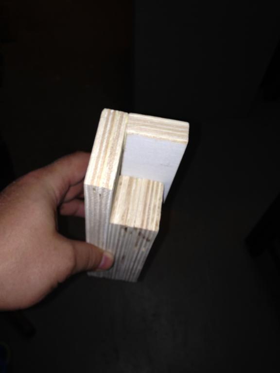

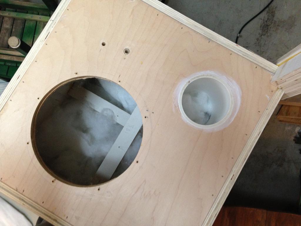

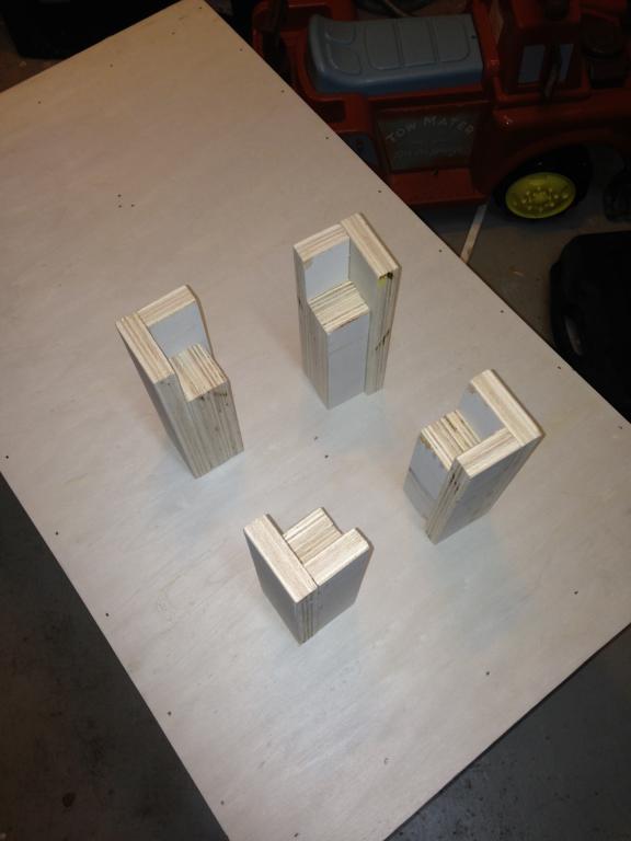

                                                                        I didnt know what to do for legs so I played around and came up with this solution. looking back at it I should have made it bigger but this will support it no problem. I cut a few strips of ply

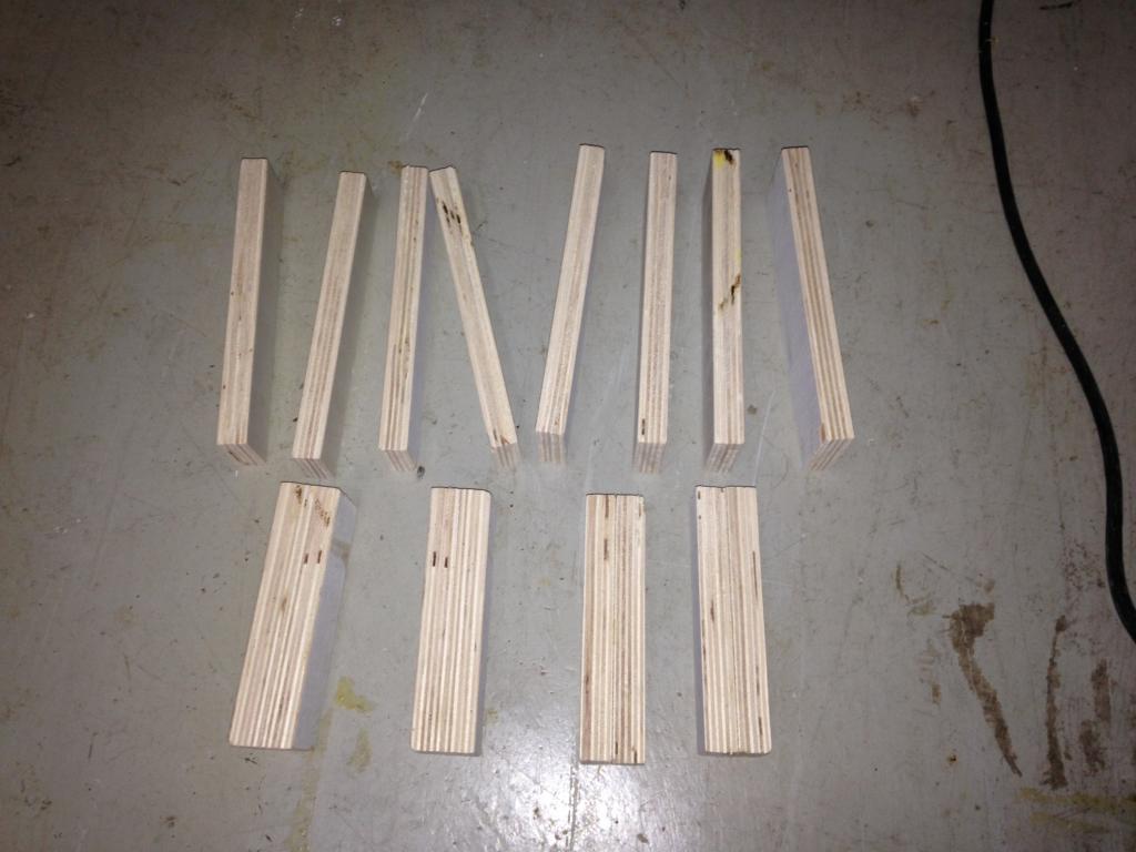

                                                                        Then I attached like so ( this is where I would have made it bigger, the shorter pieces should be wider so I could screw from the other side, not much lateral movement so it shouldnt be that big of a deal)
                                                                        all four made up
                                                                        and then glued and nailed
                                                                        Just need to finish sealing and stuff ( should have stuffed while one end was opened ) and then wired up! I cant wait!

                                                                              As expected, you have a complex room with a mix of highly reflective and highly absorptive elements.
                                                                              Screen axis (assuming a flat wall behind you) is "stepped" by the back wall in the dining area, so you should expect room modes supported by both dimensions. It's a small step, so these modes will blend together
                                                                              Cross axis is worse than stepped, it's divided; the half wall will reflect off both the side wall and the dining area wall, as well as the full-width reflection above the half wall, and an even longer path through the kitchen, that could add some room resonance itself. Expect modes based on each segment, low living, low dining, combined and kitchen. There's also a strong asymmetry in the side wall; the fireplace reflects sound very well, while the glass doors are a true bass trap, allowing bass through but reflecting higher frequencies. Vertical blinds help damp the higher frequency reflections.
                                                                              Vertical axis has no single distance due to the tilted ceiling. As for the step, the effect is to broaden resonance peaks.
                                                                              Walls, floor and ceiling are basically bare, save for the seating area around the fireplace. I would expect this room is too bright for comfortable conversation... have you done a "clap" test? Clap your hands once, very loudly, standing in the middle of the room and listen to the decay. The clap should die so fast it's hard to sense, but I expect you'll hear it continue for a second or so.
                                                                              Your area rug and couches (fabric upholstery I assume?) are the main room treatments above bass, with the glass door and couches helping damp the bass range.
                                                                              If that's an accurate description...
                                                                              Try generating a little WAF by starting with the "clap" test and conversational needs. Higher frequencies are easily treated with panels, and panel appearance has a lot of artistic options that may appeal to her tastes, as well as making the room easier to live in. If she's willing, the obvious locations are the front and rear walls, above child level, and the dining area. You'll be amazed how much easier it is to talk in a properly treated room! Hang them like art - center of the wall with lots of space around them, perhaps offsetting opposing walls. Don't crowd them unless there's opposition to spreading them out.
                                                                              As to your issue with the 40's, 40Hz is 14' and 50Hz is 11' half wavelengths. That looks about right for the ceiling, but... there are a lot of walls that are close to this distance or an integer multiple. I can only suggest repeating your test that identified this frequency range as a null, but varying things like doors, open/closed, especially the glass door. See if you can find the resonance that's driving the null. Then we can talk about sub locations that would minimize that resonance. It could be as simple as moving the sub under the display, but I hesitate to recommend anything in the absence of more information. I see lots of opportunity, waiting on a need.
                                                                                to which my son thought it was a trashcan and tried to thow away some trash
                                                                                which is good....I suppose :lol:
                                                                                This wasnt finished being sealed and no stuffing at all, but I can say that it sounded rather well. I could for sure see in the future or if I ever did this again to use a double layer of walls. I think thats the best thing that I could do for it. Other than that I am very pleased and cannot wait until its finished!
                                                                                • Tomato
                                                                                  • Apr 2012
                                                                                  • 27
                                                                                  So I did a simple clap test and I found it interesting. The only decay that I could really notice came from the hallway, there was some that I could discern but probably all over but the hallway was the largest audible source. I guess that since its just a box with hard floors and parallel sides it makes sense. I am scared to even mention wall treatment to my wife ops: lol but I will see what kind of coaxing I can do, probably will be turned down but cant hurt to try
                                                                                  So stuffing, I could not find any friend or anyone with a little insulation that I could source, but I do have a body pillow and a regular pillow that I could use. So I went that route, only because free. Having messed with pink insulation alot over the years I tried to think about how dense it is and the quality of the fibers, with that in mind I tore chunks out of the pillows and just threw it in. I used up both the pilows and it filled 3/4 the way full which I think its perfect. I just gave it a small amount of packing. My theory of using chunks of pillow it wont fall out of the port. Getting pushed out is another story I will worry about later :P
                                                                                  so this is the orginal sub where I just threw in a random car sub. I took the sub and the plate amp off of it, the new box is specifically designed for the sub. I used the plate amp and I knew it would be sufficent for my needs.
                                                                                  and Bam! its new home.
                                                                                  To give a quick difference of sound: The small cube is like a sorbet, the big box like a custard. While they are both sweet the sorbet is sharp and leaves a tang in your mouth but the custard so silky smooth and leaves your mouth wanting more. Sure it can get loud but the whole point of this adventure was to build something for quality. Designed for a purpose of cleaning up the sound. Learned a few lessons for my next one (hey I still have 2 more subs) and will for sure build it better. Just now need to get a mic with proper software, wall treatment, proper amp for sub(s) and finish up my surrounds and I think I will be good for a while
                                                                                  • fbov
                                                                                    • Jun 2008
                                                                                    • 479
                                                                                    Nice pics... and so lots of comments. And no issues with workmanship; nice looking sub!
                                                                                    1) you've misunderstood the interior treatment of ported boxes. .
                                                                                    - line the walls, leaving the resonant cavity open. You've shown how to stuff a sealed box...
                                                                                    - make sure there's nothing near the port mouth, for at least 1 port diameter in all directions. You can stuff around the port, just not near the mouth or the driver.
                                                                                    The idea is to absorb any frequencies above ~80-100Hz inside the box, as they're likely harmonic distortion, while allowing the box to resonate at the tuning frequency, say 30Hz. Think in terms of the box breathing, inhaling and exhaling, 30 times/second. The bigger the flow, the louder the port, so avoid anything that messes with air flow. That's one big reason for flaring port ends. Yours could use a roundover bit run around the inside of the port mouth, the bigger the better.
                                                                                    2) Subwoofers need to be well coupled to the room.
                                                                                    Yours isn't. Stuffing differences aside, did it sound different outside being driven by the car amp? Think in terms of pressure waves coming off the bottom of the box. Where does the air go? Three of four sides are walls, forcing it straight up, and effectively adding a randomly varying horn loading to the mouth of the sub. This should tend to favor lower frequencies, and may be a factor in smoothing the response, but the LF response is already muted due to port blockage. I'm not saying this is a bad thing, per se, but rather hope to make such things choices, rather than outcomes.
                                                                                    3) Clap test will vary with your location
                                                                                    The classic location for "flutter echos" is stairways, where you have wide expanse of bare, parallel walls. Hallways are similar. The key is that the main listening room has reasonable decay, which most furnished rooms will. That said, the difference between, say, 0.5 sec for a 40dB decay and 0.25 sec, is not gong to be evident in a clap test, but you'd notice if it were a second or more... it finds the really bad, not the marginal. You now know you're not really bad, but it'll take measurements to find what could be improved, if anything. I've done no room treatment, and spent years figuring out why not... and found I had treated the room by furnishing it, although base construction methods helped a lot (stick construction, not cinderblocks).
                                                                                    HAve fun,
                                                                                    Frank
