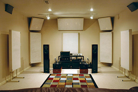

    Use the search- this has been talked about before- and consider artwork perhaps on the cloth outer surface to make more esthetically pleasing? Of course, while some folks would tolerate rectangular off white panels a few inches thick hung on the walls in critical locations, you wife may not. What are her limits/requirements?
    This article will give you some ideas about what does work and wouldn't be hard to DIY using the techniques ThomasW and I have employed in the past.
    RealTraps Room Treatements Stereophile
    Sidewall treatments are positioned to be where early direct reflections will occur from the source- if you put a mirror on the side wall, and you can see the speaker in it, that's where it needs to be.
    There is also the concept of LEDE to consider, as with studios - Live End Dead End, which translated basically is that you want to kill early high level reflections near the speakers and keep the acoustics more "lively" at the listener end of the room. That may be a little more advanced than you want to get into, except you should be familiar with the concepts- if you put all your damping in the listening end of the room, you won't be happy with the results.

              Ahh leather furniture...unfortunately, I've been there done that. Here are a few things that can help.
              *Very large throw pillows on the sofas and floors.
              *Throw a thick blanket or quilt over the back of the sofa when listening.
              *Sneek "your" chair into the sweet spot so that you don't have leather close to your head.
              *If you have drywall over studs, make deep absorbers by cutting away the drywall and using the space between studs.
              *Use diffusers on the wall areas behind, and directly to the sides of your head.
              Paul

                            Very nice room you did!! I am extremely impressed!
