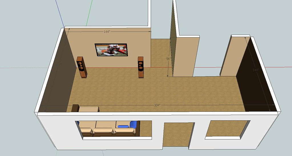

    So I have been doing a lot of reading and keep flopping around between building a pair of the Nat P's, Statement Monitors, RS TMWW Towers, or Zaph ZDT3.5's. However, I am a bit concerned with what will best fit my room? As we have only been in the house for a year and a half, we do not plan to move anytime soon. I am in the process of finalizing the design for my new media bench/entertainment center and will likely begin building that after the 15th.
    Notes: Room opens up on far right to kitchen, hallway leads to rest of house. All ceilings are 8ft tall, flat ceilings (there is no vaulting).
    Here is my Google Sketchup of the room with some of the furniture (media bench will go between speakers and be 70"L x 22"H x 18"D). Information on the build can be found in this thread (sorry haven't updated recently with new design)....

    I have a suggestion that would apply to any of your choices. If it is possible and amenable to your living environment, it would be preferable to rotate your setup 90 degrees, with the TV and speakers on the long wall (167") and the sofa in the open space between the living area and the dining area.
    The reason for this recommendation is two fold.
    1. The speakers will have similar boundaries on the left and right side, making the reflected field response more similar and improving the imaging of the speakers.
    2. The couch will not be on a boundary, which degrades both the bass performance and spaciousness of the perceived sound.
    -David

          Unfortunately, I have already tried that but the WAF has given a negative for that... Also, the couch that is in there, while L-shaped like ours, is not the right size and the left side comes out about another 18" towards the speakers.
            I anticipated that. We'll proceed knowing that it can sound good, real good. Just know that it won't be audiophile-theory perfect. My room isn't perfect either.... it is what it is.
            Of the speakers you're discussing, I see insignificant differences in the way they will interact with the room. They are all solid designs. Each have minor trade-offs. And then each has minor voicing variations due to the designers.
            To break them down in BROAD OVERSIMPLIFYING TERMS, lets look at the NatP versus the RS TMWW. We'll the Nat P has two 7" midrange drivers versus 1 6" Midrange. Theoretically, this will give the NatP more output potential in the frequencies handled by the midrange driver. It should be able to play louder, cleaner. The NatP not having dedicated woofers might start to eat into this advantage as the midrange is asked to play bass, but once you introduce a subwoofer this negative is gone. But, without a subwoofer the RS TMWW might start to produce a littlemore distortion in the midrange, but they will have a lot more bass capability due to the pair of 8" woofers. Pick your poison. Tweeter is basically the same.
            The Zaph ZDT3.5 is similar to the RS TMWW. It has a lesser quality tweeter, but still a good one. The mid is a extremely low distortion (high quality) 2" mid dome. It is used over a much smaller range than the mids in the other designs, so it isn't pushed as hard and capabilities acceptable. Then it has pair of 7" woofers (the same used as mids in the NatP). So, probably has great mids and good bass capability, but probably not quite as much spl and depth capability as the RS TMWW.
            The Statement Monitor is a bit of a different beast. The others all used basically Dayton RS drivers and dome tweeters. To start, the Monitor has a ribbon tweeter. Some love them, some don't. I thought the statements sounded good. It has a single smaller 4" midrange, so it won't have the SPL capabilities of the previous two designs here. But it is a very high quality mid, nice sounding mid. Many prefer the sound of it to the RS drivers. The bass is provided by a dedicated 7" woofer. So, it has some advantages over a simple 2-way in capability to reproduce, but looses some to the systems with dual woofers. And not to be forgotten is the magic in the open back mid. I hate descriptions, but I would say the Monitor is a step up in quality but down in pure spl capabilities. Not a speaker I would choose for a frat house.
            But, I've seen people quite happy with a simple 5.1 system consisting of a simple 2-way TM using a 6" woofer. So, I would hesitate to get caught up in making spl capabilities the ultimate factor. I think all of these will fill that room well enough.
            I don't see your massive subwoofers shown in your sketchup. Subs are a must for movies - period.
            If you can't decide, and can't find anyone to listen to theirs. Put the list on a dart board and throw. You can always build your second option in two years, when you have to scratch the itch again.

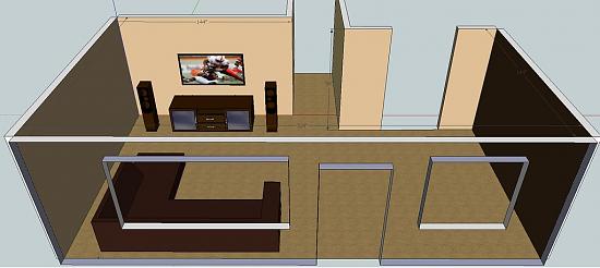

                      Here is an updated version of the front room with a corrected version of the couch and media bench added.

                        I agree rotating the room 90* for imaging across the front, as well as gaining space behind (a different) sofa or chairs, would be much better than band-aids...but... The reflective surface of the wall and window so close to your head is also problematic. You don't want a diffuser across the window, so maybe thick/heavy curtains would be better than nothing. Maybe a nice (deep) decorative absorber or two on the left side of the room.
                        What is in the rooms outside the interior walls? You might be able to gain some WAF points with an IB sub firing into an adjacent closet/room, ceiling, or basement/crawl space.
                        Rather than spend money on room treatments, consider a jewelry purchase :W

                          The windows actually do have relatively heavy, old full fabric curtains that I am sure will do a good job of diffusion. Again, the rotation of the room is a no go but I may "attempt to see how things look" when I build the new media bench and move everything around.
                          So from what everyone is telling me, should I not be able to do the room rotation, I would want to do either a pair of the Nat P's (budget) or RS TMWW (Mid budget) for speakers, and/or possibly wait for the Ansonica's!
                            Hang on... why are building a media bench? It appears the TV is wall-mounted, in which case you have no good reason for such a bench, but plenty of good reason to NOT build it (it would limit you to the far less ideal horizontal center channel placement for one)
