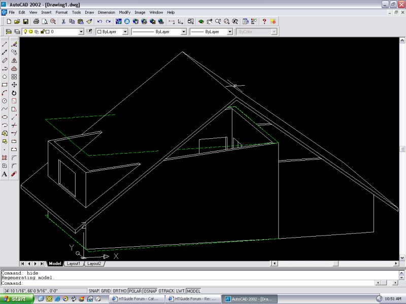

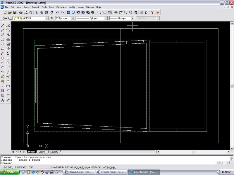

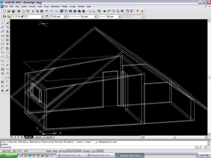

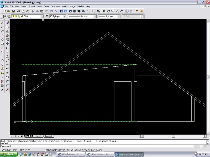

        Well from the limited amount I know, cathedral ceilings are not preferred. When's the last time you saw a theatre with a cathedral cieling anyways...? I'm sure you can do things to make one work better but I'd be willing to bet flat or possibly sloped (to reduce parallel surfaces) would be preferred. In fact, you may want to investigate having the ceiling sloped if possible rather than flat or cathedral if it's doable in the space...? Slighly angled in walls towards the screen and ceiling angled down towards the screen may just give you the best results...?
        I'm such a nerd...I'm drawing you something in CAD :lol: :roll:
          Twin Moderator Emeritus
          • 16706
          Ok CAD nerd coming through :lol:
          So basically you could do something like what I've posted in my pretty litte pictures here. I didn't bother drawing the dormer roof over the extended front portion as it would have just cluttered the drawing more and I have other things to do you know!! :lol: They'd likely have to build the exterior side wall straight in reality and just build a "false" angled wall inside but you get the idea (Good place for them to run extraneous plumbing, HVAC, electrical etc ) I threw a window in the front there as well. My thoughts were that you could have black out drapes and the screen come down in front of the window if you were watching something... totally just conceptual Then the room behind the theatre with the short ceiling on one side, I figured would be perfect for your gear and maybe a computer room/office or something. (That would also allow easy access to connect your PC to the HT too :T ) The dashed green line shows where the room would be if it were straight and the 10' back ceiling height didn't reduce to 8'. Of course I have no idea of dimensions etc so I don't know how much if any of that will work but that's my thoughts on it anyways... :B
