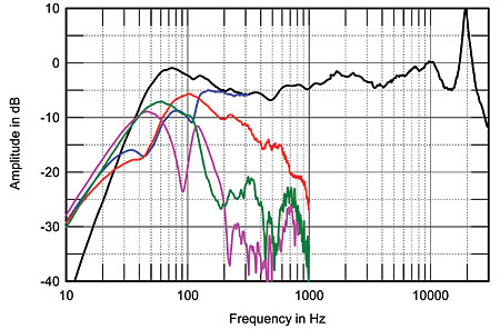

    Click image for larger version  Name:	306MA6fig3.jpg Views:	1013 Size:	43.4 KB ID:	868983
    (From Stereophile).
    Anyway, I think that the RS-8's may tend to impress in the short run, and become very fatiguing in the long run. But - this is a big "but" - do colorations can lead to a better sounding speaker? Is flat the way to go?
    I realize this is a dumb question - I know a power response should have a slight downward slope - but the Monitor Audios are praised in the press, and their power response is... well... crazy looking (at least to me) I can't imagine what their on-axis response may look like.
    Regarding the RS6's measurements:
    Below the top octave, the RS6 slopes up gently from 300Hz to 11kHz. When unaccompanied by resonant problems, this sort of response gives the impression of articulation detail and space rather than brightness per se, which ties in with BJR's auditioning comments.
    So... is this a correct way of designing a speaker?
    Overall, this is impressive measured performance from a relatively inexpensive tower loudspeaker.—John Atkinson

      This is the simulated on-axis FR of my speakers. It's basically identical to the measurements I took.

          How about the FR at 30 deg and even 45 deg off axis? Are there any peaks, even small ones in the 1-3 kHz range? I've found that any peaking in the off-axis response correlates to listening fatigue and a sound without that really satisfying something where you know it's right.
          In my experience, it's definately an iterative process to get the sound just right. This is true even if you do measurements for impedance and FR in the enclosure before designing the x-over initially. You need a good x-over simulation tool where you can clearly see how the response changes when you change component values.
          Another good tool is a 1/3 octive EQ, so you can try different things like BBC dip, or inversing any anomoly you see in measurements, etc. It helps get a target response you can then match the simulation to.
          If you're not happy with the sound, keep at it.
            In my experience, what happens with speakers designed like that RS6 is that, they grab you first thing. But over an hour or two of listening, your ears start to fatigue significantly. The "meat" of sound is in that dip, while the "detail" of sound is above that (starts ~800Hz, though - if it's got a mild peak 800-3k it'll have "forward" or "detailed midrange" - above that tends to add to "sparkle" and such. It's not about a correct design specifically, but about understanding what type of response triggers what response in a listener.
            The RS6 will be more likely to sell when it's on a showroom floor, or even a short in-home demo. It might drive folks with a classical background a little batty.

                              Others could elaborate better, but that's very much the "BBC Dip" that is sometimes designed into a response. IIRC, it's a broad, shallow dip, usually more centered around 2kHz, and the overall effect is more relaxed. Kind of a "10th row" rather than a "front row" concert experience...
                              Someone correct me if I got some of that wrong...
                              • jimangie1973
                                • 92
                                That's definately the effect. In many designs with a wide dispersion dome tweeter, the BBC dip creates a flatter power response. When the tweeter comes in around 2 kHz, it's off-axis energy is much greater than the mid-woofer. So cutting it's output creats an on-axis dip which fills when measured off-axis.
                                  • 16163
                                  Nah, you're pretty much on the money. It's an issue because so much stuff is relatively close mic'd. Also there are power response versus axial response issues, and then there's that whole psychoacoustic saddle stuff, and loudness perception. I'm still dithering about whether to put a little BBC dip in the Modula NeoD; I've listened to them with about three different sets of electronics and a lot of different program materail.
                                  For the intended use in HT, I'm not sure it's a wise idea- for music, it might be. The more transparent and natural the source material and the electronics, the less it seems desirable. We'll see....

                                                  I've heard people claim that high end head phones are very accurate. Have you ever done a comparison to of your speakers to headphones.
                                                  I just have a problem with the whole notion that non-flat is better. To me, that is an acknowledgment that the recording has flaws that must be corrected by the speakers.
                                                  However, flat on axis is never flat off axis. I believe that I've read the BBC dip results in better off axis performance. So, I guess it is all trade offs and what your definition of flat is.
                                                    • 16163
                                                    Actaully, a well designed speaker can be flat both on and off axis, but it takes a fair amount of effort and is another design restriction to consider. In practice, few commercial speakers work very hard to do this, but the best do. Well designed dioples tend to have an advantage there, if the figure 8 pattern can be maintained consistently with frequency, but then the upper end is a problem (like the Orion, which with the tweeter flare doesn't maintain the same pattern control off axis, which is part of why it has, guess what, a BBC dip. I'm pretty convinced that the best treble for a dipole is a waveguide with good pattern control over the whole operating range, and a dispersion that reasonably approximates what the open back midrange and woofer are doing. Something like this....
                                                    Of course, equalization is required to shape the response to "level", but note the tightly controlled spacing of the response at different angles- there's a consistent fall off at 30 and 45 in level, but that's the point- consistent with regards to frequency. Direct radiator tweeters don't do that, and neither do most horns or so called waveguides like the MCM used in JKrutke's one design.

                                                      Originally posted by cobbpa
                                                      Have either of you considered aiming for a response similar (as identical as possible) to the commercial speakers you enjoy?
                                                      I can try it with my current project. Maybe a xover with and one without a BBC dip. Plug them into the DCX2496 and see what happens.
                                                      On a side note, Jon, have you measured your Modulas with the resistor tweak? I remember preferring the Totems, even with your modification. I'm curious as to how similar the responses are now.
                                                      No, I haven't had a chance to do the proper side-by-side measurements. But after my recent difficulties with measurements for my current MT project, I won't be doing that again unless I have a very good reason. (OK, I'll be doing it again when I build my final cabinets.)
                                                      • JonW
                                                        • 1601
                                                        Those plots that Jon shows are pretty impressive in terms of on versus off axis. Nice.
                                                        It's not necessarily fixing flaws of the recording. It could be fixing flaws of your ears. They ain't linear. :P
