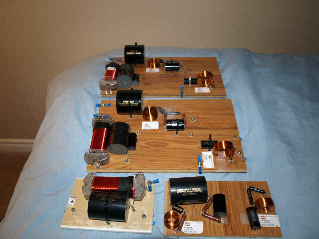

                    • FredT
                      • 28

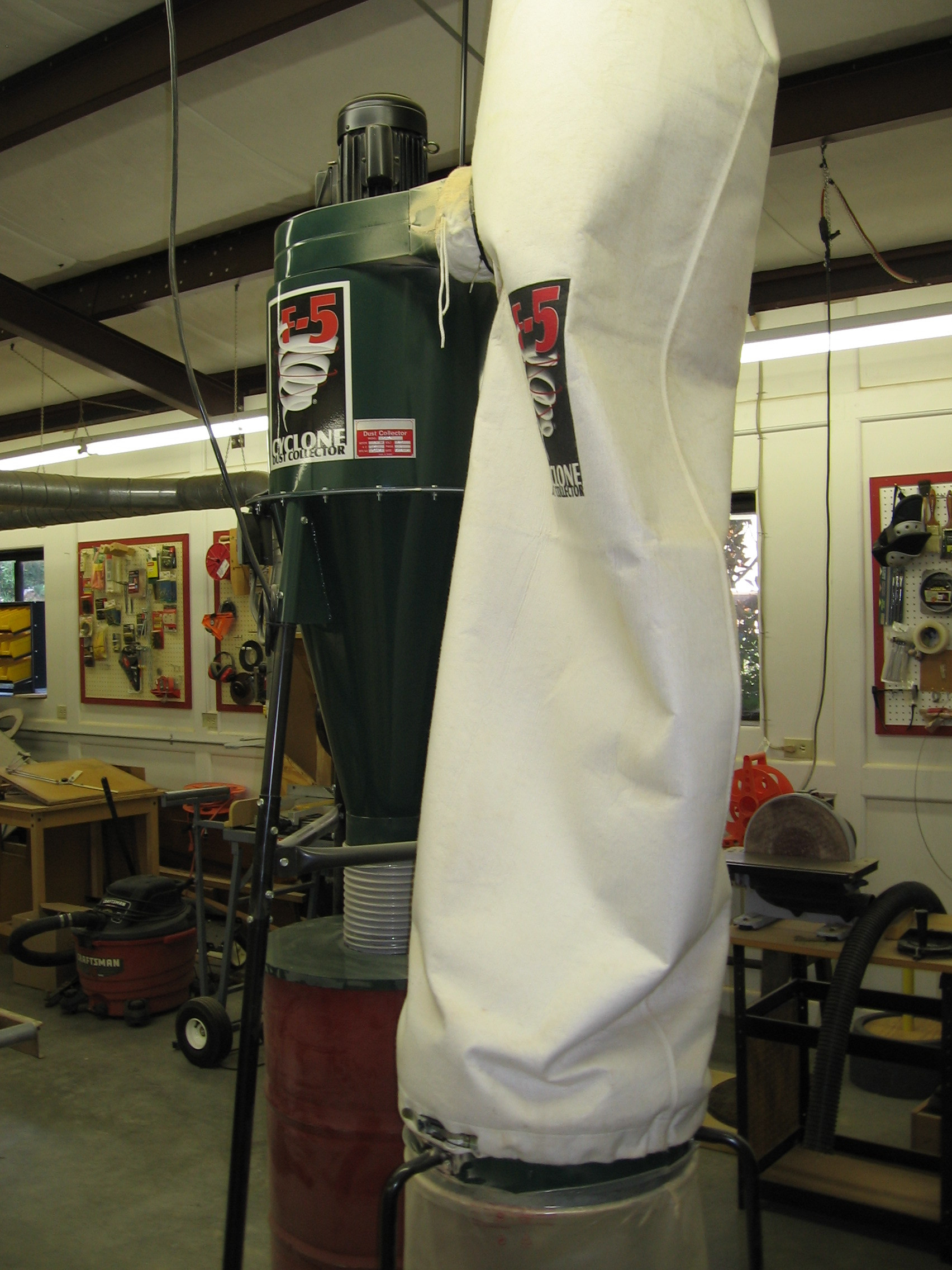

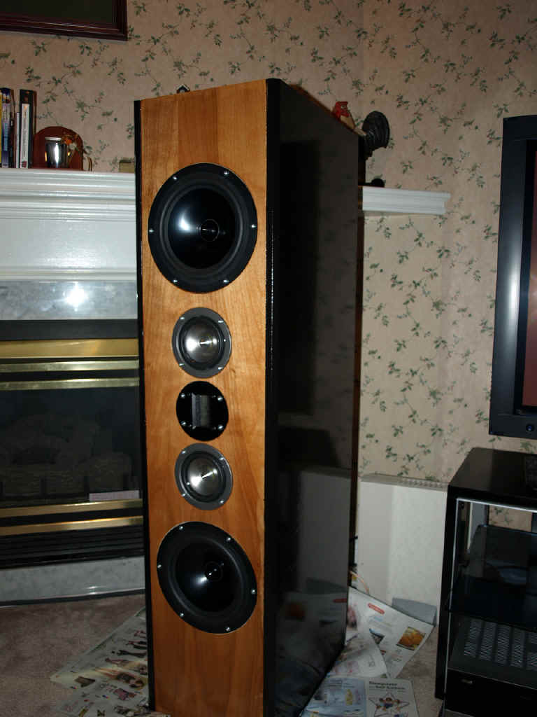

                      #820

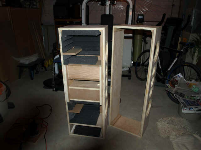

                      Tweeter Cap Comparisons
                      I was wondering if anybody has tried different 3.9uF caps in the tweeter crossover. I'm building a couple more pairs of Statements and have rigged a multi pole rotary switch so I can compare caps, including NP electrolytics, Jantzen Crosscaps, Clarity SA's, and Jantzen Z-Superiors. I'll report on any difference I hear when the new enclosures are completed. :huh:
                      Also, just for the helluvit I'm building one pair with additional bracing. With my original pair I did hear some resonances around 300-400hz with my ear pressed to the enclosure sides adjacent to the woofers and the top panel. For one of the new pairs I've replaced the 5X10 braces with modified window braces, and I've also added 1/2" eleven-ply birch plywood to the interior sections nearest the woofers. I increased the enclosure depth a bit to compensate for the interior volume lost to the added plywood. The other pair I'm building for a friend is per the enclosure drawings. When they're completed we'll compare them and report on any differences.
                      Here's a picture showing the braces and the plywood lining.
                      http://fredt300b.smugmug.com/gallery/4274907_KTENt#250417536

                        #821
                        http://fredt300b.smugmug.com/gallery...TENt#250417536
                        Hi Fred,
                        Cool stuff you're doing. I'm looking forward to hearing the results of your tests.
                        I used Clarity SA's on the ribbon crossover (3.9's) in my friend Chris's Statements but they've never been compared side by side with mine. I can tell you the sound quality is very crisp and clean. Excellent!
                        I'm looking forward to hearing all about your tests.
                        BTW, what did you use to line your cabinets? I'd think that foam/fiberglas/sonic barrier etc. would kill any cabinet resonances.

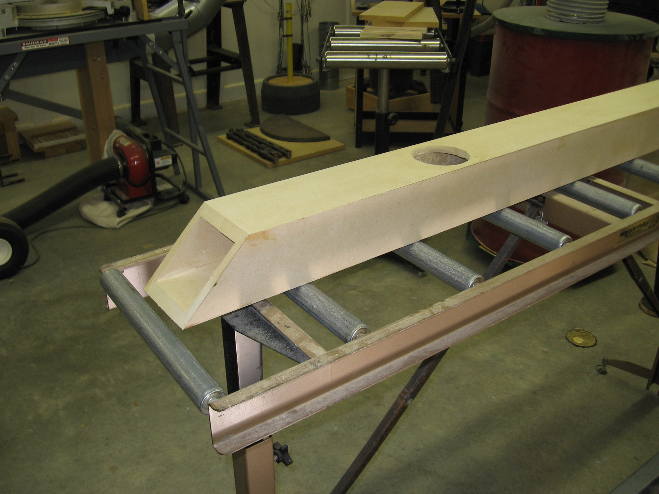

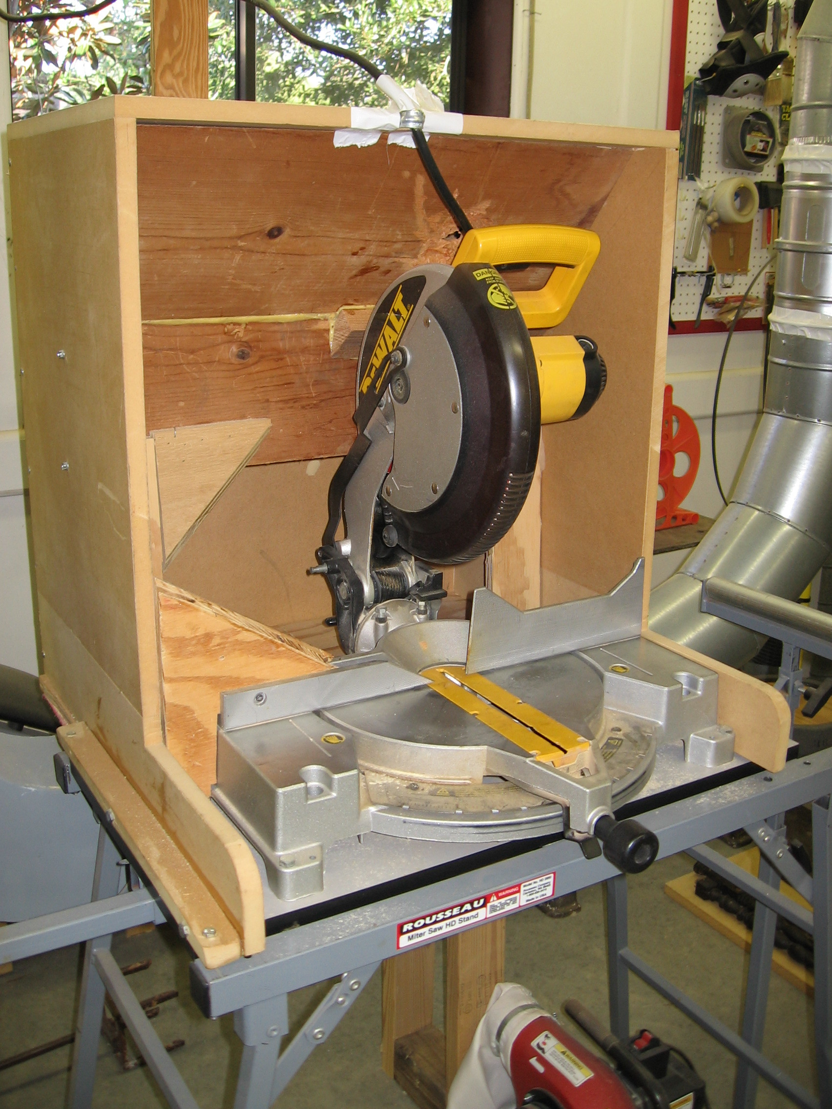

                        • FredT
                          • 28

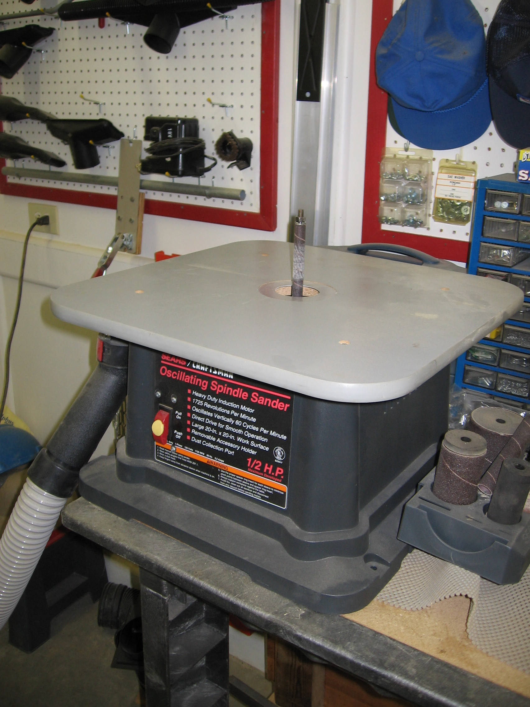

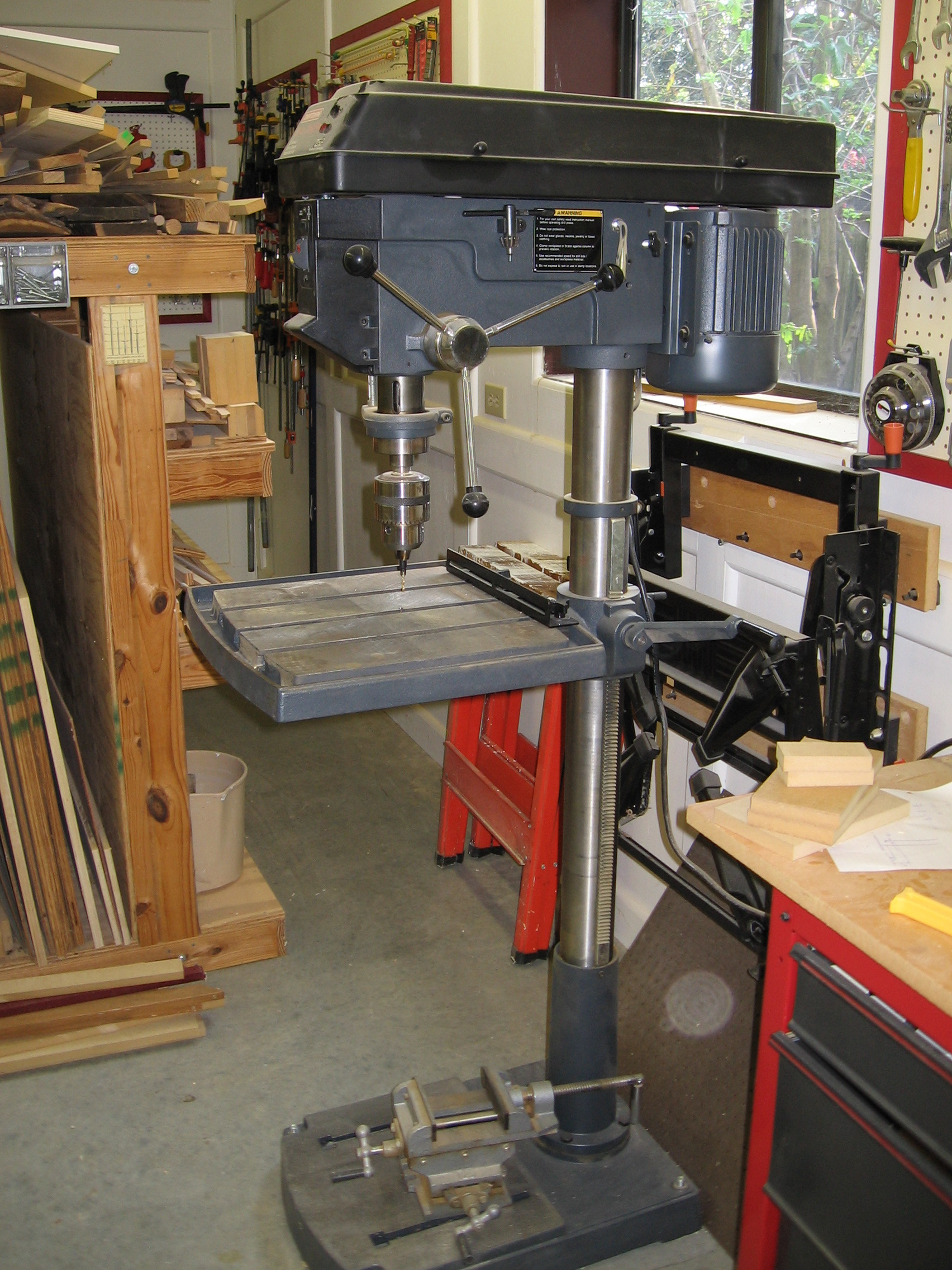

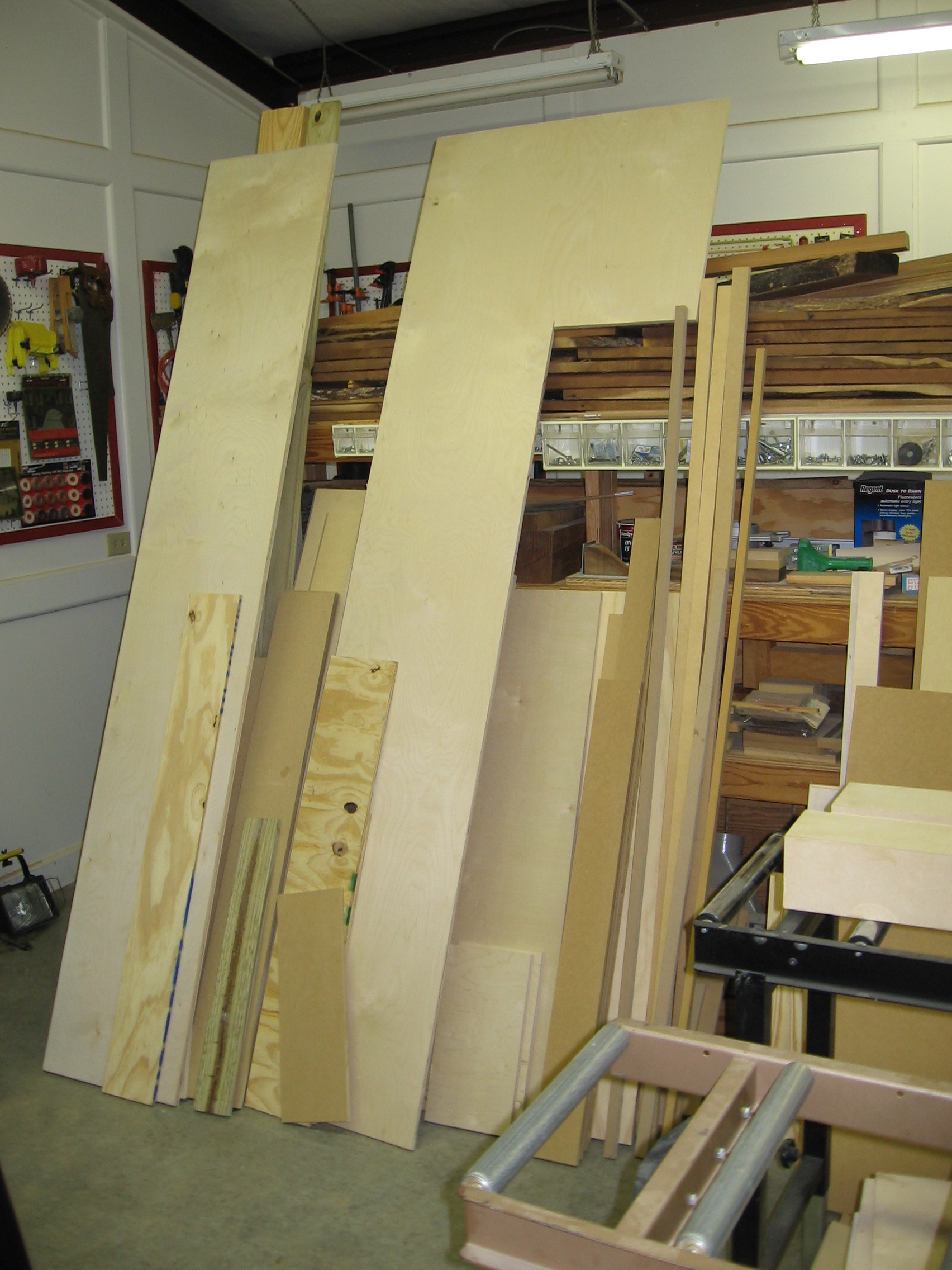

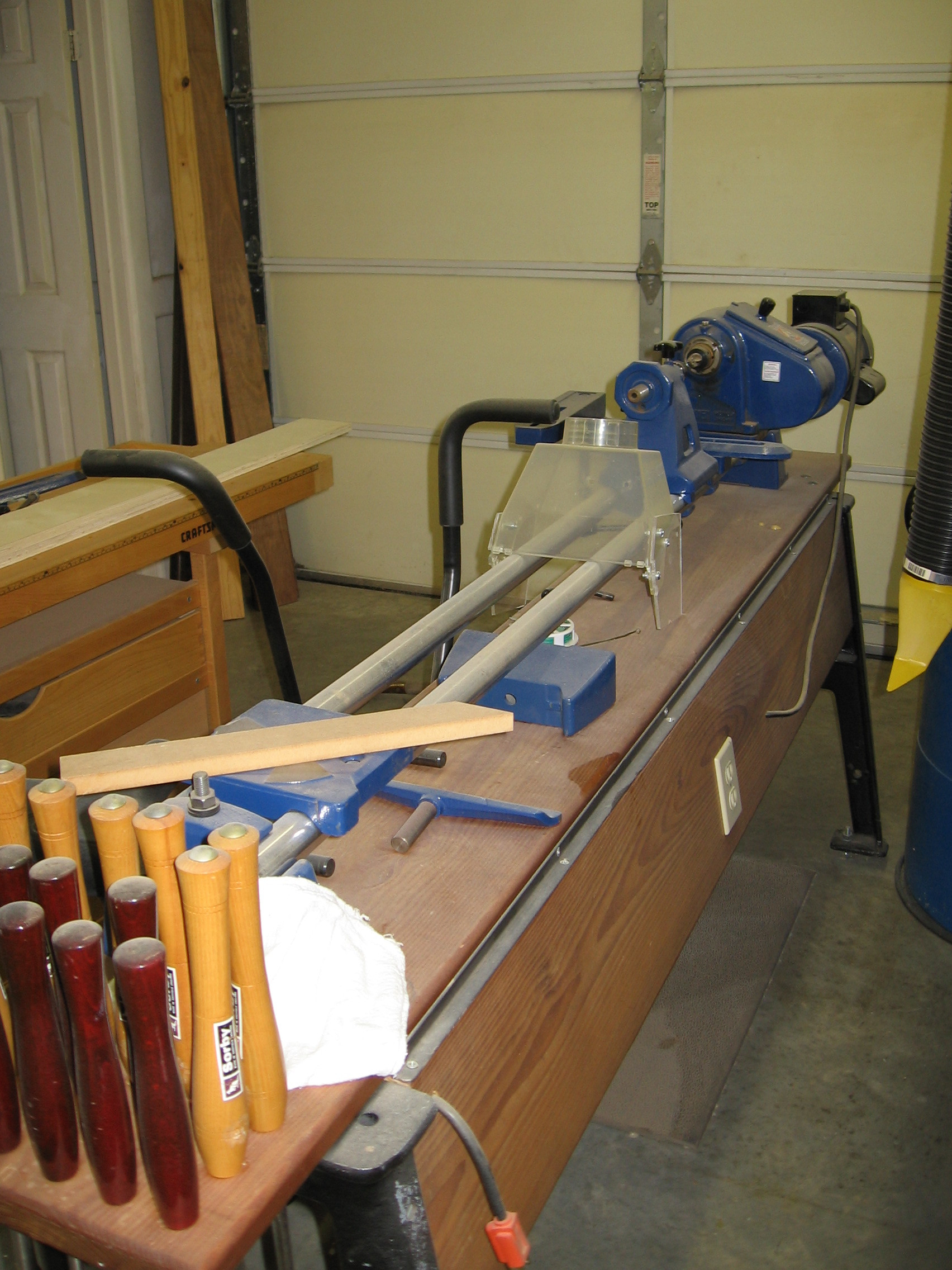

                          #822

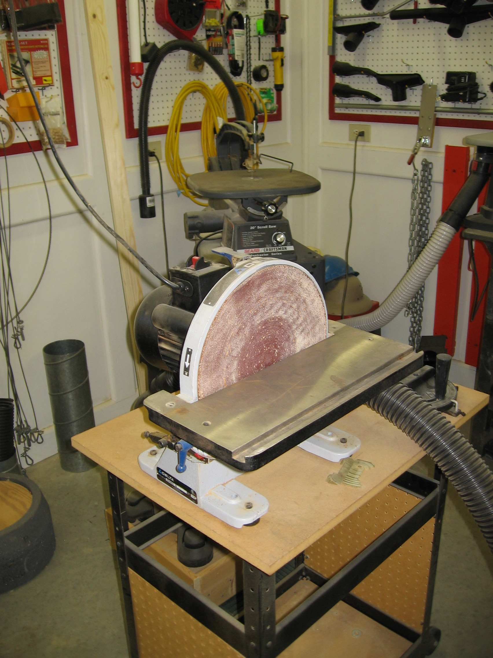

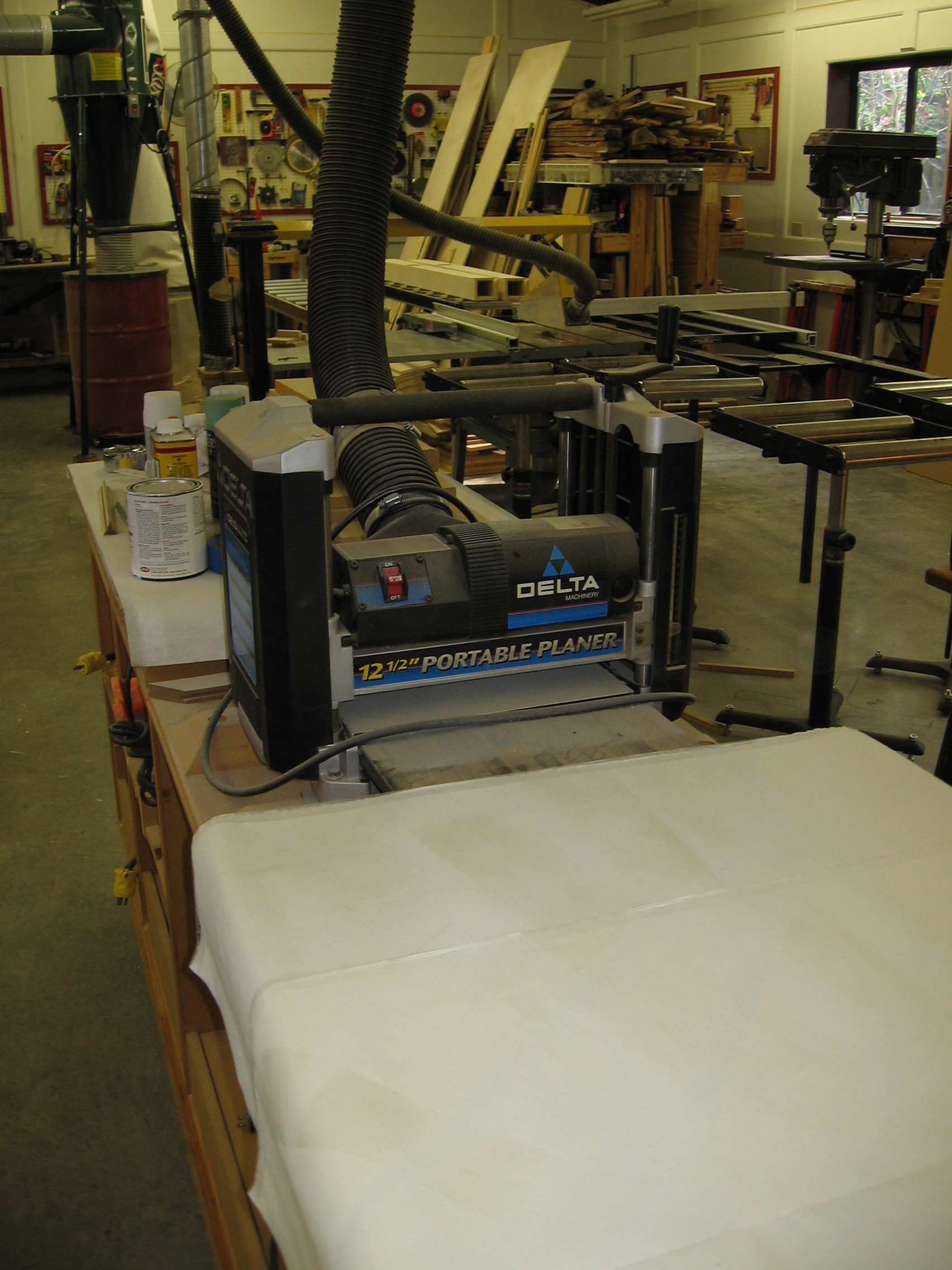

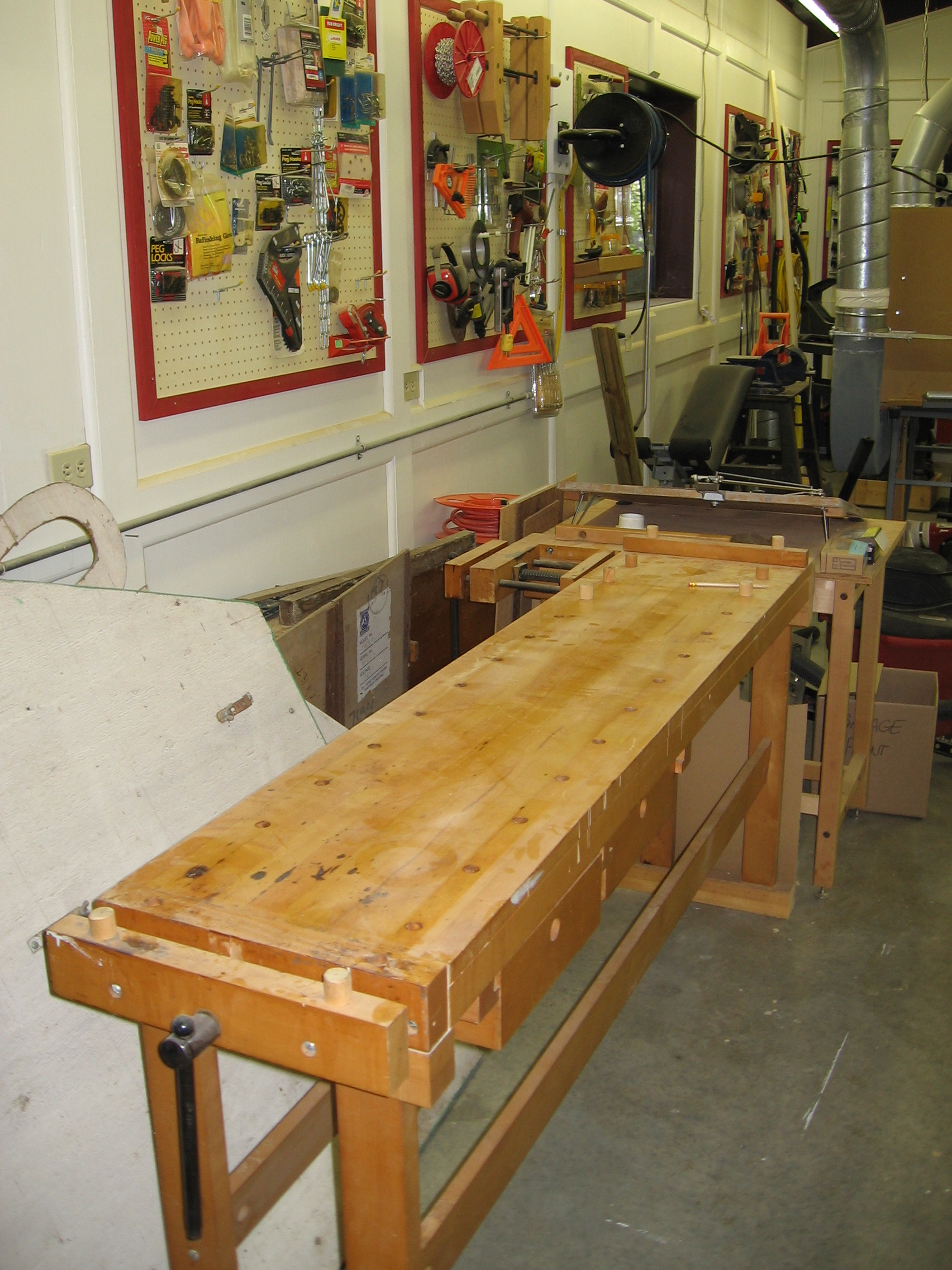

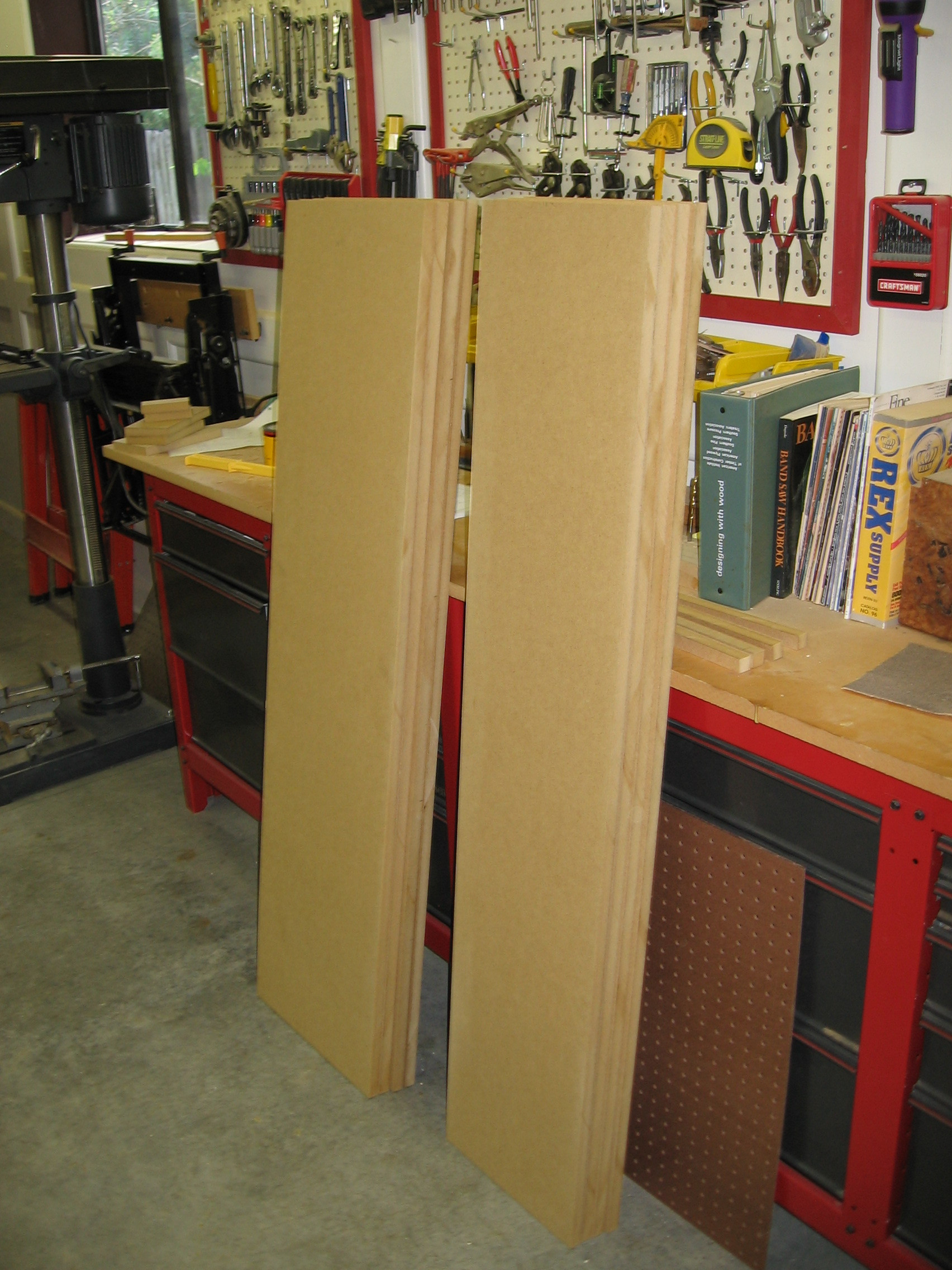

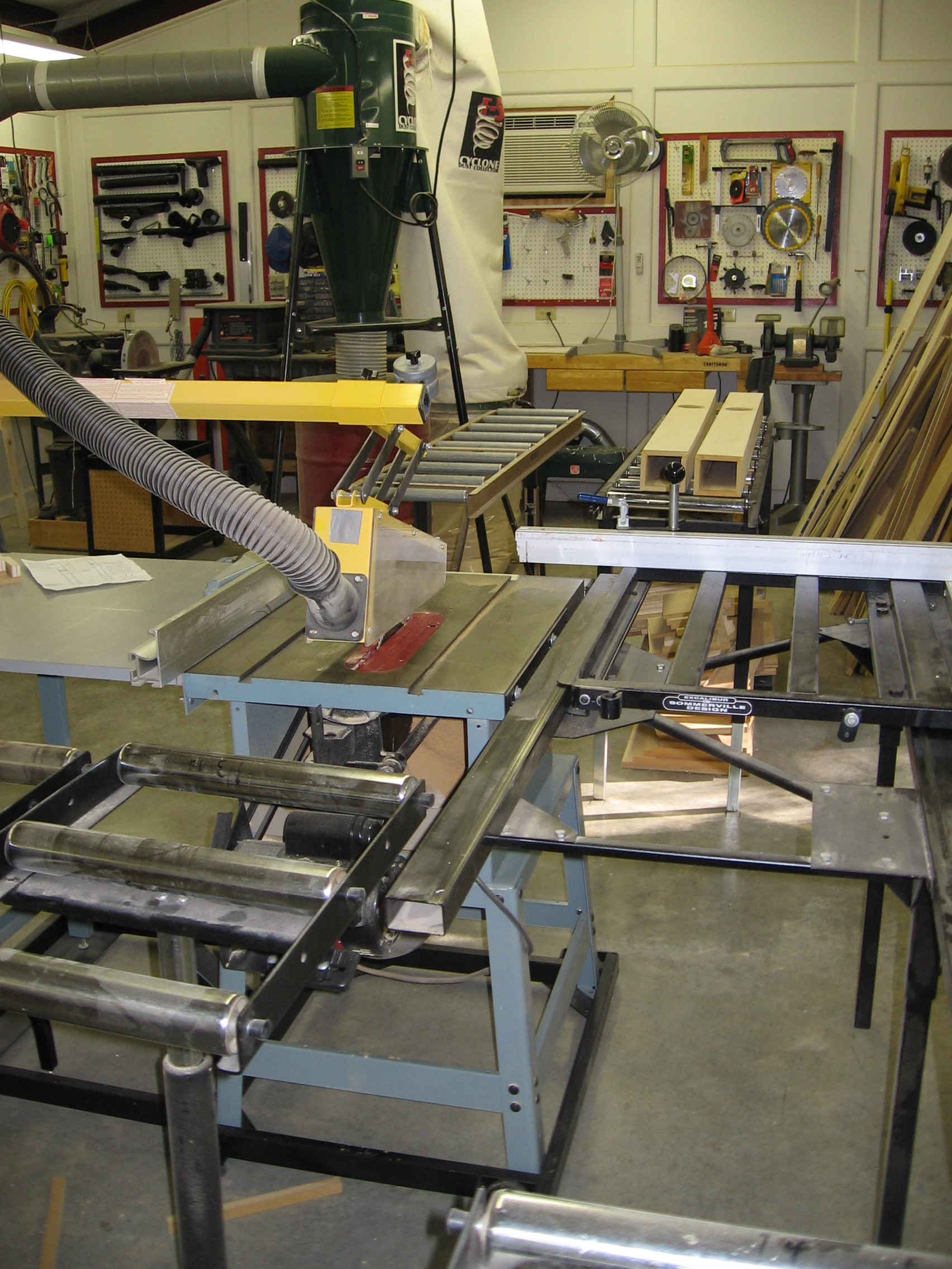

                          The resonances are minimal, but this is such a good speaker I'm motivated to make my second pair of enclosures as perfect as possible. I used fiberglass inside the original enclosures to absorb internal reflections. Black hole or its equivalent would have been better, but I'm too cheap to buy a couple of sheets. The first speaker I ever built was a pair of Wayne J's Eros MKII's, which use half inch plywood lining to damp panel resonances, and those enclosures are among the deadest I have ever heard, so I decided it might be worth trying this on my second pair of Statements.
                          I didn't mention it, but this time I'm also using two 3/4" panels for the baffles instead of the 3/4" and 1/2" per the plans. I'm doing it this way because I had lots of 3/4" mdf in the shop and would have had to buy a 1/2" sheet just for the inner baffles. I'm also using a rear facing port and installing the crossover in the base.
                          BTW, I'm building a second pair because I demoed the first pair when I hosted the Houston Audio Society's Christmas party in December. Word got out about them, and somebody decided they had to have a pair. I sold them my first pair and started building my second pair, on which I plan to use a better quality veneer so they will be true "Statement" speakers. Also, somebody had asked me to assemble the crossovers for a pair they were planning to build, and when I learned he didn't have any experience with tools I offered to help him build his in my workshop. We're well on our way with that pair too.
                          You can do anything if you got the right tools! :lol:

                            Hi Fred,
                            What an awesome shop! I'm envious! :B

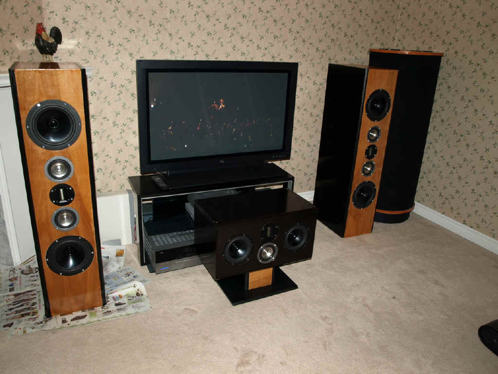

                                        sealed statements - sneak peek
                                        I have the center channel finished and up and running along with one tower.
                                        Hopefully I will have the other tower complete by next weekend to complete the set.

                                          Looking good! Are you using the 40" tall cabinets? If so, the ribbon still needs to be at ear height for best sound quality.
                                          We're looking forward to seeing the end result and getting your feedback.

                                            Hi Jim,
                                            These cabinets are actually 48" tall, the bottom 8" is sealed off and houses the crossovers. The ribbon is pretty close to my ear level when seated.
                                            The center sounds fantastic, I just need to find a new placement for it due to it's size.
                                            Many thanks again Jim for all your work and sharing with the forum.

                                                Perfect! I'm glad you're enjoying them. :T

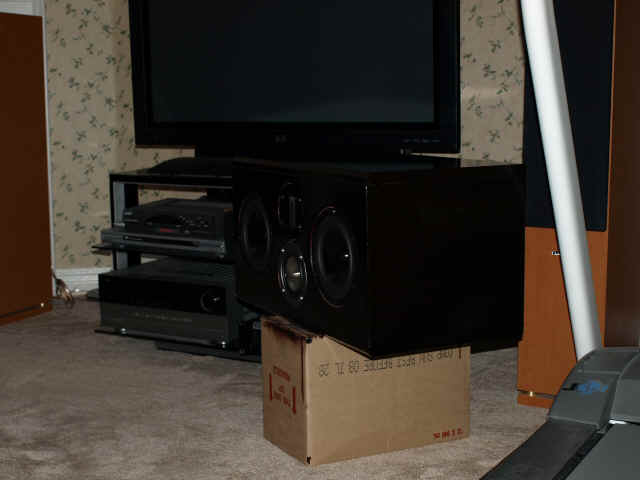

                                                  • 3815
                                                  #834
                                                  Pic attached.
                                                  That black center looks awesome! Love the finishing on the tower as well.
                                                  -Chuck
                                                  • zjason
                                                    • 19
                                                    #835
                                                    The center channel and the sides of the towers are MDF, painted with black melamine paint (3 coats - sanded lighly with 240 / steel wool between). On top is 2 coats of Minwax Polyshades black to provide the high gloss. The combination turned out pretty good.
                                                    The main frame of the towers is birch plywood stained with Minwax Polyshades, natural oak - 3 coats.
                                                    There are some minor touch-ups still to be fixed, but overall it turned out pretty good for my first attempt at cabinetry. I hope to have the second tower completed this week.
                                                    These are "HEAVY" units, I struggled to lug the one tower up from the basement for a sound check on the crossover.
                                                    I can't wait to have everything in place and working together. I am going to move my current mains to surround duty, if I can hide them behind the couch. Movie night at my house is quite the experience, I'm glad my wife is so understanding...

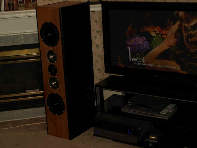

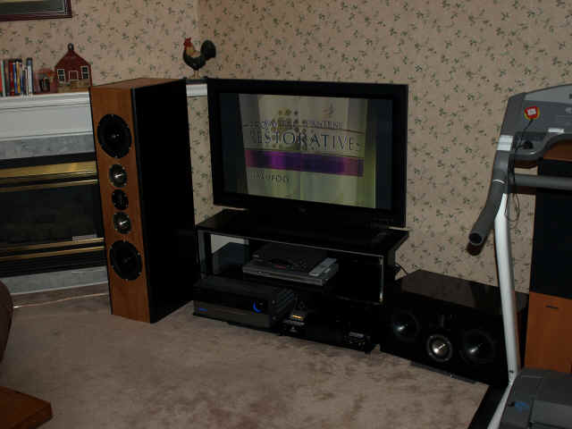

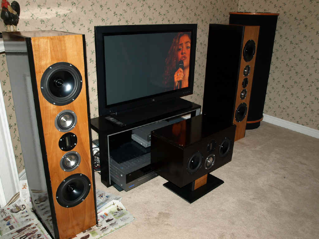

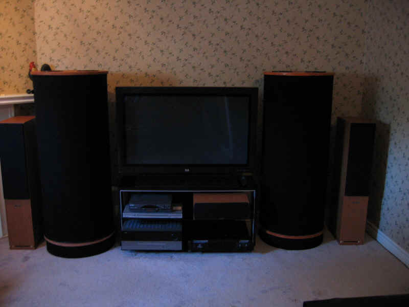

                                                                ow yeah my statements finally got done. here's a money shot of my apartment and the statements proudly taking up a big space of it. as you can see my so called living room is no bigger than the bedroom when i was living with my parents before college. and i dare not sacrifice inch of it for good sound. i'm actually gonna bring out all my equipments to the space between the speakers to even further reduce the space but increase sound quality. cuz i need the amp near the speakers for the 100 dollars per 6 feet wires im installing. if you guys have recommendations for budget but nice looking stereo racks please let me know thanks. pew but anyways moving on to the speakers, its base were replaced with wooden fence post caps. i know its not the most dense thing but i put another 3/4" sheet on the bottom and besides the carpet it sits on is super plush/thick. the posts are spheres that sits on rectangle pyramids but ofcourse its inverted so my statements have little wooden balls as feet. the black parts of the speakers are velvet sheets. i chose velvet over painting to further maximize the stealth/ninja-ness when the movie projector is operational. for the accent, wood veneer strips that run horizontally . working with the strips alone cost me six hours. i havent bothered to post any close up shots cuz the truth is that the work isnt very clean. and plus i would rather be listening to them instead of working on them. which is what im gonna do now lol. they are being run with a tube dac, tube preamp and a SS mosfet amp. a sherwood am7040 probably the best find yet for me because it actually puts out more deep/clean base than my nad 2200 while being all tuby like at the same time. synthetic tube sound as i have coming thru statements are simply gorgeous. i actually had a tube amp that i had to get refunded for because the statements were too revealing of their distortion. but with a mosfet as one of the forum member here had suggested, the sound just simply becomes something special. anyways thats my input here for the day, if you guys could help me out with fixing the pic to just become a full spread that would be great. and if you guys could give me recommandations for bargain priced but good looking stereo racks please let me know. thank you and good day.Image not available
                                                                Last edited by theSven; 20 March 2023, 19:33 Monday. Reason: Update image location
                                                                  #842
                                                                  Lookin' good Coconutout! I'm glad you're enjoying the Statements and you got your electronics the way you want it. :T

                                                                            Completed Set:
                                                                            Here is the finished pair:
                                                                            Now I'm debating about needing to upgrade my receiver in order to properly power these fine pieces. Maybe others with the sealed version can chime in on their experience.
                                                                            Current: HK avr 145, rated at 40W x 5 (all channels driven, 20 - 20000 Hz). I love the sound and features of the HK, the only weak spot is that it does not have pre-outs
                                                                            I am looking at a Yamaha rx=v659 that has the pre-outs and is highly rated by many reviews.
                                                                            For subs, I have 2 15" Tempest ported sonosubs powered by an Behringer EP2500 pulling about 700 Watts per channel. Currently crossed at 60 Hz.

                                                                              #848
                                                                              They look great!
                                                                              Unfortunately for you, the better the electronics, the better they sound. Have you checked out Emotiva? They have excellent electronics at very reasonable prices.

                                                                                        Great job ZJason. I think you sarted from my Natalie P design pictures and your build looks sweet. I've been gone a while but many, you guys keep pushing forward. Nice to see these new Statements flowing out. Great work.
