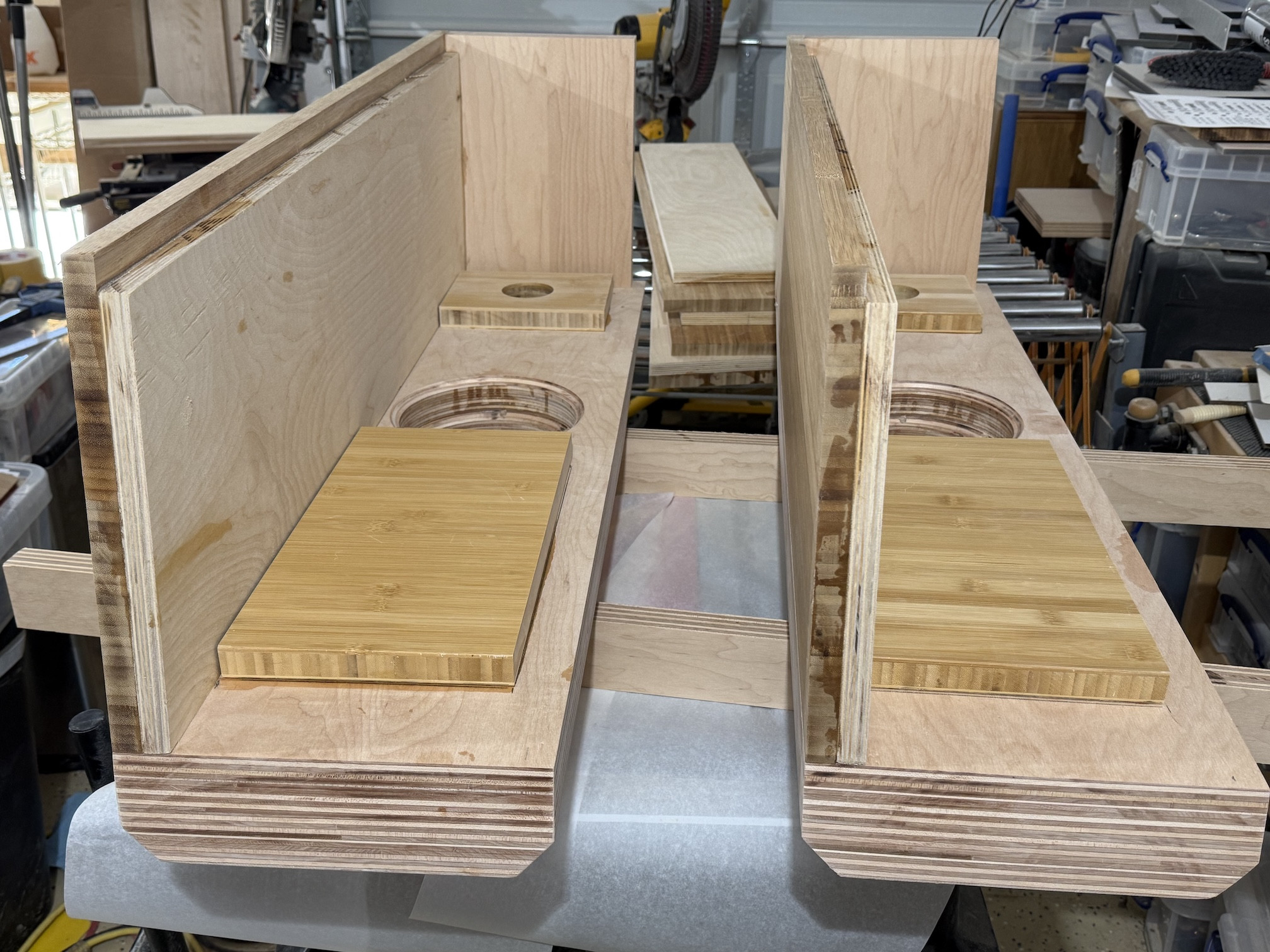

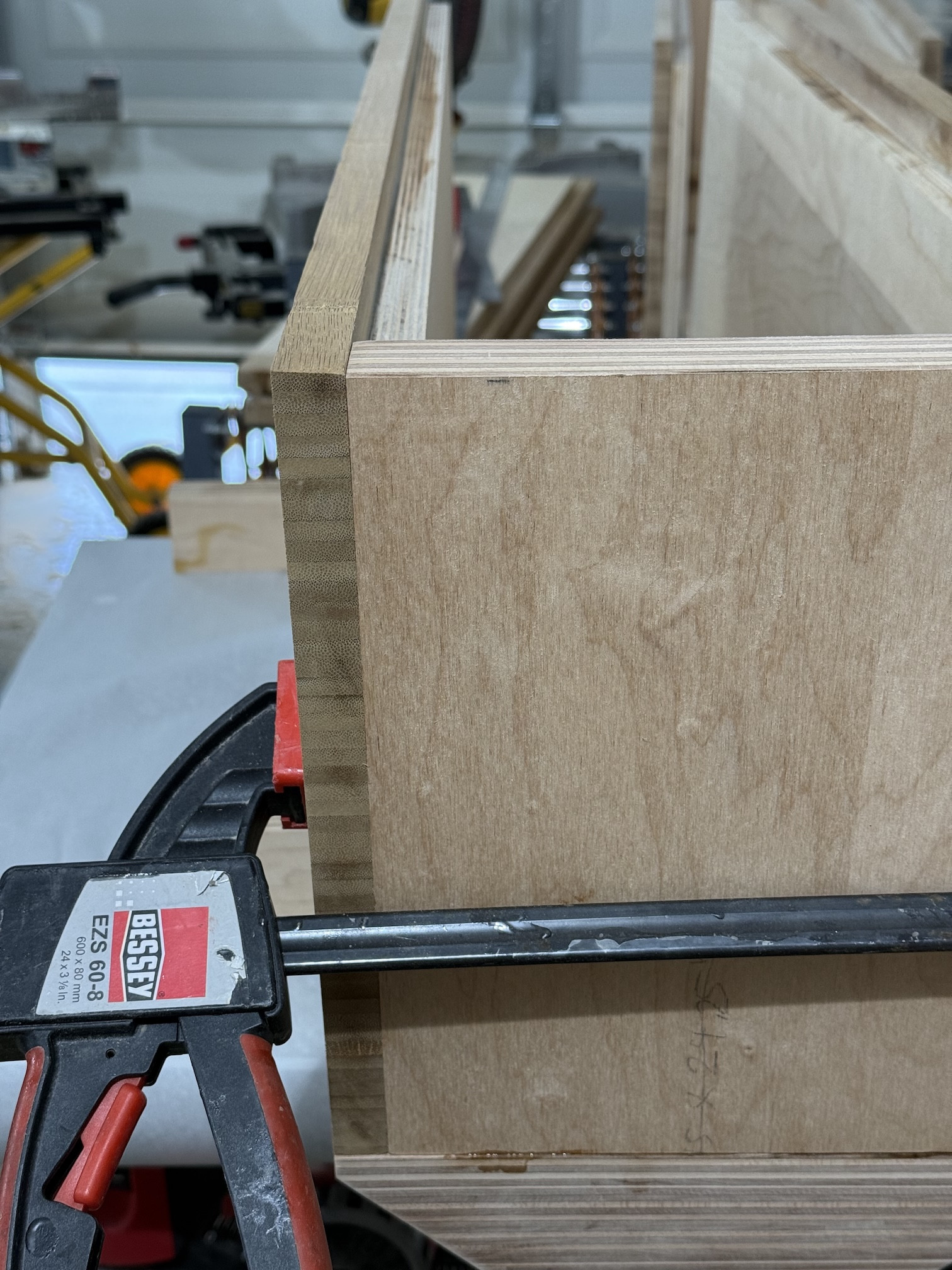

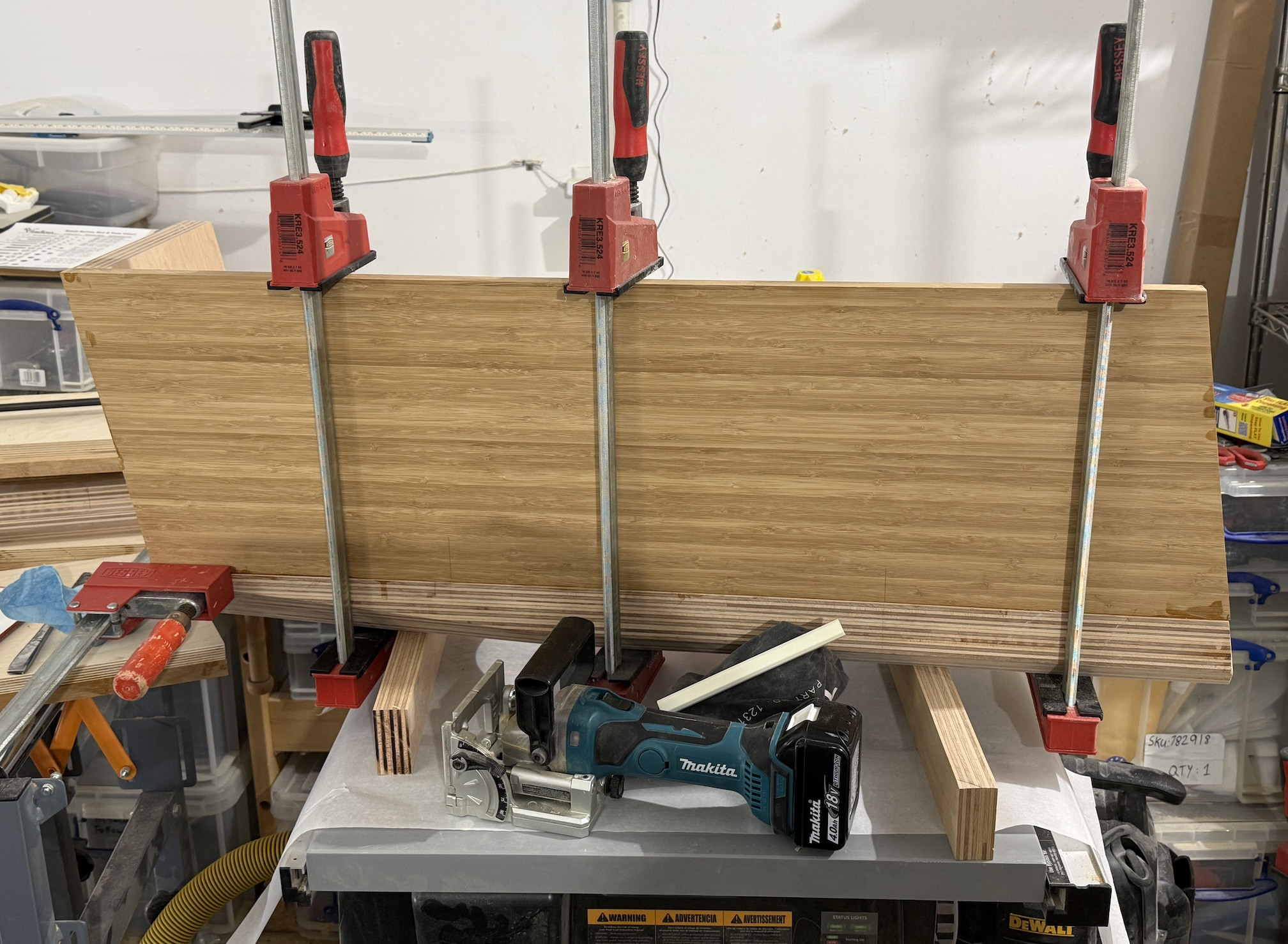

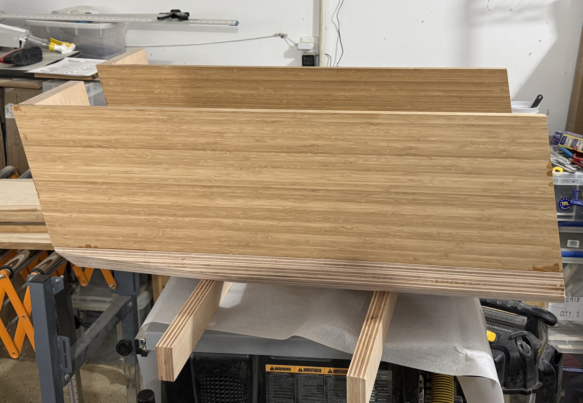

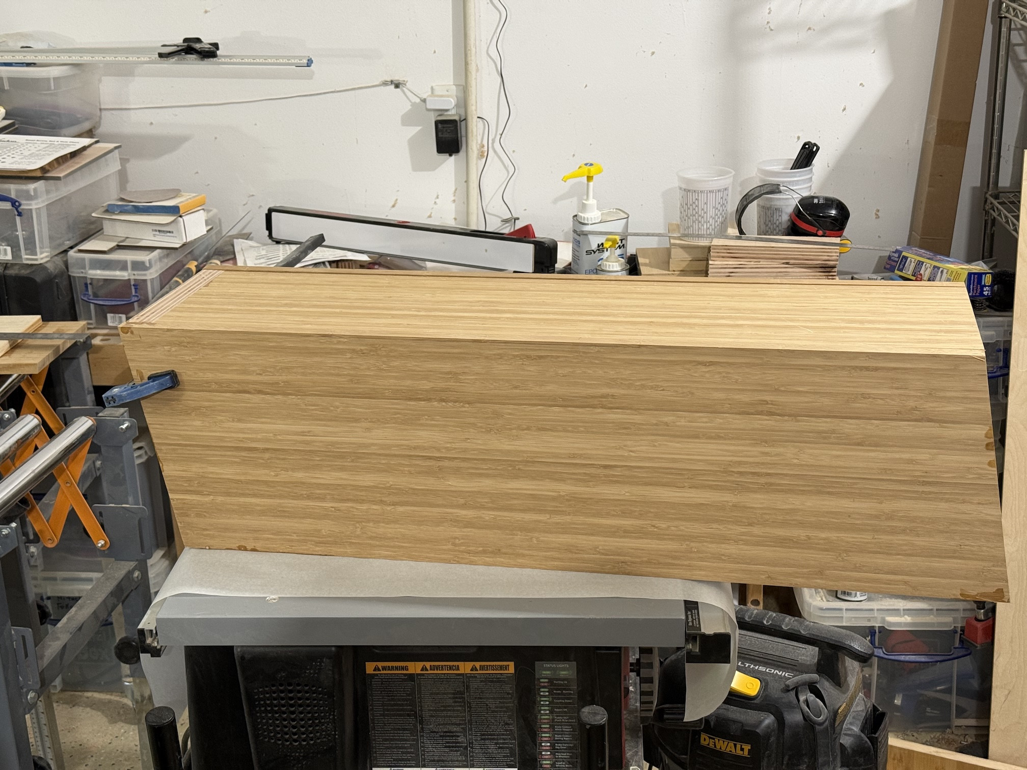

    And here we see some more of that slow but steady progress...
    Another right side wall and top panel going together... ​
Name:	Adding Top Panel.jpg
Name:	Glued and clamped.jpg
    Next up will be inner and outer back panels- due to the spacing of the panels versus router cuts, , they will not be routed until assembled into the cabinet.

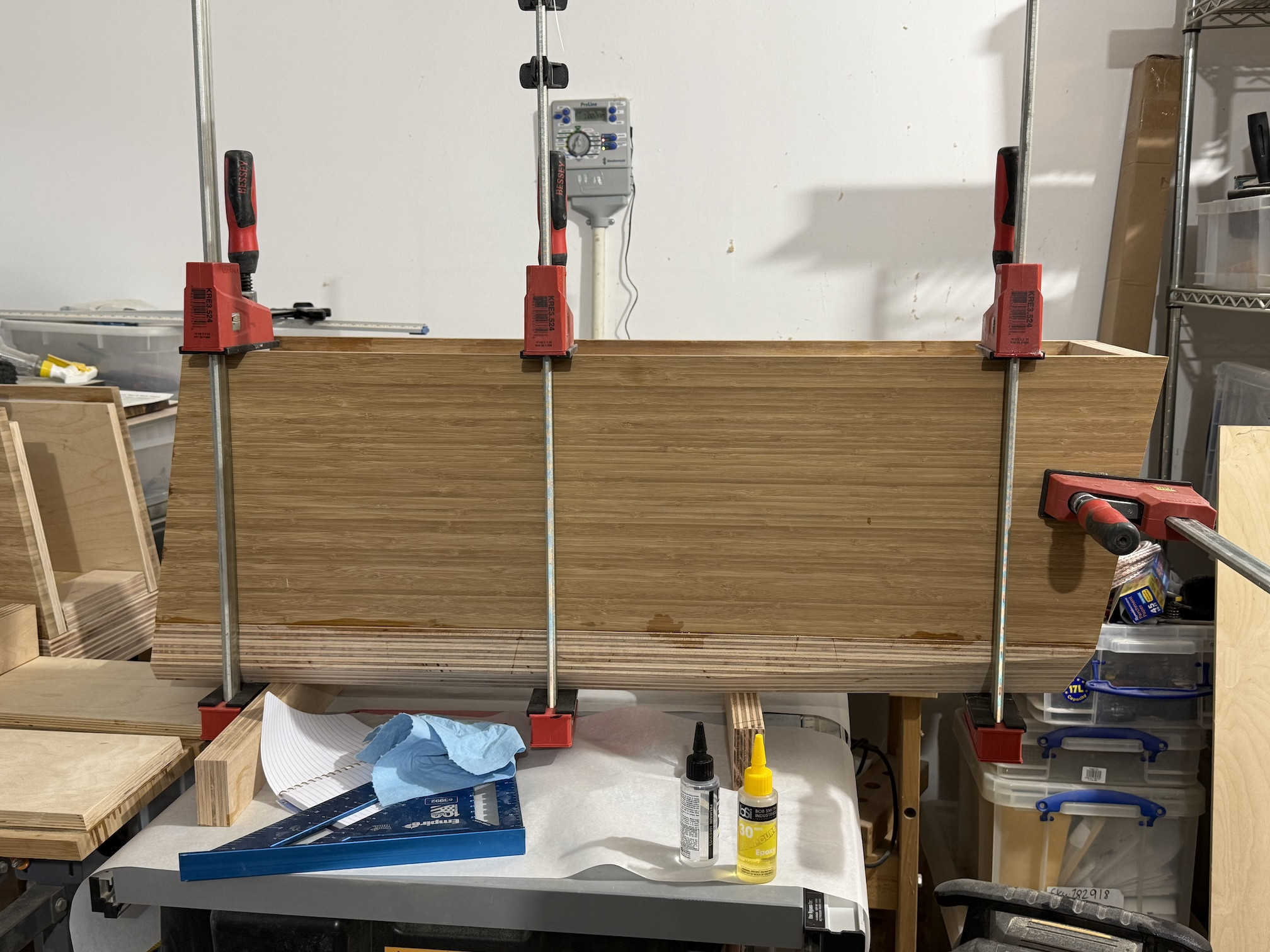

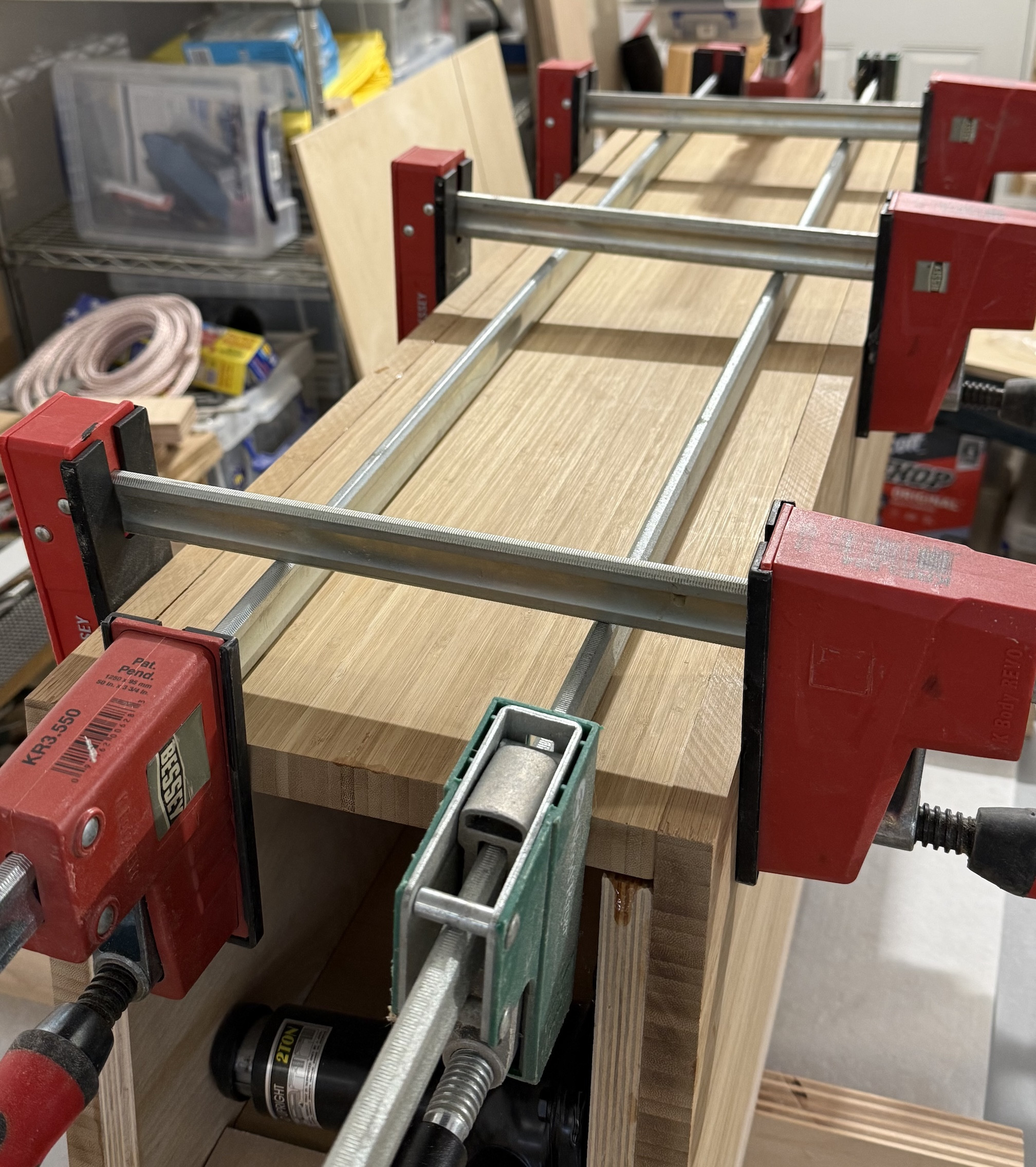

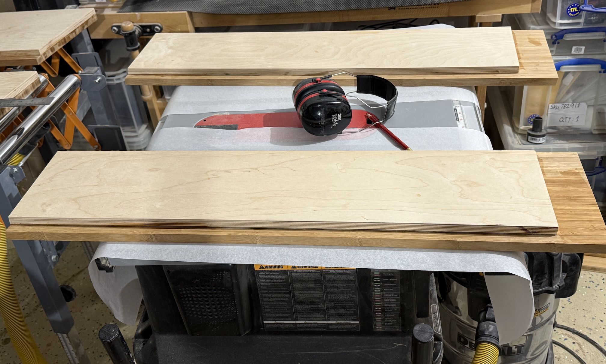

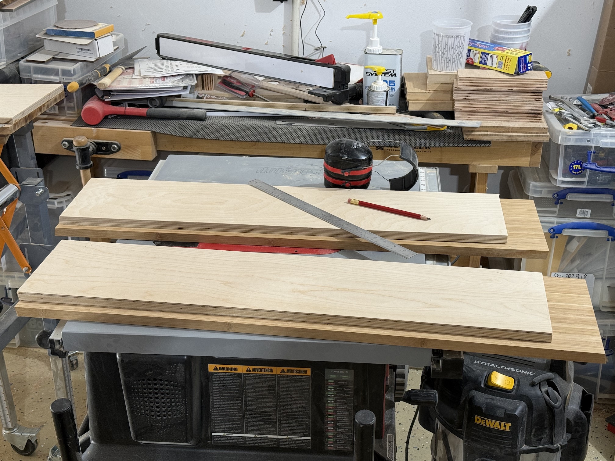

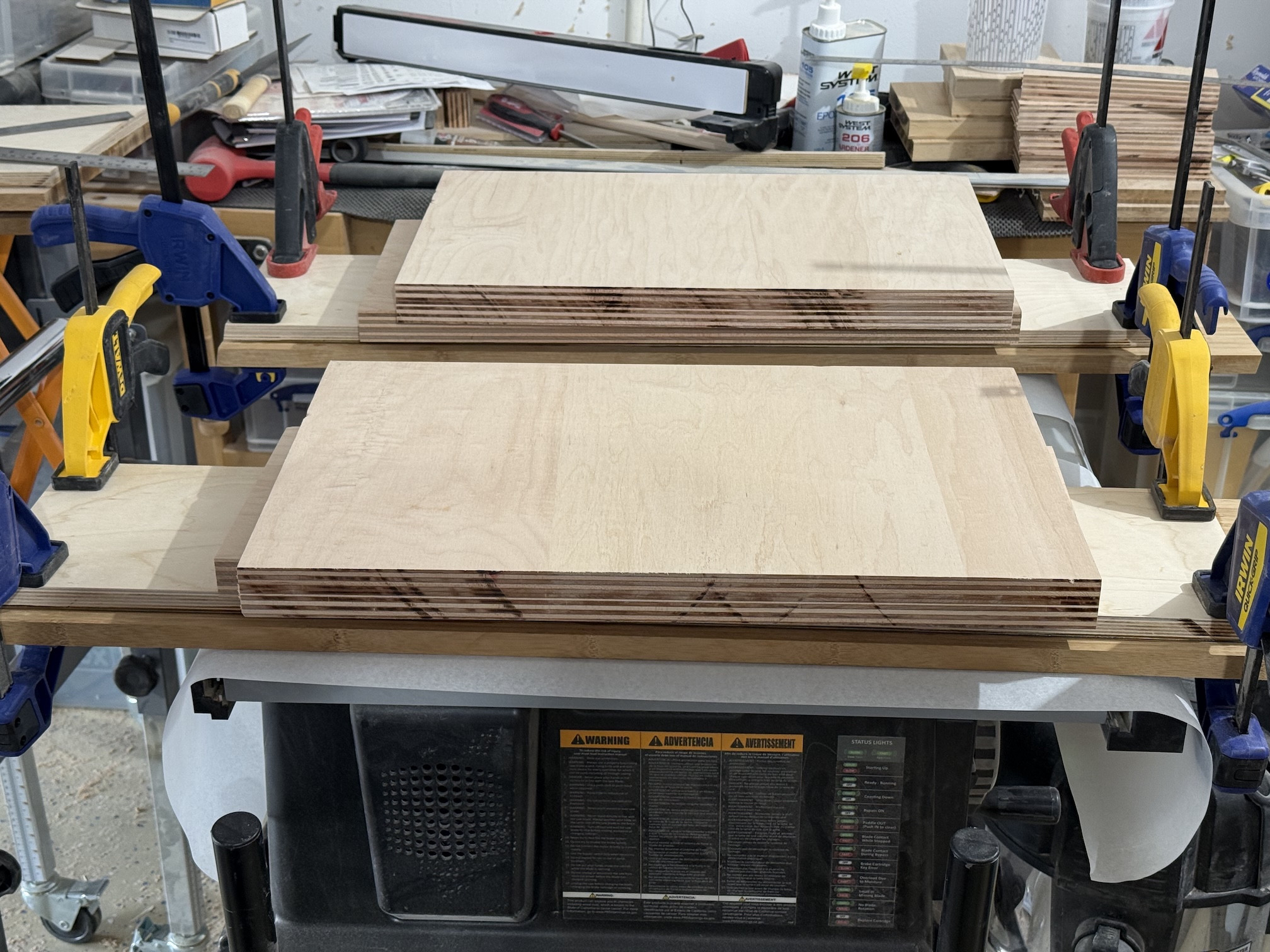

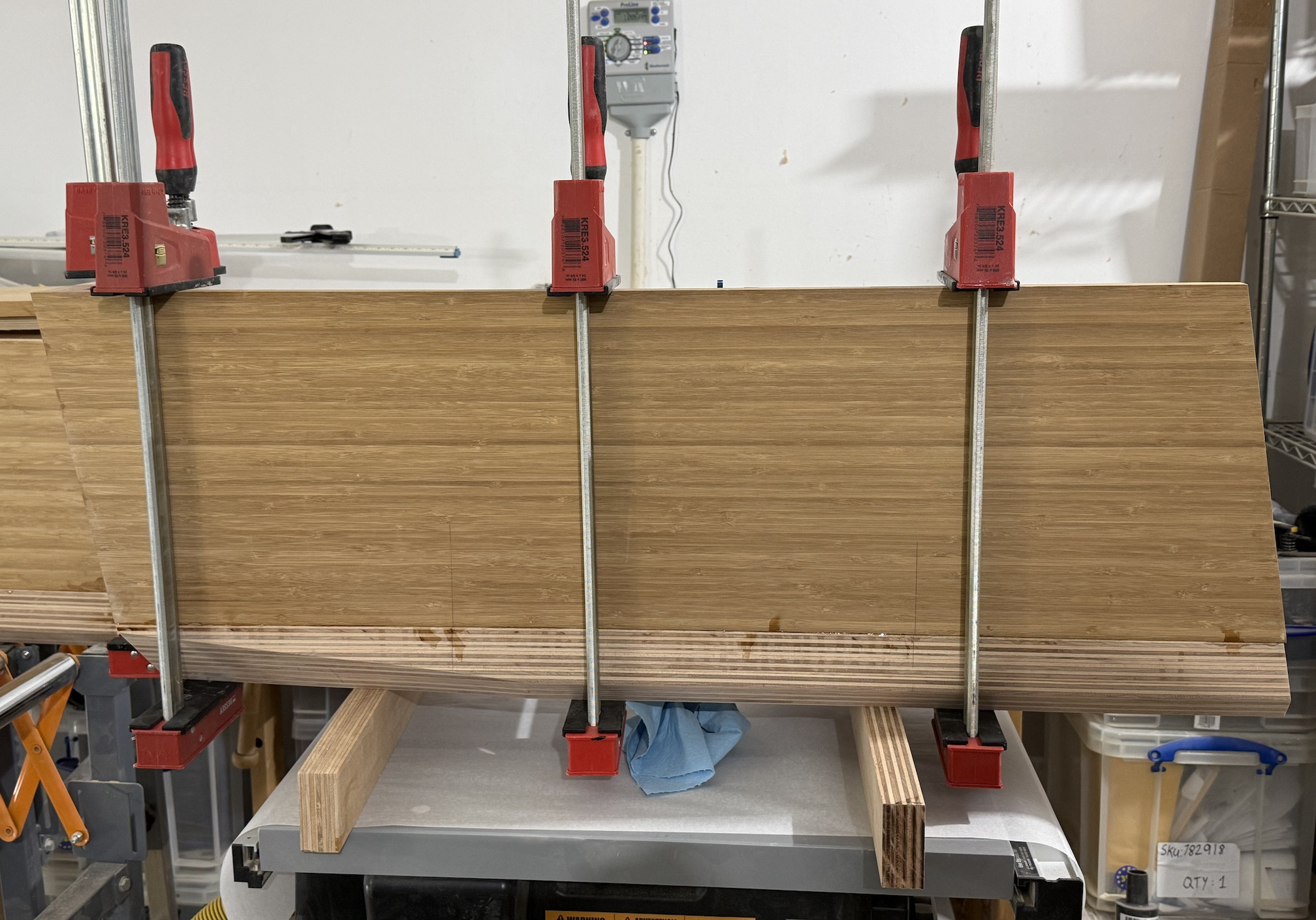

      Main step this morning was gluing up the inner back panels to the outer back panels, and making sure everything is aligned "just right"!
Name:	Outer - Inner backs.jpg

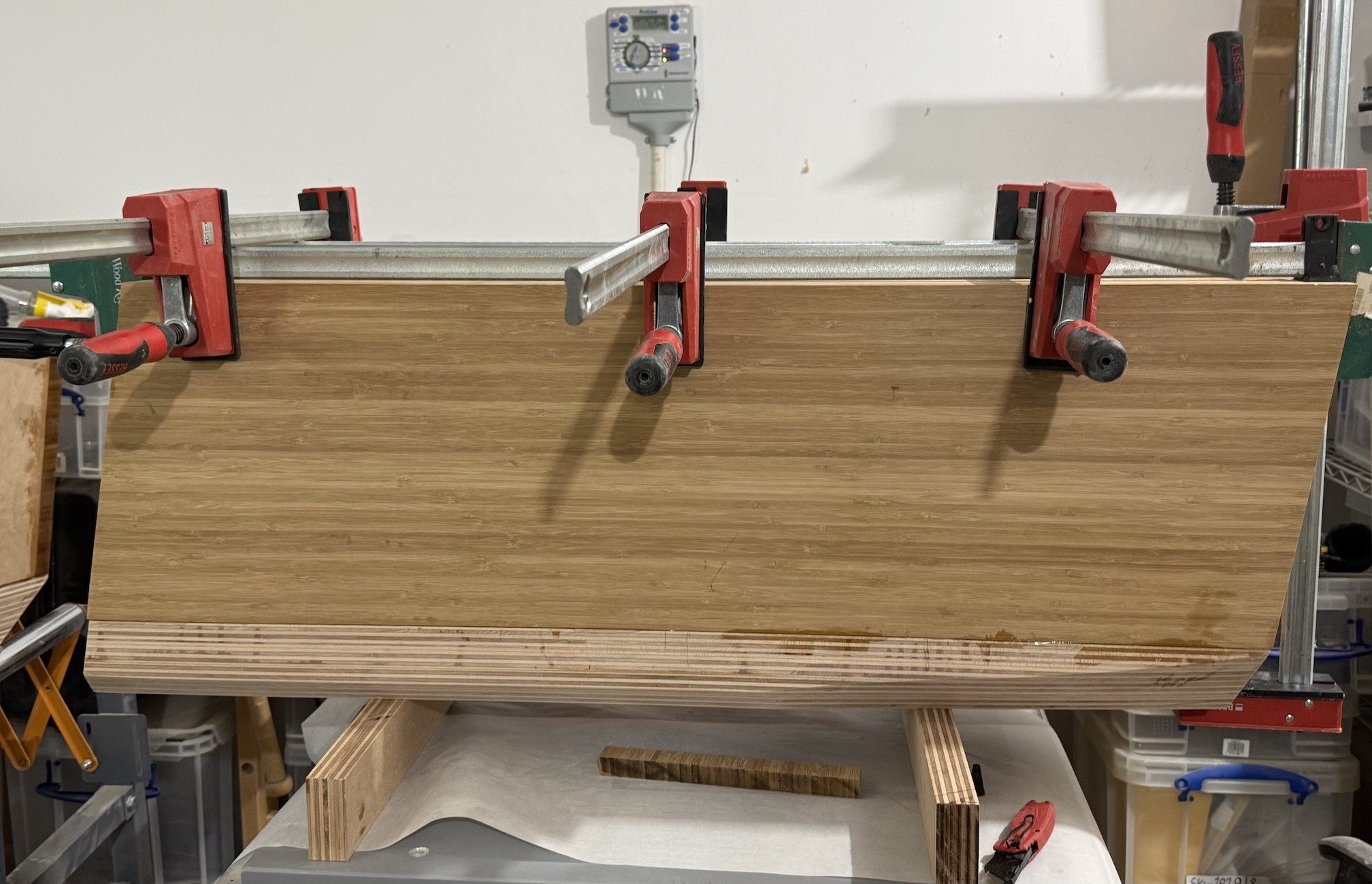

      This involved measurements and some alignment marking, and double checking with a steel rule after the thin coat of epoxy is applied. Alignment lines drawn top and bottom after everything is lined up makes it easier to do when assembled with epoxy...
Name:	Back clamped - weighted.jpg
      Note, I'm clamping at the ends, checking alignment, then adding maple ply scrap weight to compress in the center, using the table saw top as a stable flat plane.
      I don't doubt the big boys can come up with a better plan, but I'm just the wires and sparks guy....

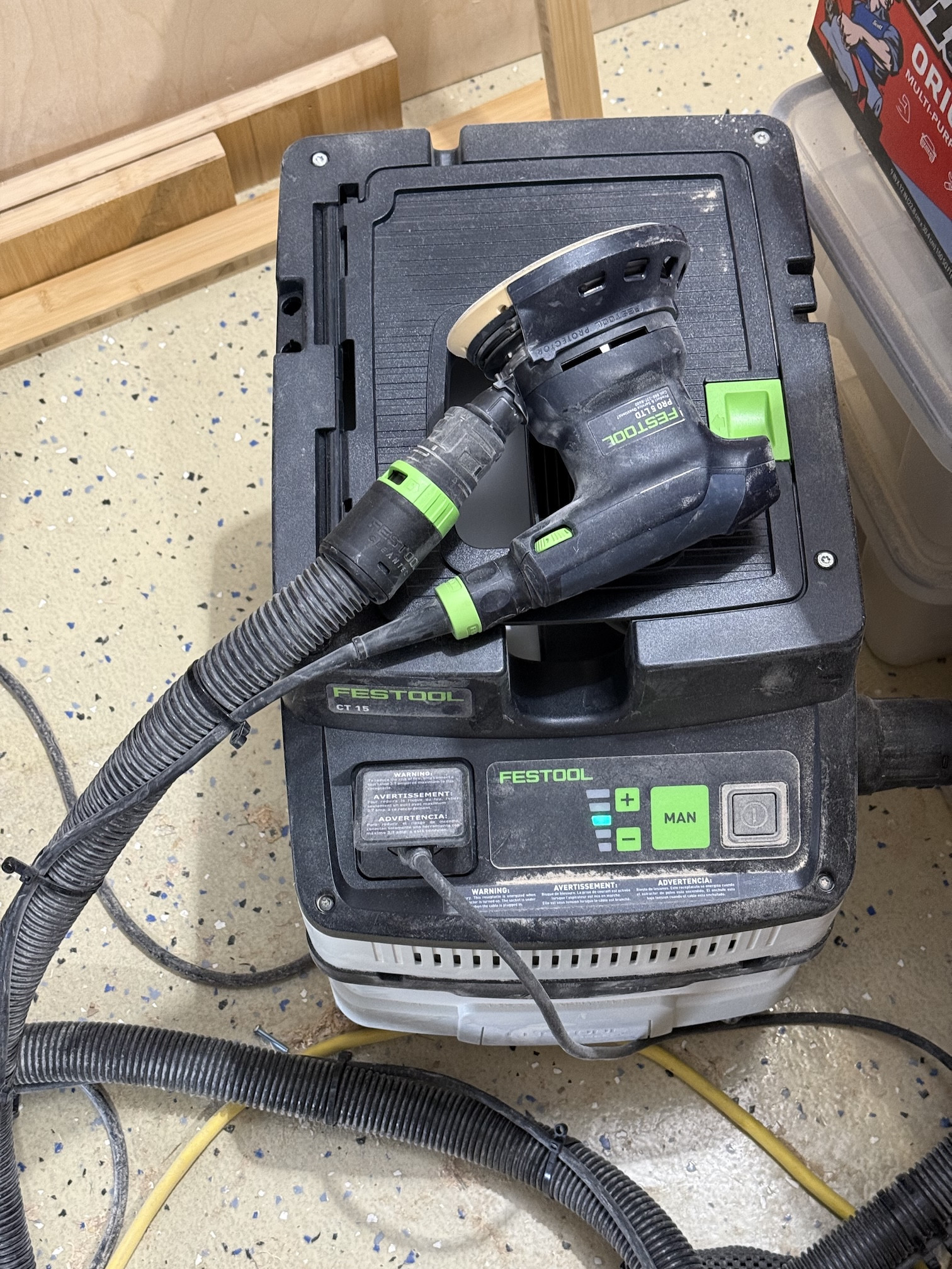

      And I find that a key to having this all go "smoothly" is my Festool sander that I resurrected earlier this year!
Name:	Key sanding tool.jpg

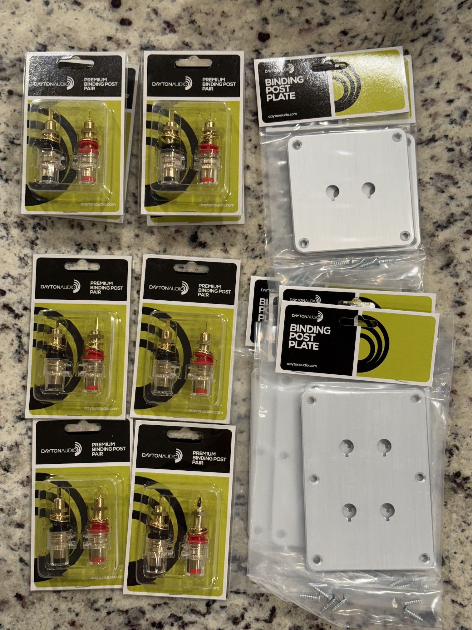

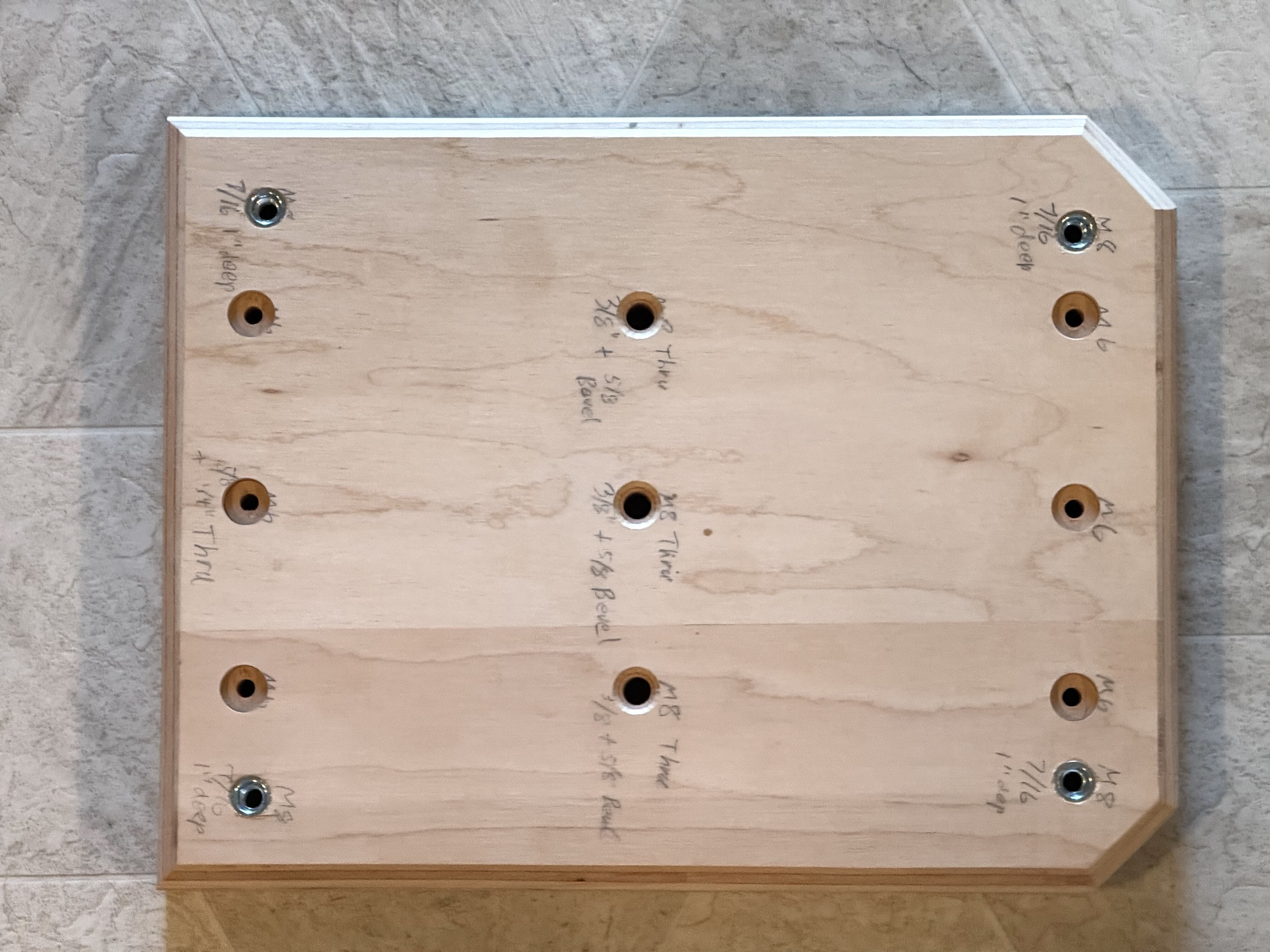

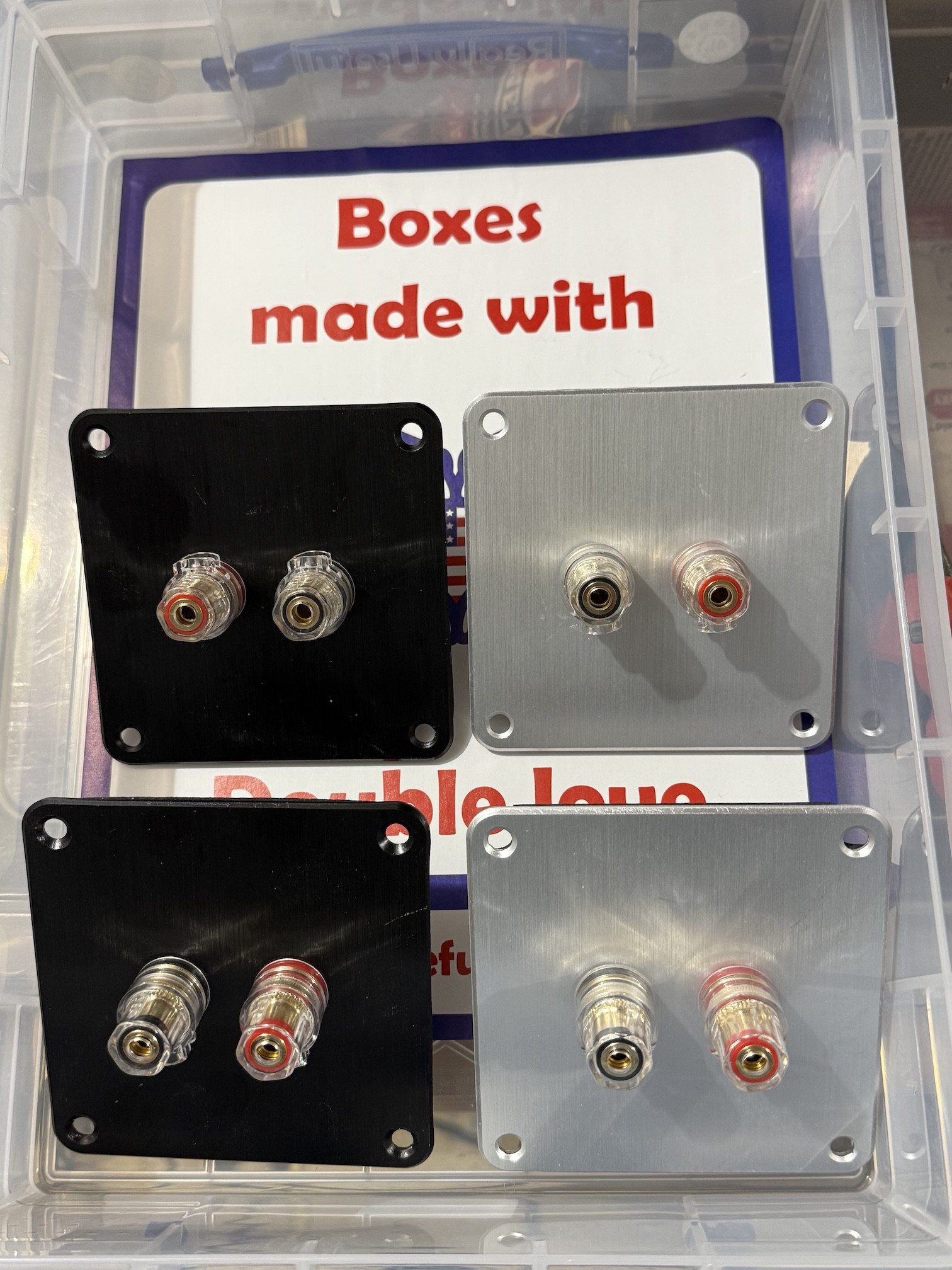

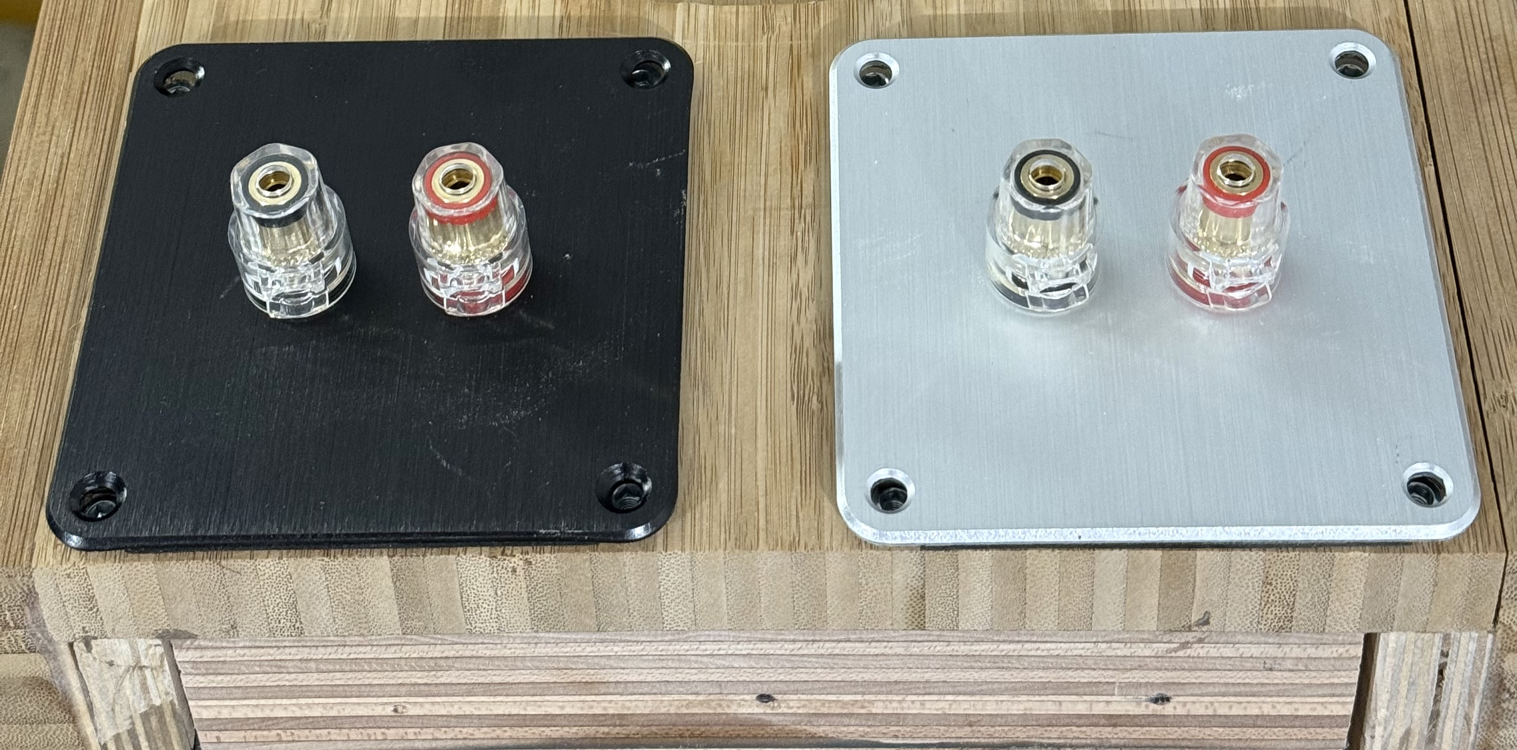

            UPS delivered two days early on the PE order for binding post plates and binding posts... sometimes things go better than expected!
Name:	PE Connectors.jpg

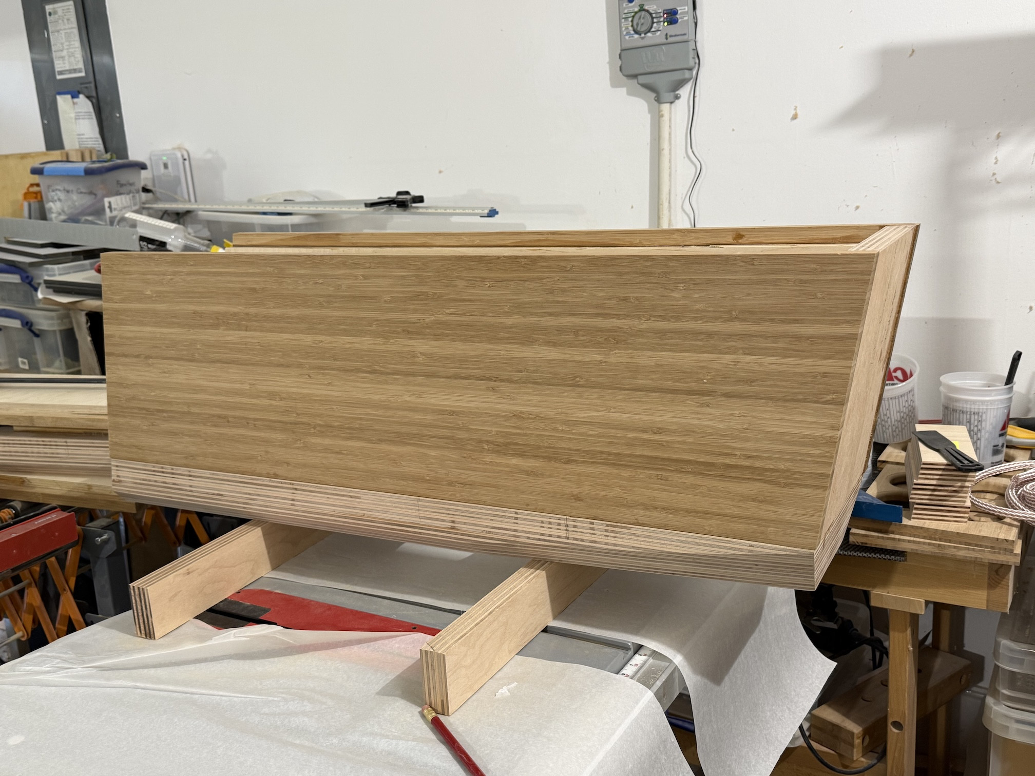

            And the clamps are removed from the back panel assemblies, I think I'm ready to do an overall fitment check right after breakfast!
Name:	Back Panels-Glued.jpg

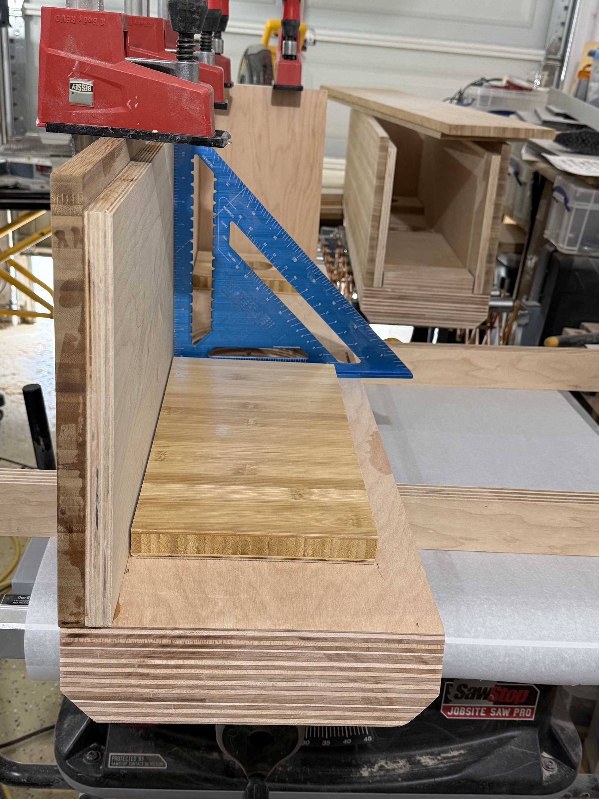

              Preliminary fitment checks look OK...
Name:	Fitment check.jpg
              Next up today is preparing the front panel alignment plates and marking up for precision alignment when gluing.
              Step by step, inch by inch... slowly I build...

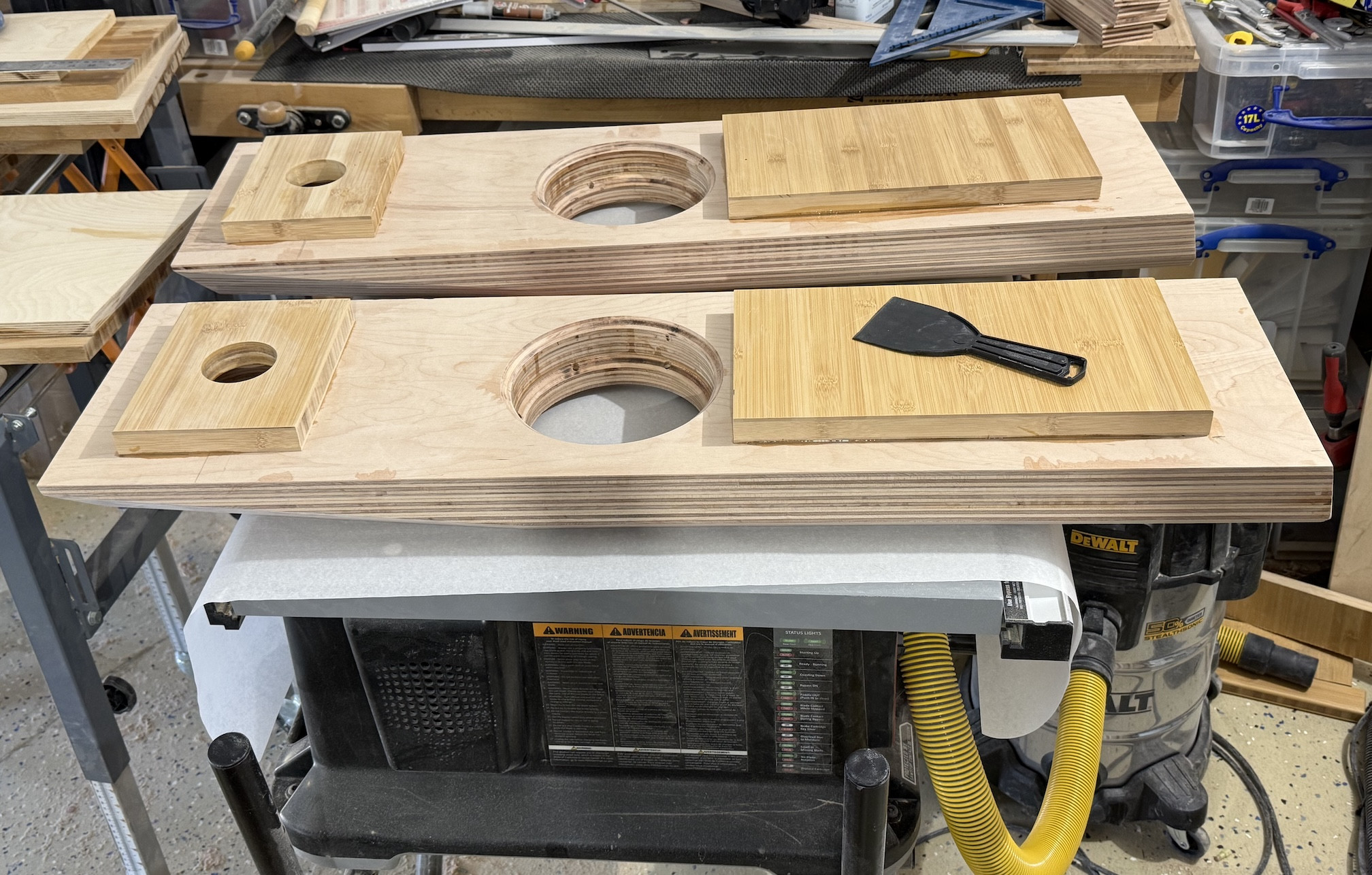

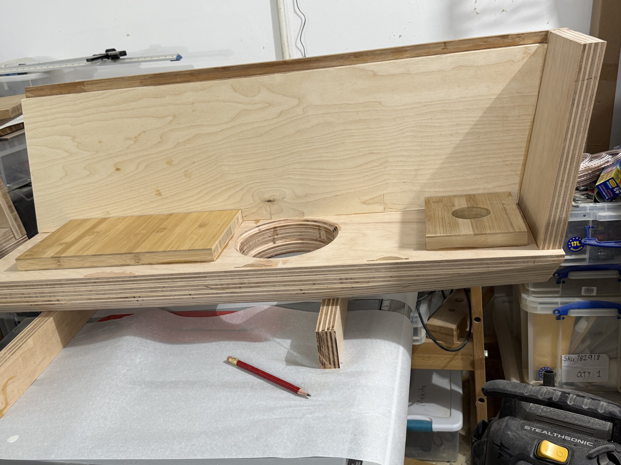

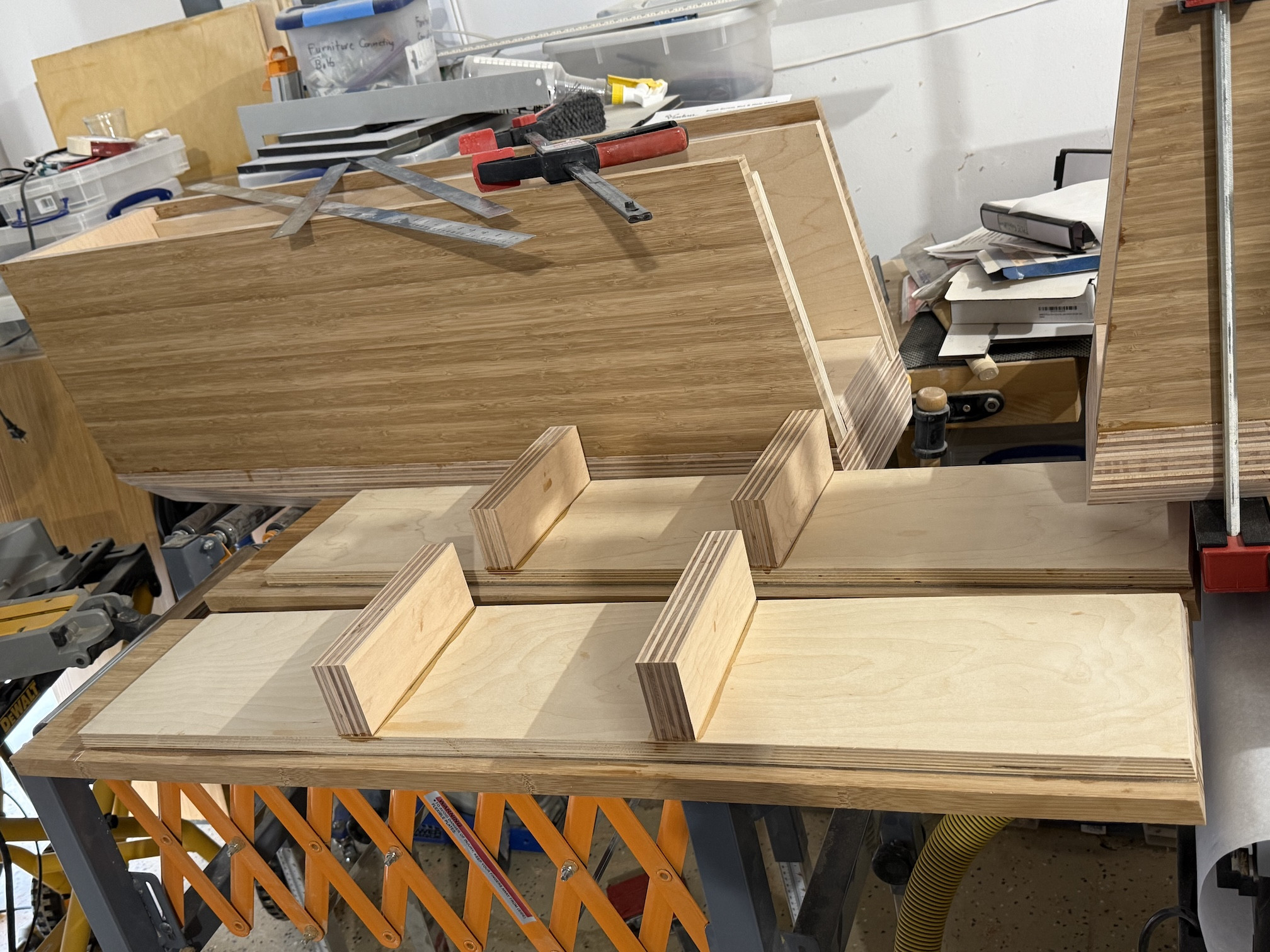

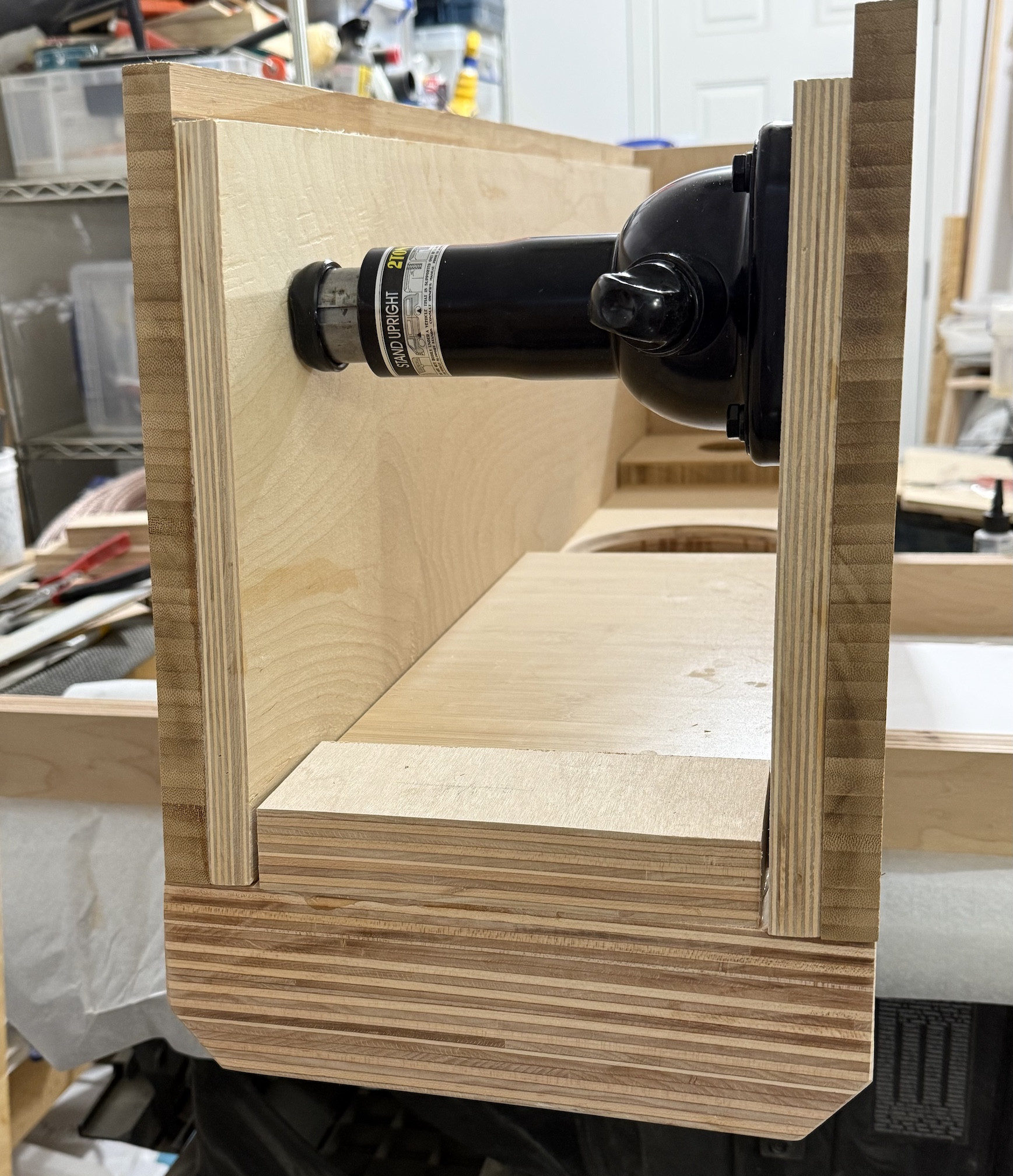

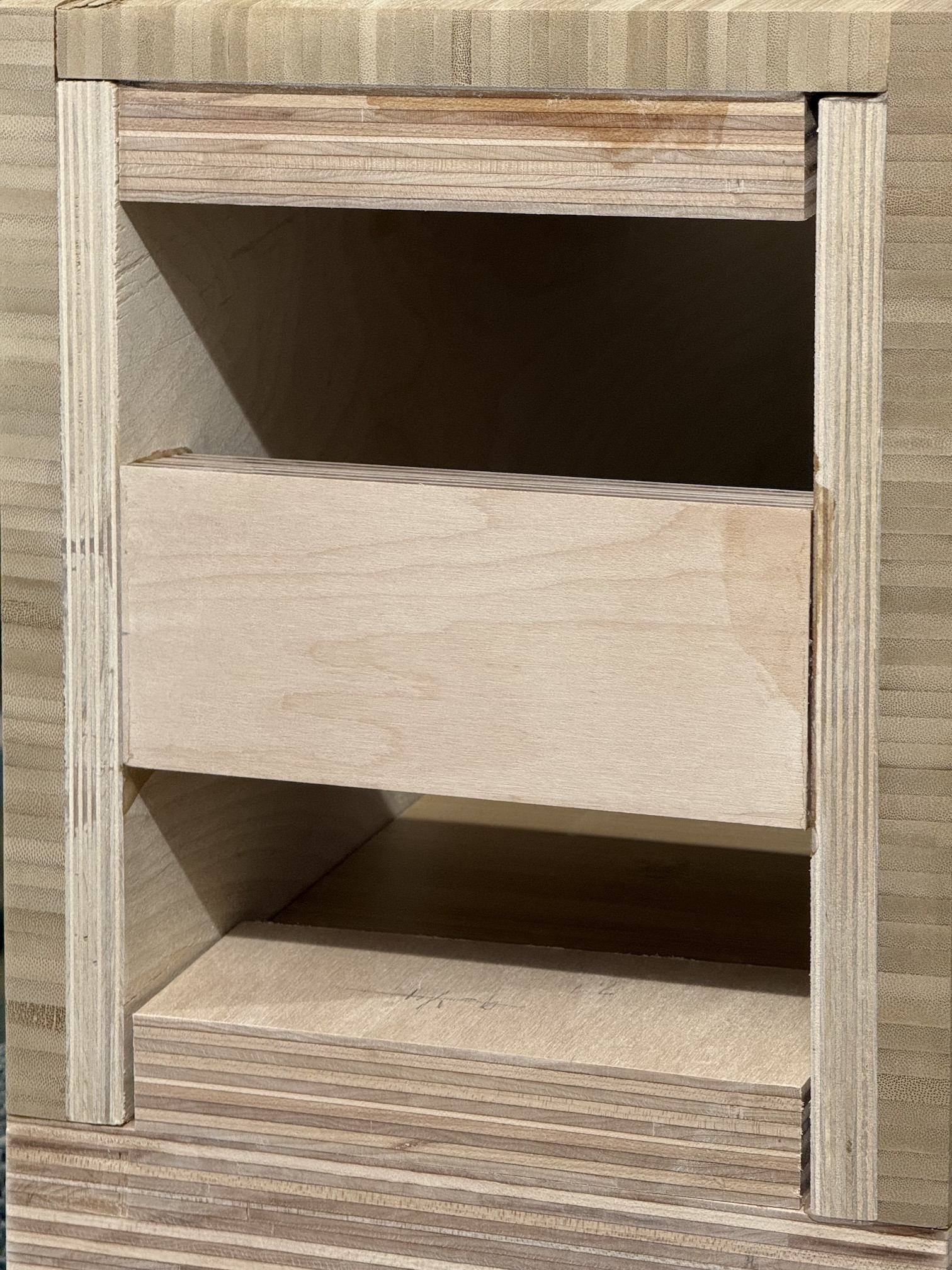

                Now, spacer panels added to back side of front panel baffles. New footer struts for inside bottom of cabinet fabricated, not yet mounted.
Name:	Tweeter and below Woofer panels.jpg

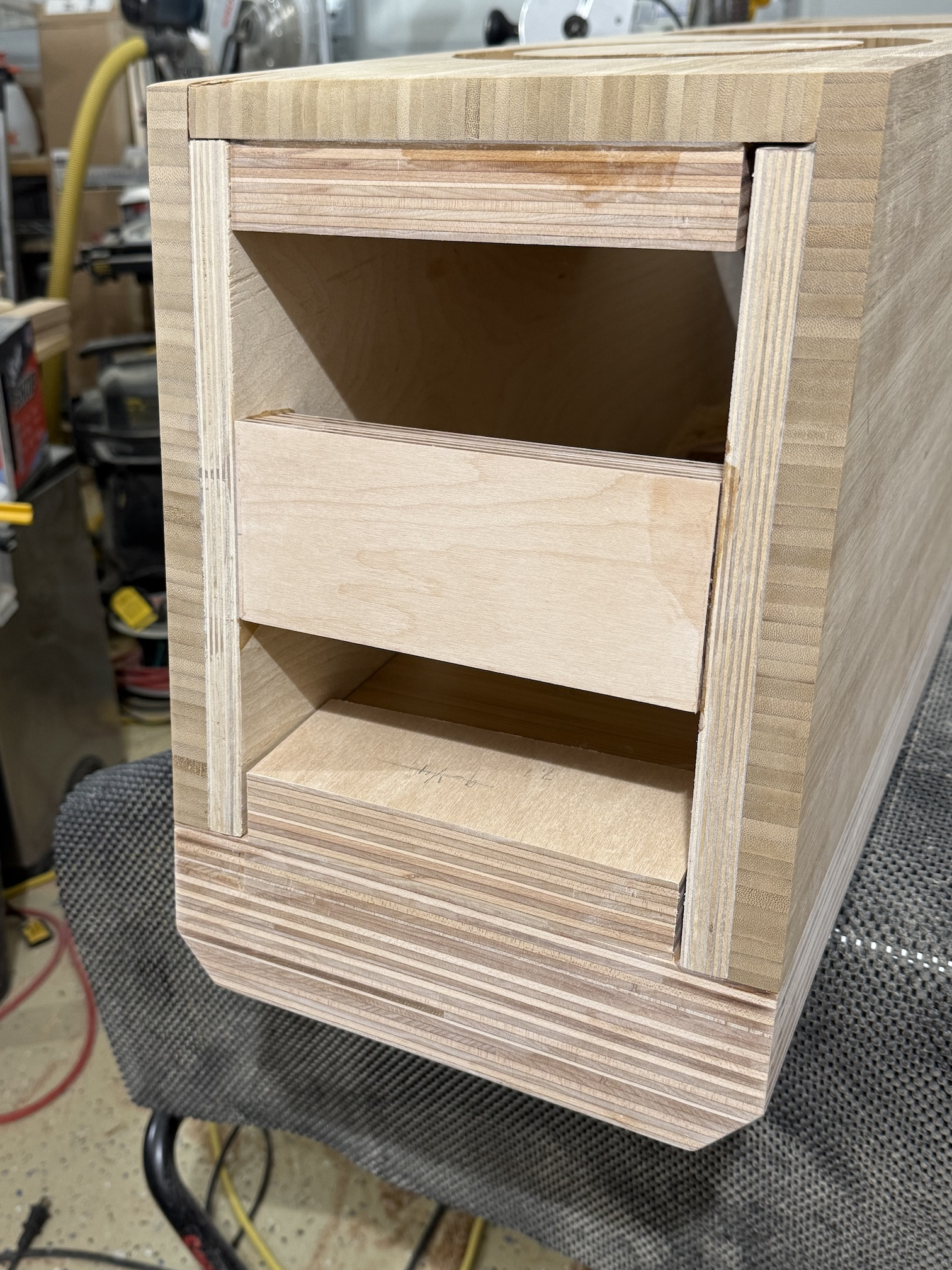

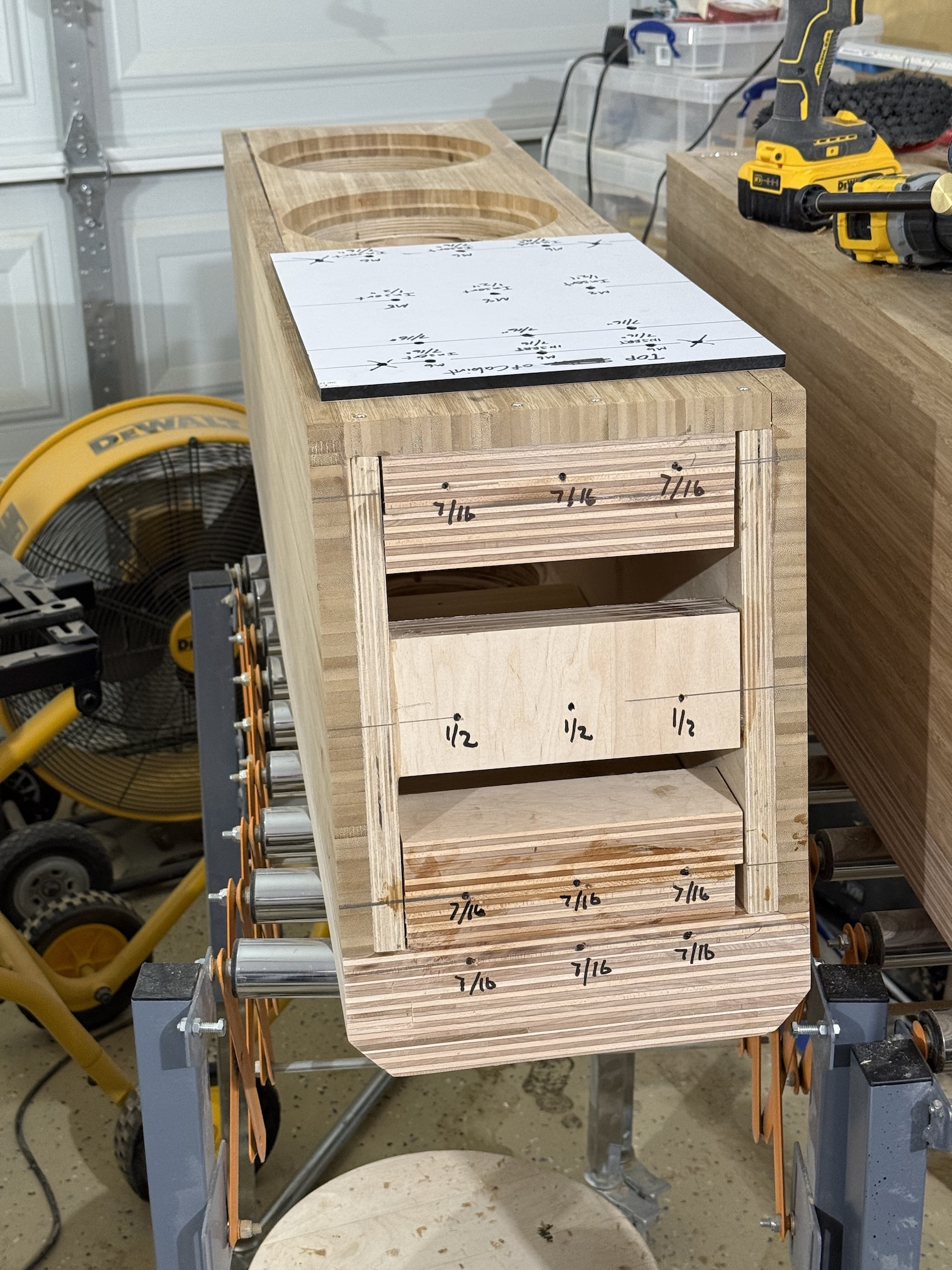

                  Next Up- Side+top combo fitment check, epoxy tomorrow
                  This is probably more detail about building the cabinets than some are interested in, but several folks have commented that this is helpful, and it's also for the couple of guys that are seriously into this, so the details of how to do it THIS WAY are fairly clear, especially for others that may be helping out. These enclosures are intended to be very stiff and non-resonant. The edge board supports will give room for the Bessey clamp heads underneath.
                  Side View
Name:	Next up Side.jpg
                  Bottom's up!
Name:	Next Up bottom.jpg

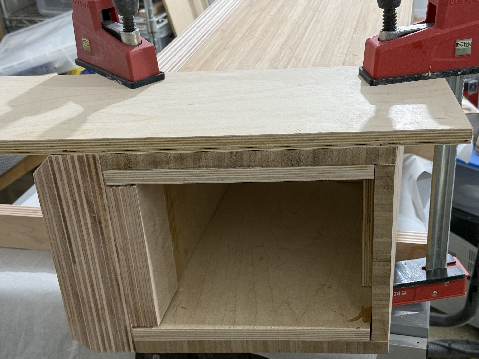

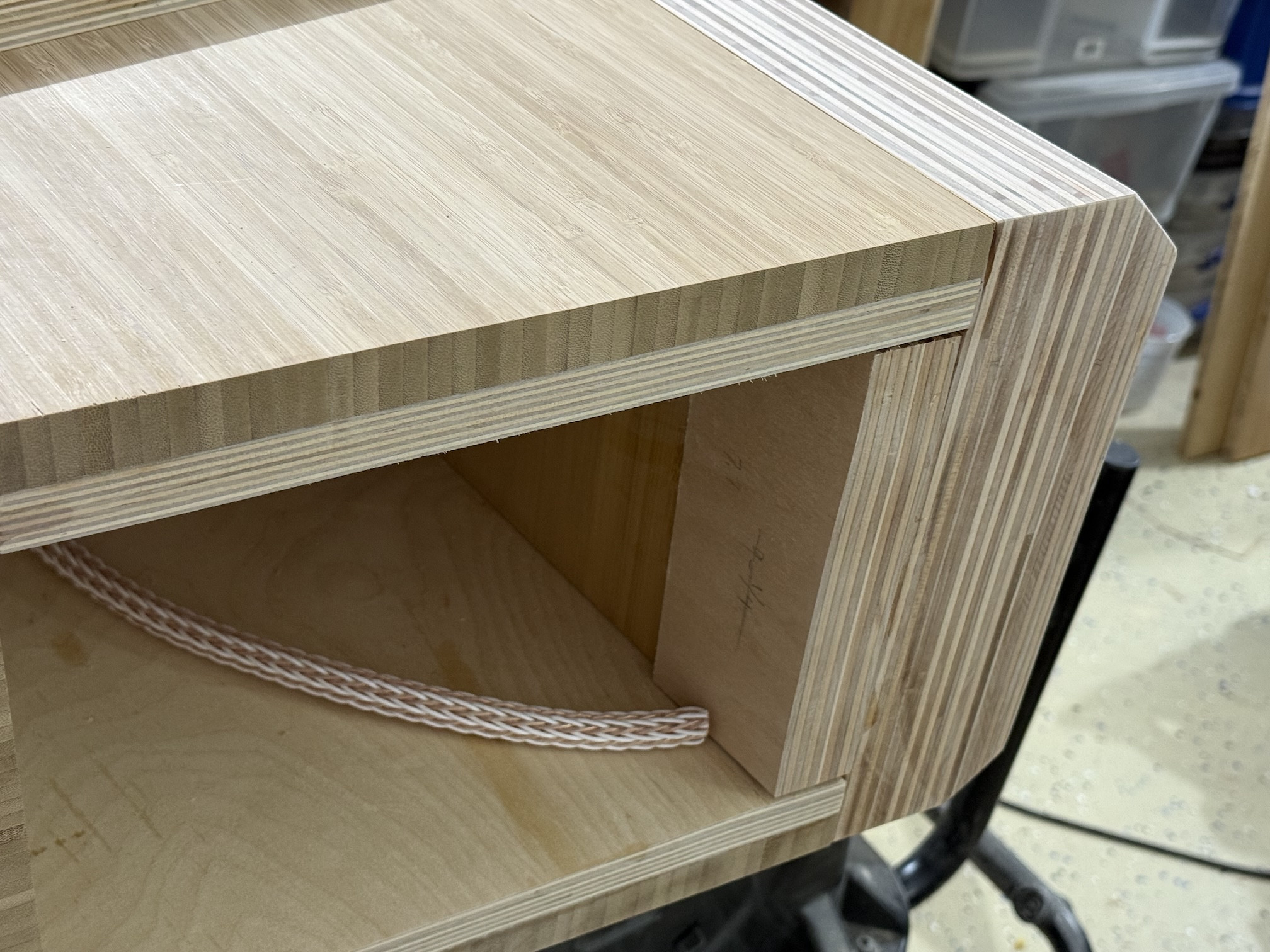

                  Making the "commitment" - after checking with both sides and back, glue up is started. To assure alignment each step of the way, I'm just adding one piece at a time- and of course cheating a bit on maintaining alignment with the Biscuit jointer. Though the Bob Smith epoxy sets up faster, that still means about 10-12 hours, instead of 20-24, so only one step per day.
                  And my scrap pieces of maple ply come in quite handy, as you can see below, but the same thing can be accomplished for assembly with just some cheap 2x4s.
Name:	walls on FP.jpg

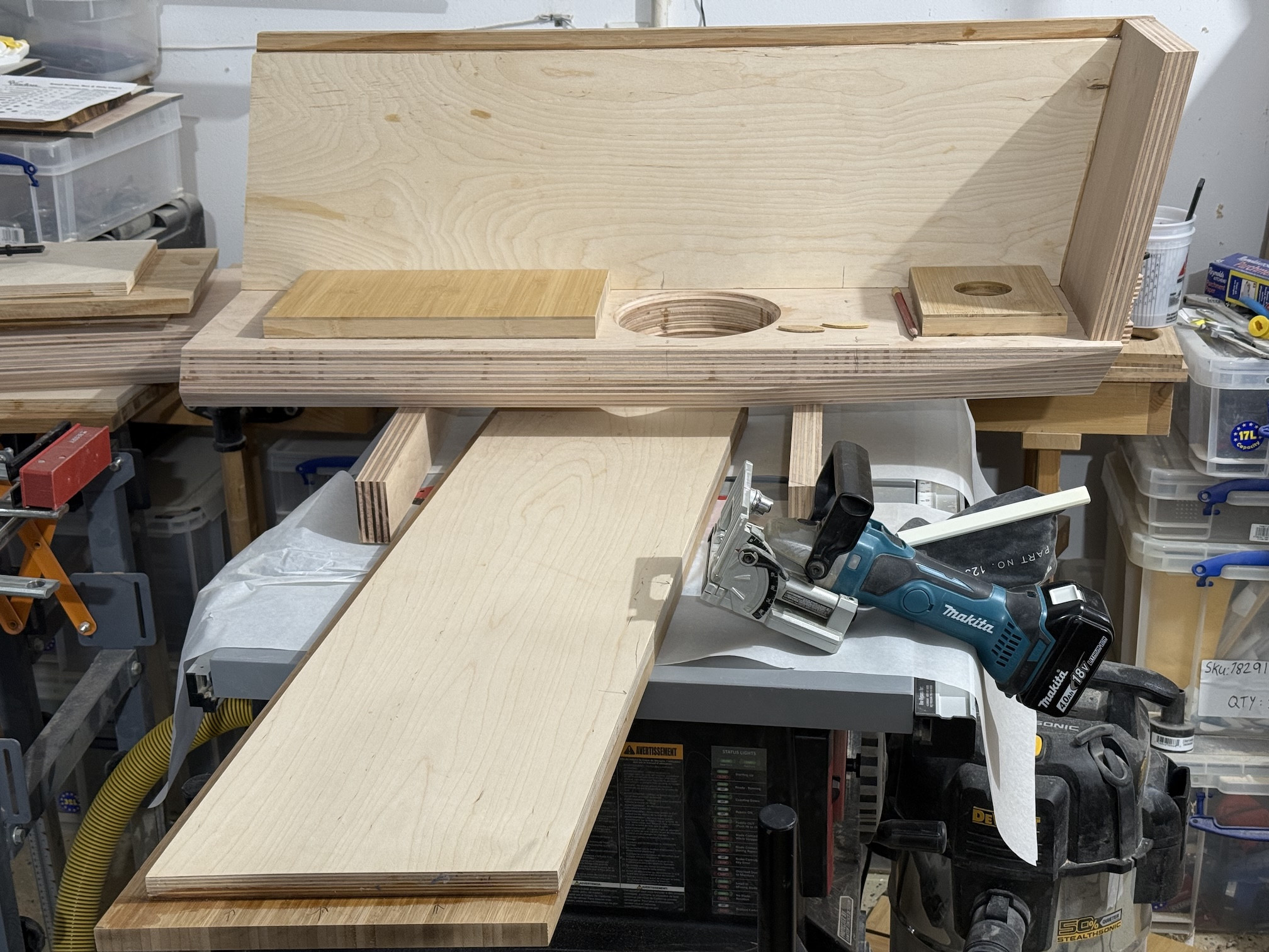

                    A bit of clean up sanding and some biscuit joinery to aid alignment control:
Name:	1-Getting ready for 2nd side.jpg

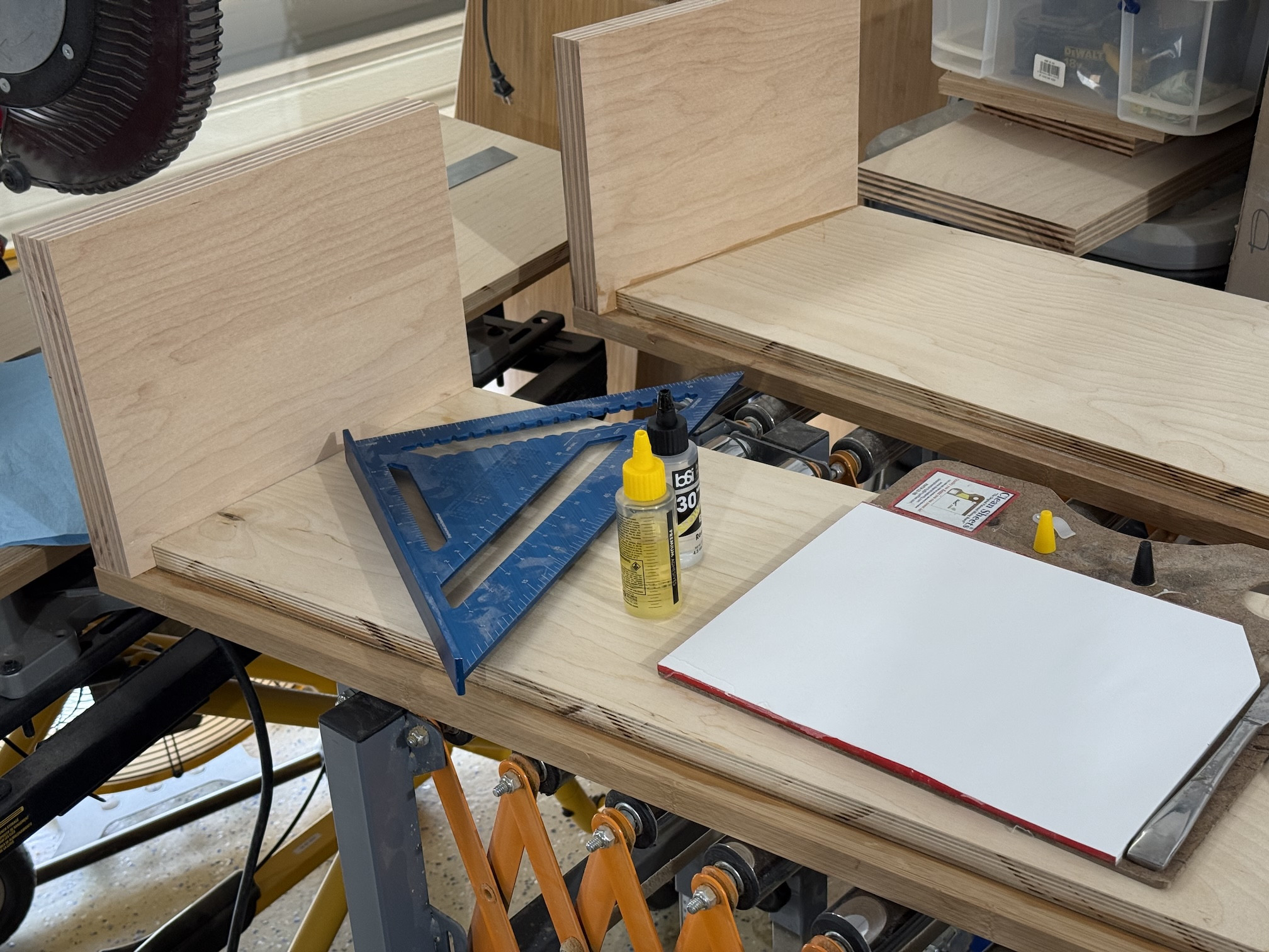

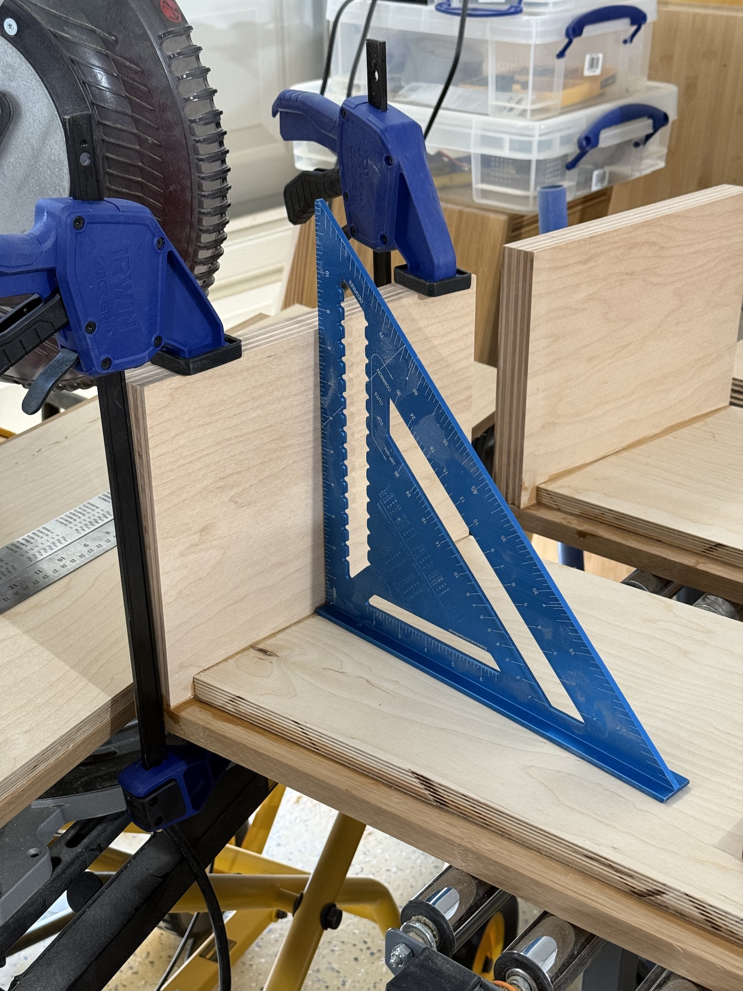

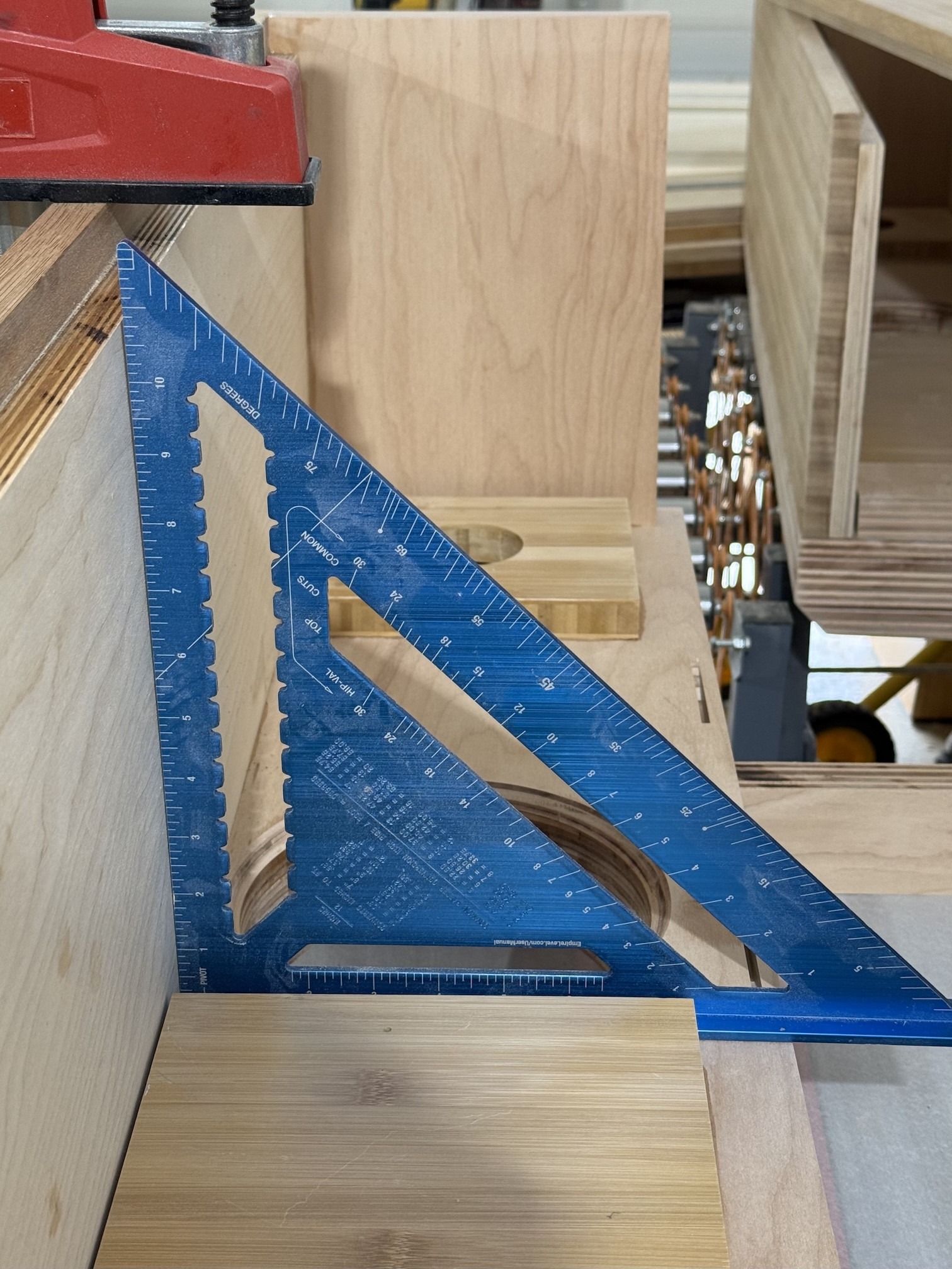

                        Back to productivity, starting the cabinet glue up for #2...
                        After doing the biscuit joinery, piecing things together and checking that alignment is looking good with our wedding mandated "something blue" is a good idea...
Name:	1 Angle Check close.jpg

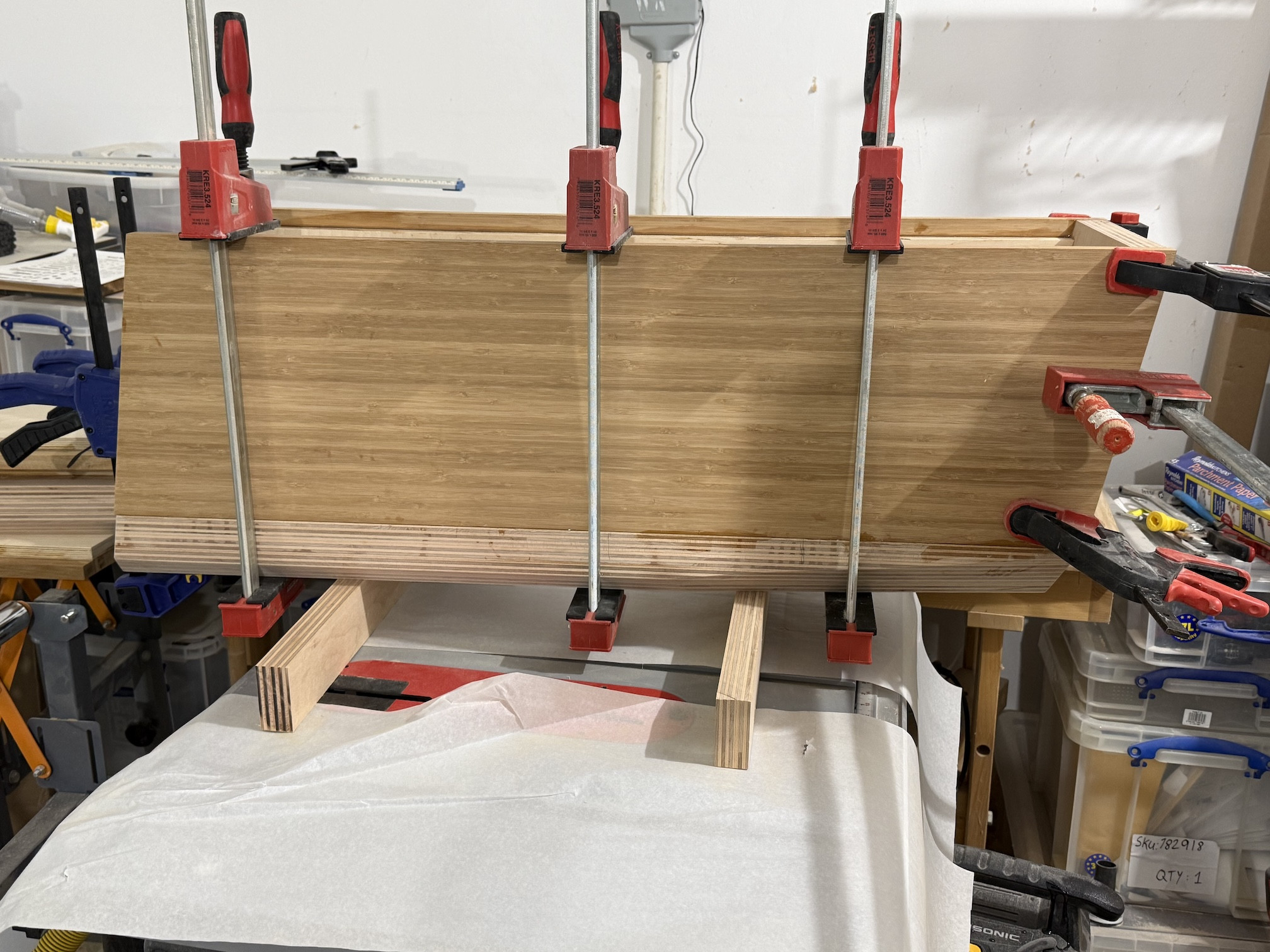

                        So, mix up the Bob Smith Industries slow set or whatever YOUR favorite is (DIYW), apply to the front panel, then place and clamp the side + top panel assembly:
Name:	2nd Clamped Up.jpg

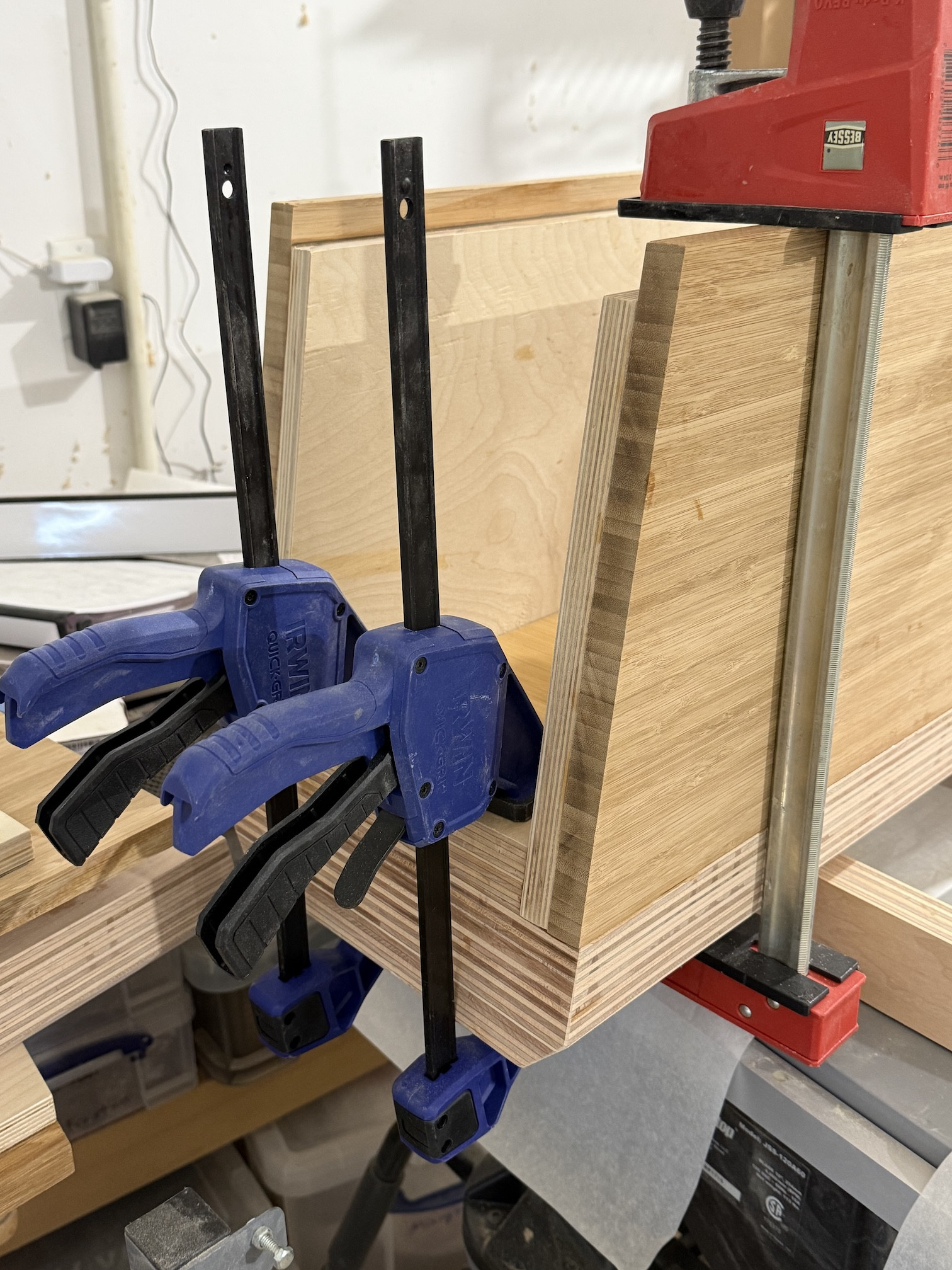

                        And if you're in the mood for it (I was), before snugging down the clamps tight, not a bad idea to re-check the angle fitment:
Name:	2nd Long View 1 clamp ujp.jpg

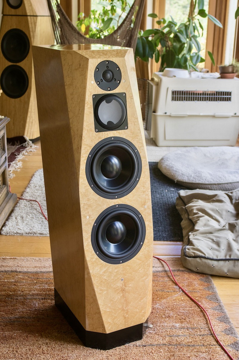

                          Now, a possibly important thought to share, if you're more in favor of a traditional build with simpler materials and a veneer skin, thats certainly doable, using the original M8ta examples as a jumping off point, or even the Wavecor Ardent, with some simple adjustments.
                          Here's a reminder, my initial Wavecor Ardent build, front panel width is in the ball park, and here I used Birds Eye maple veneer to good effect:
                          Click image for larger version  Name:	W-Ardent Birds Eye.jpg Views:	12 Size:	317.5 KB ID:	961379
                          This of course is more in the classic Avalon Acoustics style. As I mentioned before, one can even cut the bevels in the front panel if your table saw cuts deeper than average, and you can build a simple fixture to position it at 45 degrees, as shown in other posts.
                          And of course you don't need this much enclosure volume, so the front to back depth can be reduced to adjust that- look at how deep this goes in comparison to what I'm working on now.
                          Click image for larger version  Name:	W-Ardent on back.jpg Views:	12 Size:	349.3 KB ID:	961380
                          This pair ended up going to a colleague and close friend, from East Germany; he still lives in the Bay Area with his daughter, but is looking into returning to Germany to work there for Infineon a while longer and then retire somewhere like Ilmenau.
                          Click image for larger version  Name:	IMG_0266.jpg Views:	12 Size:	1.36 MB ID:	961381​

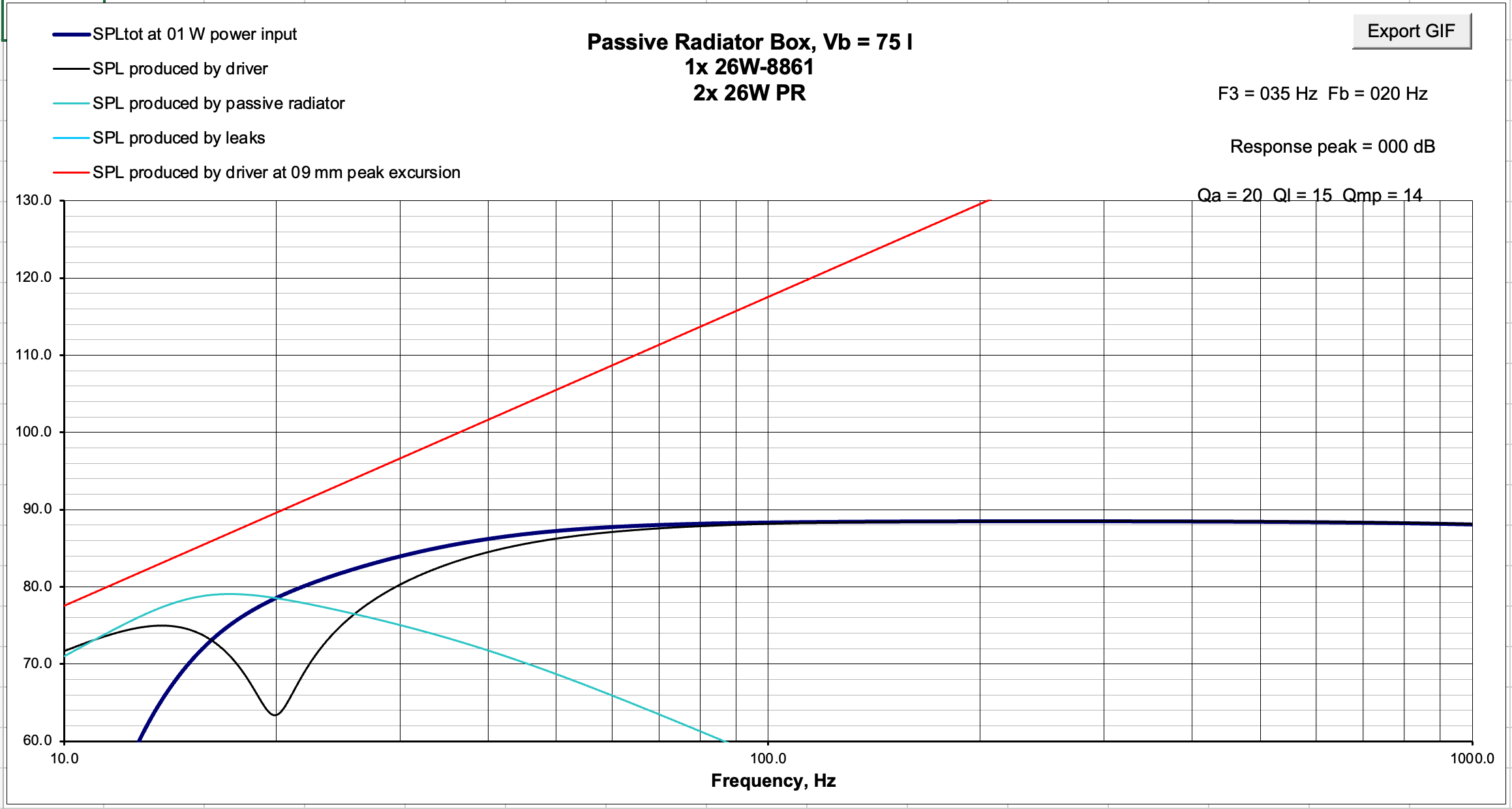

                            So I started looking into the 26W/8861.. and the first thing that caught my eye was the Qes of 0.33... Bingo! Potential Bessel high pass configuration!
                            Now, Steve, being the practical and frugal sort, was hoping to get by with just a single PR, but the compliance doesn't work out right that way, and if the maths don't math, then ya gotta do what you gotta do. I'll skip through the intermediate details and show you what I came up with:
                            Click image for larger version  Name:	SPL -3 dB 35Hz.png Views:	0 Size:	130.5 KB ID:	961383

                                Up and at 'em early, lots to do this Saturday!
                                This cabinet, after gluing, I needed to tweak the inside dimension just a teensy weensy bit after the assembly, so that the back panel would fit in properly...
Name:	1-Fine tweak interior wall spacing.jpg
                                Variable height stands like this come in handy at times for various things.
                                Then, laying in the epoxy and installing the back, with light clamping force, is just another rinse and repeat operation...
Name:	2nd Cab glue up backside.jpg
                                It's probably worth noting that the enclosure is getting fairly heavy at this point; I don't have a scale out here, maybe I can borrow one from in the house later.
                                This 75 year old can pick them up and move to a different table or support, but you want to think about it a little bit and make sure the floor is clear of anything that might trip up your footwork! The removable phenolic base plate shouldn't make any significant weight additions.
                                  • 16175
                                  One more shot I forget this morning that shows how things go with the back side when it's all assembled with good tolerances.
                                  Next step will be a slight follower leveling of side walls to back (if needed), then mark up for the PR locations and doing the rebate and through holes.
Name:	Backside overview.jpg
                                  No external event schedule forcing a Long March style pace of work, but I do want to get back to the Saint-Saëns Planar system!

                                    Sunday Day of Rest? Hah! As if!!
                                    Just as early, but a little quieter... some crossover analysis for Steve, some glue work on one cabinet, and mostly some sanding for the maple baffle edges on the other.

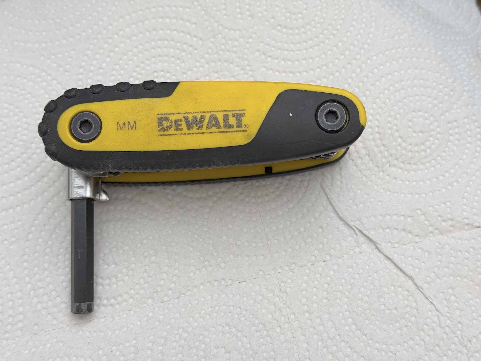

                                    When I'm dealing with hard rock maple, the optimum sanding tools can help, and in this case what I need is some Mirka Abranet 80 grit, and one of my DeWalt random orbital sanders. The thing I like about the Abranet Mirka stuff is how transparent to air it is- you could hold a fresh piece up to your mouth and have no trouble breathing through it, no matter where you kiss it, not even if you're running. And it cuts quite well...
                                    Click image for larger version  Name:	DeWalt sander for 80 grit.jpg Views:	0 Size:	745.0 KB ID:	961423
                                    Good progress made, but you know, I think I'm going to just continue Monday morning. That's what Mondays are for, right?
                                      • 16175

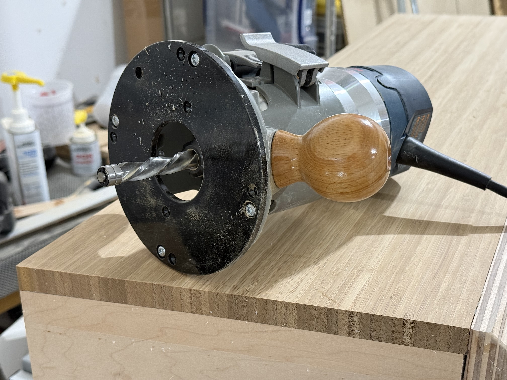

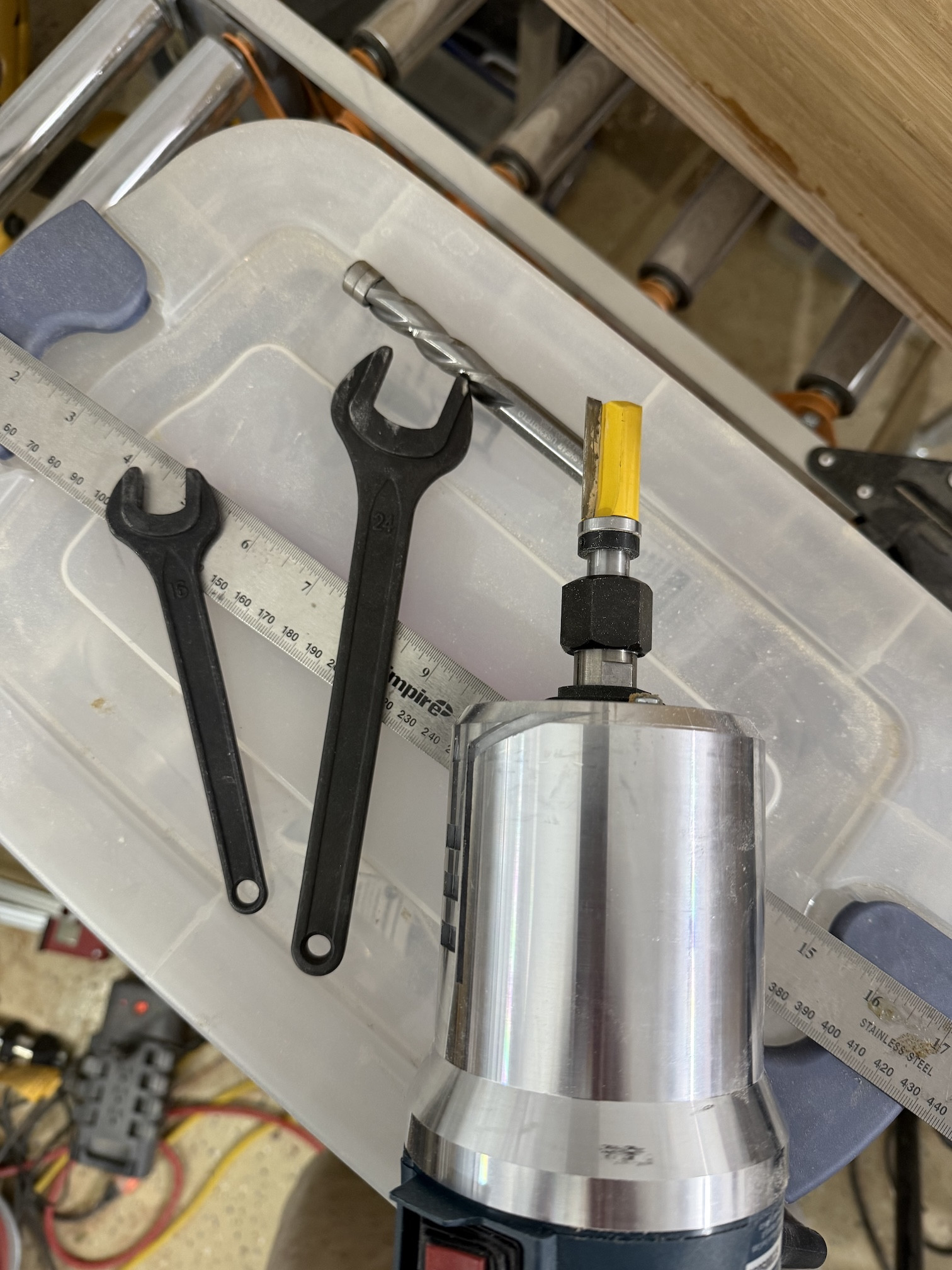

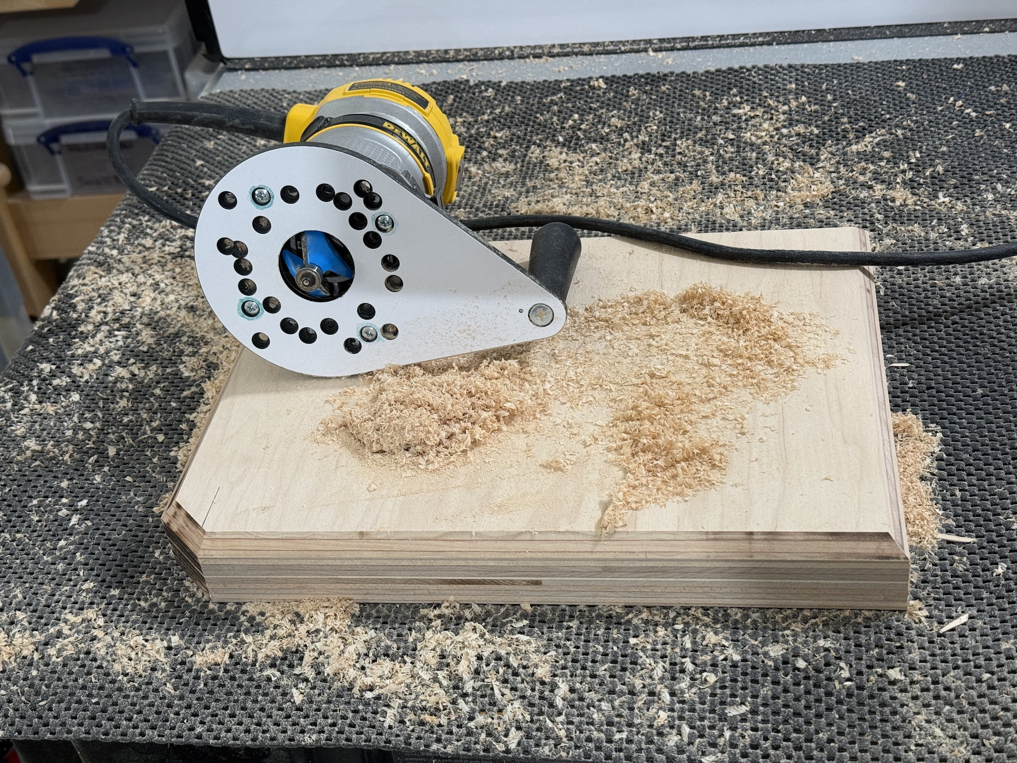

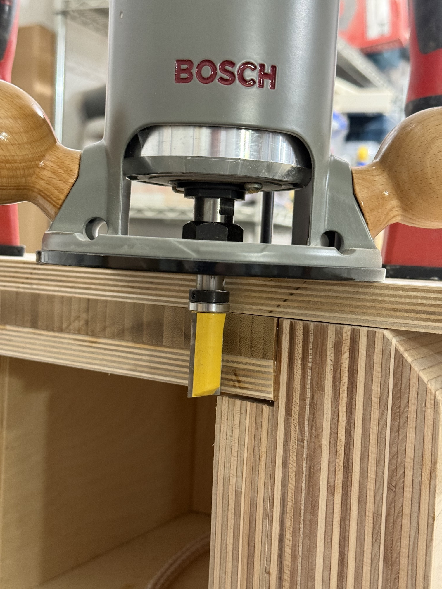

                                      It's been all about sanding and panel fitment routing (trimming to flush). No CNC here, folks, just elbow grease! And Something New, the new fixed base Bosch router.
                                      There are two bits to be used in these steps, a classic 1-1/2" cutting near body follower, and a solid carbide 1/2" tip follower.
                                      Here, getting the more basic one ready, to do detail trim using 3/4" BB ply as an alignment fixture.
                                      Click image for larger version  Name:	1-Something new ready.jpg Views:	0 Size:	560.3 KB ID:	961434
                                      This shows how it's used making a trim cut in the side walls at the base, and by trim, we're talking 1/32 to 1/16", to line things up with the front panel. .
                                      Click image for larger version  Name:	2-Something new BBPly jig.jpg Views:	0 Size:	691.6 KB ID:	961435
                                      Of course, one must hold the trim guide firmly in place, and this shows how I do it.
                                      Click image for larger version  Name:	3-Clamp Jig 4 Trim.jpg Views:	0 Size:	689.1 KB ID:	961436​
                                      And here, how it looks after I do a trim pass. Of course, I have very high precision bionic eyeballs and incredibly sensitive fingers checking and calibrating the alignment- we don't need no CNC here!
                                      Click image for larger version  Name:	4-After Trim pass.jpg Views:	0 Size:	689.1 KB ID:	961437​

                                        You didn't think we were done for today, did you?
                                        Of course, we've got to check all the trim adjustments carefully...
                                        Click image for larger version  Name:	5-Check Trim.jpg Views:	0 Size:	691.3 KB ID:	961440
                                        Oops! Shouldn't have left that top secret view of tweeter cable in the picture!
                                        The problem with this left and right side of the cabinet is that you have to do both sides!
                                        Click image for larger version  Name:	6-Do the other side.jpg Views:	0 Size:	666.0 KB ID:	961441

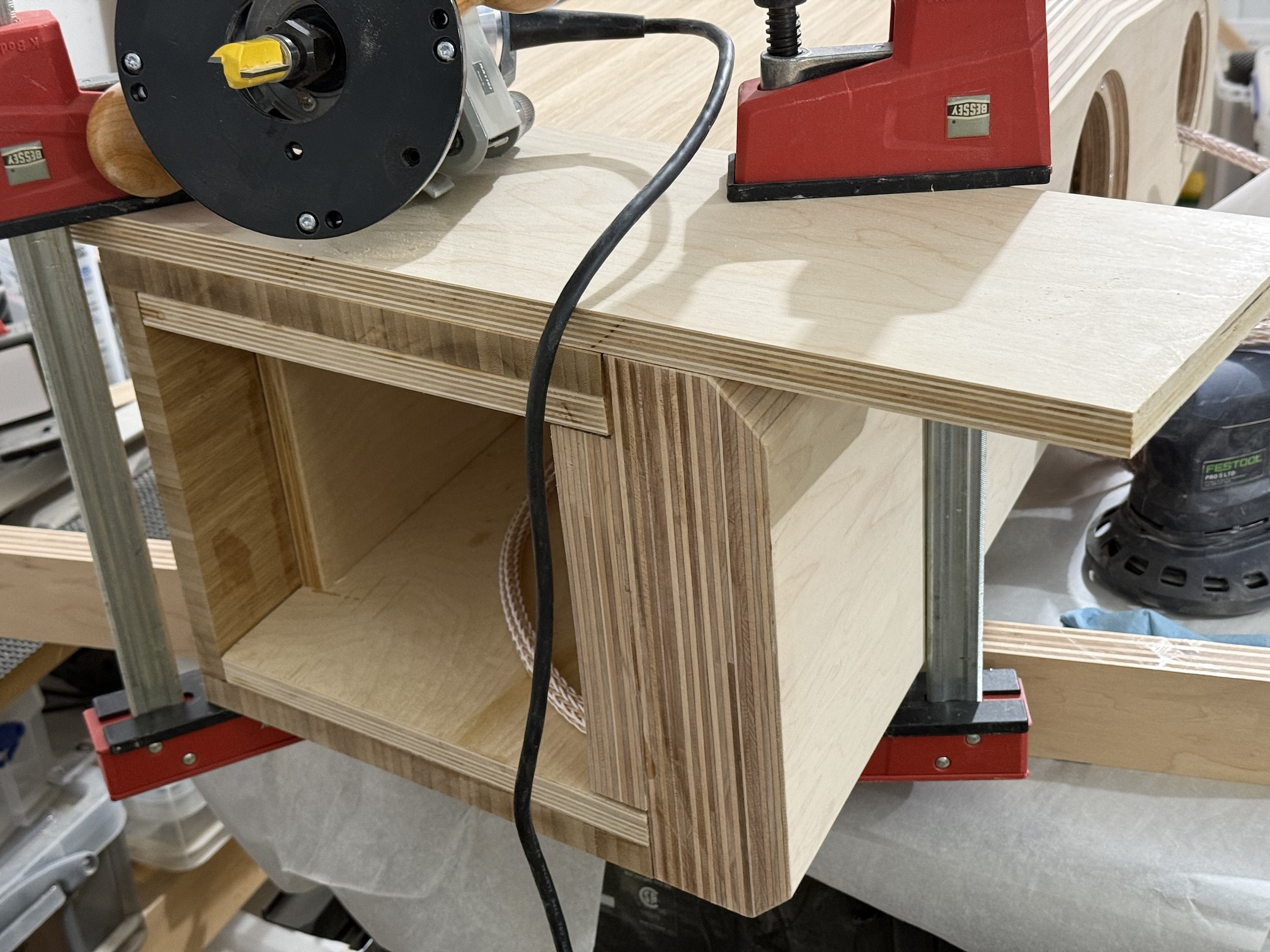

                                        But once these outside trims on the base are done, we can switch to the solid carbide follower bit for the overhang trim... I prefer the long ones, better stability in motion I find... This is mainly for leveling the side walls on the back with the back panel- may not need anything, may need a teensy bit- flush fits make a better impression on your friends... unless you're really going for the "Idaho Rustic Look", as I usually do.
                                        Click image for larger version  Name:	7-Solid Carbid follower overhang trim.jpg Views:	0 Size:	722.5 KB ID:	961442​
Name:	8-Ready forNext.jpg
                                        So, here's cabinet number 1, ready now for the next major step, which will be routing the rebates and through holes for the RSS210PR going into the back panel, and installing threaded inserts. I know, I know, you're all thinking,

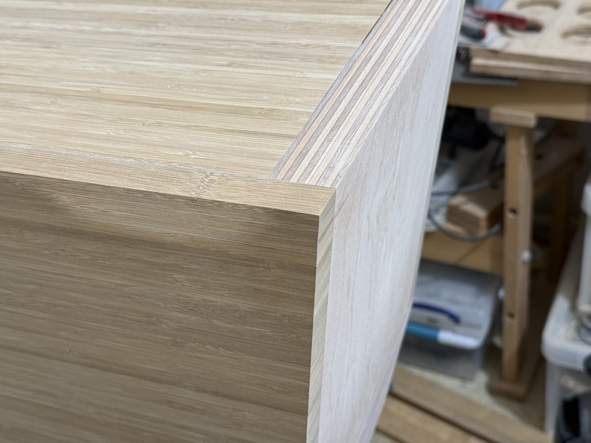

                                        Side panel and back sanding down to 220 grit done also, and it looks like the desired level of fitment accuracy is being achieved, though it may disqualify this build from the "Idaho Rustic Achievement Award".
                                        Click image for larger version  Name:	2-Edge-Corner finishing.jpg Views:	0 Size:	635.8 KB ID:	961454

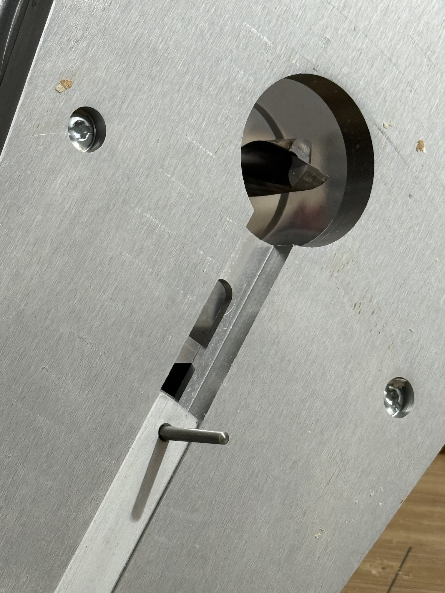

                                        Yesterday was busy on many fronts- one of them being fixing my router jig; the folded metal pin to make a "peg" for 1/8" router centers finally gave up the ghost. I suspected their might be a reasonable chance I could find something useful at our local Ace Hardware, and sure enough they came through, with a drawer of tapered steel pins of just the right length, and one of the exact size I needed. Installed it in the fixture, and just had to tap it down about a quarter of an inch for a nice snug fit.
Name:	1 Tapered Pin.jpg
                                        Works quite nicely, and frankly, it's how it should have been built to begin with.

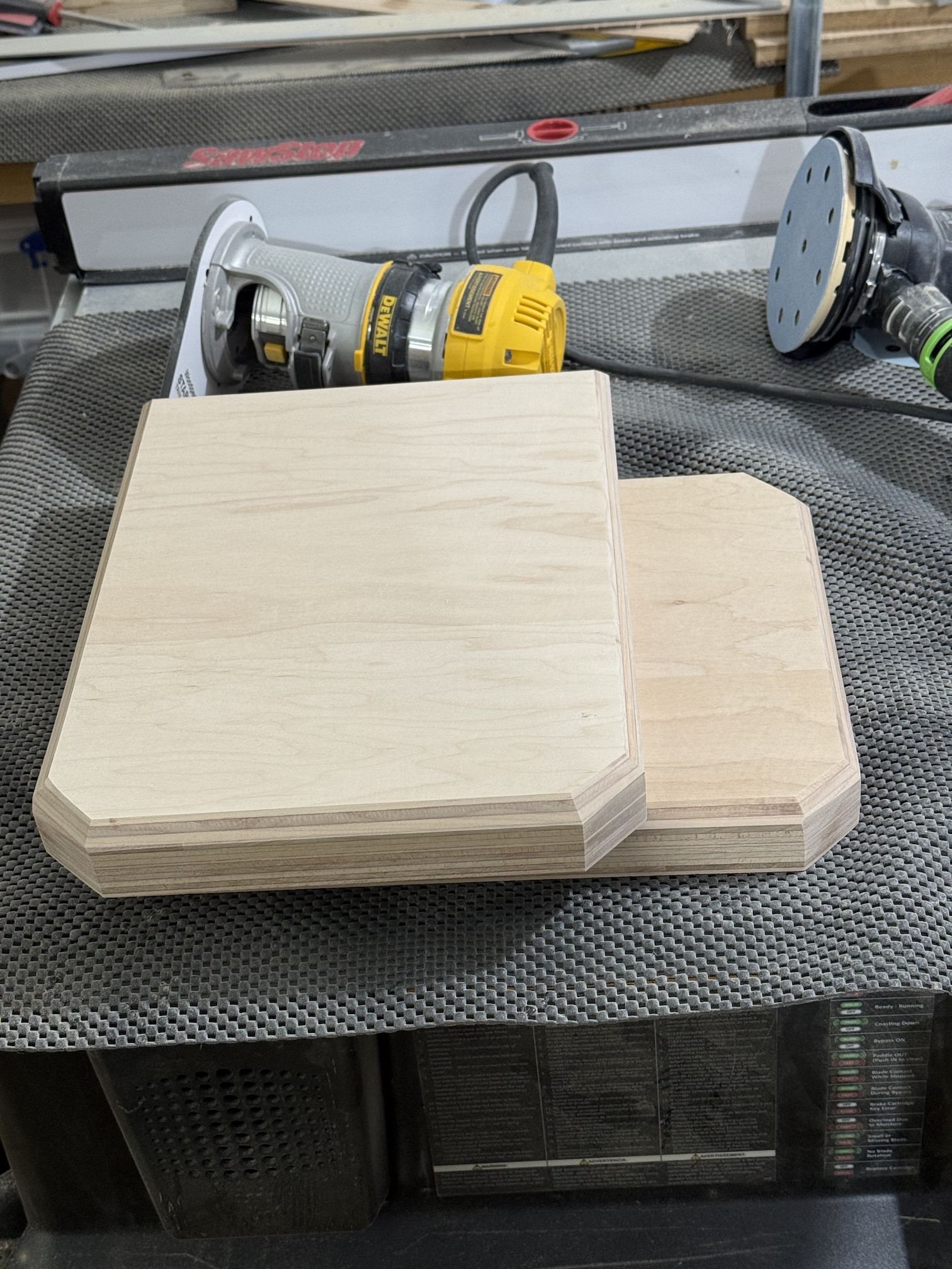

                                        First tasks was clean up sanding on the prototype base plates.
Name:	1-Sanded baseplate.jpg

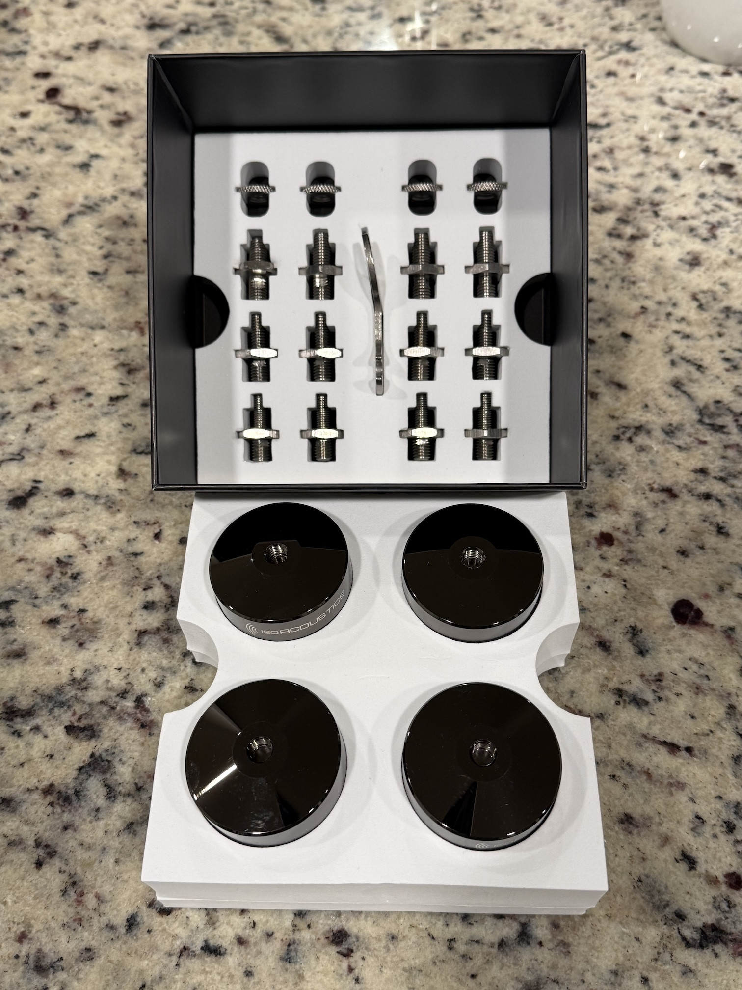

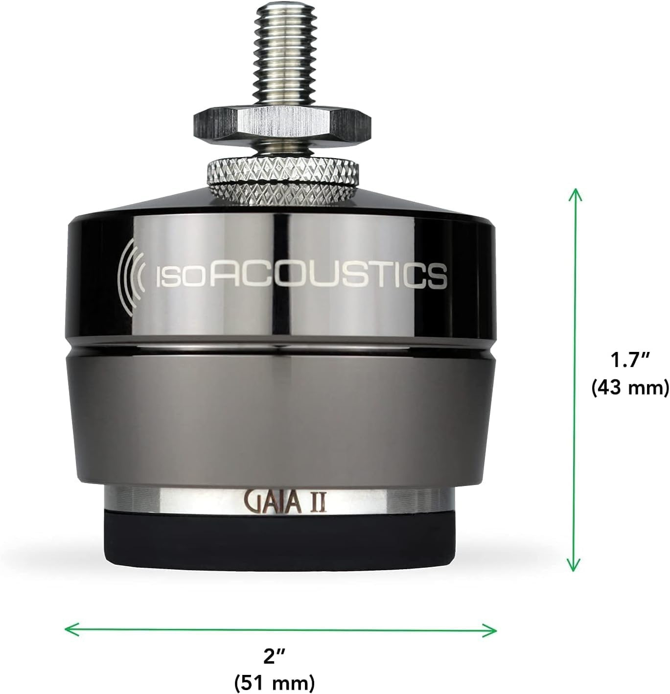

                                        The GAIA 2's were received yesterday, and they make a strong first impression...
Name:	GAIA 2 received.jpg
                                        Developing and testing a home made version of these would be a significant time distraction- these are just too convenient, especially with the included custom hardware options for mounting.
                                        And, then too, how would I get these guys to test my home made footers?

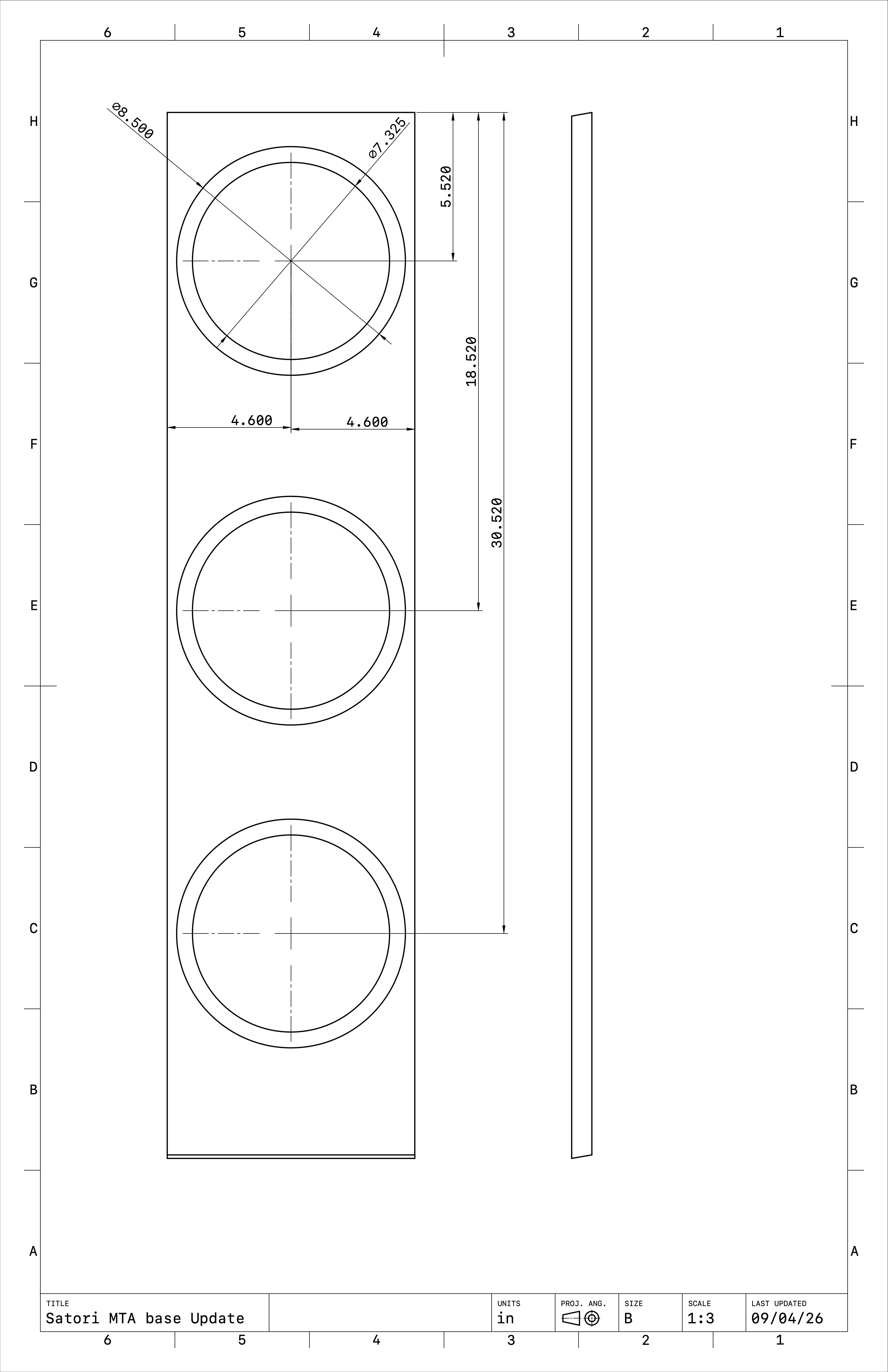

                                        So, I prepared a simplified 2D drawing of the outer back panel and locations for center of each PR, and worked from that (larger print!) to do a light pencil layout on the backs.
Name:	Satori MTA Back Fab Update.jpg

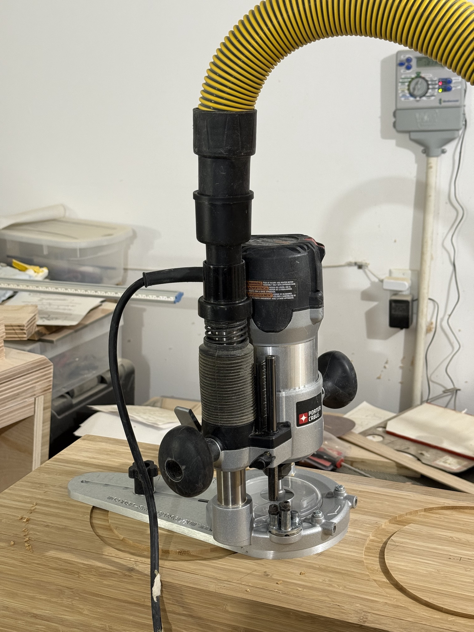

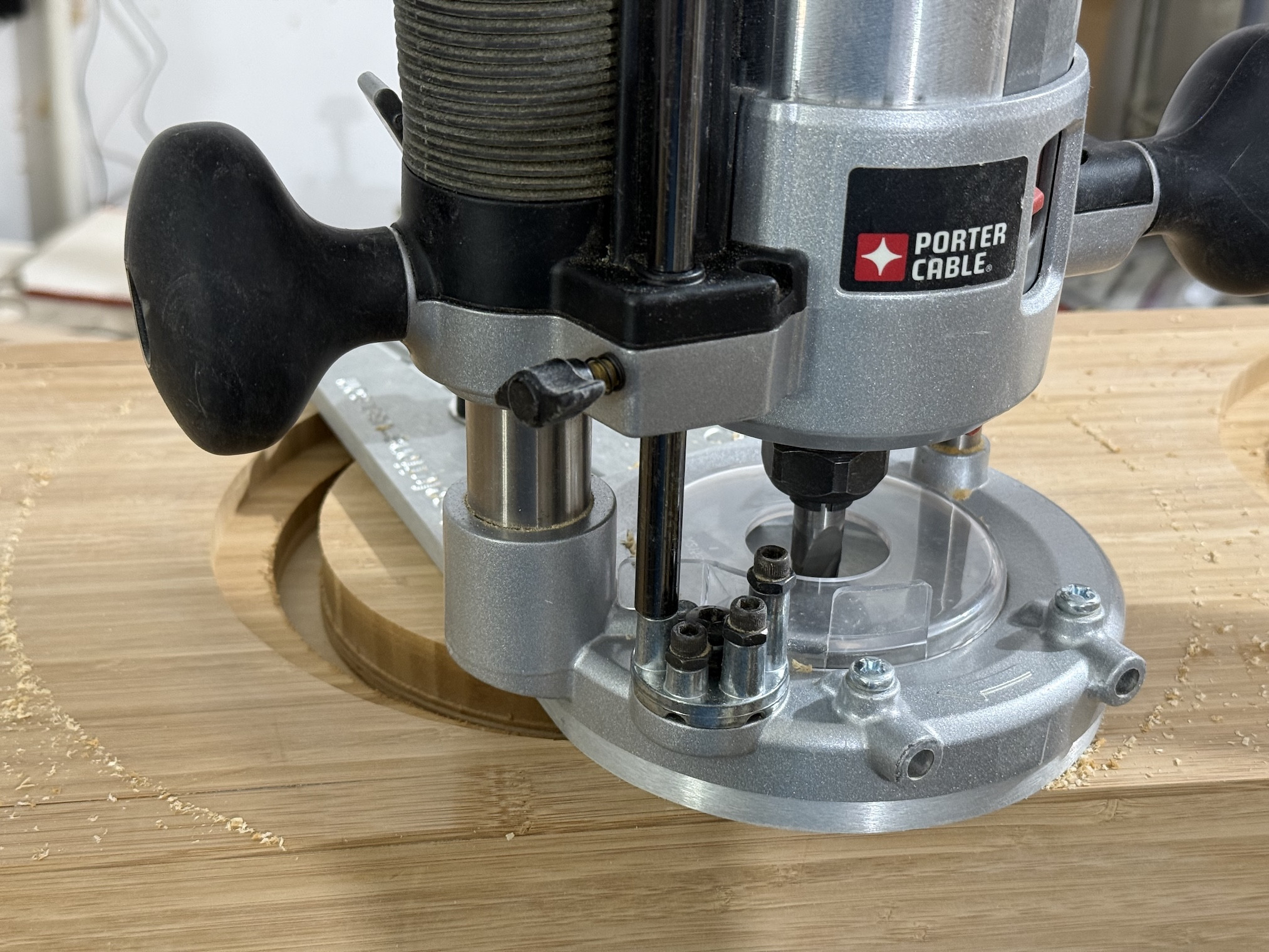

                                          From there its straight forward- drilling the routing pilot holes...
                                          Click image for larger version  Name:	2 Routing pilot holes.jpg Views:	0 Size:	674.3 KB ID:	961473
                                          Shallow pilot cuts to start the outer rebate support for the PR's...
                                          Click image for larger version  Name:	3 First cuts complete.jpg Views:	0 Size:	672.5 KB ID:	961474
                                          Then deep cuts- here, for the inner through hole; note, setting up the cutting depth steps ahead of time using the plunge depth control. I step through three different depths, in this case the last one leaving a thin 1/4" thickness of panel holding stuff in place, which will be cutout with a saber jig saw, and then cleaned up with follower bearing router.
                                          Click image for larger version  Name:	4 Router close up.jpg Views:	0 Size:	721.9 KB ID:	961475​

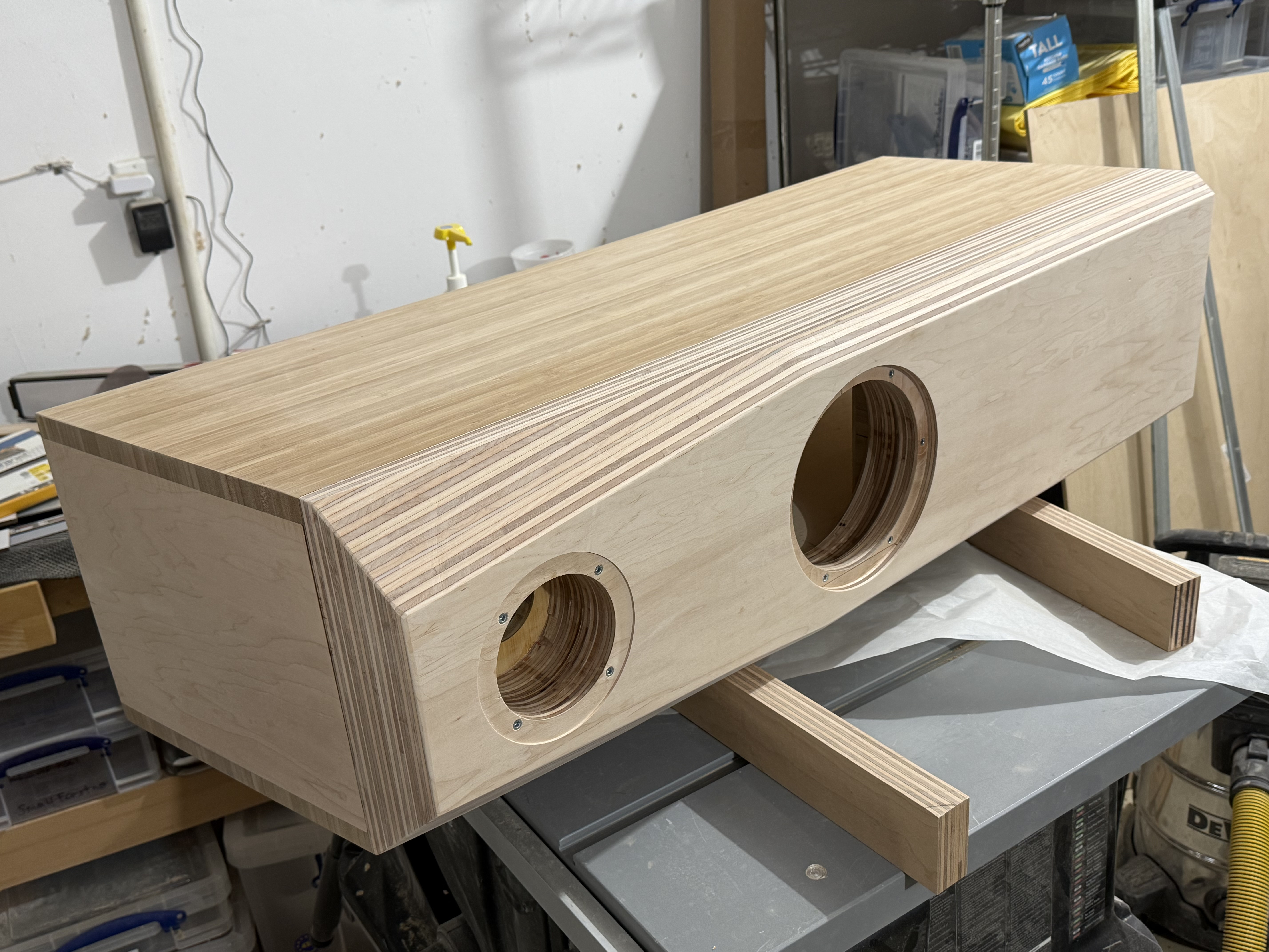

                                                Up at 5 today, and the morning is just about gone! Why does slow work take so long?
                                                well, double checking stuff, re-setting up fixtures, blah blah, it all takes time!
                                                However, do have a little to show for it- should be more later...

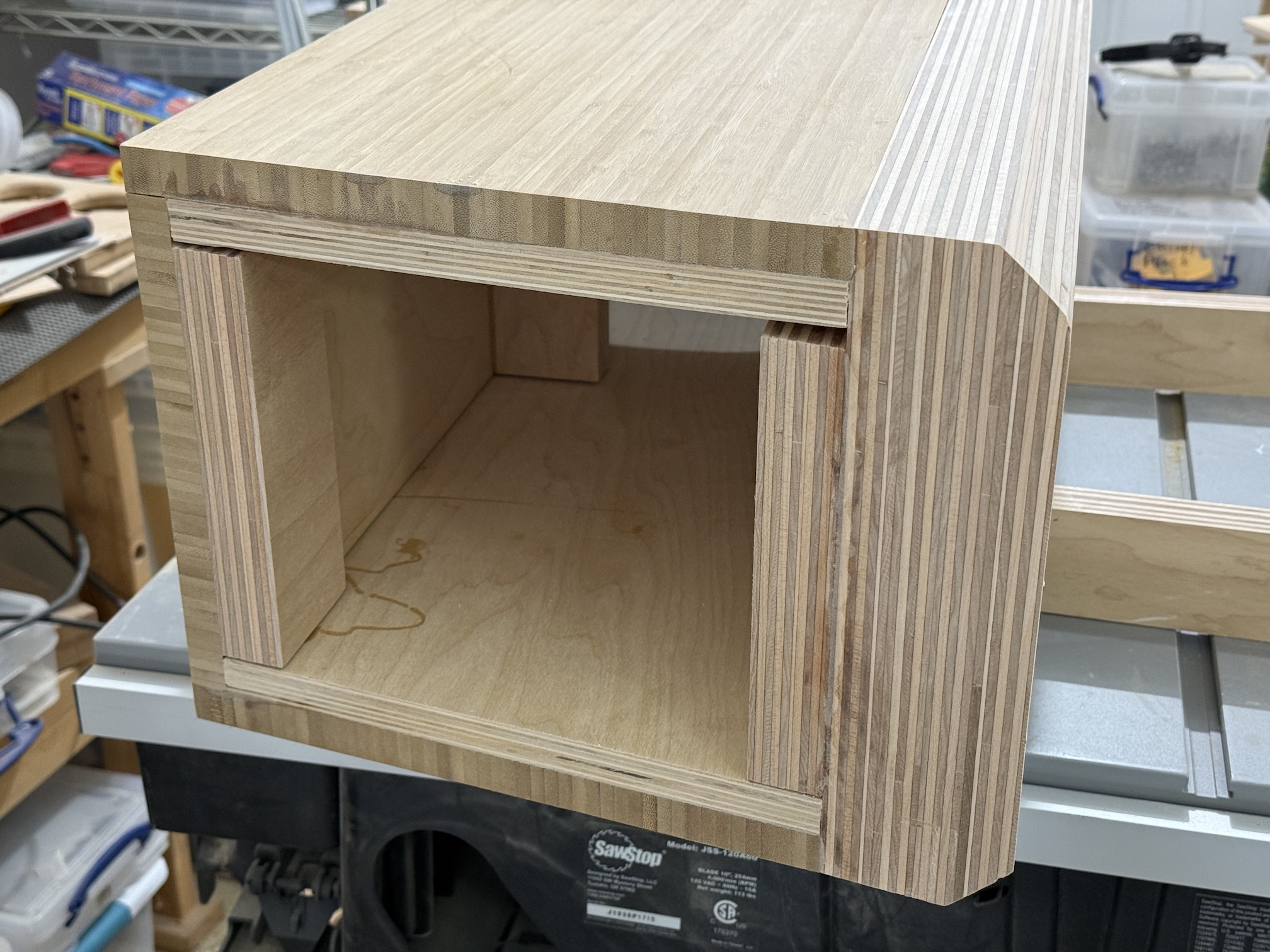

                                                I figured a fitment test might be a good idea with all these PR holes I'm making...
Name:	PR Fitment check.jpg
                                                And I mentioned a new bottom end cross brace strut as an additional structural aid in mounting the base panel, it's not real without a picture on the internet, right?
Name:	Bottom center strut added.jpg

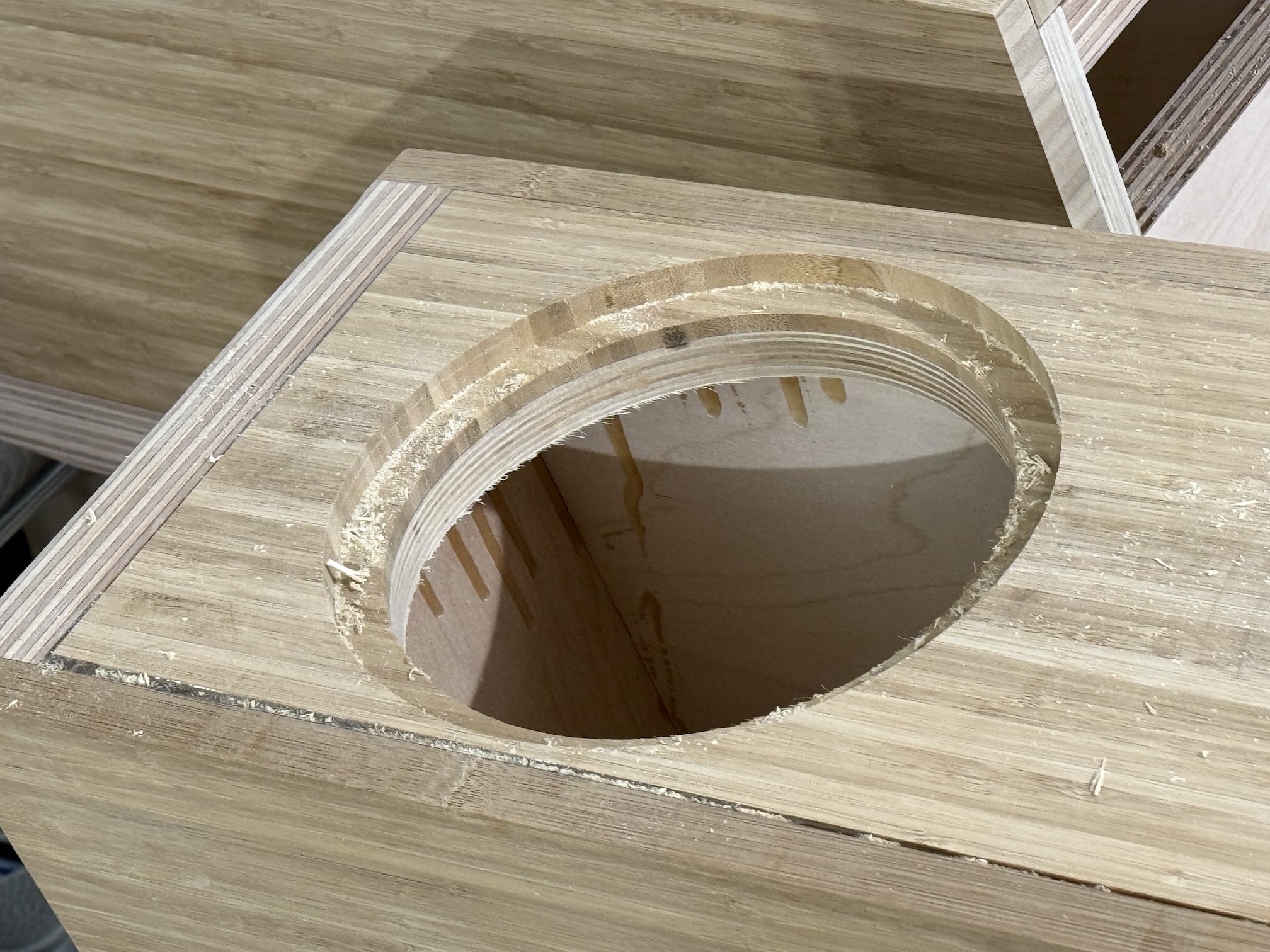

                                                After lunch, back to the PR center cut-outs, and then center punching locations for the threaded inserts!
                                                And maybe some musing rumination about the mechanical connectivity of the bottom plate to the support feet and to the enclosure- need to layout a phenolic board as a template for the execution on the cabinet and the base plate.
                                                Oh, wait, Sunday day of rest? How about Labor Day of Rest?
                                                  • 16175
                                                  Well, it's Labor Day, and I've decided my official theme for the day is an old gem from the Eagles...
                                                  "Taking it easy"
                                                  So, a bit of work in the shop, more routing and cutting out of PR pass through area...
                                                  Click image for larger version  Name:	PR Routing & Cut.jpg Views:	0 Size:	744.0 KB ID:	961488

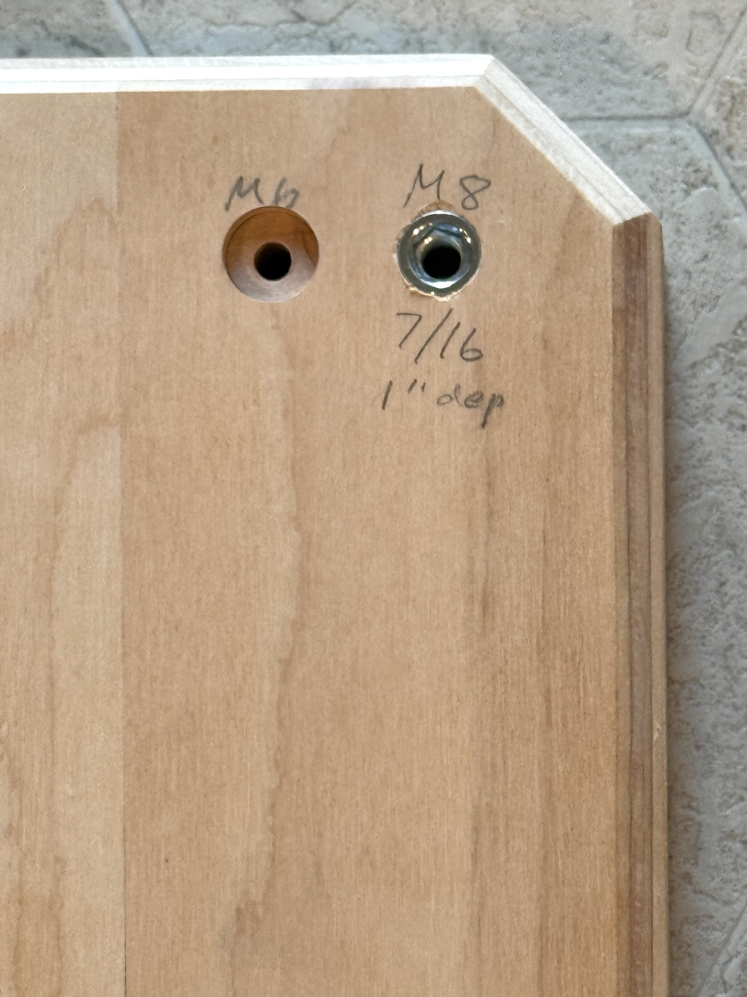

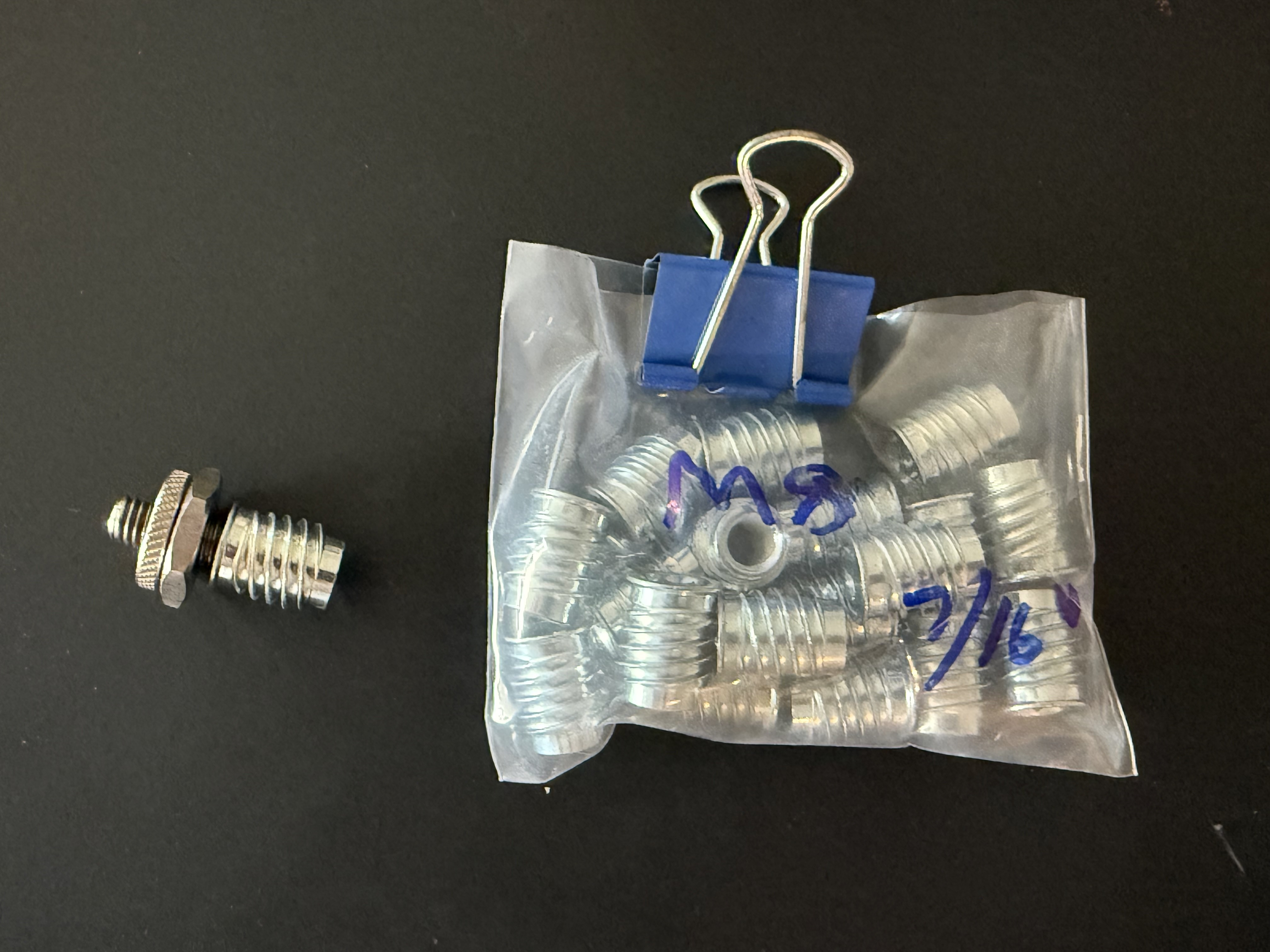

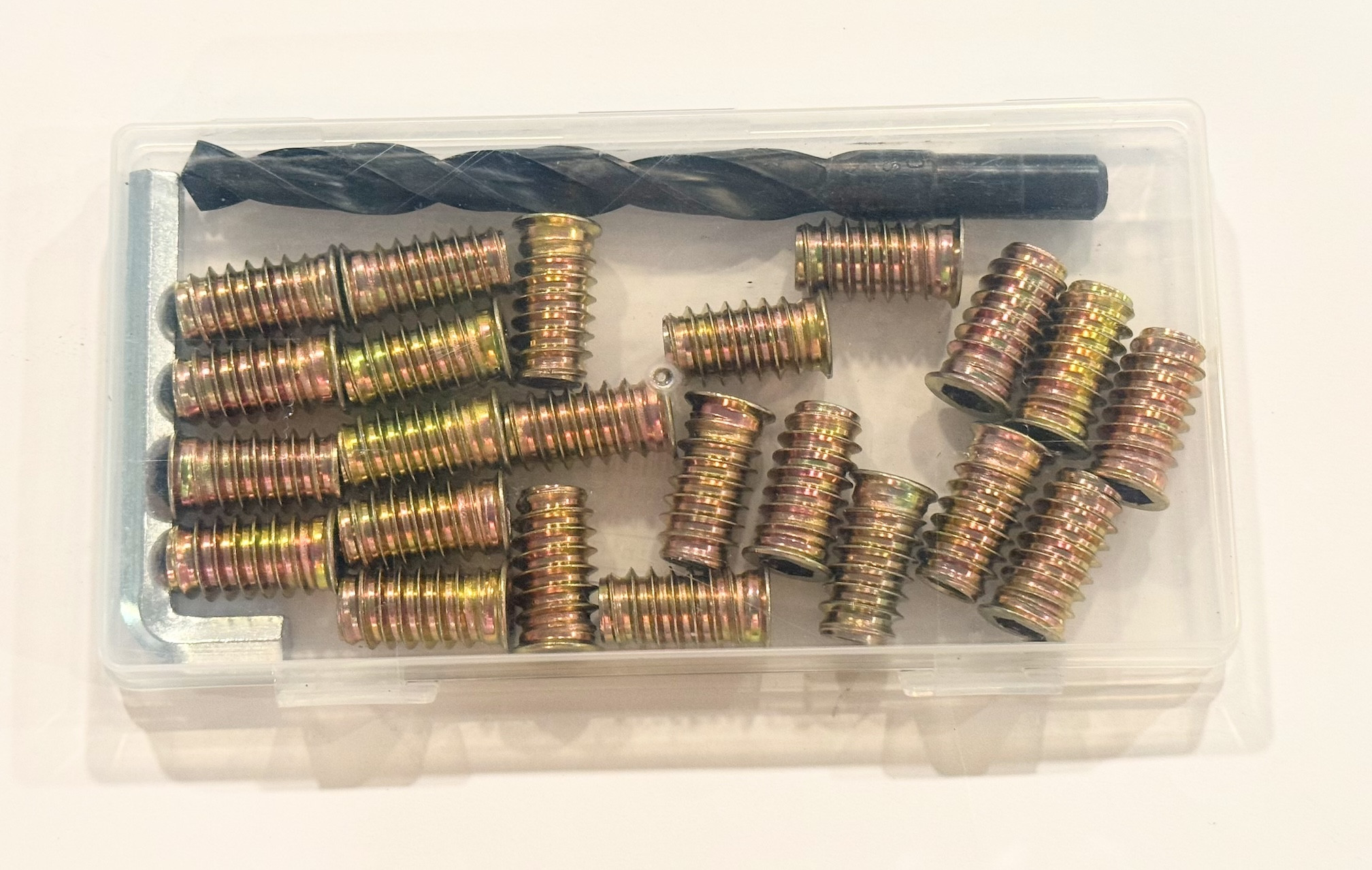

                                                  But next up, a little about the M8 threaded inserts- one set arrived yesterday from Amazon, another from Amazon is due today, but the RAMPA ones won't be here until around the 15-16th, next week.
                                                  Now, this is a good example of AI illustration in advertising-
                                                  What Amazon is showing for this product:
                                                  Click image for larger version  Name:	Amazon M8.jpg Views:	0 Size:	560.4 KB ID:	961489
                                                  AND, on the other hand, what was actually received:
                                                  Click image for larger version  Name:	M8 Received 05.jpg Views:	0 Size:	548.5 KB ID:	961490​
                                                  The shoulder area near the top collar actually measures 7/16", and this correlates with the actual drill bit diameter, so this should be functional. The Hex Key fits nicely, but I do wonder if it's going to be of sufficient leverage (length) for driving into Maple. An accessory tool might be a good idea.
                                                  However, though the construction of the parts look sturdy, I'm not charmed by the slop in fit of the threaded portion with the M8 bolt from GAIA. So, I'm glad I have two more alternatives on the way to check out.
                                                  I'm going to spend some time on the layout today for the baseplate and specifically the template pattern- started that yesterday. Heck, I might just see about finishing the current Rick Partlow novel I'm reading- fourth in a series of 4- his military SF is very engrossing for me, because of both the ways he approaches future technology development and usage, based on socio-political issues, and how the relationships within the military and political teams ring true for me.

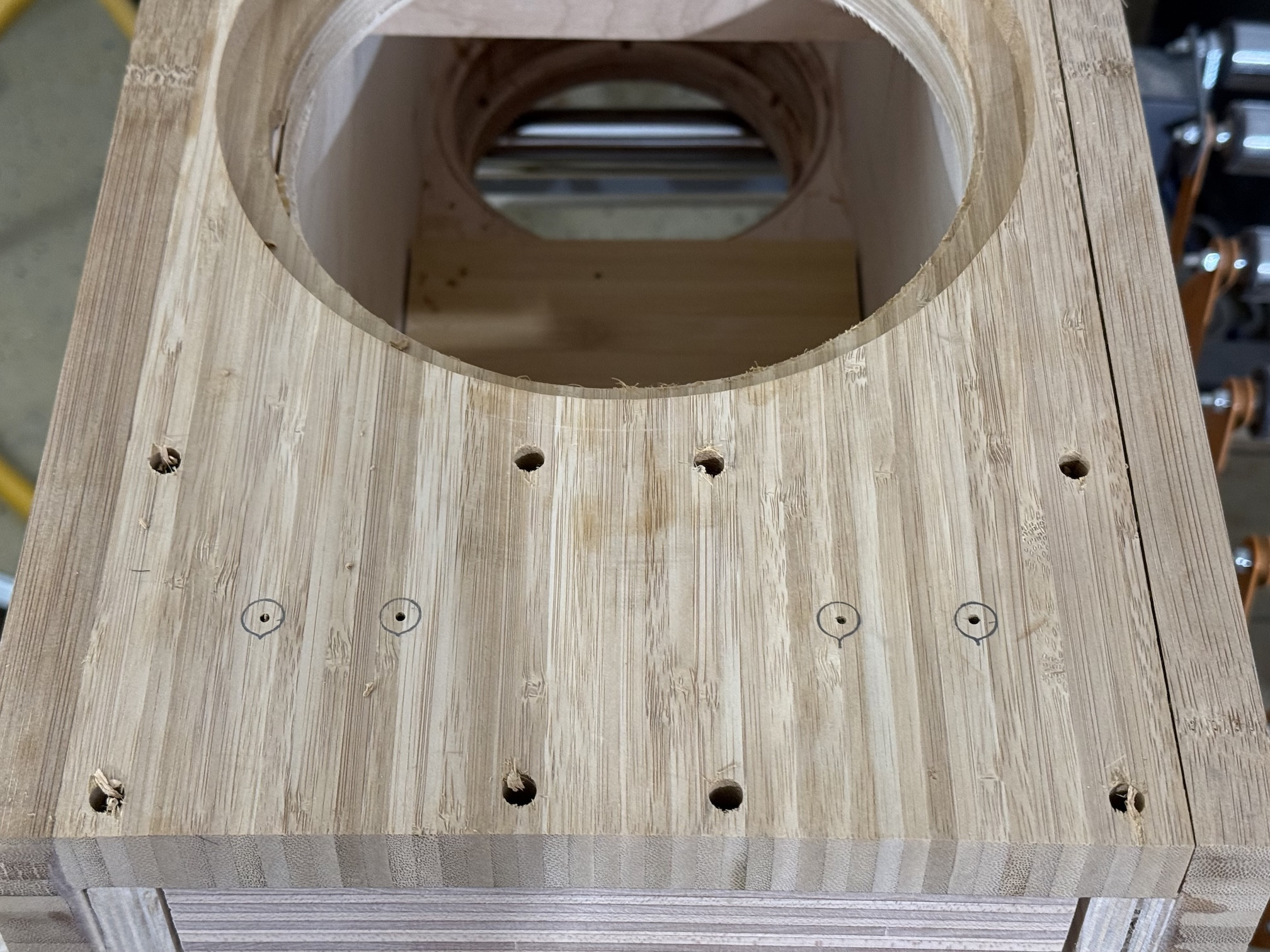

                                                    • 16175
                                                    Talk about a week of distractions and waiting for stuff ordered to arrive!

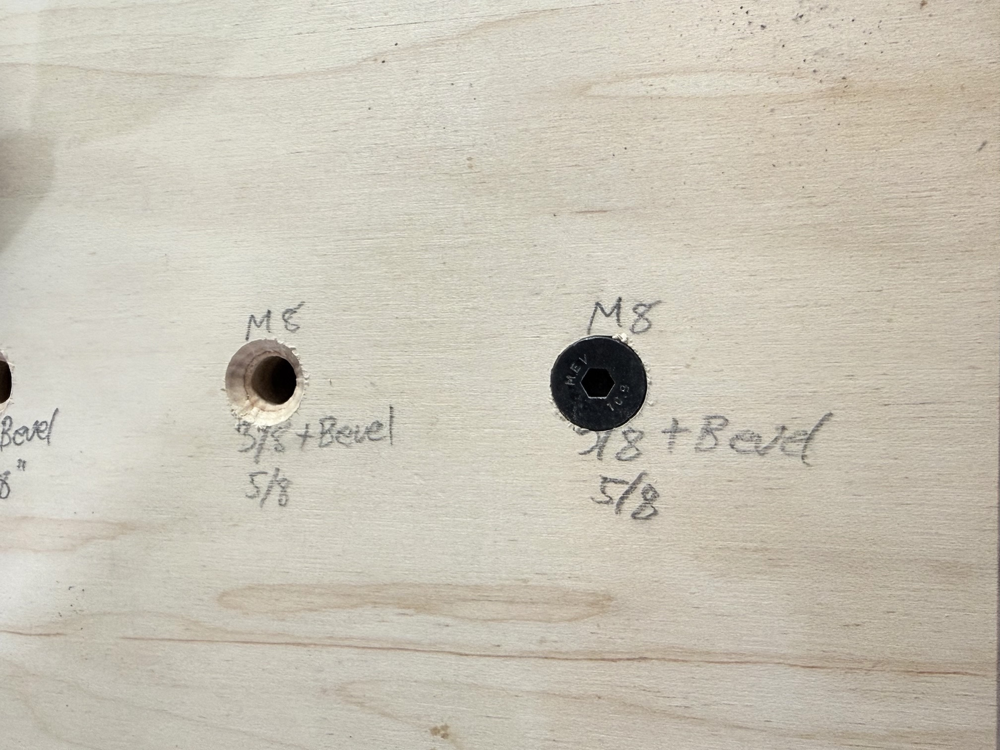

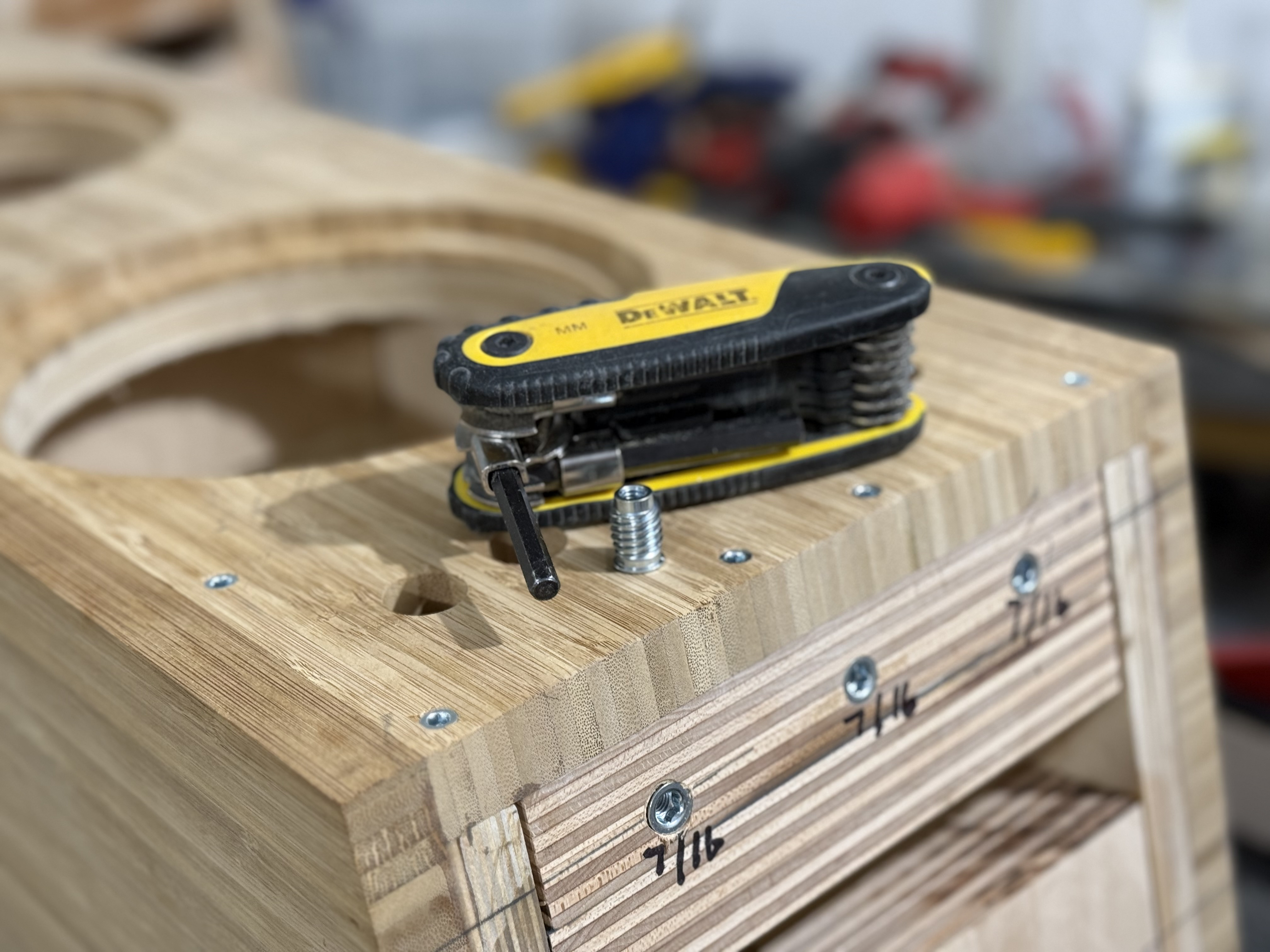

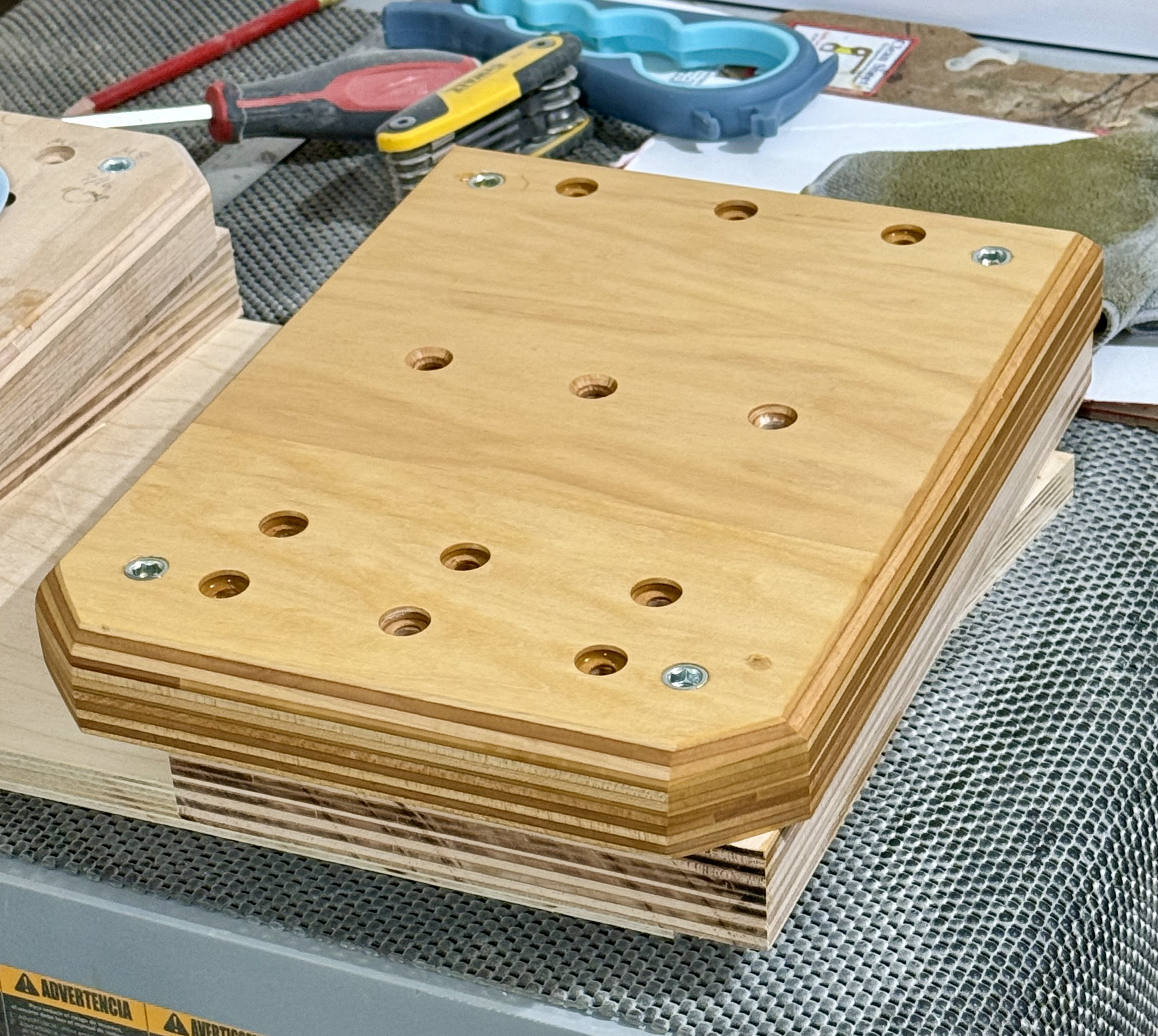

                                                    The RAMPA M8's have arrived from Bear Valley and they do not disappoint-
                                                    Like the M4 and M6, these have a three-point design with three interleaved threads, so there are 3 engagement points starting the insert with things easily aligning to the true perpendicular.
                                                    Click image for larger version  Name:	1-RAMPA M8.jpg Views:	0 Size:	1.33 MB ID:	961547
                                                    These are going to be used for the GAIA footers, and also for two clamping holds to the bottom center braces.
                                                    Click image for larger version  Name:	2-Center Bottom.jpg Views:	0 Size:	863.8 KB ID:	961548
                                                    Locations will be precision set by the phenolic template board being prepared in design.

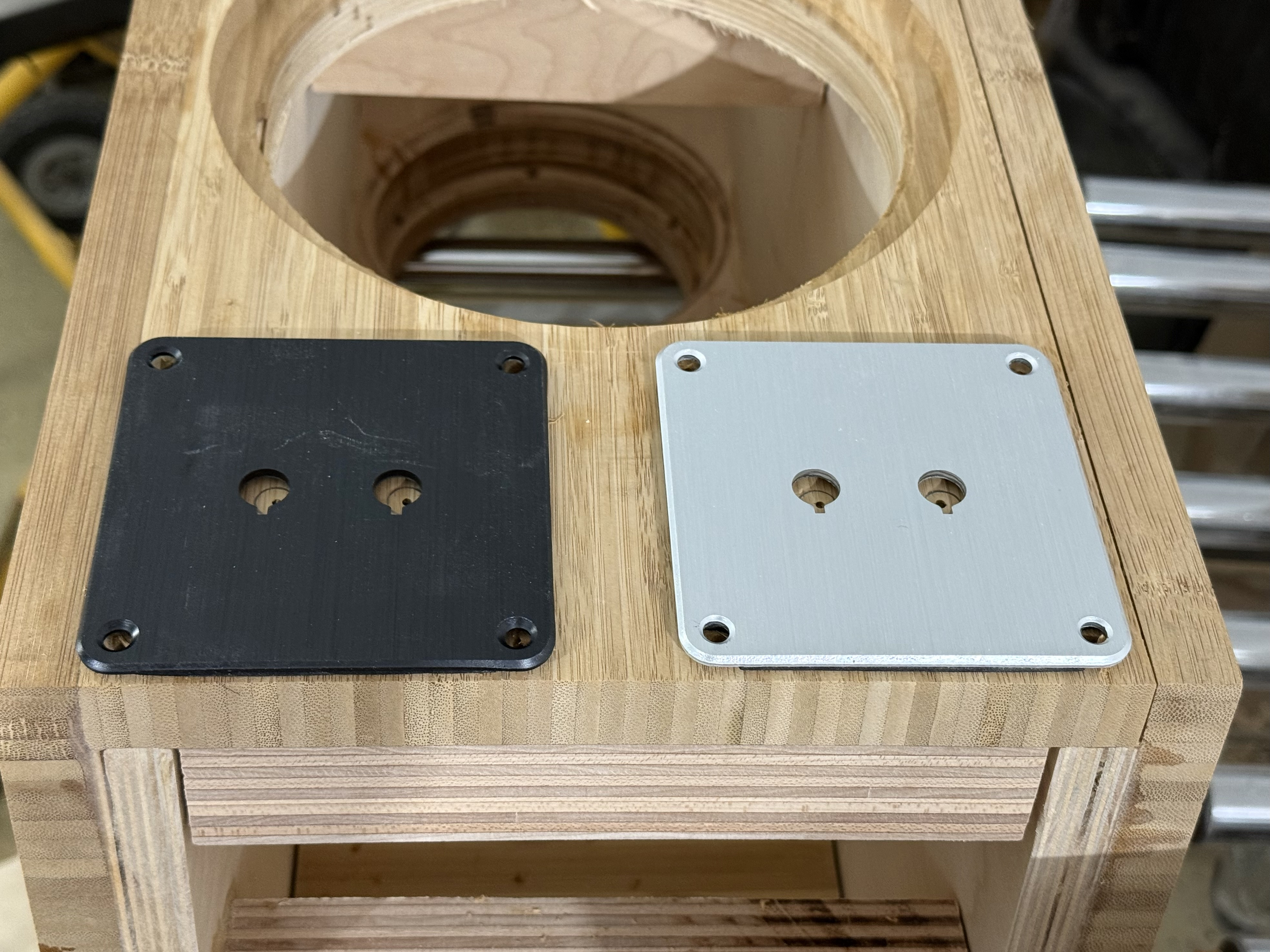

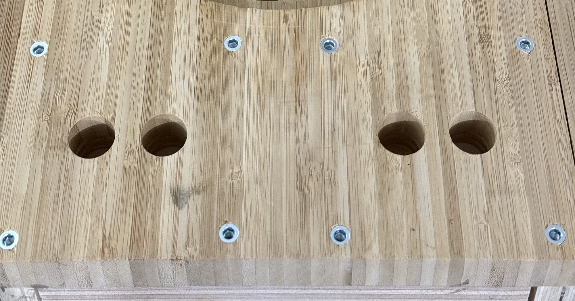

                                                    Also made some progress on the binding post setup- I like using the Dayton plates, in this case we don't quite have enough vertical room for a double post plate, so I'm going to arrange the single set side by side, and what the heck, why not color code them, since I have so many of both on hand?
                                                    Click image for larger version  Name:	3-Binding Post Plate Arrangement.jpg Views:	0 Size:	2.12 MB ID:	961549​

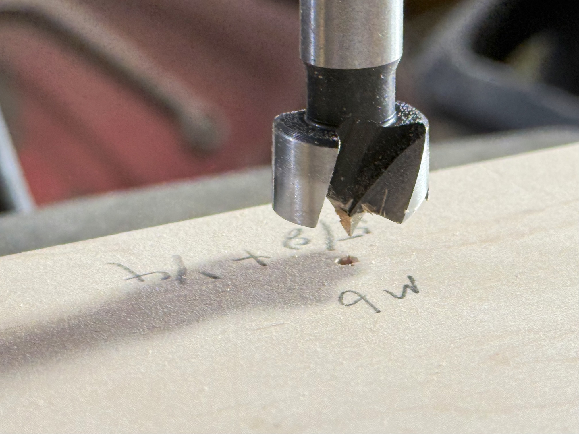

                                                    These Dayton plates come with some fairly nice wood screws, but you know, this is a RAMPA insert build! So M4 flathead socket screws will be used.
                                                    Click image for larger version  Name:	4-Dayton Plate-M4 Flat.jpg Views:	0 Size:	489.8 KB ID:	961550​

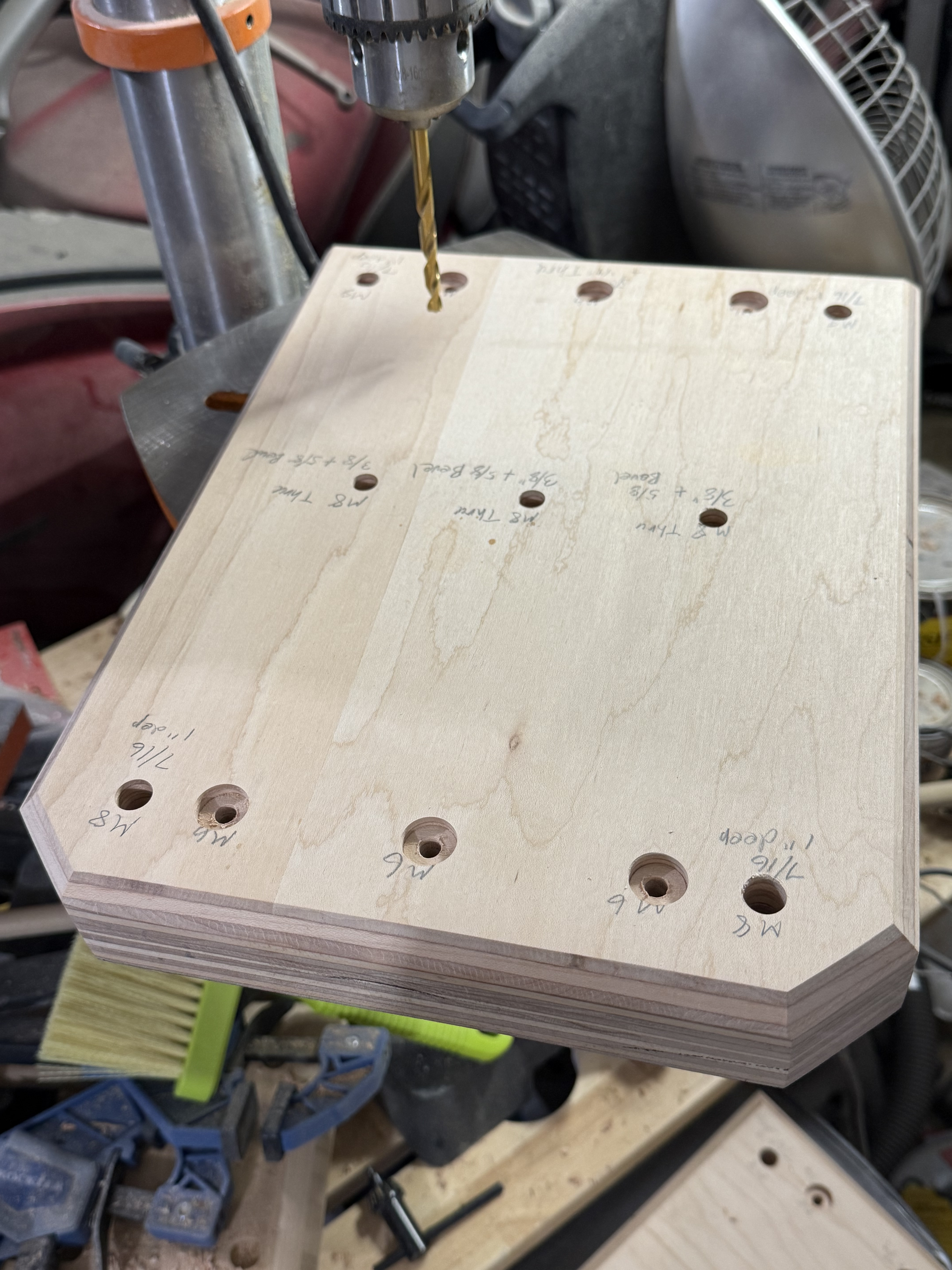

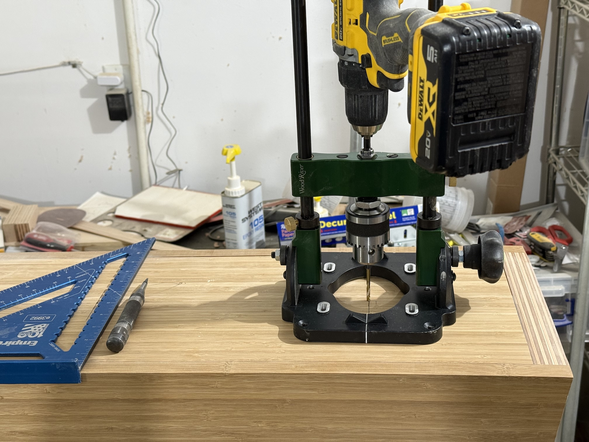

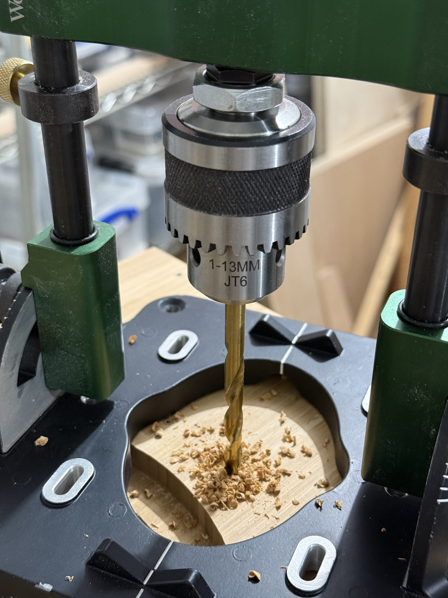

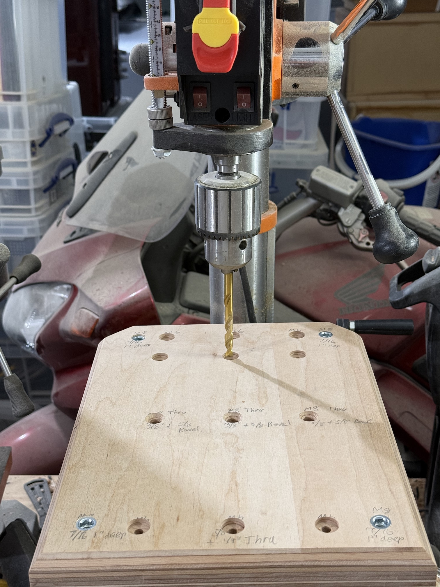

                                                    Drilling the insert holes with 9/32" bit is easy peasy with the drill guide, and using the travel stops to automate the depth.
                                                    Click image for larger version  Name:	5-Drilling M4 Inserts.jpg Views:	0 Size:	666.8 KB ID:	961551​
                                                    Some sharp new Forstner bits for the binding post holes are due in by Sunday- the inserts will be installed tomorrow, the cabling will be installed on Sunday also.
                                                    Click image for larger version  Name:	6-M4 Inserts Drilled BP next.jpg Views:	0 Size:	774.6 KB ID:	961552​

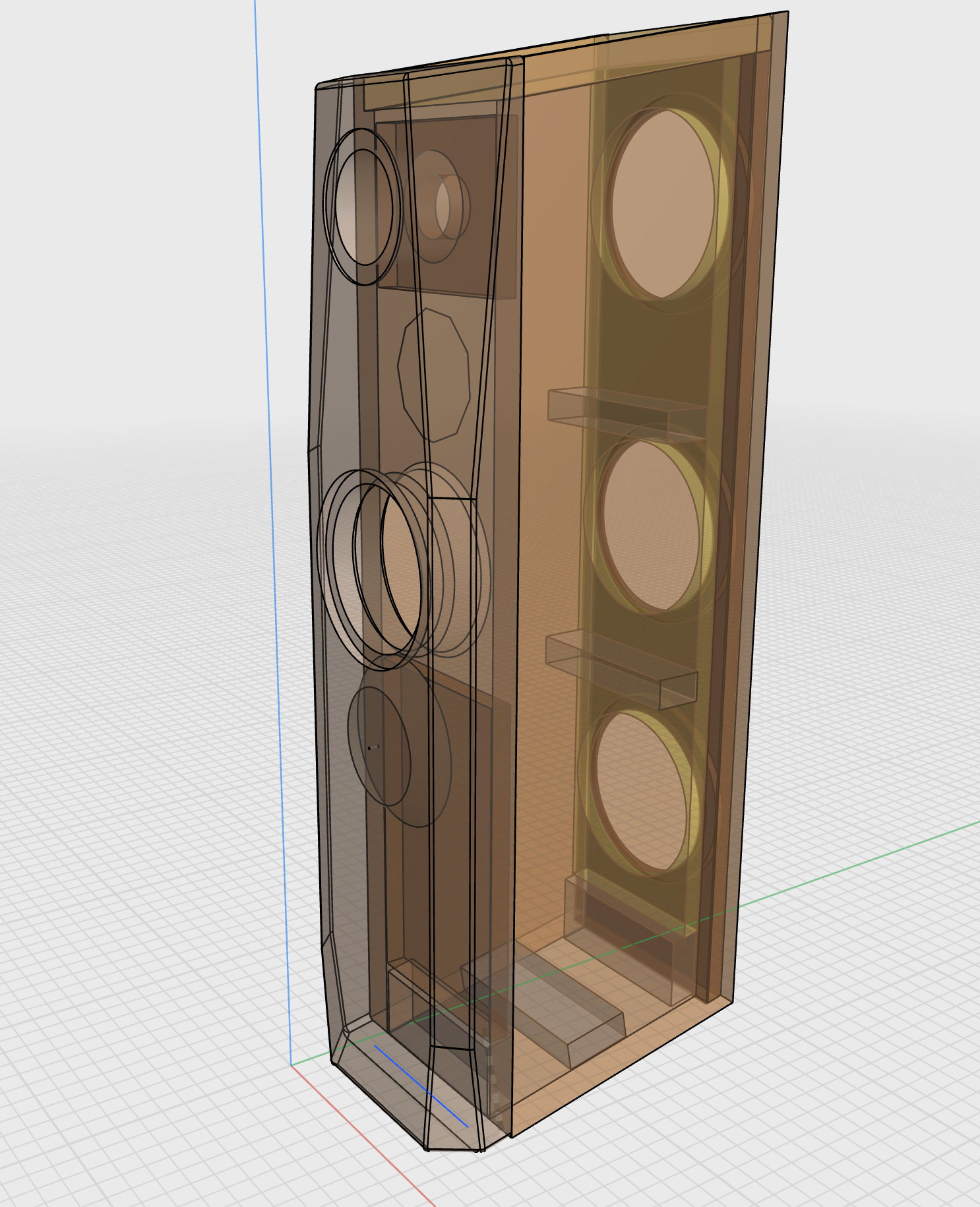

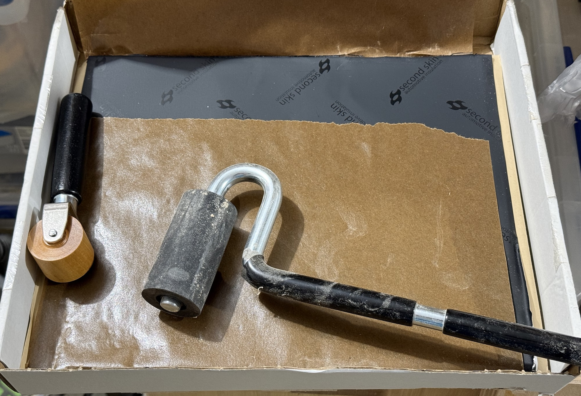

                                                    Many things on the To-Do list today, but also got some MTA stuff done- mostly updating the 3D Cad bracing work at the bottom of the cabinet in Shapr3D, mounting binding posts on Dayton panels, and reviewing what I want to do in updating the design of the base panel, regarding attachment to the main cabinet and location of the footers.
Name:	X-RAY View 9-19.png
Name:	Binding post plates.jpg
                                                    Tomorrow more Forstner bits and some specialty router bits are arriving, and I also expect to be installing some Second Skin sheets on the inside side walls.

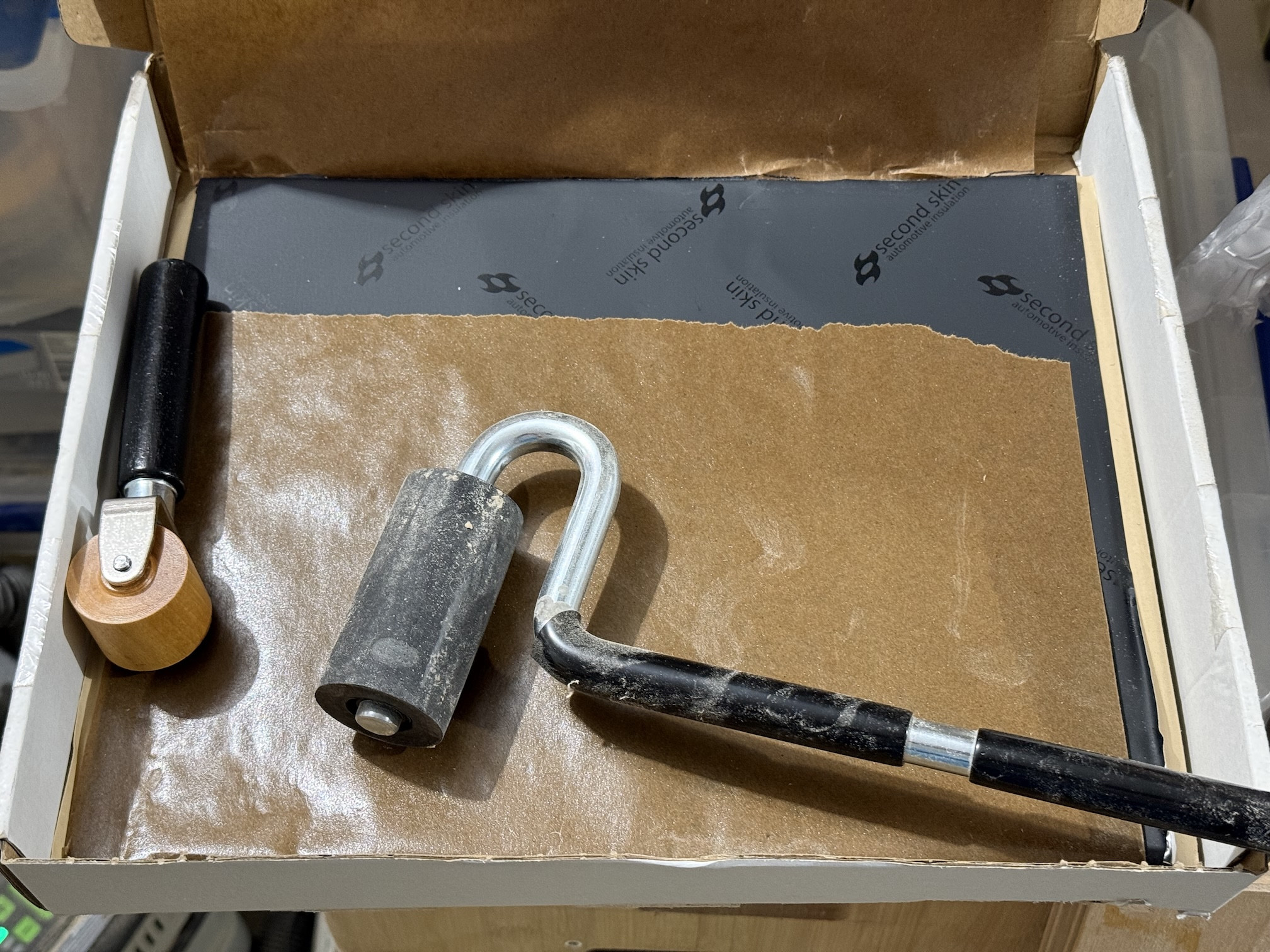

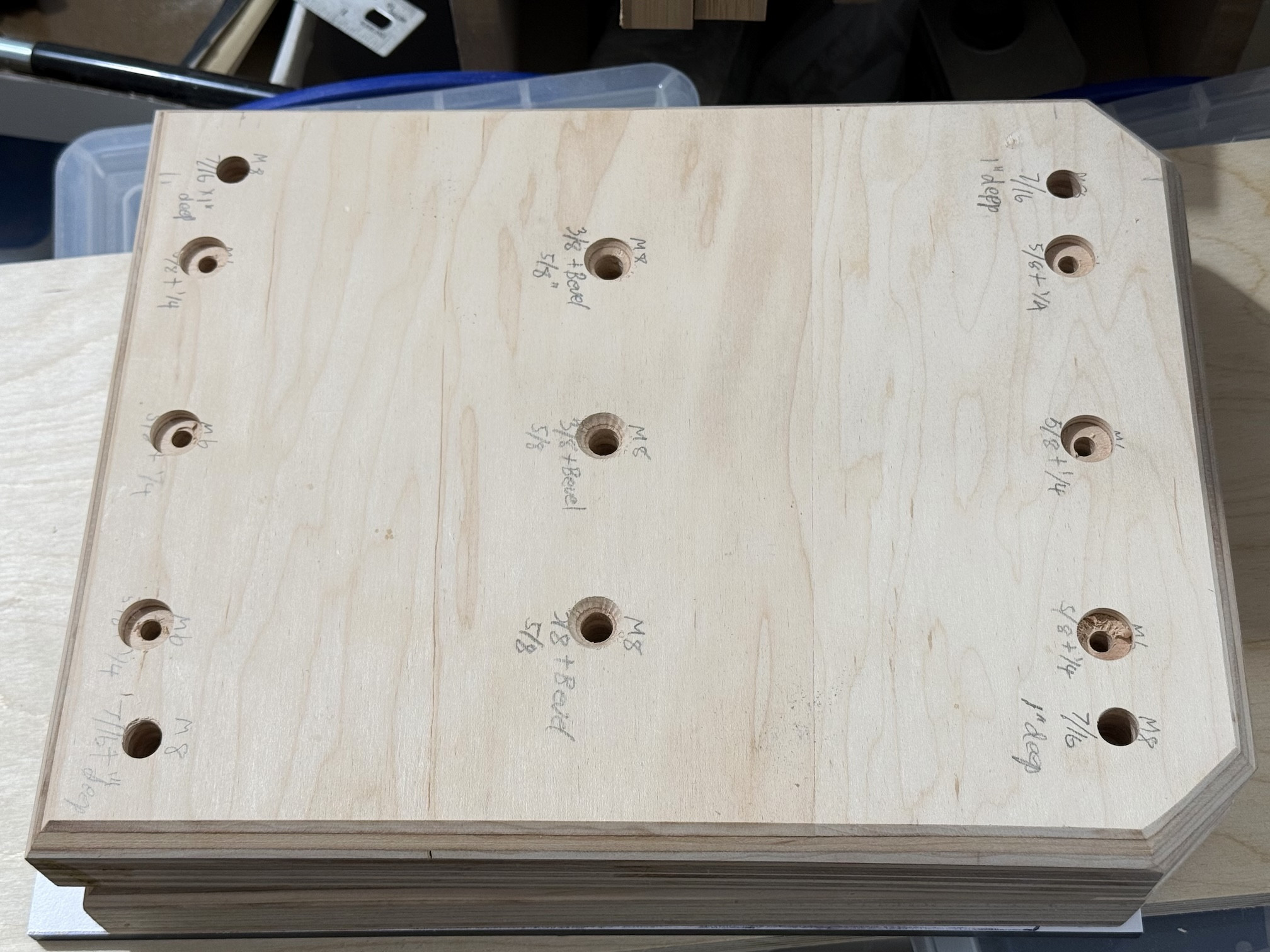

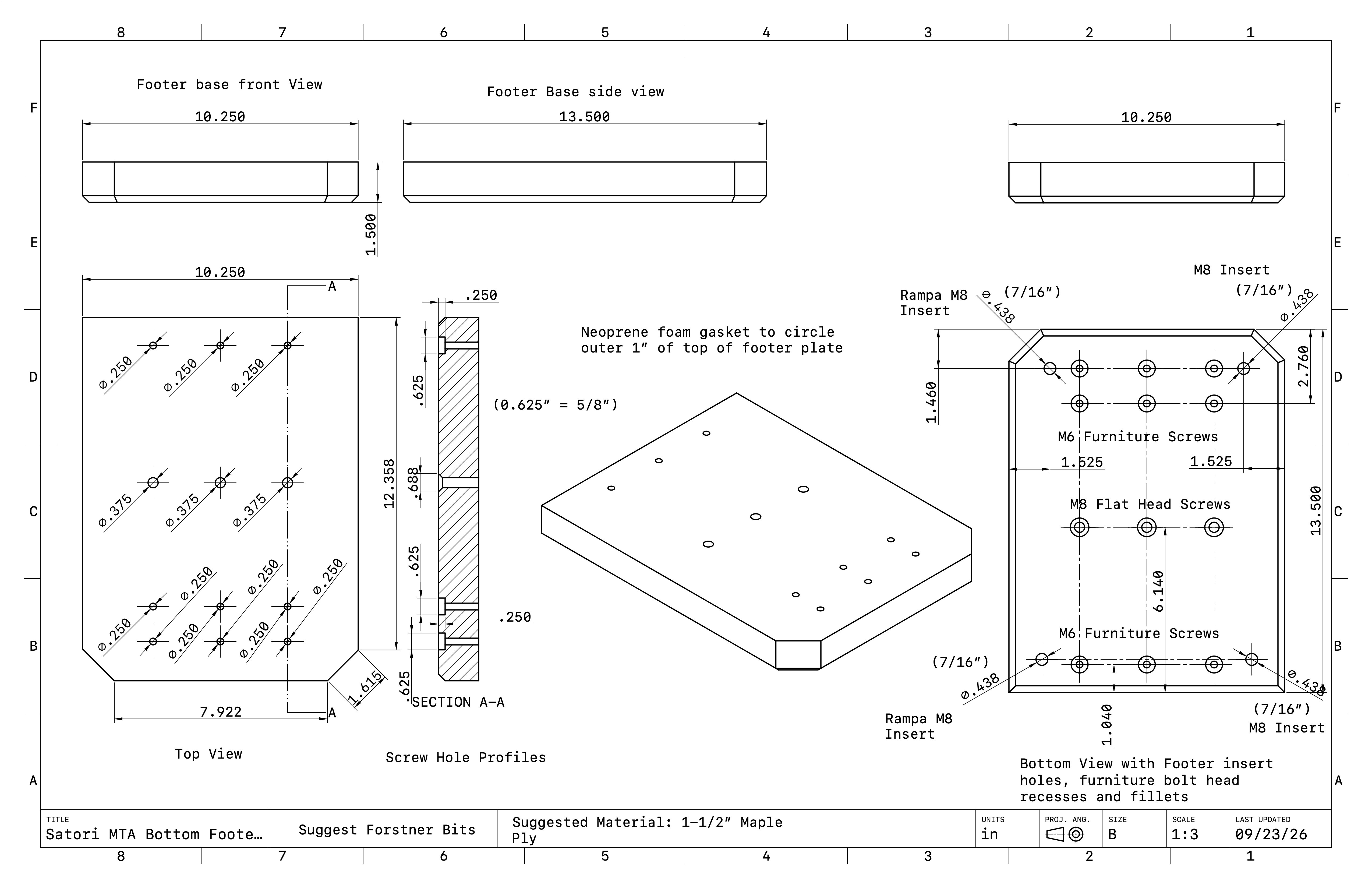

                                                      • 16175

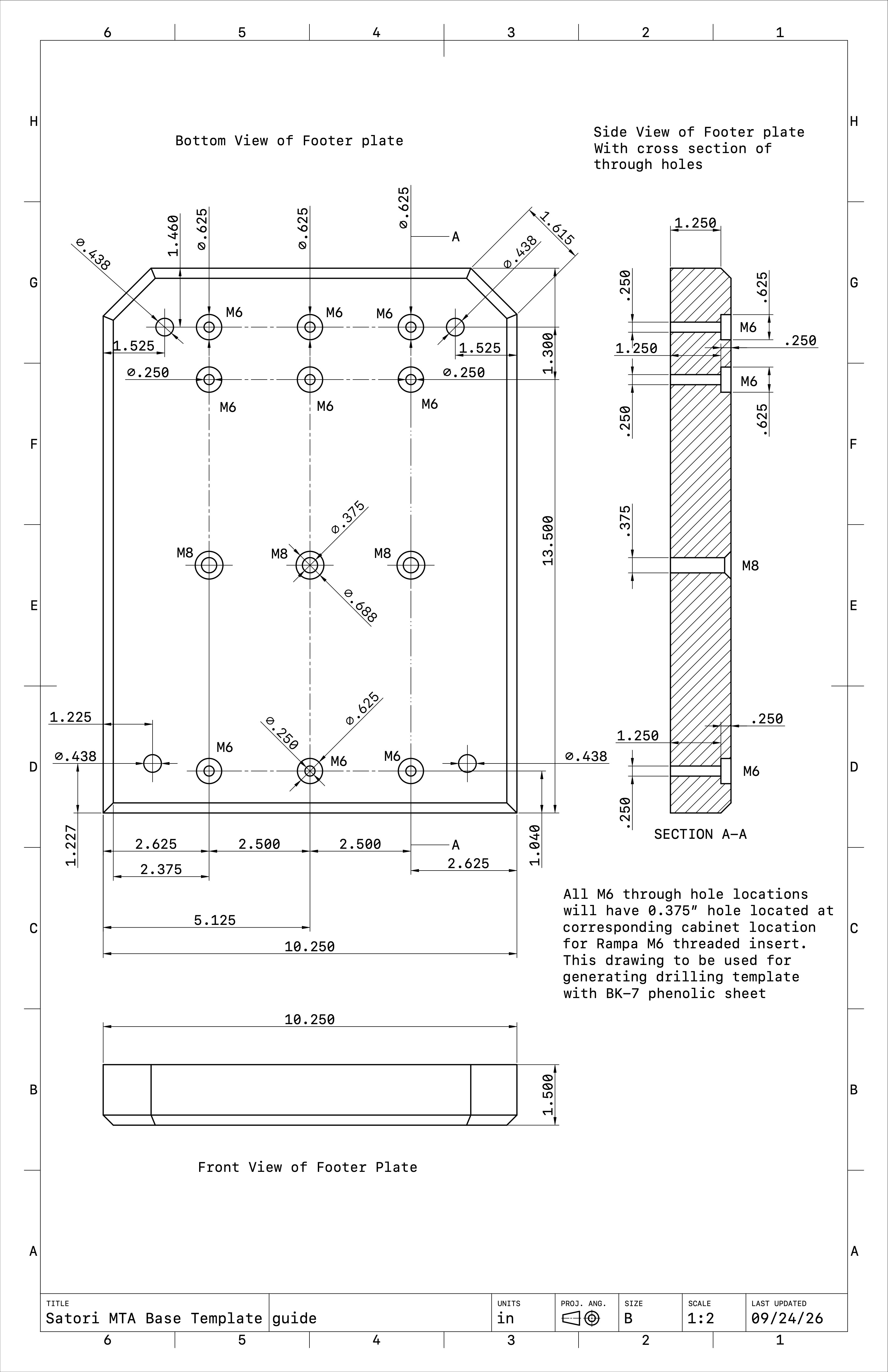

                                                      The previous week has been filled with distractions- but now I have a preliminary drawing for the bottom footer panel, and Amazon just delivered the Forstner drill bits I had on order to deliver today (you know how it goes, adding stuff for delivery on the same day during the week before), so I'm ready to create the drilling template mark up guide with a piece of BK-7, and then get down to brass tacks. The template will be used for assuring consistent hole locations on the bottom of the cabinet and on the footer pieces (previously shown in basic form).
                                                      THIS IS PRELIMINARY and NOT YET TESTED!
                                                      Click image for larger version  Name:	Satori MTA Bottom Footer Plate V1.jpg Views:	0 Size:	1.29 MB ID:	961565
                                                      This is assuming using the M8 hardware posts on the GAIA footers with RAMPA M8 threaded inserts, and using a combination of M8 flat head screws and matching inserts on the cabinet bottom center brace previously shown, and "liberal" use of M6 furniture screws with recessed heads with RAMPA M6 threaded inserts for the front and rear attachment points in the 1-1/2" side to side struts attached to the front and rear panels.

                                                      • 16175
Name:	Satori MTA Update Bottom Plate V1b.jpg
ID:	961572And getting up this morning before 4 AM, an update on today's progress, a planned detailed drawing of just the bottom side of the footer plate, to make it easier for me to create the template, as my large format Epson CAD plotter is in off site storage:
                                                      Just updated the drawing, adding the spacing in for the M6 through holes to the back side.
                                                      This is all being done in Shapr3D, for anyone curious about those kinds of details. Now, time to get out the rulers, angle guides and templates, and make me a drill hole marker template!
                                                      I just noticed that not noted on this drawing is that the 7/16" holes for the footer M8 threaded inserts are only 1" deep in the panel model- through hole is not necessary.

                                                      • 16175
                                                      Yesterday and today's work reminded me of a song we used to play in a British power pop band I was in during part of college-
                                                      We could play nearly all of Tommy, but of course there were favorites for various reasons... this one seems appropriate to the work being done!
                                                      But, getting down to business, it was first about creating the layout template in BK7 and then center punching and notating all the hole locations on each plank.
                                                      Then, getting out the drill bit collection, mostly Forstners for this job, and getting down to work.
                                                      Center punches and Forstner bits go together like a horse and carriage, so to speak...
                                                      Here, prepping to drill a shallow relief for furniture style M6 bolts with a 5/8" bit.
Name:	1-Center punch - Fortsner bit M6 Furnthru.jpg
                                                      Here, a 3/8" pilot bit run with a Forstner bit, for the M8 through holes- the full depth is completed with a high grade standard bit. The Forstner ensures best precision for the location and a clean cut surface.
                                                      Just step by step for each hole, until we're almost all done.
Name:	3 Mosty done.jpg
                                                      Last step was a bevel cutter for the M8 flat head screws:
Name:	4-M8 through-bevel.jpg
                                                      Then a shot of the finished work on the bottom panels- ready now for sanding and clean up, then installing the threaded inserts for the footers, and finishing.
                                                        • 16175
                                                        Today's theme, courtesy of Jethro Tull, an old favorite of mine, "Nothing is Easy". (should this be the motto of DIY?)
                                                        Now, where the heck did I put my flute? I can find all the guitars and keyboards...
                                                        Here's the situation in a nutshell...
                                                        The Asian brand M8 threaded inserts (including the ones equipped with both a drill bit and hex key) are exactly 1/2" on the outside of the threaded inserts, and the drill bit size provided is 7/16".
                                                        This is probably fine for a soft wood... but not for hard rock maple. Probably need a drill bit of 15/32" in hardwood. Yes, I can get those on Amazon. At my local Ace Hardware?
                                                        Fuggetaboutit.
                                                        Now, the outer diameter of the threads on the Rampa M8 threaded inserts are 35/64". So, forget about 7/16, but with a 1/2" hole, and a manly metric hex wrench, one can get the job done.
Name:	0-Rampa Insert.jpg
                                                        Here's one installed:
Name:	1-Rampa Detail.jpg
                                                        Here's the DeWalt Hex Tool I use- the one that came with the insert set from Amazon is not adequate in my opinion. Too small a handle for the forces involved
Name:	2-Dewalt mm Hex combo.jpg
                                                        And one of the bases with all four inserts installed:
                                                        ​​​​​​​Click image for larger version
Name:	3-base with 4 inserts.jpg
                                                          • 16175
                                                          Talk about distractions- like spending nearly all afternoon Wednesday cooking a chicken dish for my wife's late luncheon for two couples, Russian wives and American husbands. and consulting on some other projects.
                                                          But also needed to order some more materials, another specialty router bit, and some table saw related stuff. Plus epoxy. Possibly not enough on hand to finish things. It SEEMS like it's all under control and will be on hand no later than Monday. Cross fingers...
                                                          Also tweaking some hole sizes in one of the footer boards slightly...
                                                          Click image for larger version  Name:	Modifying Drill dimensions.jpg Views:	0 Size:	714.9 KB ID:	961591
                                                          And I did a test pass using the BK7 template board to center push footer base locations on one of the completed cabinet. Decided to install an additional side to side brace strut, to support the threaded inserts better, and after looking at the side profile in Shapr3D, am convinced I should do it for the other cabinet also. And ordered a new follower router bit to trim the depth of the PR mounting planes.
                                                          And the new package of SecondSkin should be in by Monday.
                                                          Click image for larger version  Name:	secondSkin kit.jpg Views:	0 Size:	773.4 KB ID:	961592

                                                          • 16175
                                                          Fiddly work- binding post plates.
                                                          Here, the drilling guides are very necessary, especially working with Forstner Bits- in this case, 5/8" is fine for clearing the binding post body.
                                                          Of course, the bit dust needs to be cleared frequently, I use both a vac and pulling the bit back out- a handy point is that one can tell how deep you're getting (besides looking at the brace level on the drilling guide!) by observing the color of the "drill dust" coming out as one goes through the layers...
Name:	2-Different layers different colors.jpg
                                                          Hole positioning accuracy is very good if one uses the center punch to locate the starting hole of the Forstner bit as we did here:
Name:	3-Binding Post Check ready.jpg
                                                          Houston, looks like a go for the binds post plate mounting! Wiring leads will have to be stripped and prepared for going through the thick panel and attaching to the tips of the binding posts! Line up for the threaded inserts for mounting via flat head M4 machine screws is working out as planned...
Name:	4-Looks Like a go.jpg
                                                          Umm, maybe use "Black" for "Bass", eh?

                                                            Some of the detail effort has been related to drill sizes and types, sort of like Santa-
                                                            Been making a list, checking it twice, gonna find out if it works real nice...
                                                            And of course using my home made template, marked up on both sides, so works for the footer piece one way, and for the cabinet bottom when you flip it over.
Name:	1-Template flipped on bottom.jpg
                                                            The holes are just big enough for a dot of marker and a center punch to be applied, as a physical aid to centering drill bits.
Name:	2-Holer markers and punch.jpg

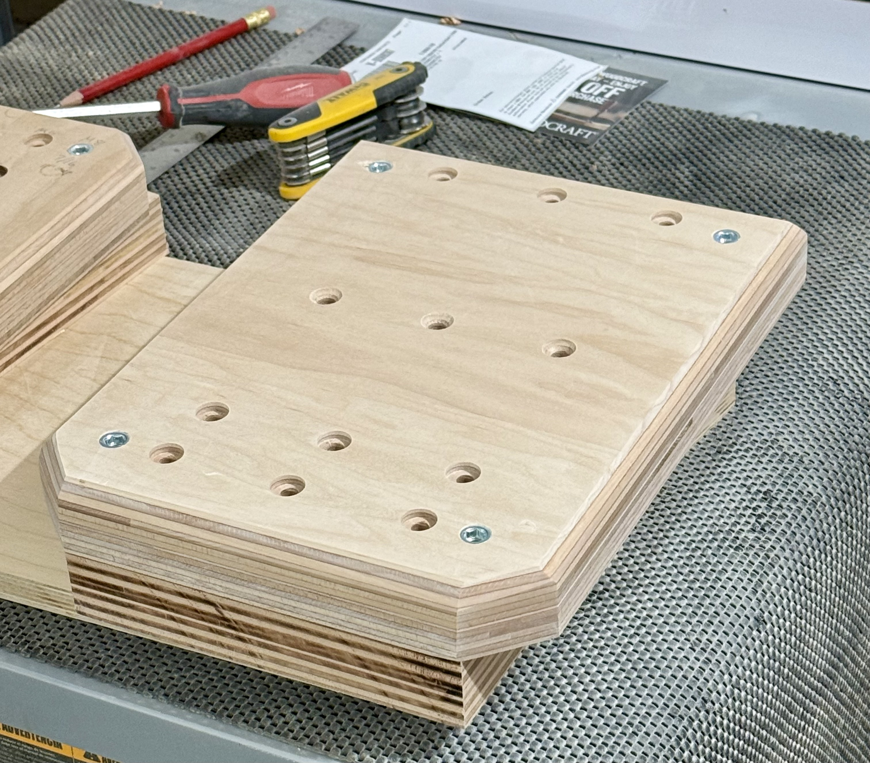

                                                            Then, we have to come down to the matter of a practical drill bit for hard rock maple plywood... ones that do find with strip edge bamboo board or baltic birch ply may be completely out of their element on this material. This impacts setting up the inserts going into the front panel and the installed lateral bracing for mounting inserts.
                                                            Through trial and error I've found my preferred drill bit family- not too surprisingly, it's a high grade one made for metal work, too: Milwaukee Red Helix.
Name:	3-Preferred Drillbit for Maple.jpg
                                                            This one works OK for the M8 Rampa threaded inserts. I use 7/16" in the same family for the M6 threaded inserts.
                                                            Some notable and important features include the design of the drill tip, how it cuts, and how it can be centered easily in a center punch depression.
Name:	5-IMG_Tip label detail.jpg
                                                            The other point to keep in mind is the torque needed to install these larger threaded inserts- the three point thread makes it fairly easy to start, but still one needs some grunt. I have one favorite style Dewalt tool that I have both MM and SAE versions. I'd guess someone must make something similarly effective, but being just a wires and sparks kind of guy, I haven't come across it for jobs like this.
Name:	6-Hex Wrench and Insert.jpg
                                                            My plan at this point is to focus on getting this first cabinet completed, finished and with drivers mounted so I can get to the interesting part- measurements and crossover design! I have some preliminary stuff done from test cabinets, but this will be the real deal, of course.

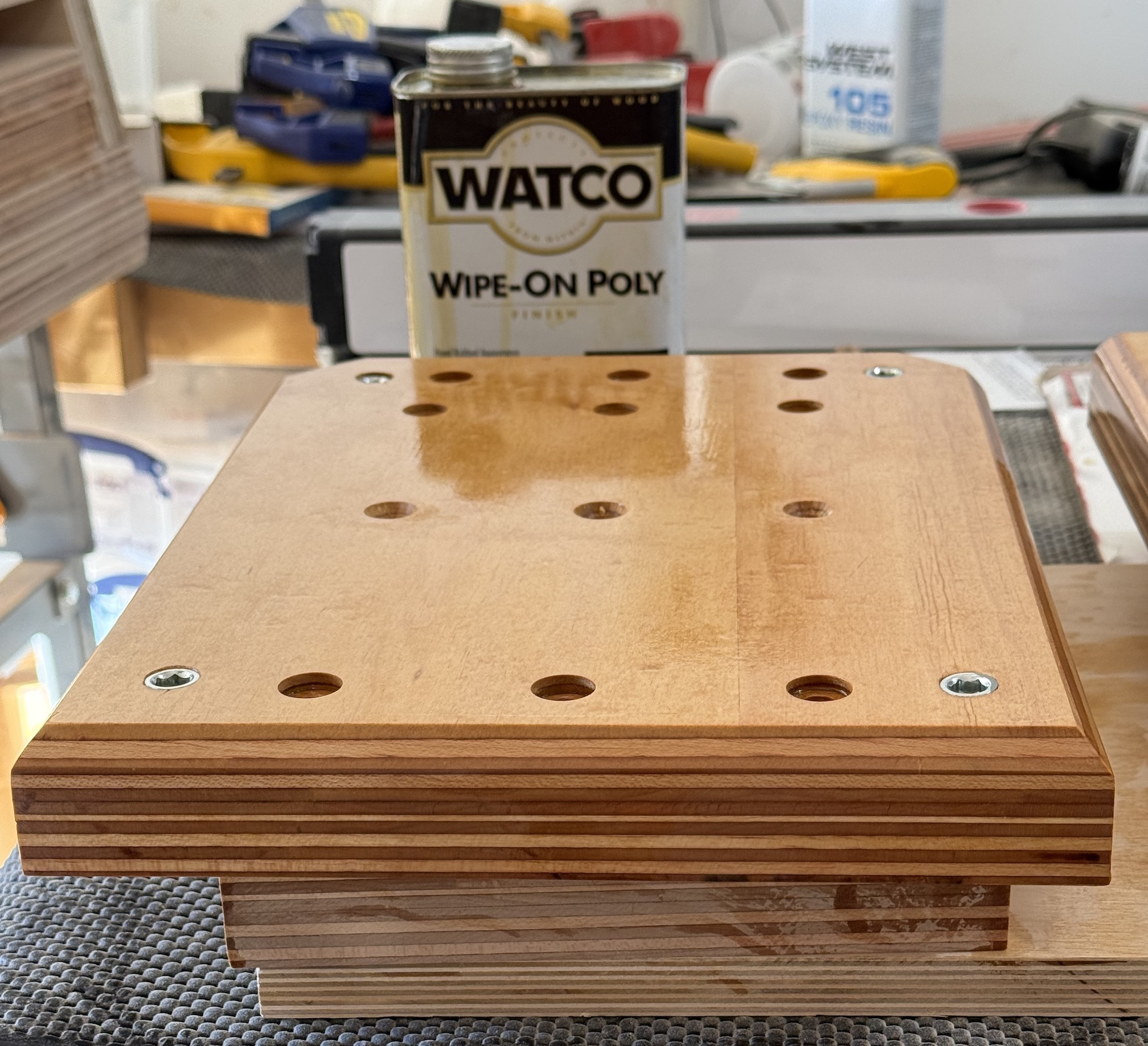

                                                              • That experiment will be enabled by having found in storage my stash of Watco products, and discovering that though some specific retailers use in the past don't have what I liked, Amazon does. I try to buy local, but it seems some days I have a fondness for items that are possibly considered too specialist.
                                                              • And in the good news department, the FESTool 320 grit sanding pads are arriving today, just in time for cleaning up the footer bases and trying the planned finishing techniques on them.
Name:	Watco Oil-Poly.jpg
                                                              My recollection of past technique was two wipe on coats of the Danish oil, followed by a coat of gloss Wipe-On-Poly, a very light 400 grit sand, and a coat of the satin Wipe-On-Poly. Just have to give that a try...
                                                                • 16175
                                                                "I had a dream... "
                                                                Literally, in the middle of the night, and thinking, "Why not have some side panel braces located copecetic to the side to side back braces, to further stiffen and raise the frequency of side wall resonance while hopefully reducing the amplitude?" Now, as narrow as the cabinet is, having deep ones doesn't seem like a good idea, but having some previous cut offs in the bamboo board at 2-1/2" in width, why not try that flat on the side walls?
                                                                So, dimensions were checked and pieces cut on the ole reliable DeWalt...
Name:	1-New side braces.jpg
                                                                And the prime build cabinet was turned on it's side and the first two installed with epoxy.

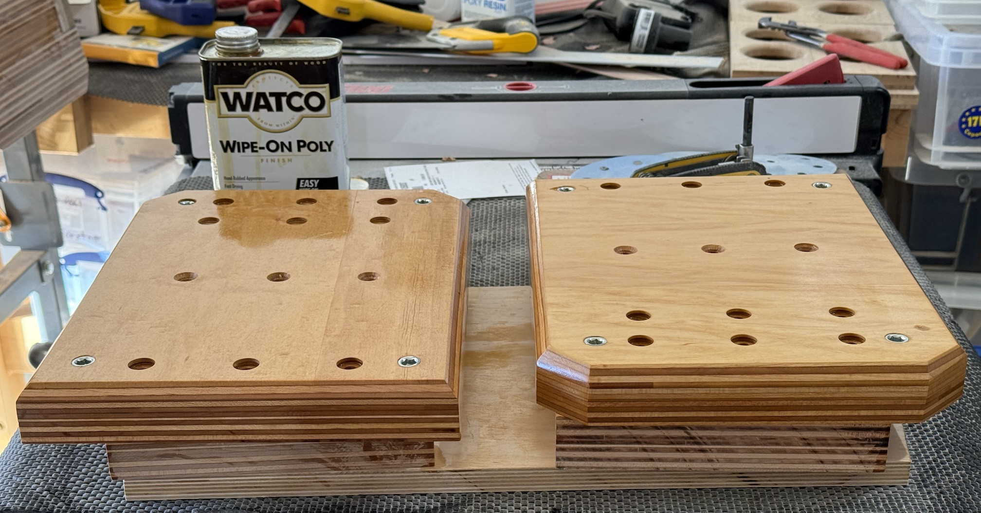

                                                                Back to the main effort, the footer bases- stepped through the three FESTool sanding disks grits now on hand, 100, 220, and 320, and for the nominal idea of "Idaho Rustic", this first footer is feeling very smooth...
Name:	2-Base sand 2 320.jpg
                                                                This is after the first application; need to go back in and flood in a second coat now.
Name:	3-Base Coat of Golden Oak.jpg
                                                                  JonMarsh commented
                                                                  Editing a comment
                                                                  From the way it's soaking in to the maple, I think a 3rd coat will be a good idea.
                                                                  Note, I also picked up some Hillman M6 stainless steel bolts, 50 mm long, I think they will work well as the fasteners.
