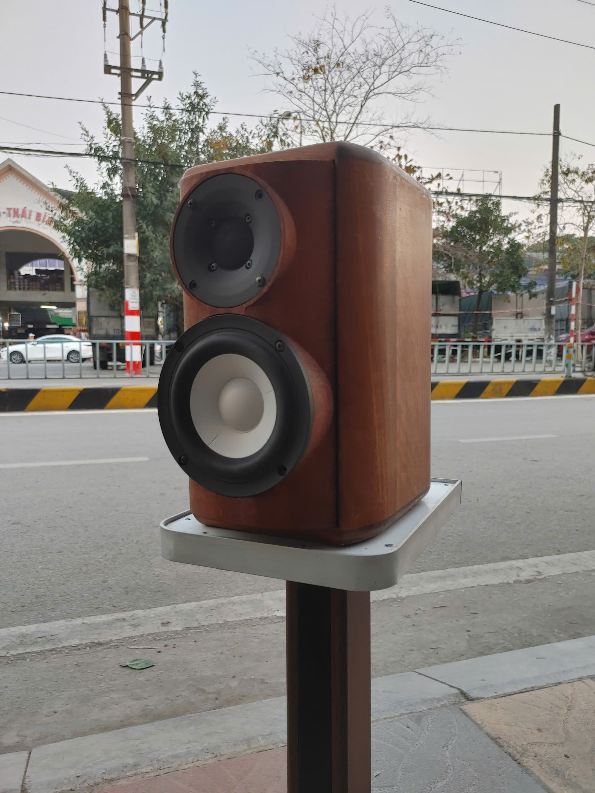

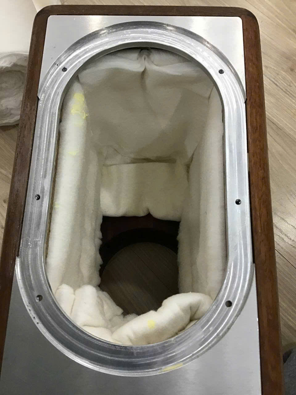

                                I would like to contribute to your thread with my project. The speaker is in the process of voiceing. My project is progressing but a little slowly.
                                Last edited by theSven; 12 February 2025, 10:25 Wednesday. Reason: Attaching images inline
