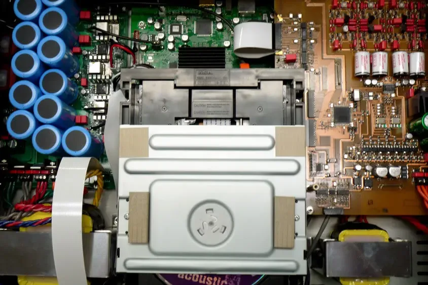

            Well, Mark, in this case all I was really interested in was DSD to LPCM conversion at high bit/sample rate; the Pioneer has the right chip set to lift the DSD out after decryption and pipe it elsewhere. Have some other plans for this, if it works out, besides playback through the Alpha DAC. That's required me to convert my Mac Pro into a bit of a digital audio workstation.
            The Cambridge Audio BD-650 also has a ton of Oppo DNA, even the power supply is basically the same though the color of the PCB was changed.
            At least Ayre, when they start with a BD83, throw away the power board and audio board. And build a new chassis from scratch.

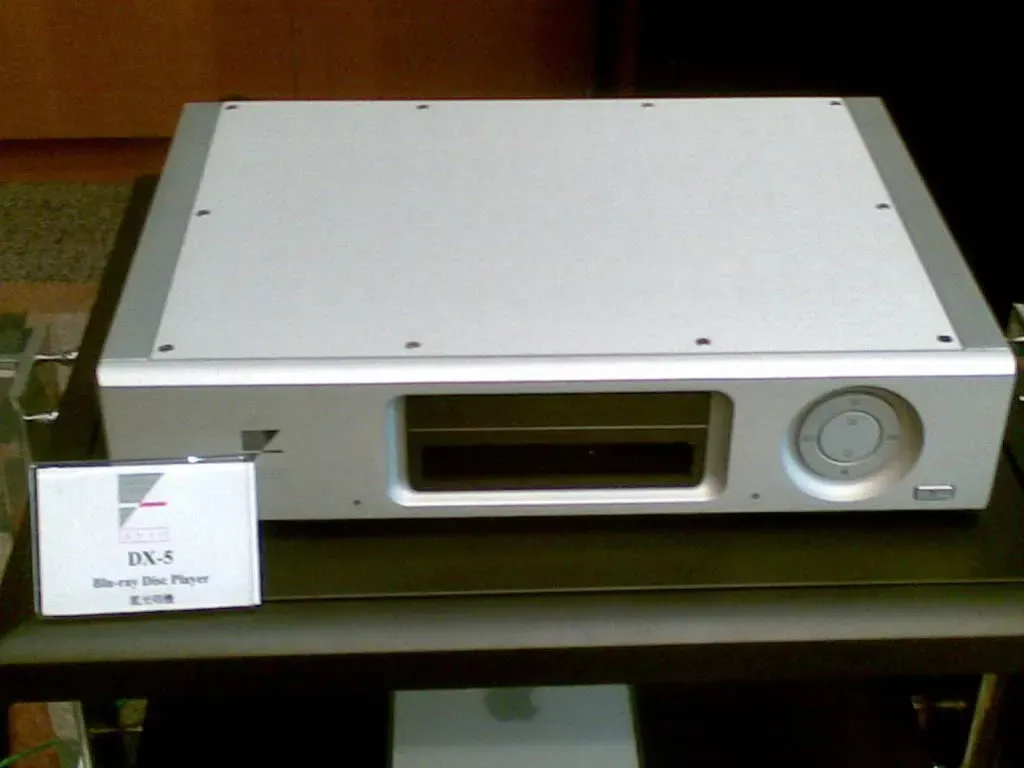

            Charlie's explanation of the DX-5:
            To make it an Ayre, we dismantle it completely and recycle everything except the main PCB (with the video decoder, ABT scaler chip, and HDMI transmitter), the transport mechanism, the VFD display, and the remote control handset.
            Next we re-build the main PCB. The big switching power supply only provides 5 VDC, then there are little mini-switching power supplies (called DC-DC converters) on the main PCB that turn the 5 VDC into 1.0 VDC, 1.1 VDC, 1.8 VDC, and 3.3 VDC. All of those are removed. There are also USB power switches that allow hot-plugging of USB devices. These are removed as they have another kind of DC-DC converter called a "charge pump".
            All of the supplies are replaced with pure linear supplies with analog regulators. The USB power switches are replaced with devices without the charge pumps. Now we have gotten rid of seven noise sources that create high-frequency square waves with harmonics well out into the MHz region. Getting rid of all of that noise creates a visibly cleaner picture.
            Next, we replace the low-quality master video clock with a VCXO. This becomes more important later on, as you will see.
            Now we start adding things back in. First is our AyreLink communication system. It allows AyreLink equipped components to act as one big system. For example, turning on the player will turn on all of the downstream components as well as automatically select the correct input on the preamp. We also make an external RS-232 to AyreLink converter box for system controllers like Crestrons. The AyreLink system has opto-isolators between each component to avoid unwanted ground loops, which is why we don't use RS-232 inputs on any of our equipment.
            Then we add a custom programmed FPGA on the front panel PCB to do some housekeeping. It intercepts the appropriate commands and translates them to operate the AyreLink system. It disables the internal volume control (which operates in the digital domain and degrades the sound) and instead routes the volume changes to an AyreLink equipped preamp. It also allows us to send custom messages to the front panel VFD display. So when the USB audio input is activated, it will report that on the front panel along with the sample rate of the received signal.
            There are a bunch of boards added on the audio side. I say "side" because we literally split the player into two parts. There is a separate power transformer that runs all of the audio circuitry, which is separated from the video side by a bank of opto-isolators. So the audio and video "sides" have separate grounds that are completely galvanically isolated. This is the only way to get the best performance from either your audio system or your video system.
            All video displays have switching power supplies that dump noise into your system in the absence of such isolation. There are also ground loops that are inevitably formed as there is no such thing as a balanced video connection. All of those problems go away with our isolation system.
            The ten-channel audio board is replaced by a two-channel audio board. Everything on this board is top-quality, with discrete, fully balanced, zero-feedback audio circuitry and discrete, zero-feedback power supply regulators. There are improvements in both the parts quality and circuit design that give it even higher performance than the QB-9 USB DAC that was recently rated "Class A+" in Stereophile's recommended components issue. For two-channel disc playback (CD, SACD, DVD-Audio), the performance exceeds our $6,000 audio-only disc player.
            We also add the USB audio input that allows you to connect your personal computer and turn your system into a music server. Your entire digital library (except SACD's, thank you very much Sony -- not!) can be stored on a hard drive and played back with the click of a mouse. So this one component can be the only source component that you need. This input is also connected via a bank of opto-isolators, so there is actually a *third* "side" to the system -- the video, the audio, and the computer. The noise from your computer and its switching power supply will not be connected to either your video or audio systems.
            We also add a second audio-only HDMI connector. This is fed by the isolated signals on the audio "side" so that it won't contaminate your surround-sound system if you choose to connect one. It also supports the new "Audio Rate Control" (ARC) feature that is part of the HDMI 1.3a specifcation. This is a breakthrough for the surround-sound enthusiast, as HDMI is normally the worst way in the world to send audio data -- the jitter is even worse than the lowly S/PDIF connection.
            But with ARC, the surround-sound processor uses a local crystal oscillator to provide a low-jitter clock to the DAC chips. Then there is a buffer that stores the incoming audio data. When the buffer is too full it sends a signal back upstream to the Blu-Ray player telling it to slow down the disc slightly. When the buffer is too empty, it asks the disc to speed up slightly. Now the audio clock is in charge, the way that it should be. (When the unit is running in two-channel mode, the local low-jitter, fixed-frequency crystal oscillator provides the master audio clock.)
            With a modern digital display (plasma, LCD, LCOS, DLP, et cetera) jitter on the video signal does not matter. Since there is no conversion to analog, the digital signal values are simply stored in a frame buffer until needed.
            Then the whole thing is put into a custom chassis made entirely from anodized aluminum and stainless steel. We want our products to look just as good 50 years from now as they do today. There are other people making Oppo "clones". One of them only replaces the chassis. Another replaces the power supply also. Nobody is rebuilding the complete player and adding the extra features and advanced technology that Ayre is.
            As far as the value, it is up to you to determine that. I can't tell you how much an improved picture is worth. I can't tell you how much better sound is worth. I can't tell you how much the features we add are worth. You will have to decide that for yourself.
            What I can tell you is that, just like all of our other products, they offer engineering and performance beyond what anyone else is offering, at a fair price that reflects our cost of manufacturing, and that we back up our products with both a strong network of the finest dealers on the planet and an incredible service policy.
            Unlike other manufacturers that try to sell you a "new and improved" product every year or two, when we figure out a way to genuinely improve the performance of our existing products, we offer upgrades to current owners at very reasonable prices. Go to the Audio Asylum and check out some comments regarding our recent "MP" upgrades to the C-5xe and CX-7e disc players, for example.
            If you want a great Blu-Ray player for an incredible price, buy the Oppo. If you want the best picture and sound quality in the world for your home theater and price is not a concern, check out the Ayre.
            Just a weeee bit different!
                              Lexicon is doing something rather a bit less... I'd call it re-badging, certainly not re-engineering.

                                Was up in the wee hours relatively (considering I normally get up at 3:30 to 4 AM for work) working on the cherry cabinet set of Modula MT's, which really are doing nicely- the whole midrange through top end presentation is just seamless, listening to a few different things like Sting "Fields of Gold" album, Tom Petty "Into the Great Wide Open", they just really nail voices in a nice way, would make a great behind perforated screen center channel- or even under a flat panel.
                                I appreciate the comment about Lexicon versus the hot rod pioneer- Lexicon unfortunately has a long history of that kind of thing- as long as the business model works, but apparently you don't even get the SE version of the Oppo when you get the Lexicon badge? Of course, what the Oppo was really designed for is as an HDMI source. I could use one with my CRT only because I have a couple of nice little boxes that technically are not quite legal, as they have full HDCP support for HDMI input and decode to RGBHV to drive a CRT front projector on the output (yeah, I'm pretty old school in my main system, though have a Panasonic flat panel in the bedroom).
                                So, there will be a "battle of the titans" to prove this out, though you can hardly call it a fair fight, as I'm running the Pioneer into my Berkeley DAC.

                                That puts the Marantz SA-11 at a substantial disadvantage, if the down conversion is working correctly, IMO, as I've yet to find an SACD player under $10K that can match the Berkeley on CD, for example. The fundamental "DAC quality", whatever the reasons- I/V conversion, digital filters, output stage, etc, just doesn't seem to be in that league. Certainly SACD sounds better than CD on those players, but with a DAC that allows well mastered CDs to rival my SACD player, I'm hoping for good things, no, great things with 24/176 LPCM playback.
                                The "test" of tests will be the James Taylor Hourglass SACD on the Modula MT MkII; that's one of the cuts I demo'd in 2005; the mastering on the SACD is far better than the available CD version, which sounds like it was made from a 2nd or 3rd generation tape- no resolution in comparison in the midrange (choral voices on "Gaia". That will be another good test of the Pioneer, too! So far, I'm very pleased with how the Pioneer is working out- the goal is to be able to capture the music on my DAW from SPDIF and use with the music server; then, even the clock stability of the custom module becomes a non-issue as it is the playback system and Antelope DA reclocker that will dominate.
