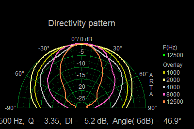

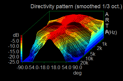

                                        The positioning for this test is similar to what many folks might use in practice, LF effects and all (40 msec gate), on 28" stands 18" from rear wall.
                                        The axis curves look pretty nice - and it sounds very good off axis, even beyond 45 degrees.
                                        Here, I've measured 0 degrees (black), 15 degrees (blue), 30 degrees (green), and 45 degrees (violet).
                                        I'd say you'd be hard pressed to identify the crossover frequency from these curves, which means you don't really hear it. Reverse null is about -15 dB centered at 2 kHz, and pretty symmetrical, as it should be.

                                                                Not necessarily Bear, the tweeter axis is much below the listeners height, so the driver integration with the waveguide might actually work in that case, depending on the listening distance, etc. I'd be equally concerned that the overall baffle shape is completely different and would create a different diffraction response than the measured prototype design, thus a new crossover would be required. In the end... it might be close in the Thiel cabinet but not perfect.
                                                                  • 16067
                                                                  Well, you know what they say, close is OK in horseshoes and hand grenades!
                                                                  Maybe too, in speakers built in re-cycled cabinets! Jed raises good points, but if you have the means to do any measurements in the cabinet, and send me FRD files, I can update the crossover design.
                                                                  I think Bear has a valid point, the crossover lobe axis will be perpendicular to the front panel plane, but for a short cabinet sitting low, that's probably a good thing.
                                                                    • 1913
                                                                    How wide is the box? The PE cab I'm using is 10". That's important for BSC in the crossover, of course.
                                                                    The other "trick" or concern is the mounting plate behind the waveguide, and most specifically, the total baffle thickness needed - in this design, that's 1-1/4" if you mill the waveguide exactly to plan. How thick is the front baffle in those cabinets? If 1", all you need is a 1/4" MDF spacer board. The tricky thing I see here, is that I do rebate the baffle, and you've already got a hole- however, if you have a good set of rabetting router bits, that should be solvable, too, if you can cut the new through hole accurately, maybe by making a template, clamping it on, and using a pattern guide. Then use the rabbeting bit to get the rebate.
                                                                    Otherwise, you might be better off cutting a plug to fit the old tweeter hole, epoxying that in place, then routing the waveguide rebate and cutting the opening hole with a spiral upcut bit. Many paths to Rome.
                                                                    The baffle width is 10.5 inches and 1" deep, and as Jed pointed out there is no round over on the baffle. But J.Thiel used the grill covers as the actual baffle (with a wide round over) and it includes a shallow wave guide that extended to the same radius as the woofer like the MCM one. If I flush mount the tweeter it would be 1/2 inches deep, still not as deep as the MCM, I'm sure.
                                                                    The woofer is also mounted on a 1/4" from the box. Knowing J. Thiel's design philosophy, it was surely time aligned with the drivers he used anyway. But, I'm guessing to use the Thiel waveguide would be quite a stretch and need a new crossover?

                                                                      What do the Theil waveguides look like? How much offset from the front panel? With the front baffle tilt back, this will affect the acoustic center alignment, in a favorable way. Because this is a low order LR2 with little difference in the acoustic offset in my design, any design that changes that aspect will have to take it into account. But if you can do measured data, then I think things can be sorted out.
                                                                      I've even done the crossover design for a straight MT with these drivers, but that would mandate putting the tweeter under the midwoofer to develop an upward crossover lobe.
                                                                      Panel width sounds OK- overall, probably doable.
                                                                        • 1913
                                                                        The Thiel waveguide has a flat slope extending to 6.25 inches in diameter. It's only 3/8" deep the way it is. But I could flush mount the tweeter and extend it more toward the center dome, with a sloped 1/8" thick wood circle cutout.
                                                                        Another possibility, would be to increase the removable baffle thickness with a 1/4" piece of wood, and sink the tweeter 1/2" into the cabinet. Then I could mount the MTM waveguide in the removable baffle.
                                                                        Although, I'll probably try it the way it is and work from there.

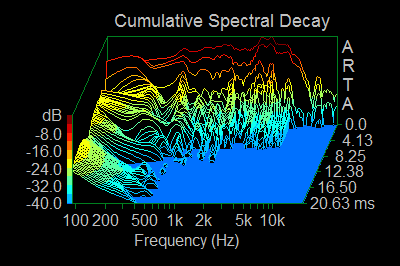

                                                                        I have ARTA software for measurements, would that do? Although I do need to get LSP CAD for measurements within a couple months for measuring the dipole speaker I'm working on.
                                                                        John unk:
                                                                          • 16067
                                                                          ARTA should do, anything that will generate FRD or txt files, and with some control over window length (and window shape? ...yeah, probably asking too much! )
                                                                          Does ARTA do distortion, too? I like checking the finished design with crossover, to make sure we're not pushing anything uncomfortably. I suppose I should download the ARTA manual and read it, but I'm so backlogged on projects and time these days, learning another program isn't at the top of my priorities.
                                                                            • 1913
                                                                            That's great ... it does do distortion measurements. It does window length, and I'm sure it will output text files. I still got to learn it better myself. I have done FR and distortion measurements but only on electronics.

                                                                              • 698
                                                                              ARTA is a very extensive tool, especially for the price asked.
                                                                              It consist of three separate programs
                                                                              ARTA - for gated loudspeaker measurements / room acoustics measurements or spectrum analysis.
                                                                              LIMP - for impedance measurements and TS extraction
                                                                              STEPS - for measuring thd with stepped sines instead of sweeps.
                                                                              ARTA part does
                                                                              frequency response + phase
                                                                              2nd and 3rd thd products from sweep (needs few special setting though)
                                                                              step response
                                                                              energy time curve
                                                                              cumulative spectral decay
                                                                              energy decay
                                                                              + many room parameters from RT30 to STI, RASTI, C50 etc etc.
                                                                              LIMP allows using periodic noise for quick impedance measurement but also stepped sines - which is more precise in end for TS extraction especially.
                                                                              STEPS with its stepped sines does either combined thd or allows separating 2nd, 3rd, 4th, 5th and 6th+ harmonics and plotting all on one graph. If one invest in laser distance meter it even does the THD vs excursion.
                                                                              Anyhow - compared to FuzzMeasure - it does all Fuzzmeasure does beside perhaps the two points
                                                                              1) ARTA does not have a way to export sine sweep and import the both the ref and measured sweep later that FuzzMeasure does (import field measurement it was I think)
                                                                              2) ARTA allows overlays of frd graphs, but Fuzzmeasure is so much easier and user friendly if one wants to compare or plot many graphs together.
                                                                              For me the point 1 was the reason to also get Fuzzmeasure. I used it this weekend to make full on and off axis measurements on two speaker projects - and I love the simplicity and user friendliness Fuzzmeasure gives by allowing to store all measurements into one file and easily overlay etc. But still for detailed THD, very full room acoustic analysis or good impedance the ARTA does very very well.
                                                                                • 698
                                                                                ARTA has:
                                                                                Uniform
                                                                                Hann 12.5%
                                                                                Hann 25%
                                                                                Hann 50%
                                                                                windows available for FRD
                                                                                and does export suitable frd and zma format with
                                                                                freq mag phase
                                                                                that one can use straight away for LspCad
                                                                                  • 16067
                                                                                  Then John shouldn't have any problems getting any needed measurement data to characterize his build for a modified crossover design. Thanks for taking the time to post this detailed information!
