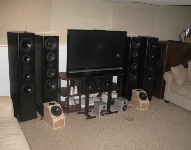

    They sort of stole the show (except for maybe my Open Range & Blue Man Group demos):
    In this positioning (which wasn't perfect), they are not necessarily perfect sounding, but shockingly good. The sound changes considerably for the worse when we pulled them further out into the room, because we were taking away the ceiling plane.
    Where you see them is where we listened to them. Everyone was impressed. The highs seemed a little rolled off. The base was extremely strong (Stronger than my Khans), maybe a little too strong and a little boxy. I'm sure clubbers would love them. They imaged well. The sound just seemed to float in the air above them. Moving around the room, the sound was very consistent. I got a good giggle out of standing directly over them in the null and having the sound just go away.

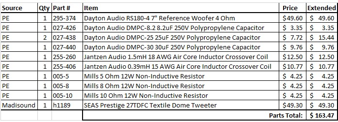

                                                                  Getting started again, looking at a BOM for these speakers.
                                                                  Hi everyone. Just coming back to the forums after a sudden and unacceptably long absence, hoping to pick up again with some of the projects y'all helped me plan a few years back. I'm wanting to start with something small, and had always planned to build these for my surrounds.
                                                                  Anyway, I've searched for a BOM and and never could find one (probably just missed it somewhere), so I whipped up this one and would appreciate a reality check:
                                                                  Thanks in advance for the help. Good to be back!
