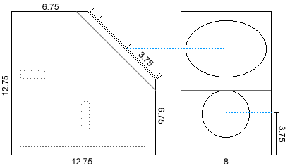

                                                                                    Box design (assuming exact 3/4" material - my box is actually slightly less as I used 18mm birch ply)

                                                                                    • AlanH
                                                                                      • 57
                                                                                      Hi Chris,
                                                                                      These look great for surround duty and would fit into my space perfectly. I love the idea of having them up on the wall and out of the way. Plus I already have two TDFCs and two RS180s sitting around!
                                                                                      I might have missed it, but have you posted a schematic with the box dimensions? How sensitive will these be to placement?
                                                                                      Thanks!
                                                                                      -Alan

                                                                                        Note that this is the RS180-4 and NOT the RS180S-8.
                                                                                        Reflection interaction will change with placement - IMO this is a design that tries to make do with a huge set of compromises and a small amount of flexibility to try to smooth over the unknowns. What I'm trying to say is, I think they'll be consistently not-perfect no matter where you place them, and that's by design.
                                                                                          Oops! Thanks for pointing that out! I totally missed it. Okay, so I have the TDFCs and I'll have to buy a couple of the 4ohm Daytons.
                                                                                          'Consistently not-perfect' sounds a lot better to me than perfectly inconsistent, which is what I feel I get when I try to wedge a regular TM box speaker into the corner of the room to serve as a surround. 8O
                                                                                          -Alan
