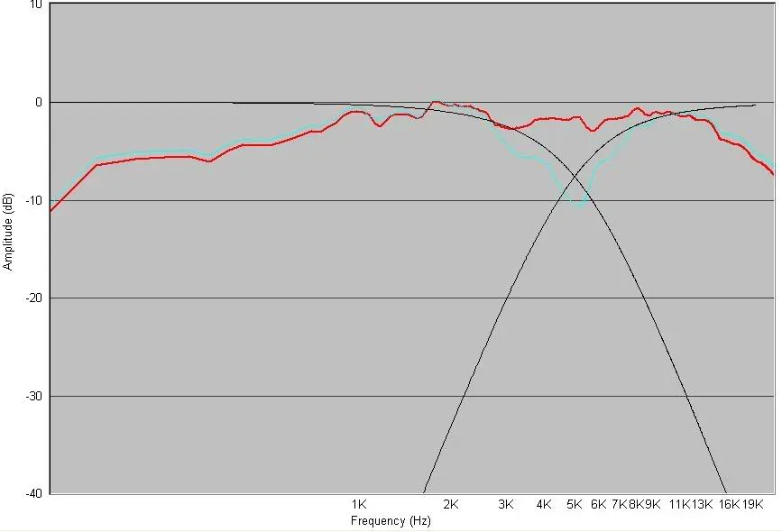

      Well I had a little time so I ran some simulations. I certainly have some more to learn about XO design, and I will take actual measurements before getting any parts. But it was still instructive. Designed a 6l box tuned to 65hz, did some baffle simulations and used FRC to add those all up.
      Here is what I was proposing--effective 4th order LR at 4200 hz

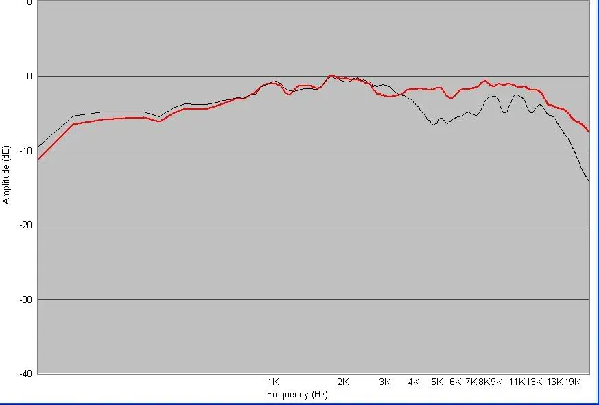

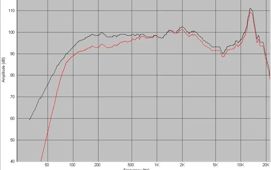

                  Ok I removed my sim pictures for the moment.... here is my original SPL trace (black) and then combined with my box volume and the output from BDS (frd tools) and combined using FRC (frd tools). Looking apropriate?
                  Oh. And how do I tame that beast at 13000 hz???? Or do I use a 6th order filter and how many octaves down do I need to get?
                    Just a simple notch filter will take care of the peak. No need to go 6th order.

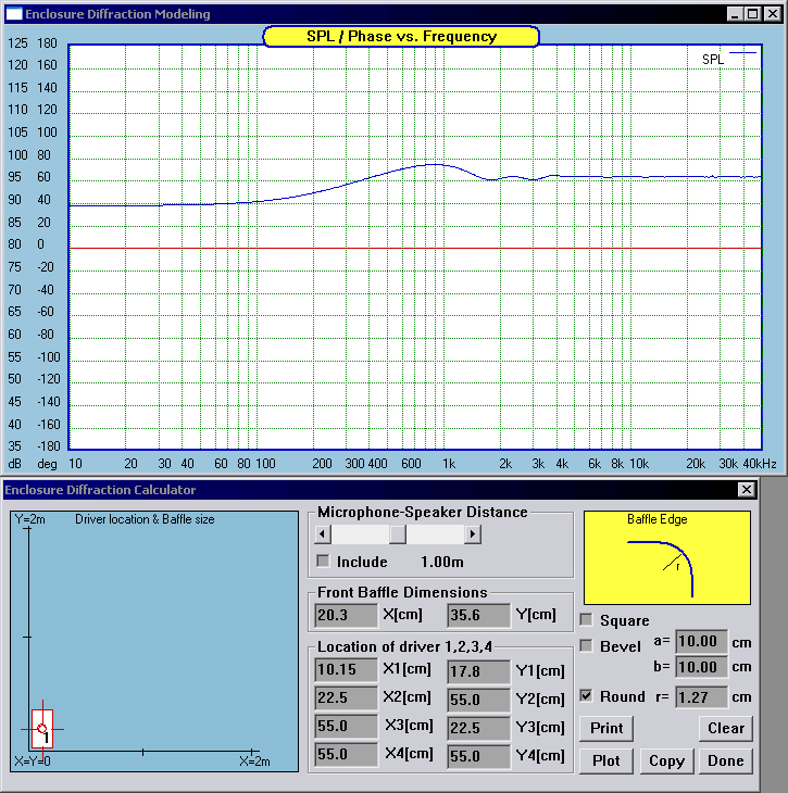

                        Your simulation is close but (including the ZMV5 diffraction)...
                        Notice the boost (+2db) centered at 1k. You don't have that in your simulation. Compare the infinite baffle and box measurements for the 55-3870 on Zaph's site. You'll see how this diffraction applies.
                        There are a couple of ways to tame the peak. One is to use a lower xover (2kHz) but your tweeter won't reach that low. Another is to use a 3rd order xover. This gives you more options but you'll be dealing with a bump from 1k-3k, once you have the BSD correct. Lastly, you can use a 1st order with LC in parallel (0.05-0.1uf shunt). This unique topology nets a very nice looking woofer FR but getting the phase correct and tweeter to mesh is difficult. A notch filter can be used but really only necessary if you're going up to 5k+. Below that, it can be controlled by the LP xo.
                        It may be simpler to start with the tweeter xover from Zaph's ZBM4 (Bargain Mini) and play with the RS xo until they mesh.

                          Ohhh--I am guessing our diffraction simualtions don't match because I am not using a rectangular box. Lets see if I can output something from the BDS......
                          Ok this is what I'm proposing. Its a chamfer, not a roundover.

                            Ok---so I have a Notch Filter on the Left, and a Impedance Compensation circuit on the right. How do I go about adding in Inductors and capacitors to increase my order?

                                  I don't think the shape or edge treatment will negate the rise, just simply change it's shape and position as it's due to the fact that the edge distance is less than a wave length away. If you cabinet was wider, I might agree but can't given your design. Again, if you compare the woofer measurements of IB and in-box of the ZMV5 or ZBM4, you'd see the boost. Even RM has a "simple" BSC that applies a slope below 1000Hz without the edge boost but it's only marginally accurate. And given the natural rise in that range of the RS, I would model a reduced midrange.
                                  The notch filters need to be inserted first in the xover, but it's an expensive solution in both cost and SQ. But you can listen to it yourself. The impedance compensation (Zobal) is a good tool for getting the woofer to model well but does add cost. (I'm doing that in my MTM.)
                                  I don't use Speaker Workshop to do modeling and so can't help you with adding the xover components.

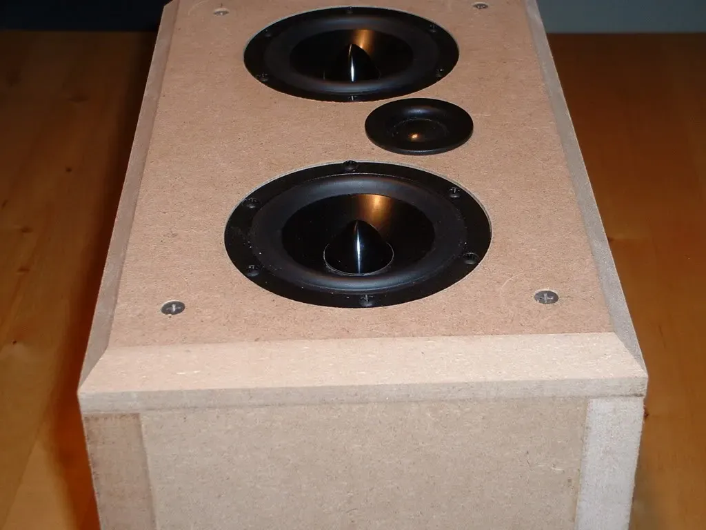

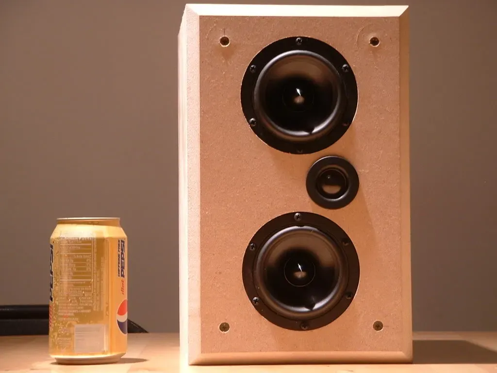

                                                So I built a box--here is a picture of the test box next to a pop can for scale:
                                                It isn't a big guy by any means--7.5" wide, 12" tall, and 9.25" deep. The driver should see a volume right about 8l. There is a 2" port 4" long. It is a bit of a hump but should help offset some of the baffle loss. Tuning should be about 75 hz (have not yet confirmed with impedance measurement)

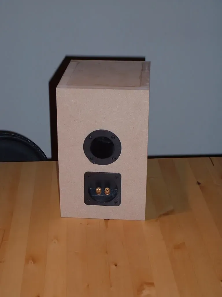

                                                On the front you can see the woofers are flush mounted (and gasketed). I accidently got a little too deep, once the veneer is on it might be a bit more obvious. You can also see the bevel I chose to go with for the front edge. I wanted to do something differently from a roundover, and was suprised it actually modeled better than a roundover in the baffle diffraction simulator. I will most likely go bigger with the chamfer--this was the size I was limited to by the bit I had in the table at the time--I can always cut more off (and will be interested in the changes in FR) Right now the face of the bevel is 9/16" leaving me a short little 3/8" flat edge on my removable front baffle. If I don't go bigger I may end up painting the front baffle because I really do not want to try and veneer that little lip.

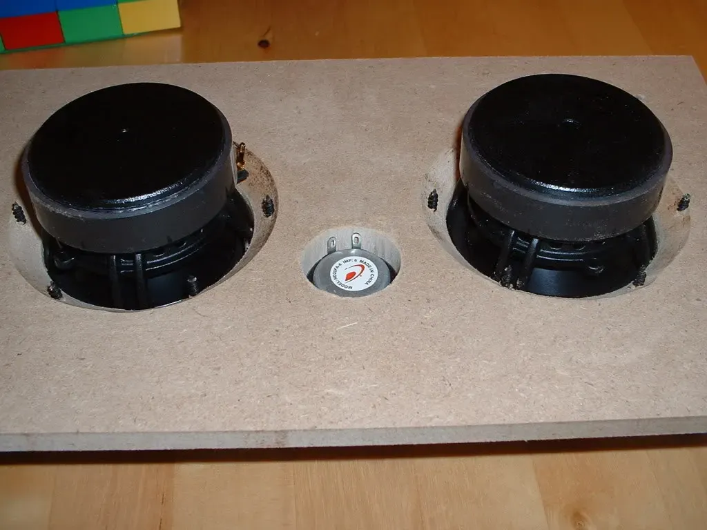

                                                  Took a couple more pictures after I opened them up to solder on a few wires:
                                                  First you can see the backside of the woofer cutouts have been relieved for improved airflow

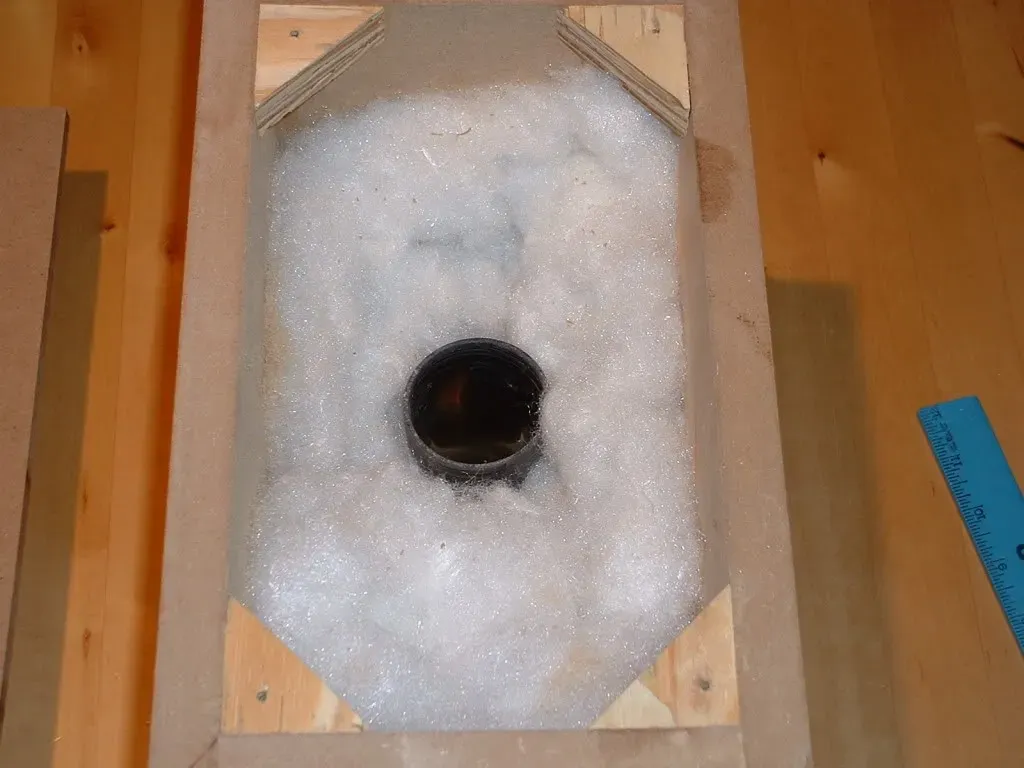

                                                  And I have lightly stuffed the cabinet with Dacron I had leftover from another project:

                                                      Yeah, that back baffle shot is a prime illustration on small drivers NEEDING some breathing room. Very much like the B3S/N's, they'd be down in a tube with unchamfered driver holes.
                                                      A bit deep on the driver rabbets... you might get by with another layer of gasket, or thicker gasket. I used some craft store 1/16" foam to cut gaskets on a tweeter, and had cut my holes before veneering, oops... added a thin felt gasket with the foam, raised it up nicely.
                                                      On the front chamfers, the wider the better. Same as increasing the radius of a roundover. I'd guess that 45 deg would be the most optimum angle, but I'd just be guessing. Hmmm... wonder if a wider chamfer detracts from the baffle width. Might want to simulate it and see, but 1/4" isn't going to be a big change..
                                                      • eyekode
                                                        • Jun 2008
                                                        • 45
                                                        Cool little speakers . Another suggestion for the too deep flanges is to use multiple layers of closed cell foam tape. Just keep stacking them! I have had to do this before and it works great.

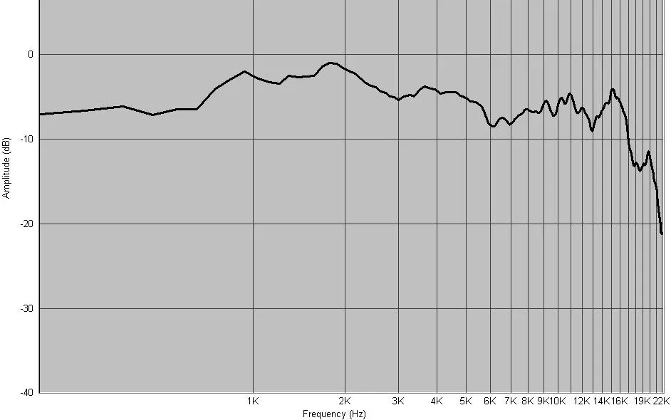

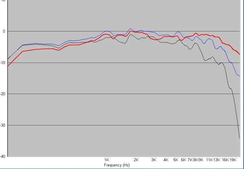

                                                          Well I actually stayed at work a bit late and took a couple of measurements. I will move into a big room either tomorrow or saturday so I can some better lower-frequency data. It still gave me something to play with crossover wise. I have a pretty good simulation going for a 2nd order butterworth at 5000hz
                                                          Anyway what really suprised me was the lack of the monstrous peak I was expecting in the 12k-13k range. This is what my gated farfield measurement looked like for the two RS100s.
                                                          It doesn't look near as bad as either the specs from PE or what Zaph measured. I will have to certainly do some more measurements to confirm this.

                                                            Here is the On axis, 30 deg and 60 deg graph.
                                                            The next picture shows the on axis along with the 4th order bessel target curves. It also has a line showing a measurement with the woofer polarity reversed--Does this confirm phase alignment--or not in a bessel alignment?
                                                            Now here is where I got a little confused. I have a tweeter offset from the center. When I took my first 30 deg off axis measurement I turned the speaker so that the tweeter was the closest driver to the microphone. I had envisioned that the tweeters would point inwards to the listening position so that is what I measured. However, my measurement ended up looking like this!
                                                            That is on axis along with the (I'm calling it inside 30 deg) measurement. Not very pretty. I turned the speaker so the tweeter would be the furthest driver from the mic (tweeter on the outside of the listening position) and got the resulting graph (first one I posted). Is this a red flag that something isn't right? I am thinking it is all baffle induced--but I wanted to run it by everyone and see what they thought.
                                                            My predicted response graph was very close to my final result--that was encouraging!
                                                              I don't think there's anything wrong. Probably just means you should use them with the tweeter on the outside.
