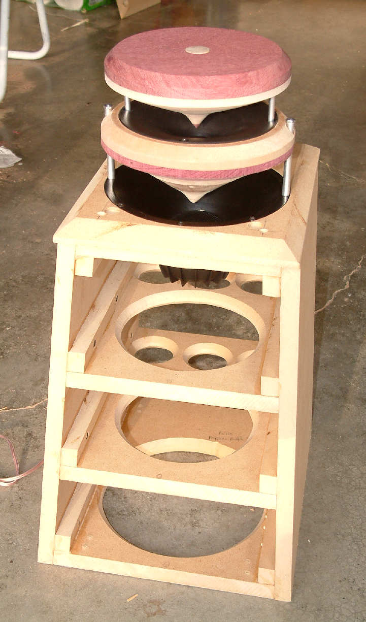

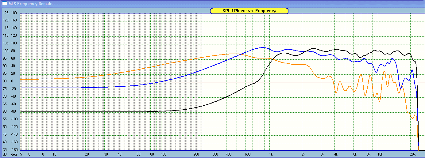

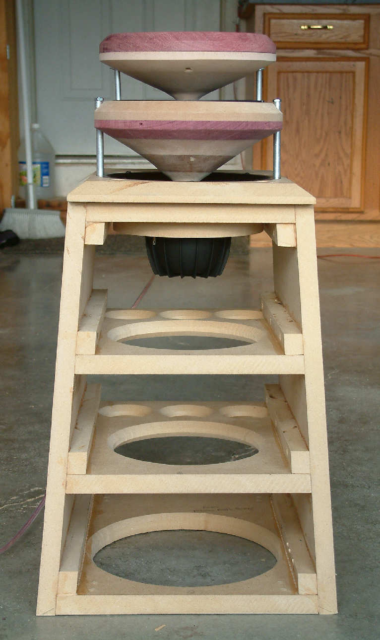

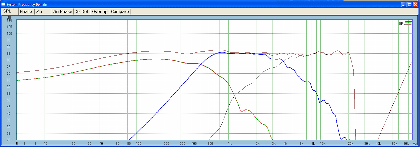

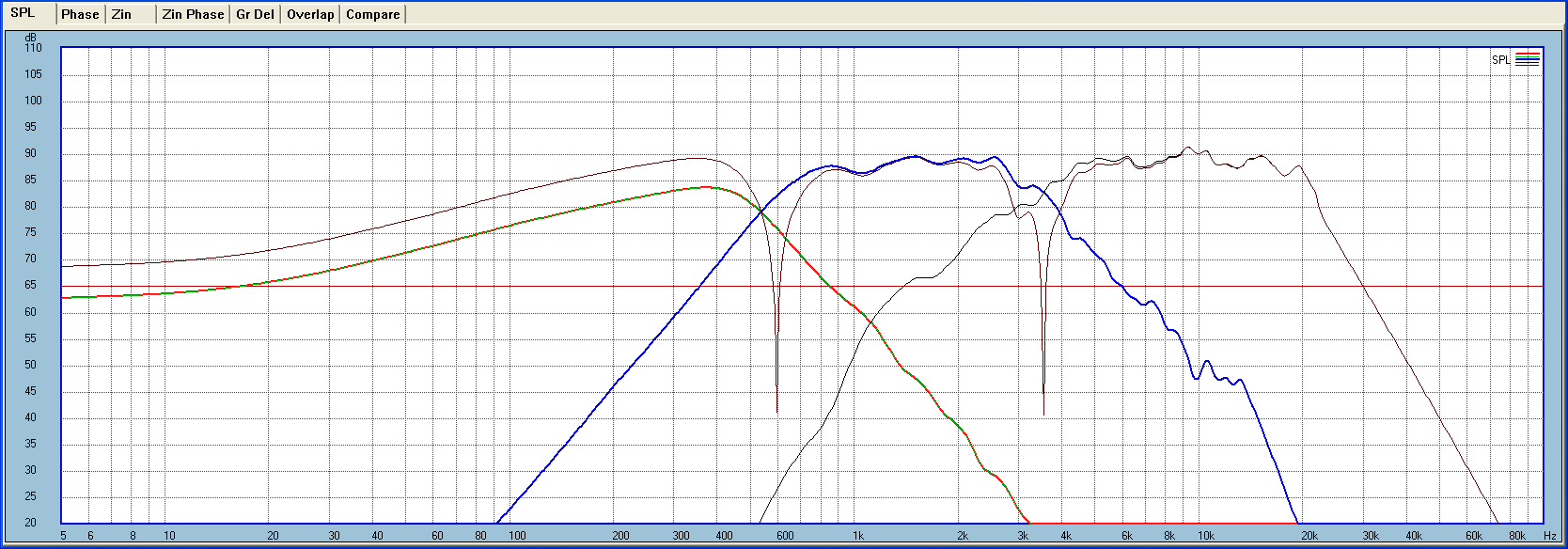

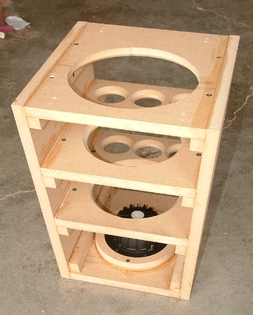

    Here are some construction photo's. The first one show the RS52baffle from below, with the 8"PE waveguide. I've treated the WG with plumbers putty to dampen any vibration and resonance in the plastic. There was a dip of about 3db in the RS52 response centered at about 1.7khz that flattened out as a result. If you look at the previously posted RS52 measurments, you can see where the plumbers putty application filled in. The plumbers putty treatment was also done to the ND20 waveguide (MCM6.5").
    The second photo is of the top box with bracing pictured from the woofer end. For now, the baffles simply screw on to the structure, but they will eventually be connected with hurricane nuts and cap screws, probably combined with a layer of anti-vibration material of some type. I'm debating whether to make the baffle out of hardwood for aesthetic reasons. If I do mdf, I will most likely have to paint the baffles. I'm not too keen on trying to apply veneer on those chamfers!
    The remaining two photo's show the same box, but with the top baffle set on top. I have trimmed the top diffuser down and added a top chamfered piece to finish it off and hide the hardware. I think it looks nice enough like this to finish it without covering the top. The top (RS52) baffle will eventually be remade. The holes you see that were originally for dowels to hold up the diffusers, etc., are no longer needed with the way I've mounted them. I do plan on making the bolts that hold the ND20/WG shorted, and to use cap nuts that will set in the recessed area rather than stick up as they do now.

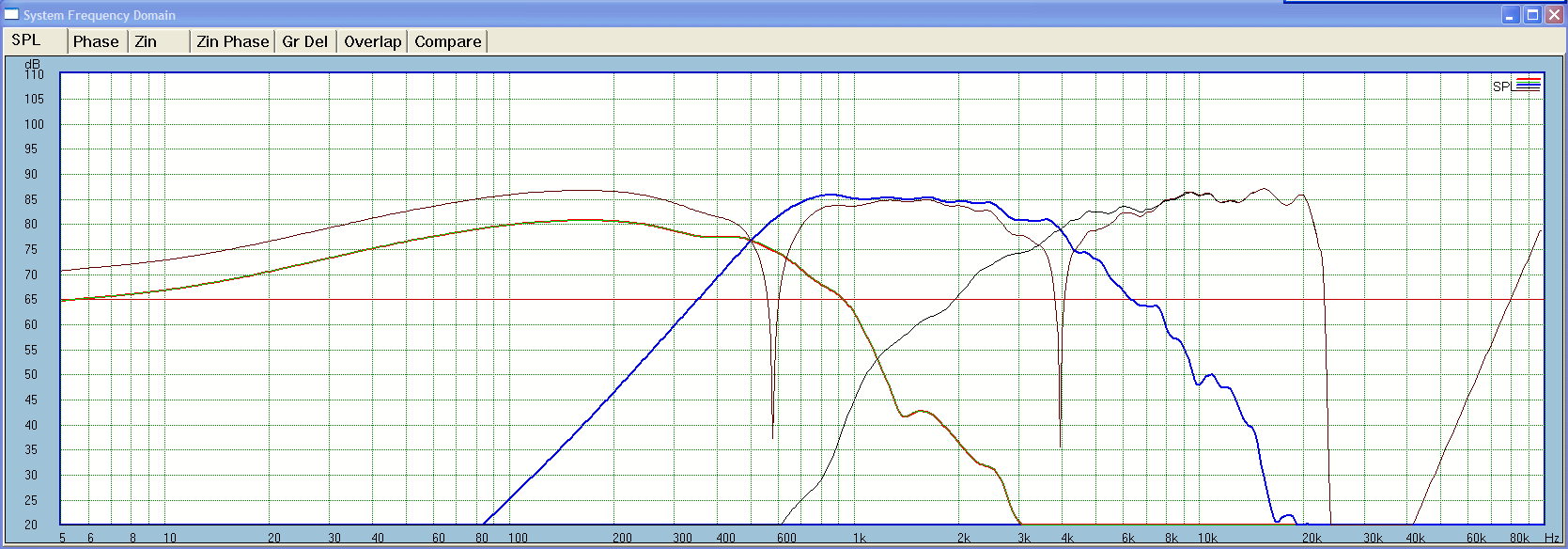

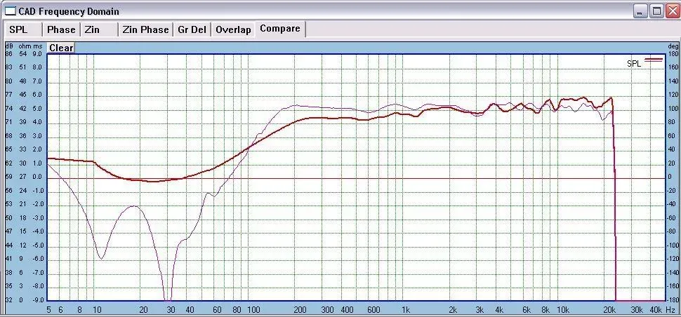

    Finally, there is a plot of the ND20(blue) and RS52(green). I was concerend that the RS52 FR would be substantially changed due to cutting down the concave diffuser from it's original 13" dia. to 8" dia. Also, my original measurments of the ND20 in WG was with it sitting on about a 10"x18" wide box top/baffle. I was concerned that going to a round baffle with the WG recessed into the RS52 diffuser would also result in some negative results. The responses are different, but not as much as I feared. Interestingly, both the RS52 and ND20 have a more ectended low end than they did in previous meaurements. The smaller diffuser for the RS52 and round baffle for the ND20 did seem to result in some loss of flattness to the FR's at their upper ends. I would imagine that some of the dips you see are due to diffraction from the round baffles, but it doesn't look too bad to me.

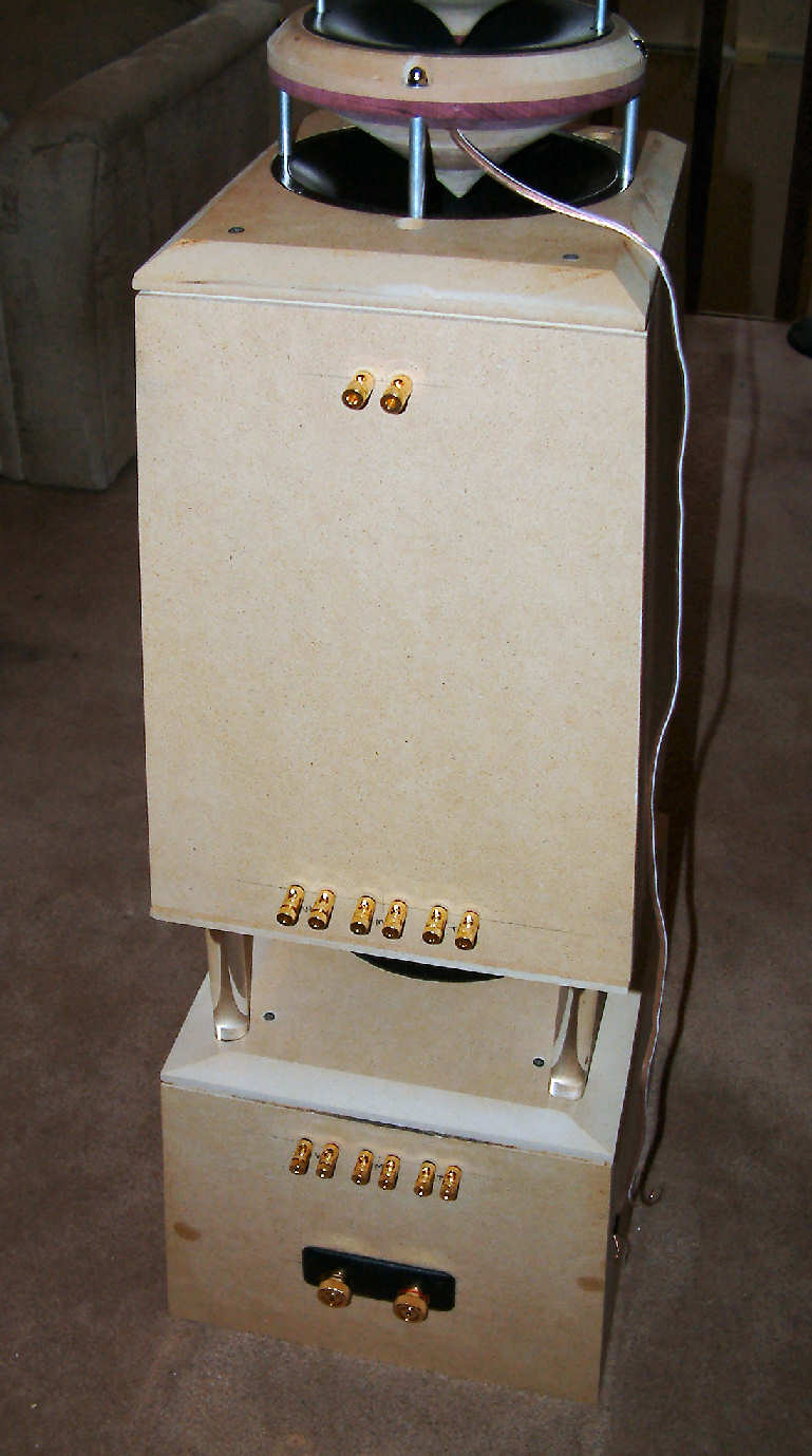

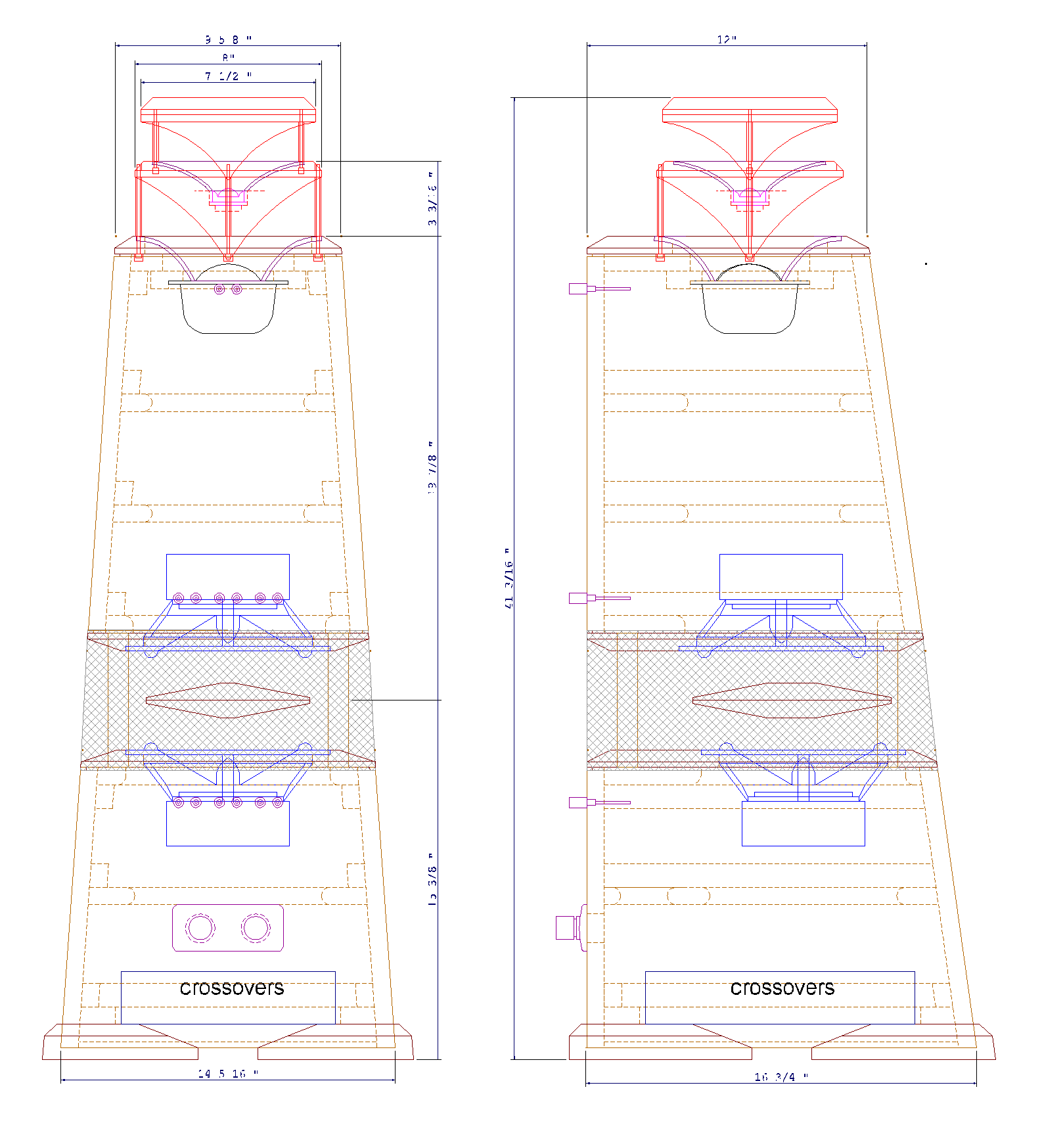

      Nothing much new, but thought I'd post the plans I'm following (pretty much so anyway) for the construction. There are a bizillion dimensions due to the angles, so I turned most of them off. I'm hoping my woofer to mid and mid to tweeter distances work out ok with my preliminary thoughts on crossover points, around 600hz and 4.2khz or so.
      Believe it or not, I need 8 pairs of binding posts! :E This is because I want to put all three crossover sections in the bottom box. So I have one pair for input that goes to the crossovers, then a pair from each crossover that has to be connected to the top box and then one additional pair that connects to the tweeter lead up above.
      I hope to mount the crossovers on the bottom section of 3/4" mdf, which will be removeable. I have about a 9-1/2"x11-1/2" area to fit them all in, so I'm crossing my fingers that my inductors and caps don't get too big.
      I have two types of damping sheet material coming from PE to use at the back of the removable baffles, which might end up hardwood, and a bunch of binding posts. I would like to finish up the prototype build and start design measurements this weekend, if I can figure out the best way to take them in this case!
      I should have more photo's once I get the prototype build done in the next couple days. I'm still struggling in coming up with a good looking way to transition from the bottom box to the floor. You can see what I'm thinking for now on the plans. If anyone has any thoughts or ideas, I welcome them.

        Is that eight pairs per speaker?? A total of 16 pairs, or 32 individual binding posts? I hope you got a quantity discount!
        I hope it wasn't too costly. This project is looking good- I'm glad to see all the progress.

          Hi Joe,
          Yes, that is 8 pairs per speaker! :E If I put the crossovers in the top box, I could have reduced it to 4. However, I had room in the bottom box and could make the crossovers removeable and accessible from the bottom, so I decided that was the best solution for me. That's part of the price you pay for having drivers separated between essentially three boxes (or housings) BTW, I had 7 pairs/speaker in the original omni, but 2 pairs were internal.
          Actually I ordered just 2 single red and 2 single black 1-1/2" long binding posts from Madisound when I picked up the Seas and Aurasound tweeters to test, knowing I would need some, but I had not though about how many I would need at that time. They are only $1.55 each, but the surprise was they sent me 4 pairs, not 4 singles. I think someone at Mad messed up. At any rate, I ordered another 6 singles, enough to complete one prototype speaker. If they mess up again and send my 6 pairs, then all the better. :W Even $3.10/pair is about 1/2 the price of similar ones at PE.

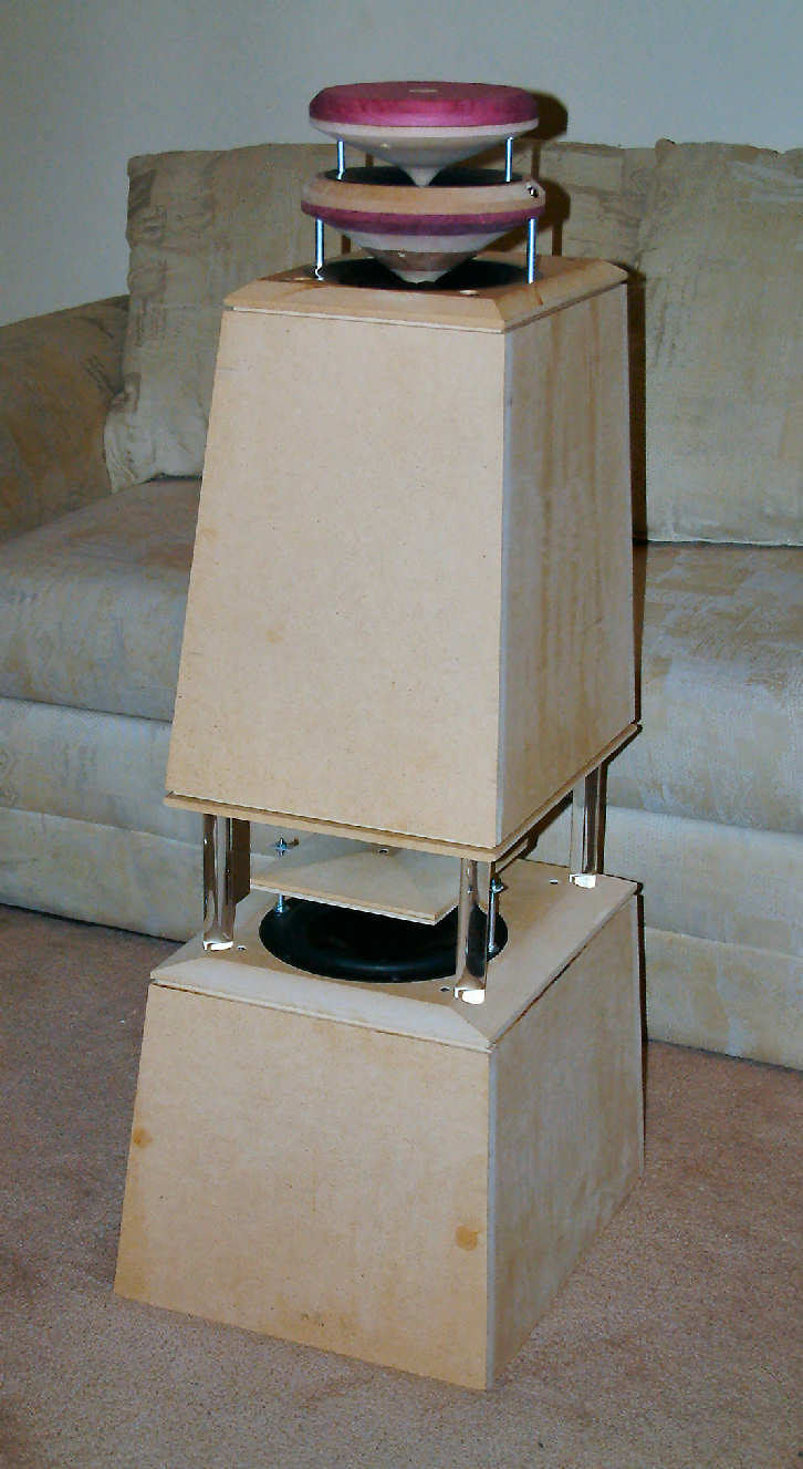

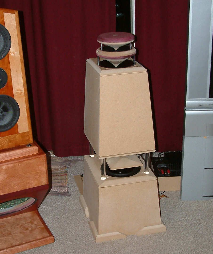

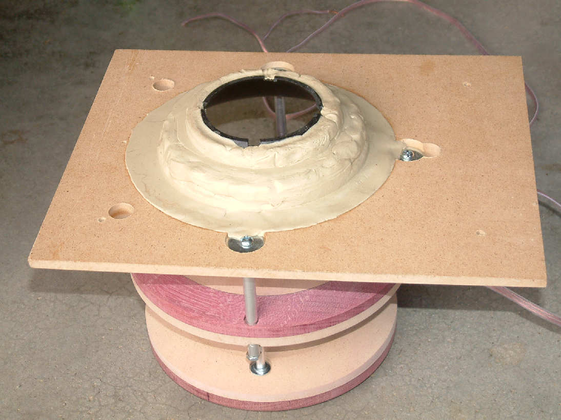

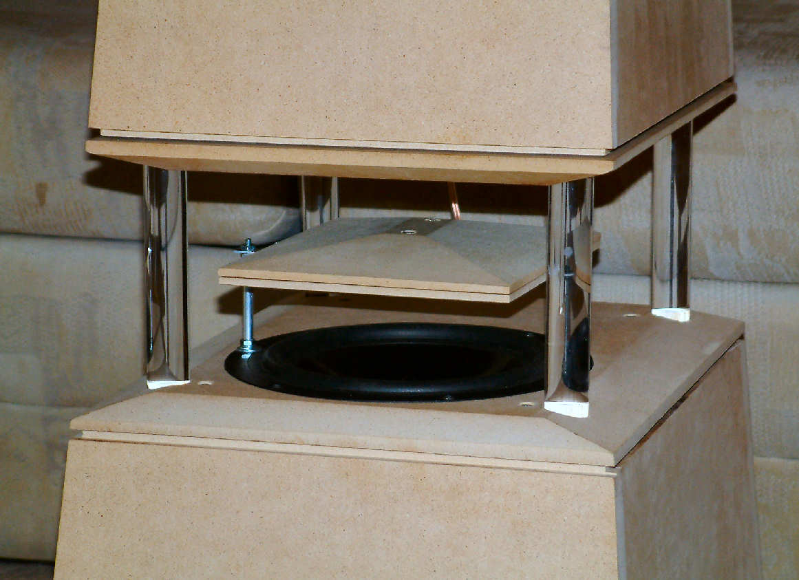

                For anyone still interested, here are some pics of the nearly finished prototype. I only have to add the trim/legs around the base, which will raise it up about 1/2" or so.
                I got the idea to try solid acrylic rods in place of the hardwood dowels between the two boxes. I like how it looks and may even use acrylic tubing in place of the aluminum tubing where I currently have it.
                I also added a combination of 1-1/4" PE sonic barrier to all 4 sides of both boxes and then filled about 75% with acousta-stuff for the remaining areas. Finally, I added a layer of mineral filled viscoelastic polymer damping material between the woofer baffles and the 3/4" mdf behind them. It has a self adhesive backing and was simply cut and stuck in place. I've also added the binding posts to the back and connected the internal wiring between them.
                I have done a bunch of measurements and there will be more on the effect of stuffing and wall lining in subsequent posts.

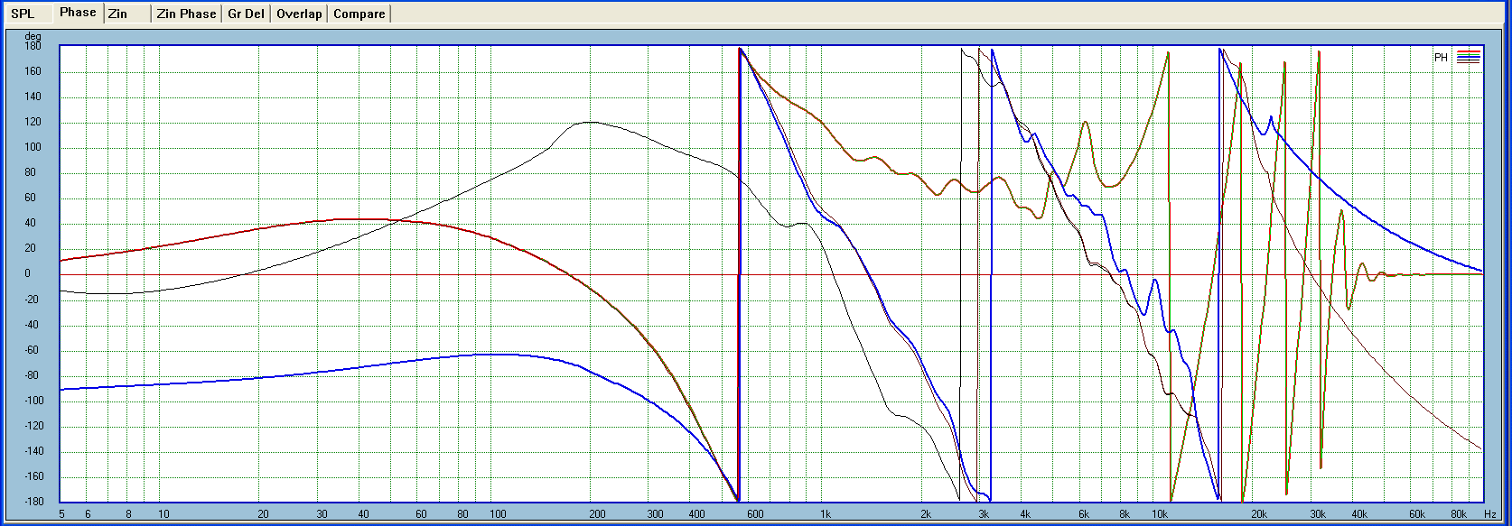

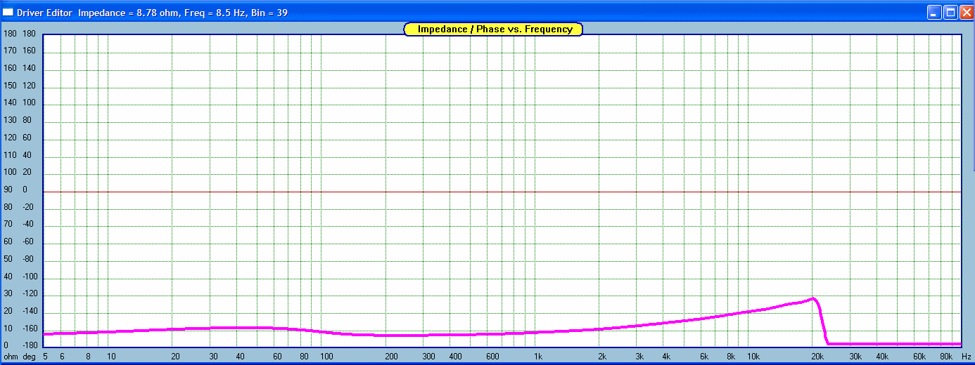

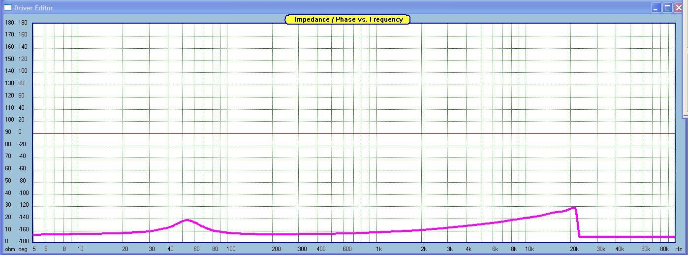

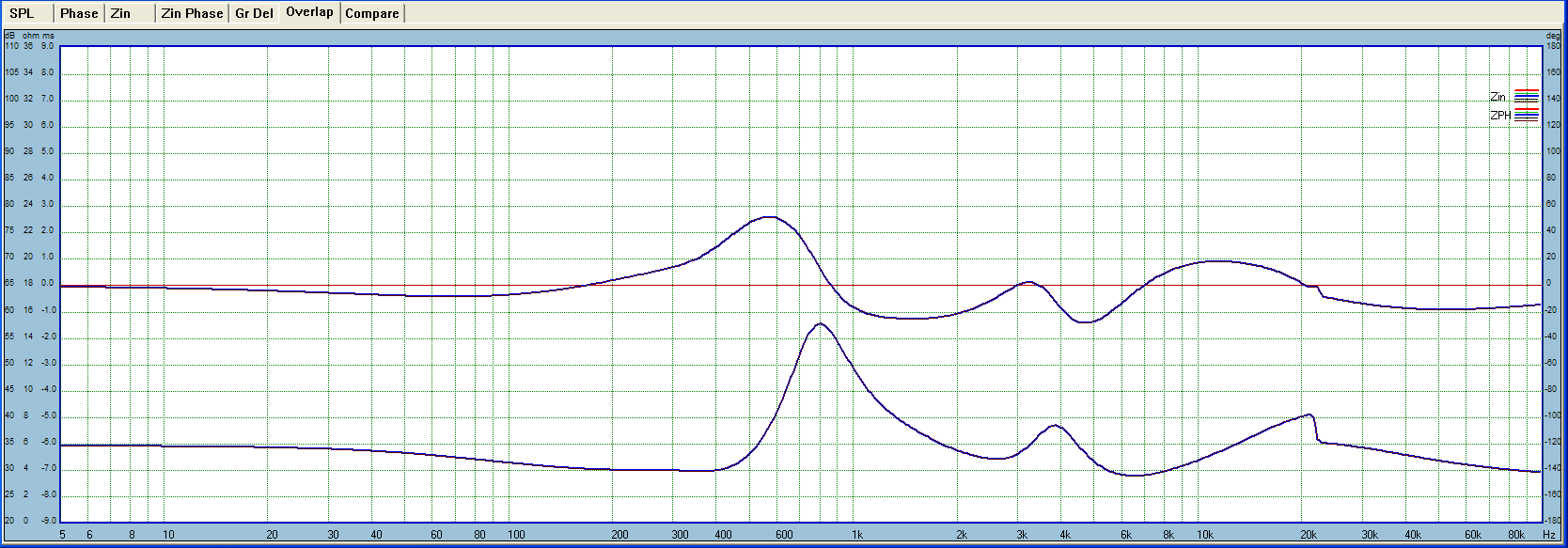

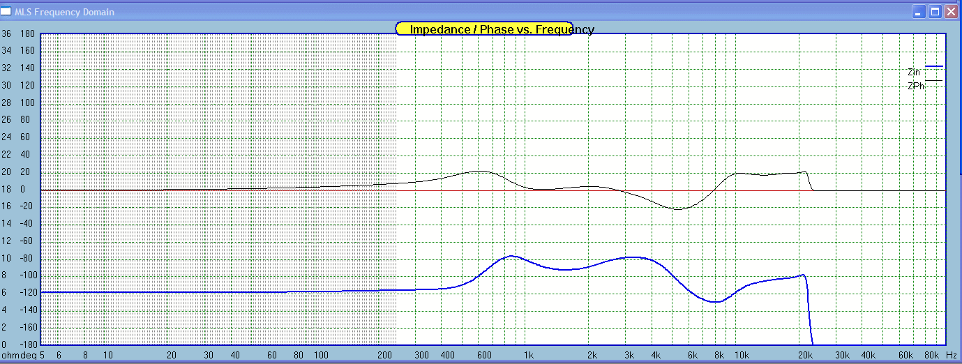

                  Here are some comaprisons of one of the RS225's (bottom box) before and after adding sonic barrier, acousta-stuf and the mineral filled vinyl constrained layer behind the baffle.
                  The first plot is the impedance of the RS225 without any fill in the box. The second plot is the impedance of the RS225 after the stuffing, etc. has been added. The stuffing seems to have generally lowered the overal impedance up through 100hz, but resulted in about a 8ohm peak at 55hz.
                  The third plot is the nearfield FR and phase of the drivers with and without the stuffing etc. The orange line is without and the blue line is with. Not only is the FR smoother with the stuffing, etc. it is more extended on the bottom end, starting at about 50hz, up almost 5db at 20hz in this 25l sealed box. The phase plots are the same color, but the smoother one is the one with the stuffing, etc. added.

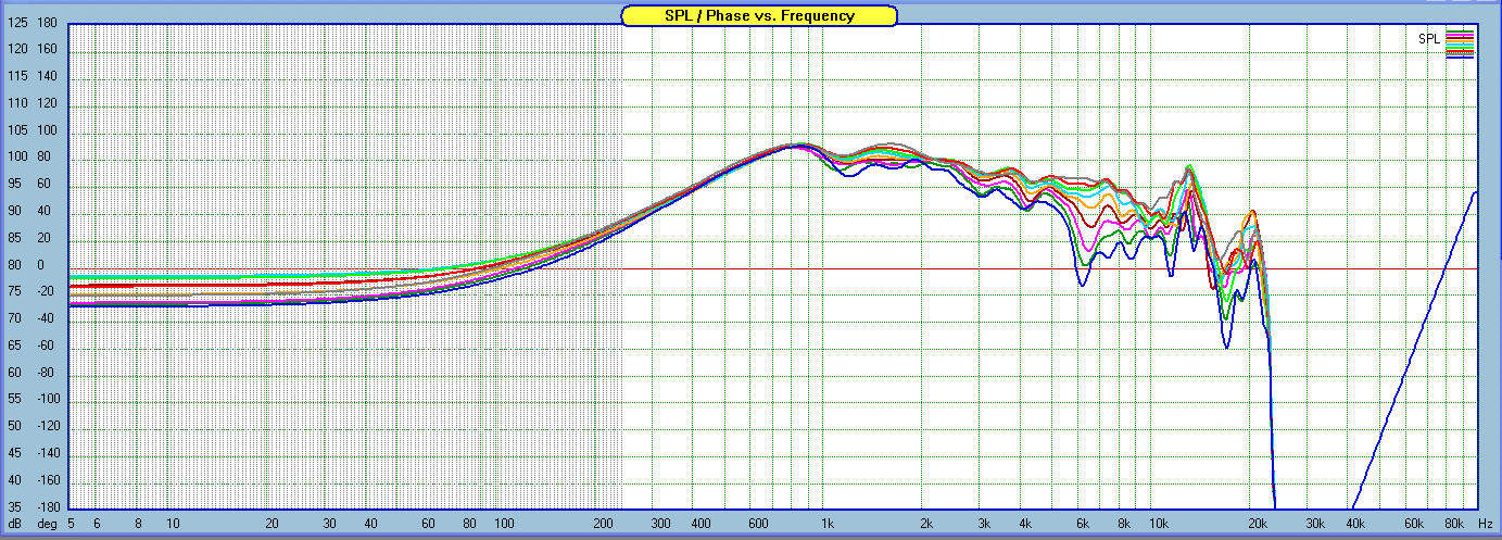

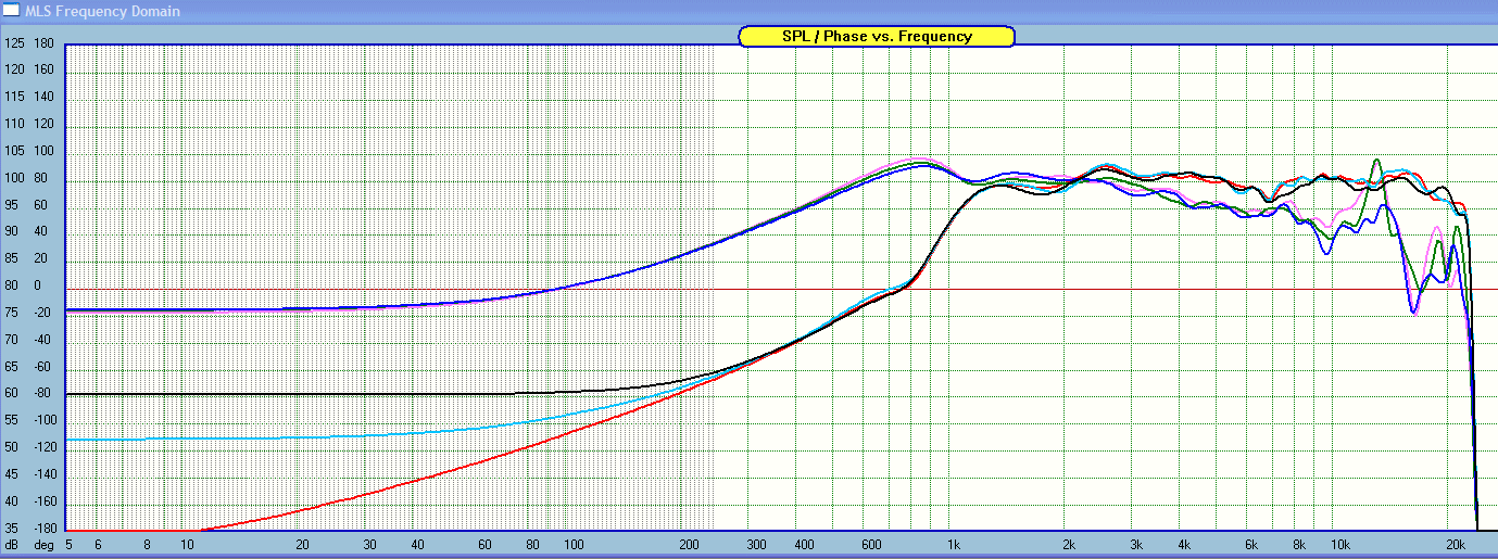

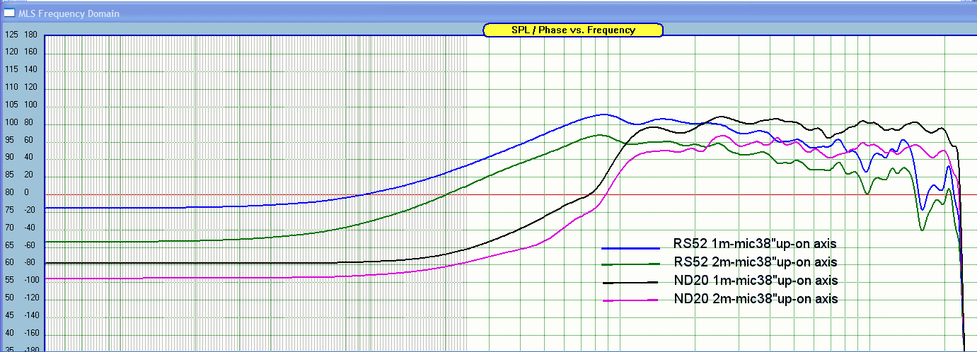

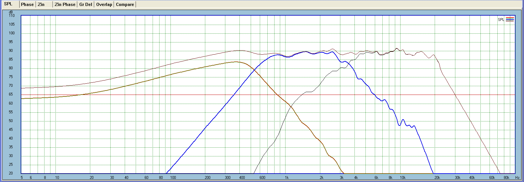

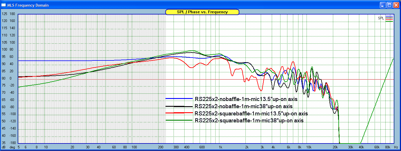

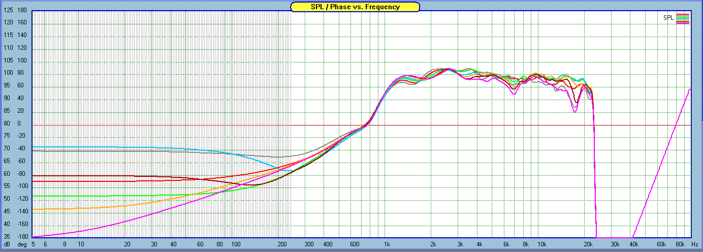

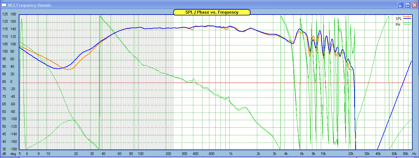

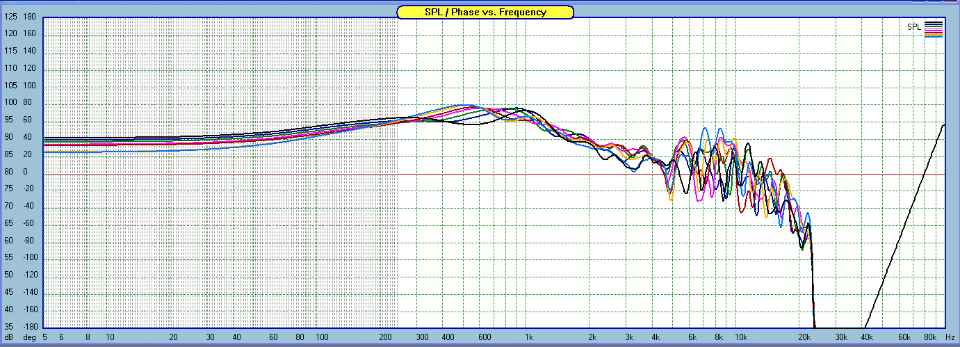

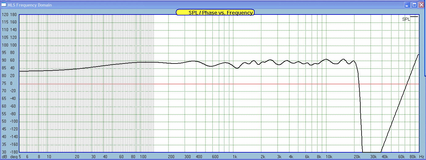

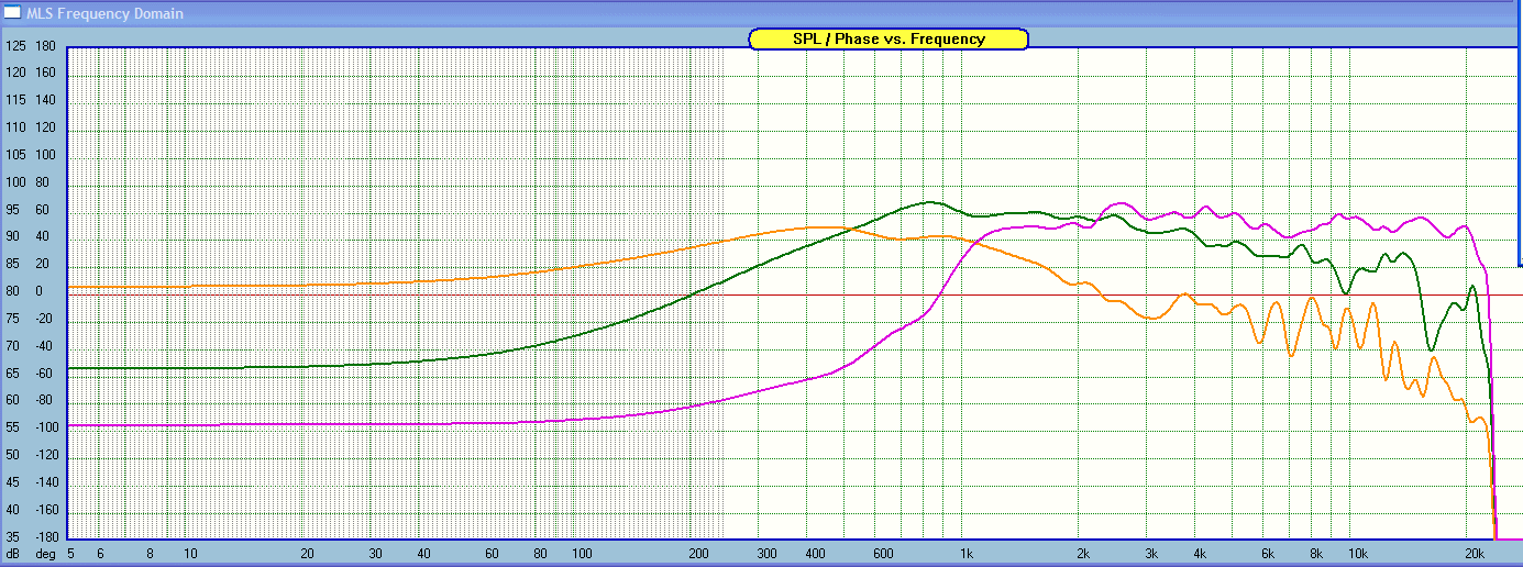

                      Here are some FR comparison measurements for the drivers. I was unsure (still am) of what method to use for the design measurements, so I tried various methods to see how they compared.
                      The first graph shows the RS52 and ND20 with the mic at both 1 meter and 2 meters and 38" high. There seems to be little significant difference between the two.
                      The second graph shows the RS225 with the box or mic in various positions and with no baffle between the woofers and with the rectangular chamfered baffle between the woofer as shown in the pics in the post above. One setup was with the box sitting on the floor, the mic up 13.5" setup and 1 meter away. The second setup is with the box raised up so the woofers were centered at 38" high and the mic was at 38", 1 meter away.
                      The third graph shows the RS225, RS52 and ND20 at 1 meter with the mic at 38". The 4th graph is the same as above, but at 2 meters. Not much difference between these either, so I think I could use either 1m or 2m measurements.
                      The final graphs shows the RS52 and ND20 on axis and also at 45º and 90º off axis. The 45 and 90 degree off axis FR's track the on axis response very closely, so omni effect and the power response without crossover should be good for 360º.
                      I did not yet do any vertical polar measurements, but plan to do so.
                      Does anyone have any suggestions as to what set of measurements they would use for design?

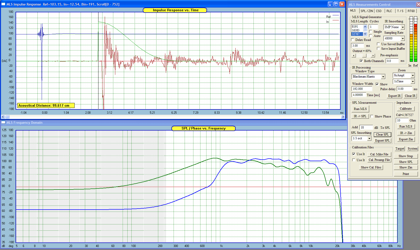

                        These are nothing but raw response measurements from each driver in SoundEasy using a 4ms gated digital MLS measurements. There is no crossover yet, so there is nothing to listen to.
                        Heck, I don't really know how to start on the 3way crossover design and I can't seem to get any help with suggestions for crossover points relative to my CTC distances or the raw responses that I have.
                        The raw response of the tweeter was a bit flatter before, but that was when the waveguide was sitting on a flat baffle of about 10"x16", and now it is sitting in an 8" round concave diffuser. I suspect that some of the changes are due to diffraction from what in effect is a round baffle for the tweeter.
                        Dan N.

                                        • 1456
                                        #109
                                        Ok, vertical measurements.....
                                        I don't know if I did these correctly, but here's what I did. I started with the woofer and did 1m distance, 14" up from the floor with the speaker sitting on the floor. Then I went up in 4" incrments to 38" , while keeping 1m distance from the bottom woofer.
                                        I then repeated this for the midrange, except I went from 18" up to 50". Then the tweeter at 26" up to 50". The colors for the graphs were the same for each graph as follows:
                                        14"=black
                                        18"=dk blue
                                        22"=dk green
                                        26"=pink
                                        30"=dk red
                                        34"=orange
                                        38"=lt blue
                                        42"=lt green
                                        46"=red
                                        50=gray
                                        The plots below are the woofers first, followed by the mid then tweeter. I don't know what to look for here, but they look to me to be pretty consistent throughout the range. The woofer is the most different, with a broadf 5db peak that changes from nearly 1k at 14" to 500hz at 38".
                                        Let me know what these tell you and if anyone has any suggestions as to further measurements. Also, how to interpret these when it comes to making crossover design choices such as choosing crossover types and slopes or target crossover points, I'd sure like to hear them!

                                          #110
                                          As if I had done several omni speakers... :roll:
                                          It looks to me as if the diffusers are not controlling directivity below 1k. No problem for the tweeter, but there may be a lot of mid-dome signal below 1k spraying the ceiling. To be sure, try holding mic/driver distance constant and sample FR while moving the mic in an arc from 38" high to directly above the speaker (how close is the ceiling?).
                                          If, in fact, there isn't much diffuser directivity below 1k you could either increase the diameter of the diffusers or raise the mid crossover frequency to make the mid more consistent. The woofers don't seem to negotiate the cabinet so easily above 1k so maybe that helps. Tweeter seems fairly well controlled above 3k. Target the best overall woofer response around the listening position.
                                          Joe's suggestion of steep slopes may be the least problematic. Anyhow, that's my 2 cents. Like you, I wish more people would take a shot at this...you've undertaken a really interesting challenge!
                                          Paul

                                                      #116

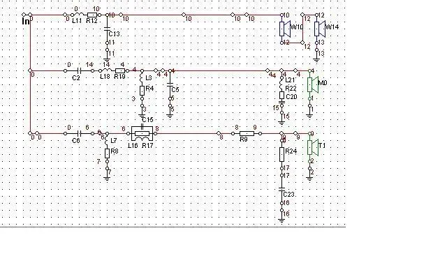

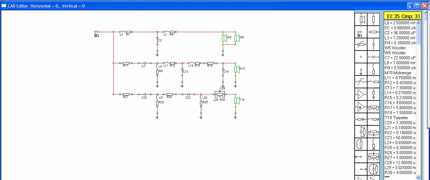

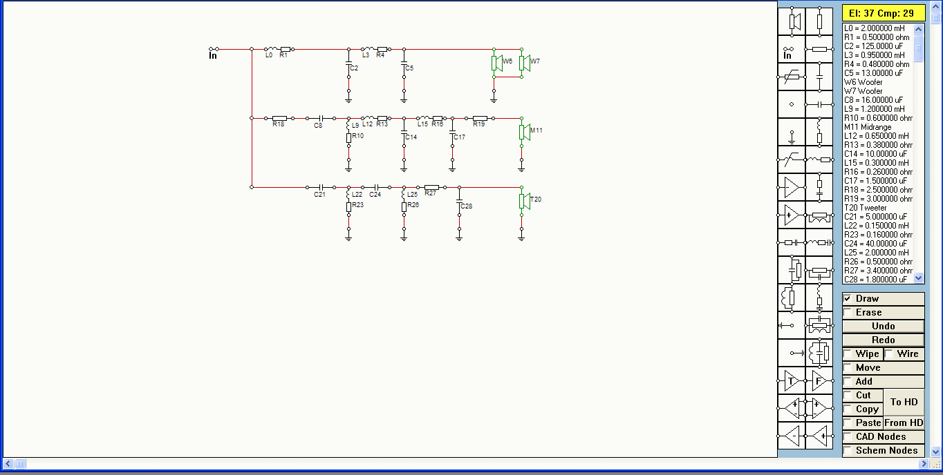

                                                      While I'm contemplating what the best scenario for doing the measurements is, I decided to pick on of the sets I already had and try to model up a crossover. I used the measurement set which is 2m distance, 38" mic height, same position for the mid and tweeter. The woofers I used measurements from 2m, mic at 38", but the speaker was raised off the floor so that the woofers were centered at the mic height of 38". All measurements were with 4ms gated windows, 1/12 octave smoothing applied. The woofers were measured as a pair, but the FR was imported 6db down from the tweeter and mid so that when the two drivers were added in SoundEasy, they would sum correctly.
                                                      I was shooting for 600hz and 3600hz crossover points, for a 2-1/2 octave spread. These points seem to make sense to best avoid the distortion areas of the mid and tweeter. All slopes were intended to be 4th order acoustic and all are 4th order electrical, except the high pass on the mid, which is LR2 electrical. Below is the results. It took a LOT of iterations and tweaking to get this to work. For those who are not familiar with SoundEasy, it adds both a inductor and resistor component at each inductor location, but the resistance is only to allow you to include the DCR value of the inductor in the model. There is actually 18 components in the crossover despite the list showing 28 at the right.
                                                      I had to do some messing around with resistors at either the amp side, driver side or both to get a reasonably flat response with good phase tracking at the crossover points. I'm not sure if this is an acceptable method or not. Also, I added a cap after the driver side resistor on the tweeter to flatten the rising top end of the tweeter. I don't know if that is advisable or not either.
                                                      Also attached is the modeled FR of the crossover, the reverse null, the impedance/impedance phase and the phase plot of all three drivers and crossover. For some reason, SE doesn't want to plot sum of the two woofers all the way to the bottom of the graph, which makes it look a little confusing. The one you see for the woofer is the ouput of a single driver. I also have a group delay graph I can post, if anyone wants to see that.
                                                      I'm looking for feedback here. Let me know what you think!

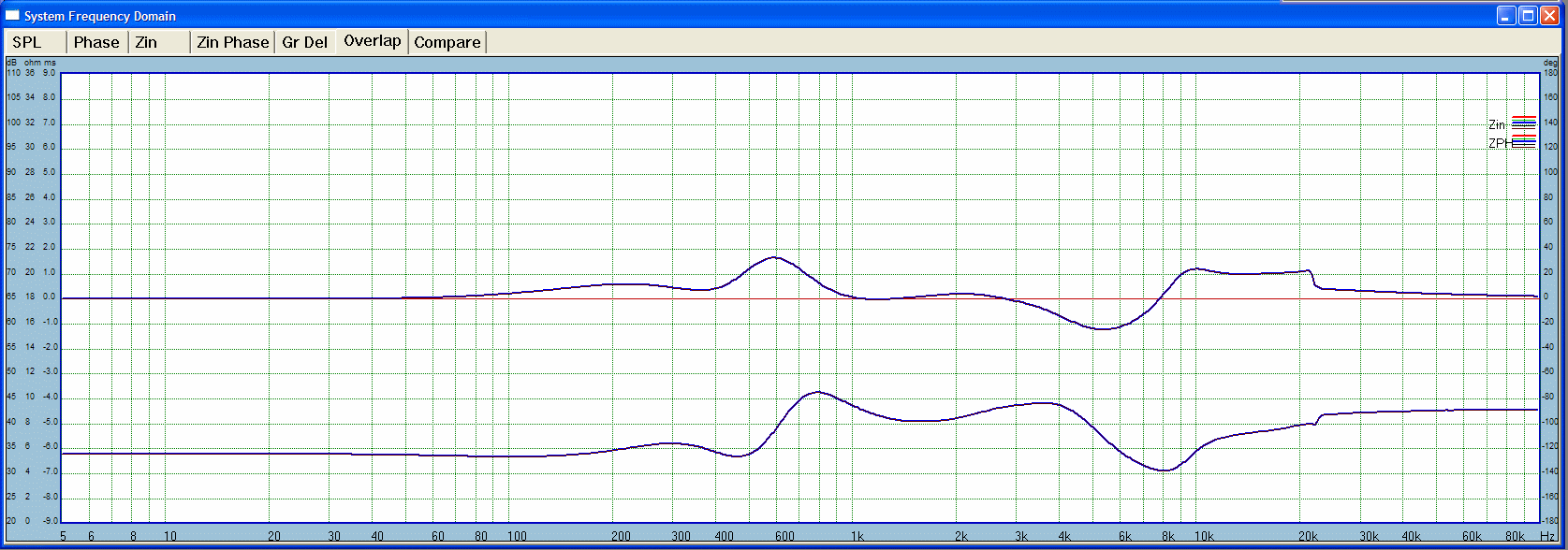

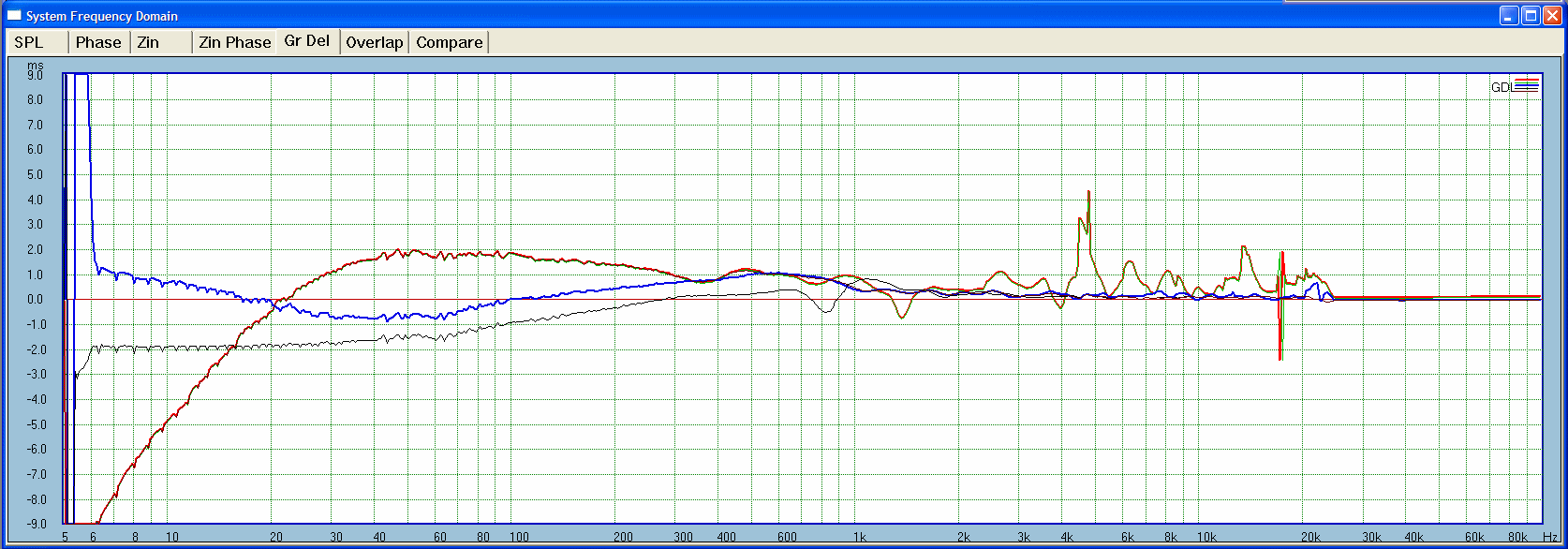

                                                                    #123

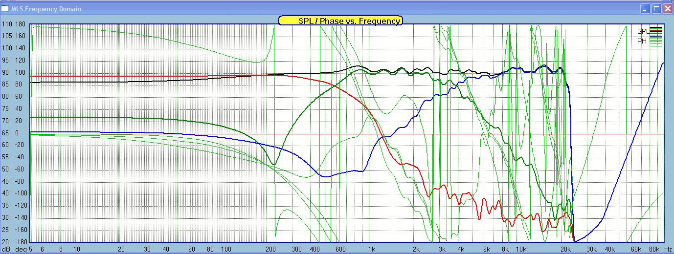

                                                                    I decided to do my measurements at 2 meters, with the mic at 38" and kept at that height. All measurements are with a 4ms gated window with no changes in mic or speaker position between measurements. Adjustments for the difference in driver to mic distance are then done in SoundEasy by setting up the driver positions relative to each other in the "front panel layout", which is intended to account for any differences in acoustic offset from the driver to the mic position.
                                                                    When I took the measurements, I tested several diffusers between the woofers. No diffuser, the current rectangular diffuser and a 10" round diffuser were tested and none seem to have any effect on the FR below 1khz or so, at least with the short gated window I'm using. Above 1khz, in the natural roll off area of the driver, there is a difference. I don't think the diffuser makes a difference for the crossover design, so I will do more tests after the crossover design is completed to see if it can have any positive effects on the sound I hear, or on the measurements at that time. That will include nearfield tests (at the front of the speaker/baffle edge) to determine if there is any difference between the diffusers.
                                                                    I was concerned about the rising FR in the midrange and peak around 3k with the first crossover posted above and also with the peak in the tweeter output at around 9-11khz. The crossover attached is an attempt to address these issues. I simplified the woofer net by going to a 3rd order electrical for a 4th order acoustic. I also was able to mess around with resistor placement and values, amongst other adjustments in the mid net and get the slope reversed, so that there is a little bit of a BBC dip now in the 3k area. An LCR trap was added to tame the peak of the tweeter a bit at 9-11khz.
                                                                    Included is the xover, FR plot, reverse null plot, impedance/impedance phase plots and a group delay plot.
                                                                    The results looks pretty good to me, though I see that there are some funky looking things in the group delay plot that were not present before. I don't know how big a concern that should be.
                                                                    Anyone have any thoughts?
                                                                    I decided to mock this one up and see what it sounded like. I will post that next.

                                                                      #124

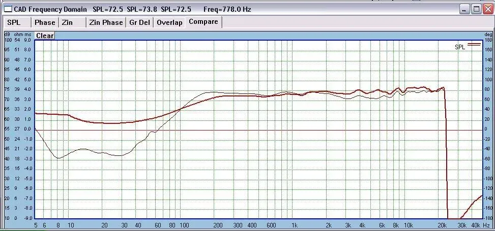

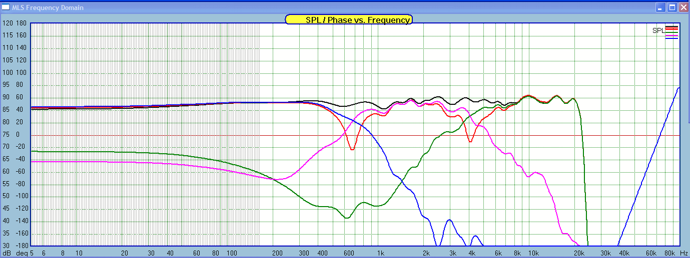

                                                                      I mocked up the crossover above and hooked things up. The drivers are all new, except the miniscule time doing tests, so there needs to be a lot of break in, but all in all I think it sounds quite good.
                                                                      I'll wait for further break in and tweaking before posting a more detailed review, but I will mention a few things I noticed. The speaker is amazingly consistent across the room. You can walk across the room from +45º to -45º and the sound is extremely consistent. The speaker is harder to localize and even bigger sounding than my original omni. The bass is very good for a sealed f3 of 50hz, but it sure doesn't have the deep end or impact that the 12" powered subs in the bottoms of my first omni. However, with one of the old omni's hooked up, with one 12" sub playing on one side and the Mentor 2 on the other, the balance is pretty good. The single 12" fills in the bottom end. If I turn off the top end of the old omni so jus the 12" sub plays with the Mentor 2, I can simulate what these will sound like with a sub kicking in around 40-60hz.
                                                                      I took just a couple on axis measurements of the speaker. These were taken at 2m, 38" mic height, 5ms gated window, 1/12 octave smoothing. The response below 500hz or so is not going to be very accurate, so you can probably ignore that. Attached is the measured FR of each driver along with the overall response. Also attached is the impedance/impedance phase plot.
                                                                      The one thing that has me confused is the results of the phase matching. the speaker seems to match phase at the upper crossover, now around 4khz, but the low end crossover, a little under 600hz does not seem to show good phase matching. The model shows good phase matching, so either I have some raw measurement problems, or I'm not setting things up right in SE to account for the acoustic delays due to driver offsets. Anyone have a suggestion here?
                                                                      I'd also like to see that peak at 850hz or so controlled a bit. The impedance looks good at about 6 ohms, with a low of 5 ohms at 8khz.

                                                                        • 1871
                                                                        #125
                                                                        Hi Dan. What's with the resistor in the bandpass? Try using a T-bandpass layout for kicks. Basically C7 and L11 are in a row then L8 and C13 after that. JonM mentioned it once and it really helped a low impedence/high sensitivity bandpass that was causing me problems. In my particular case it also lowered the Q of the HP section of the bandpass, so that hump at 850Hz may drop a bit too.
                                                                        Also what method did you use to measure the two woofers? I used John K.'s method for doing my MTMs and the measured results of the actual speaker vs. the model are kind of strange. Sort of like yours, lower woofer level than expected and slightly different phase. Luckily the addition of 1.5 Ohm resistor to the tweeter solved this. Very flat response and they just sound great! But I'm still trying to sort that method out...
                                                                        ~Brandon 8O
                                                                        DriverVault
                                                                        Soma Sonus
                                                                          • 1456
                                                                          #126
                                                                          Hi Brandon,
                                                                          The bandpass section was originally made up of an LR2 electrical for a 4th order slope on the high pass, combined witha LR4 electrical/4th order slope on the low pass section. Then I added the resistors and second cap for additional control that seemed necessary. I'm not sure if this is an acceptable approach or not.
                                                                          I'm not sure I'm following your suggestion on a T-shape. Do you mean move L11 so it is adjacent to C7 and then place the two legs of L8 and C13 adjacent to each other in the center?

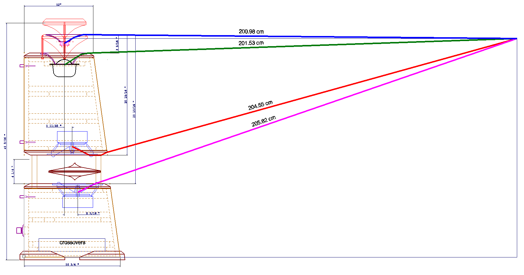

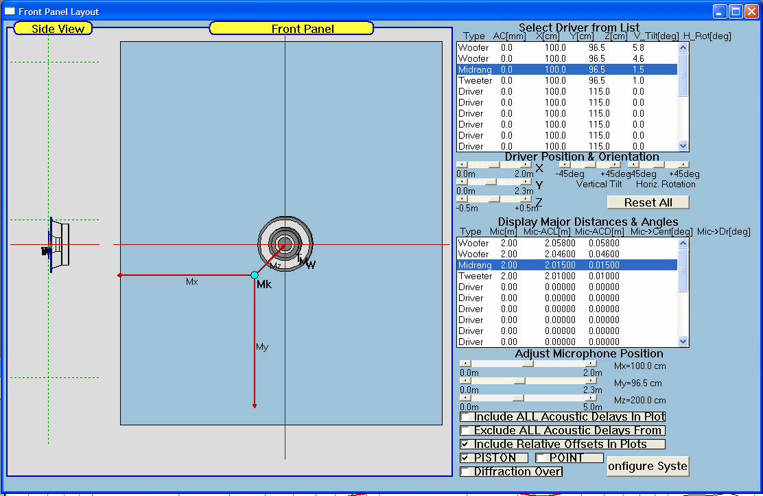

                                                                          I set the speaker on the floor. Set the mic up at 2 meters, 38" high. All measurements were taken at that point. Woofer impedance was measured with one woofer. FR measurements were taken with both woofer on, but set 6db below the mid and tweeter when imported, so that when two drivers were added in SE, they would sum properly. This is the method John K. suggested when I did the first omni MTM project. Then I set up the "Front Panel Layout" for the speaker in SE, where the vertical heights and offsets between the drivers was input and acoustic distances is calculated byt eh software. Again, this was as John had recommended before. It is my understanding that this accounts for the different acoustic distances between the drivers and the mic. I wonder if there is a problem with my setup here however. One thing that occurs to me is that I entered each woofer individually in the front panel and each has a different offset. Yet, each uses the same measured response. It would seem to make more sense in this case, to measure each woofers output separately and then the front panel adjustment would make more sense. What do you think?
                                                                          Also, I set the horizontal offset in the drivers positions. For example the mid and tweeter are at 0", the top woofer is at -3.9cm (closer than the mid/tweet) and the bottom woofer is at -5.8mm. The bottom woofer is at a height of 33.2cm, the top woofer, 45.9cm. the mid at 93.6cm, the tweeter at 99.1cm and the mic at 96.5cm. I used the location of the baffle each speaker is mounted on to enter these heights. On other approach might be to use the approximate voice coil height of each driver, rather than it's baffle. The heights were input in the Y column and the offsets in the Z column. The Acoustic Offset column was left at 0 for all drivers. SE does not recognize up or downfiring drivers, so I don't see any way to ue the acoustic offset column, unless I use acoustic offset instead of Z location to input the relative offsets of the drivers. Any thoughts?
                                                                          My thinking is that first, the woofers either need to be measured indivually and locations input individually, or measured together, as I did, but entered position-wise at a common point, perhaps at a point centered between them vertically and horizontally. In this case, that would mean enter them both at an average height of 39.6cm and average offset of -4.6cm. I think I'll try this and see what it does to the phase of the woofers in my model.
                                                                          Another possibility would be to load the horizontal offset between the drivers as an acoustic center distance change, rather than a Z distance change.

                                                                            #127
                                                                            Originally posted by dlneubec
                                                                            Hi Brandon,
                                                                            Yep just like that. The usual layout is called C-bandpass because the filters are Cascaded. The T-bandpass was popularized by Bullock I think. Here is mine:
                                                                            Try removing R17 from the bandpass and try this layout. I don't want any resisitors in series with a mid or woofer just because of the wattage issue. This layout worked well for my problematic mid with low impedence. You'll have to rework the XO to get the desired FR again. I actually needed smaller components after that, don't know if that's normal but i suppose it has to do with the higher impedence. So it's economic layout also

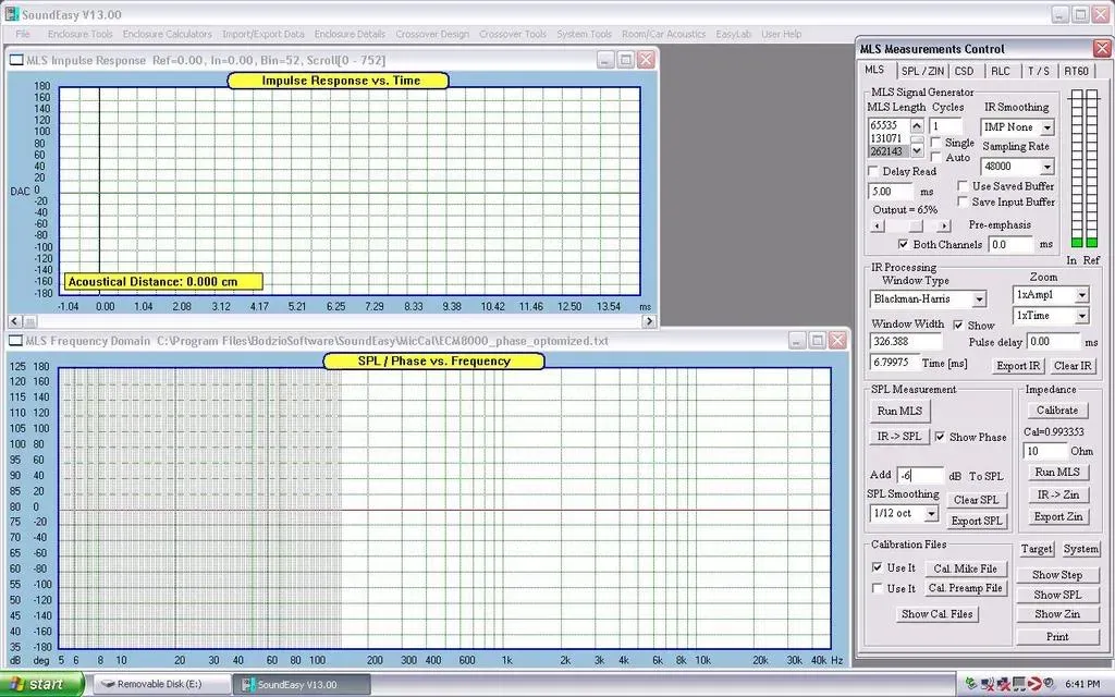

                                                                            That sounds like what I did. Under the SPL Measurement you entered -6 like this:
                                                                            ? Then saved the driver file? That's what I did. I noticed the HBT doesn't seem to save to the file unless you have the Driver Editor open to the HBT tab and have the responses graphed. Maybe this was why my responses didn't match? Here is the modeled vs the actual, purple is modeled, red is actual and is just a farfield measurement:
                                                                            It's close but not quite right. I modeled the XO for smooth offaxis response and surprisingly the match is closer around the XO:
                                                                            Pretty good other then the tilt caused by the woofers too low or the tweeter too high. Again I have to troubleshoot this. My center channel XO will be built this weekend so I'll see if that sheds some light on this. Otherwise I'm going to build a simple MTM just to measure and model with until my model matches the actual.
                                                                            I have the same concerns. I asked about this on the usergroup and got one reply that didn't answer anything. I may not have been clear about what I was asking though I guess. My concern was using the polar plots. If the difference in distances is already in the measured phase it seems to me that moving them around the baffle layout (for doing polar plots in my situation) could only introduce error. I don't have a good answer here. I've been working like a madman and haven't much chance to sit down and think this through. Besides all that I think you can tilt the driver in the baffle layout screen, perhaps this can do what you need?

                                                                                On the measurement side, another approach has occurred to me for my project that may be much more accurate in terms of phase correction. It occurred to me to take look at the plan and calculate the direct path that sound would have to take from the VC to the mic. Attached is plan of what I came up with in reviewing the CAD drawings.
                                                                                Since I calculated the actual acoustic distance from the plans, it seems to me that I should set the front panel up so that both X and Y values are the same for all drivers, but the differences between the calculated distances would be entered into the Z value for each driver.
                                                                                I figured that each driver had to be set a positive distance over the 2m mic position along the z axis to reflect the increased distance or offset. That mean +.98cm for the tweeter, the mid at +1.53, the top woofer at +4.6cm and the bottom woofer at +5.8cm. This should reflect the fact each driver is further away from the mic. The front panel layout I'm thinking of is attached. Does this approach make more sense?

                                                                                  Brandon asked about this project in another thread, so I thought I'd post an update.
                                                                                  I never was able to resolve the problems I was having with my simulated phase match as compared to the measured phase match after the crossover was mocked up. I took to swapping compononets in and out and measuring the changes and finally came up with a crossover that is pretty good. The phase match is good and the crossover points are at about 690 and 4000hz, pretty close to my goal.
                                                                                  Also, I took the prototype of the waveguide omni and played it in mono at the Indian DIY (back when the crossover was not as good and points were pushing the low 500's and about 3900hz). It recieved a good amount of praise, though it was a bit all over the map. Some thought it was amazing and others thought they heard some driver integration problems.
                                                                                  Unfortunately, the waveguide omni is just not as good as the original Mentor omni (to my ear). I think I may need to change the mid dome out and use a high efficiency pro mid, 6.5"-8" in size, with no waveguide. Also, I could stand to get better at 3way design, which might help as well. I have decided to put it aside for the time being to work on a more direct update of the Mentor omni project. I will probably start a thread on it soon. Here is a pic of what the waveguide omni looks like prior to the temporary shelving of the project. Also included are some graphs of the measured response of the last crossover build of the waveguide omni, 7ms gated window.
                                                                                  I hope to start making dust on the new project this weekend.

                                                                                    Thanks for the update- I saw the other thread and I wanted to ask how it's doing.
                                                                                    I'm sorry to hear it didn't pan out as well as we all hoped. It sure looks cool, though.
                                                                                    -Joe Carrow

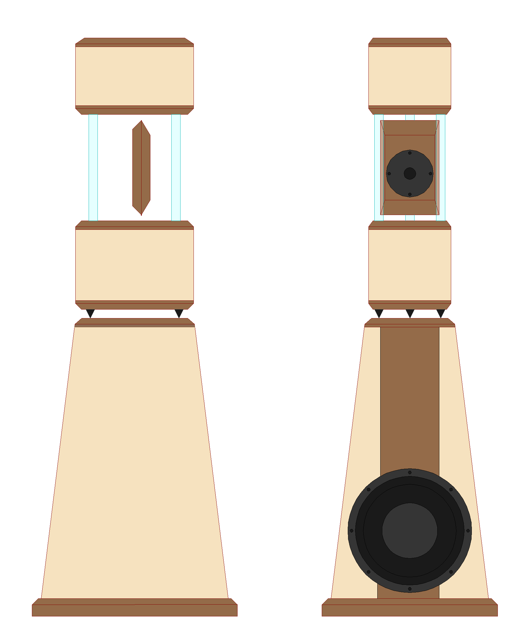

                                                                                      I've not given up on it. I'm just setting it aside until I have more experience under my belt to understand what I need to do to make it first class. :E
                                                                                      However, I'm excited about my new project. It's a partial omni, like the Mentors (my first omni project). It will have a powered sub (RSS265HF) in a 20:1 taper transmission line cabinet, F3 about 29hz, F10 about 19hz or so, in a cabinet about 31 liters. With room gain, that should be some serious low end output. I plan to cross it over up higher, around 180hz or so, to an MTM using the 2-RS150-4's in series, one up firing, one down and a forward firing RS28.
                                                                                      The cabinet size will be much smaller than the original and is intended to improve on a few things. My wife likes the look a lot more and the RS265 should make the bass both clean and strong.
                                                                                      I plan to start a new thread on this one soon. I'll probably start making MDF dust this weekend. I see a similar crossover to the Mentors, which used the RS180/RS28 combo, but crossing up at 1800hz. I'm hoping the 180hz and 1800hz crossovers, with steep slopes on the MTM will allow for some pretty good SPL's before any strain shows up.
                                                                                      Here is a teaser. More later!
