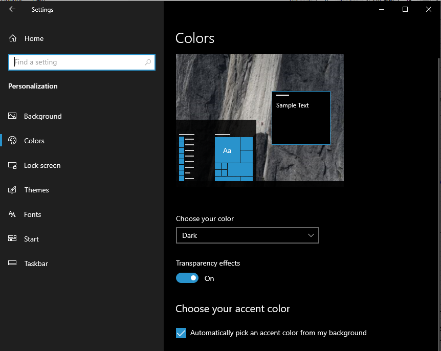

                      • Reet
                        • Dec 2007
                        • 524
                        Originally posted by kimmosto
                        Program supports high contrast themes with dark background. E.g. dark traces on default white background are system colors which turn automatically to light when background is dark enough.
                        Interesting, so I tested and see that black backgrounds do occur for "high contast" mode, but that mode is a bit extreme for normal use for me. What I am referring to is the "dark mode" setting in Windows shown here, which unfortunately does nothing in VituixCAD. I prefer this dark mode as more of a personal preference, while the high contrast mode is more geared towards accessibility features for people with vision problems.
                        Of course it doesn't have to be tied to the windows options. A manual selection in the options for background colour would be perfectly okay for me.

                          • kimmosto
                            • 589
                            Originally posted by Reet
                            "dark mode" setting in Windows shown here, which unfortunately does nothing in VituixCAD. I prefer this dark mode as more of a personal preference.
                            'Dark app mode' switch is quite new feature, and not widely supported in applications. Basically it's just a bit in Win32 registry for "legacy" platforms such as .NET Framework 4 of VituixCAD so (some) programmers are on their own. I've already done something simple: background of charts and XO schematic turn to dark and some colors change when 'Dark app mode' is switched on and program is restarted.

                                * Added simple support for 'Dark app mode'. Background of charts and XO schematic turn to dark when 'Dark app mode' is on and program is restarted.
                                • Reet
                                  • Dec 2007
                                  • 524
                                  Thanks! This is a good change for me, my only recommendation would be to also change the default "blue" trace colour to cyan or green for better visibility on the black background.
                                  https://discord.gg/h5SuNKDJfx
                                  • kimmosto
                                    • 589
                                    Dark app mode is just a mess. Few problems and colors fixed to revision 2.0.75.8 (2021-08-02).
