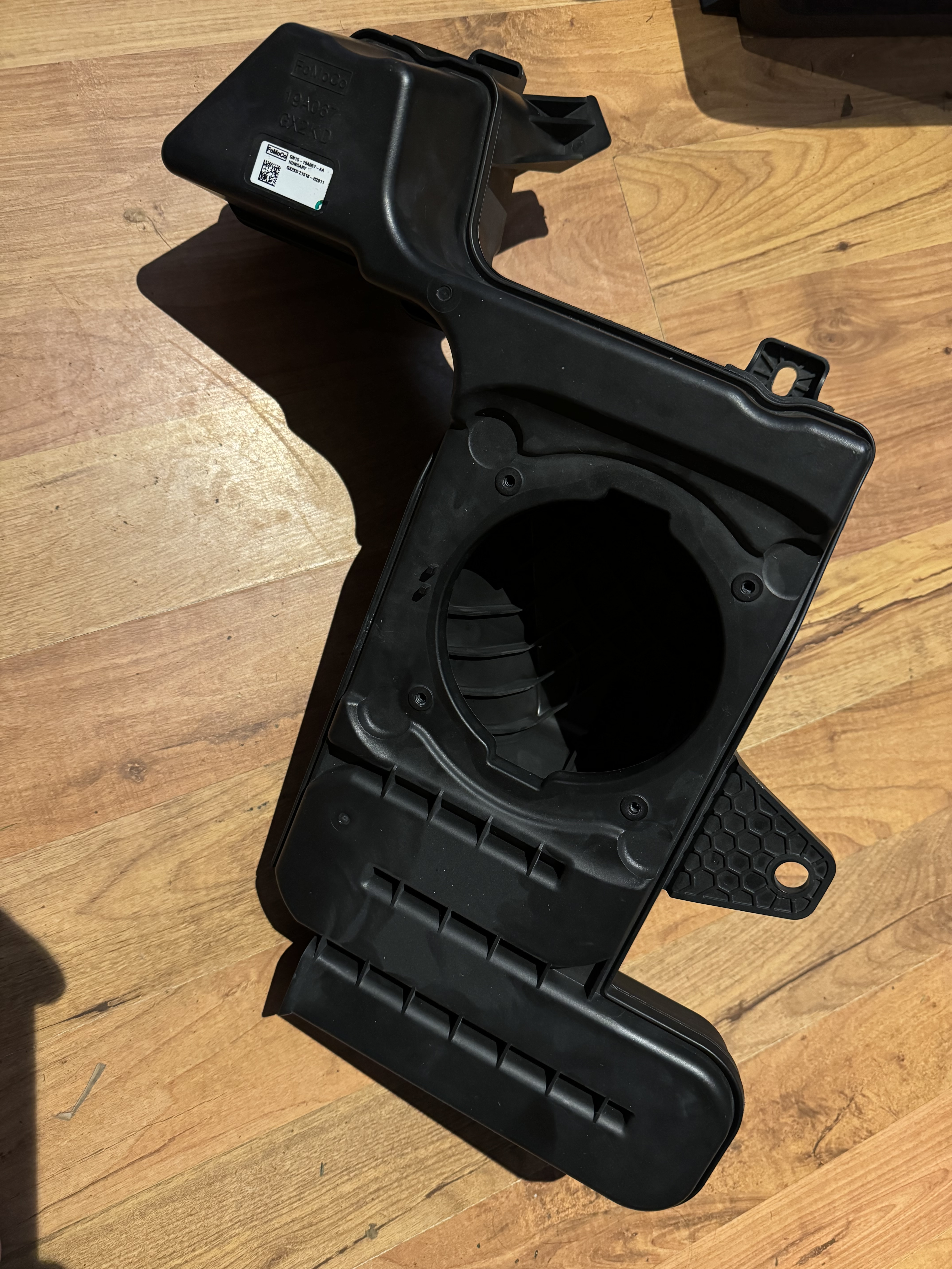

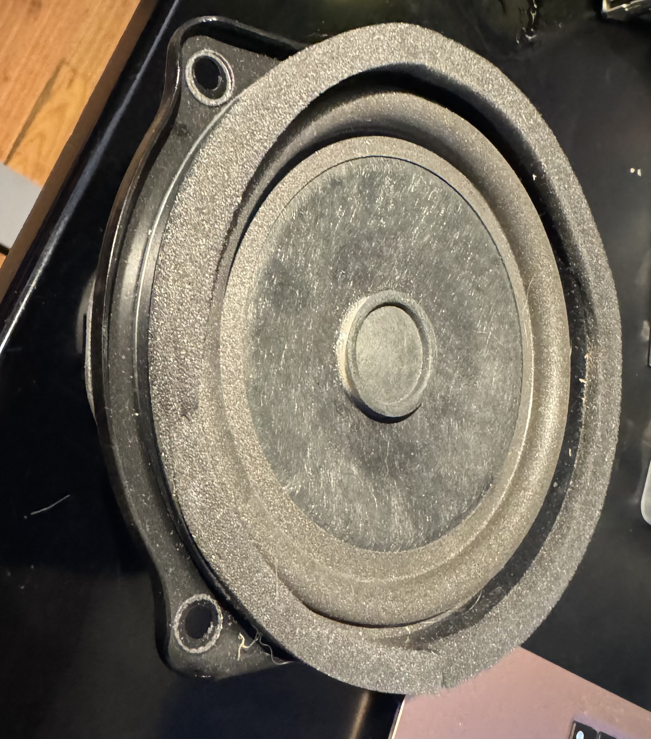

    So I'm trying to upgrade the sub in the stock location of our Ford Ecosport. It's got a little 5" "sub" in the back in a plastic box, and I've been contemplating maybe trying to put a Dayton Epique 5.5" in the stock enclosure. The volume should be about right, although the box is technically ported and I have no idea to what, or what the full volume is but the 5.5" Eipique has 14mm of xmax and would work nicely off the little amp I have and I know I could make it fit the box.
    The other idea I've had is to get a polycam license and try 3D scanning the location where it goes to see if maybe I could build an enclosure that fits there, and use the scan to calculate the volume and what not. I have the iPhone 15 Pro which has lidar and what not so I think it'll give me dimensions and so on. I'm not entirely sure, the stock sub is so pathetic the Epique 5.5" would definitely be an upgrade. I'll post a pic of the box and the stock driver.

    • 16128
    Finally it let me put in the other picture lol.

      Current enclosure looks ported. Guessing you would seal that off? Might be a weird pesky response otherwise.
      Could consider the Tang Band W5-1138SMF as a more affordable option. Pretty sure I have that in a small home sub that works pretty darn well.
        • 16128
        I mean the epique is only $100 bucks and like small enclosures both sealed and ported. And yeah it is ported I’m not sure if there is a way to figure out the tuning. Looking at the original driver it can’t be all that great lol.
        Maybe this weekend I’ll pull that panel back off and see what I can figure out. There’s not a ton of room but maybe I can make a baffle that fits and fiberglass the back part of the enclosure.
