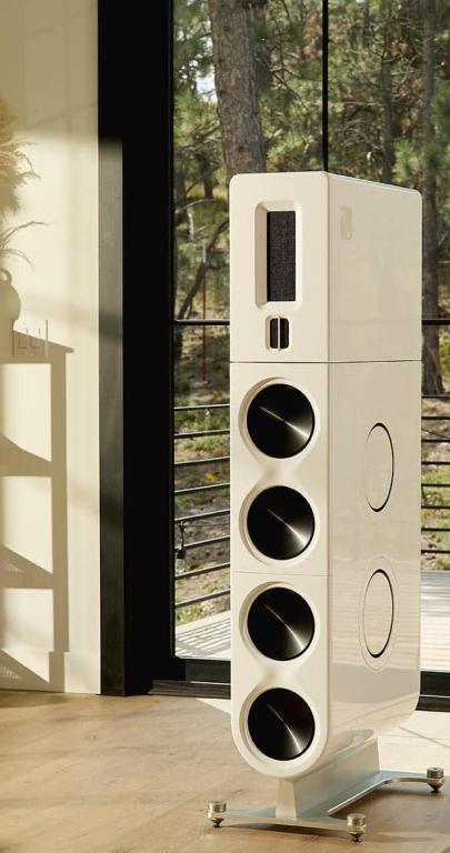

    To say that lately I haven't been following many things I usually pay attention too, like Boulder based audio manufacturers, is a major understatement. Fortunately I have stalwart friends like Steve Manning who will fill me in from time to time, just so I don't get completely lost from reality...
    What? Huh? PSAudio making a speaker? Really?
    Got to their web site to find out more about the FR30's. This video is about the installation visit for customer #2, in Missouri. I have lived in Missouri, when about 5 years old. Don't believe I ever met the gentleman receiving this pair of FR30s.

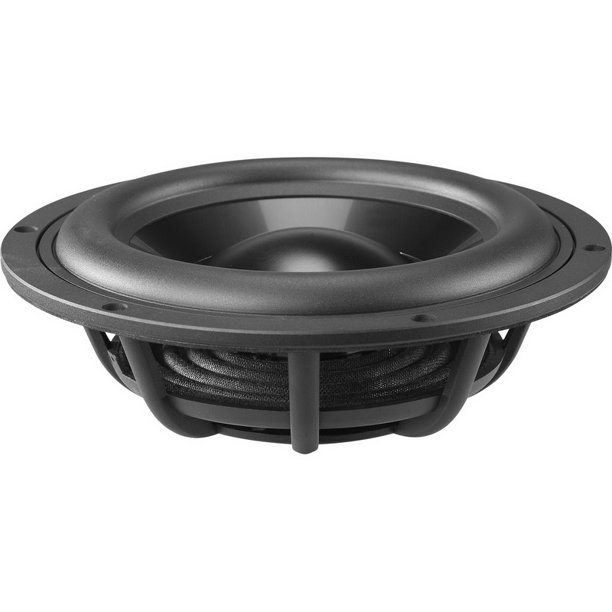

    It's a beautiful speaker. Those look like 8" versions of the woofers from the Kii3.
      • 16093
      Yup, that does look like the SBS is the right series, but new versions- the older ones look pretty conventional.
      Bit of a weird bird, if you look at the specs- relatively high Fs, about 9mm Xmax, very strange sensitivity and SPL response plot. Looks more like a sub driver.

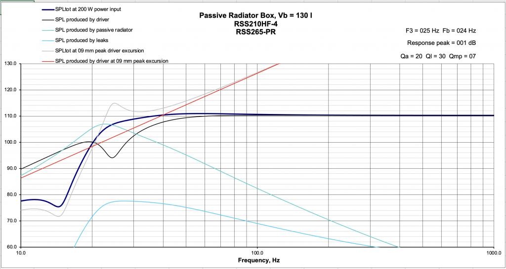

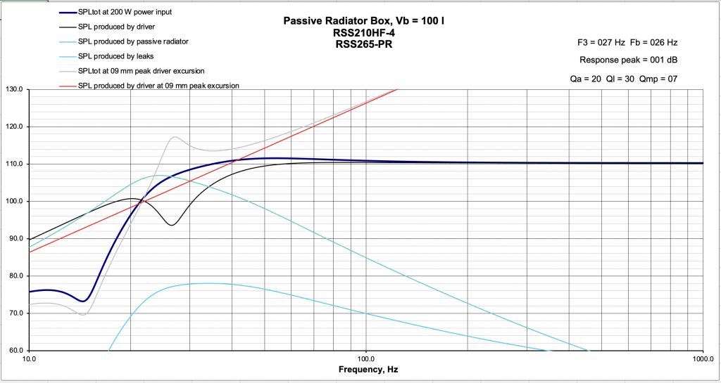

            OK, I had a pretty tiring moving day yesterday with the trailer, so I'm going to let myself have a tiny bit of fun this AM before doing more of the same today...
            I've been working on a new system design, which Steve's aware of, which is why he flagged the FR30 to me, because the LF configurations were basically identical- four 8" woofers and 4 10" passive radiators. The midrange and treble weren't remotely the same, but that's a story for another day. And I have a plan to change that... and drivers on the way or in hand. In fact, in poker terms, I plan to raise the stakes a bit.
            But among the LF configurations "tested" in Unibox, here's the deluxe one in about 130L of total volume... a little bit bigger than the Isiris cabinet volume. This might be considered the "perfectionist" version... best extension, flattest in the mid bass, etc. This graph is with 50W per driver, which pushes them to a max of 2/3 the rated Xmax. So, some headroom is left.
Name:	Screen Shot 2022-05-17 at 7.11.04 PM.jpg

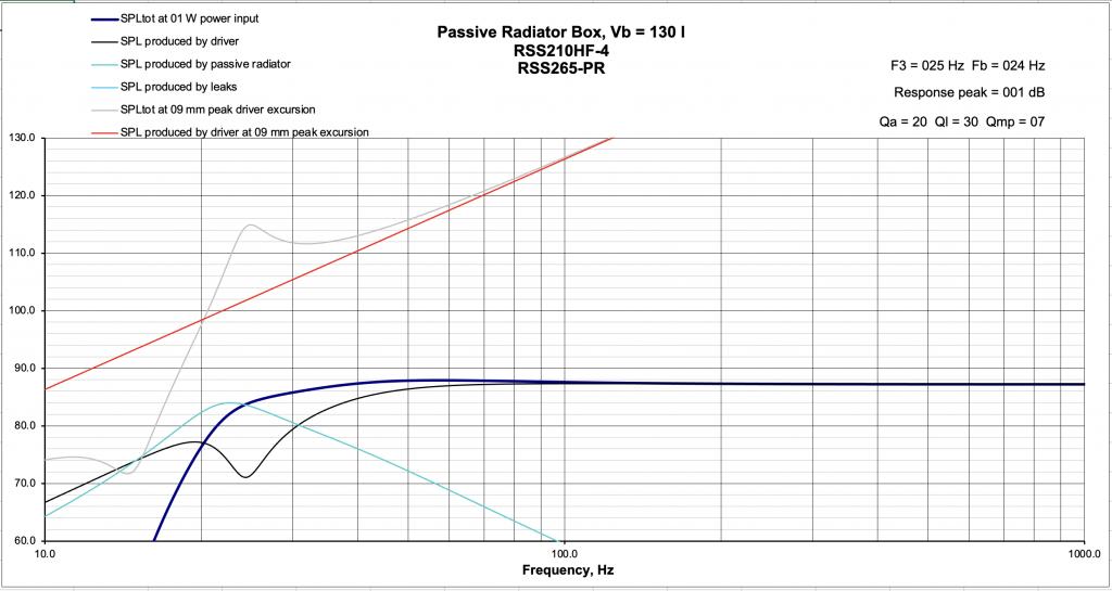

            And for reference, if we drop the power per driver to 1/4 watt, for a total of 1 watt on the bass system, we can see what I call the sensitivity curve.
Name:	Screen Shot 2022-05-17 at 9.06.28 PM.jpg
            It's pretty much right on target for my original planned value based on back of the napkin stuff, and coincidently, roughly matches the FR30.

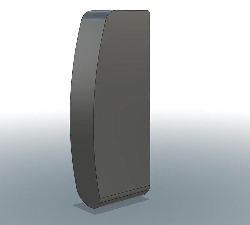

                  Since I like to see the bigger picture... Is there a cabinet drawing yet what this is going to look like?
                  Painter in training
                    • 16093
                    Steve and I are discussing that and kicking around concepts. This isn't going to be a small system, of course, given the low frequency driver array. And we figure drawing a certain amount of inspiration from the "Aspen FR30" is not a bad idea... (maybe I'll have to persuade Steve that we can make "Klone Audio" a wholly owned subsidiary of SMJ... )
                    :rofl:

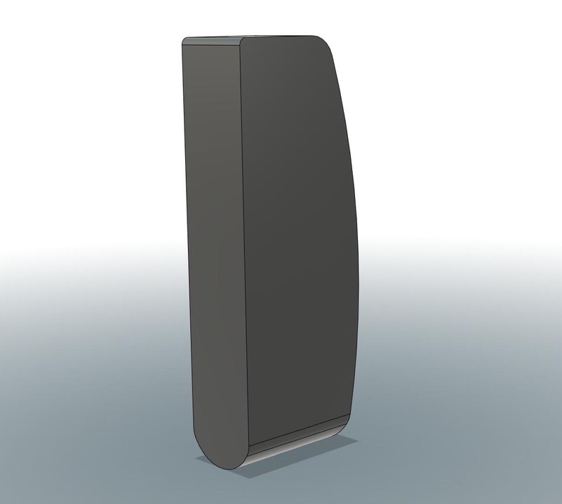

                    This is just a form factor concept that Steve came up with after our early discussions... no detail stuff like edge bevels or round overs, just the general form factor based on dimensional inputs from my earlier POC work on the LF section, plus what is needed for the midrange/treble cabinet.

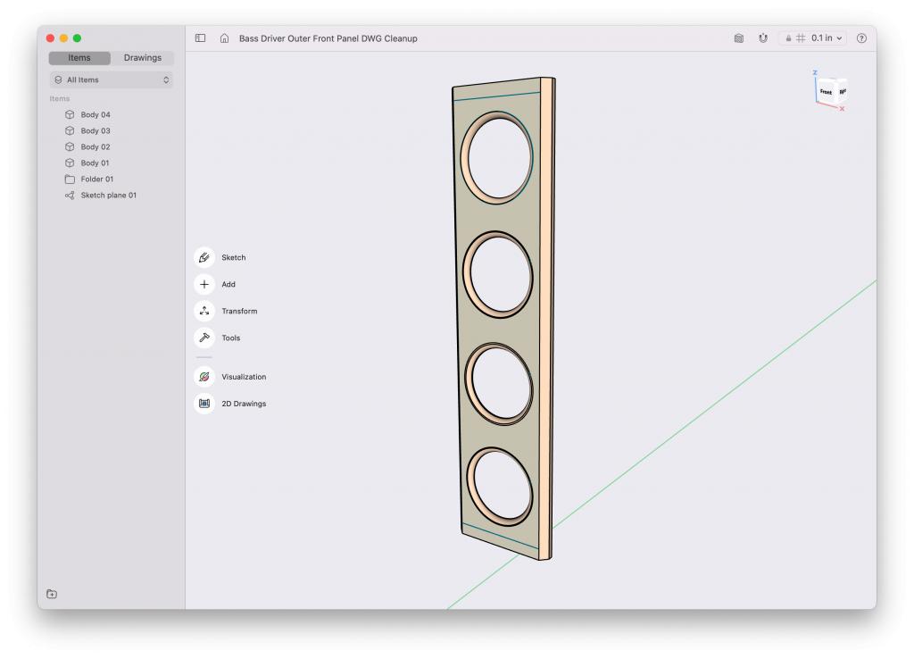

                    Front View
                    Rear View
                    And, duly note that evaluating an upper end module with planar and ribbon drivers, means it will also have to compete with the better more conventional solutions- such as PuriFi, BlieSMa, Satori, and Eighteen Sound 6ND430, all of which are "on hand". The "conventional solution tweeter I've been favoring in the earlier stages of this project is the BlieSMa T25A. The B is nice, but I'm not convinced it offers a 2X value proposition to justify nearly 2x the price, given what can be done with the "classic" notch filter for the fairly high frequency breakup mode of the T34A. And the A version, like the A version of the T34, seems to have better extreme off axis response. But, never say never...

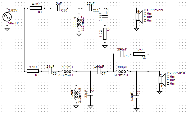

                      POC Planar crossover
                      well, instead of watching silly videos online during lunch, I thought maybe I should continue investigations- something like, a Proof Of Concept crossover for the possible planar parts, given that FRD files at 15 degree increments out to 45 degrees were available. This is not for the ribbon, but uses the same crossover frequency and filter type as the ribbon would use... of course, a variety of data issues will require updates, but, this is just POC for a nominal SPL...
                      For the system configuration I had in mind, it would be my usual self styled LR3 network for the midrange to woofer, proposing 450Hz, and an LR4 @ 2.8kHz between the midrange and tweeter, as the ribbon is designed for that crossover point and filter type. And the planar tweeter should be able to handle that, one hopes.
                      Its fairly straight forward, especially as there is no issue with Fs resonance to compensate with a shunt network.
                      Schematic
Name:	SS Planar MT XO-schema-1.png

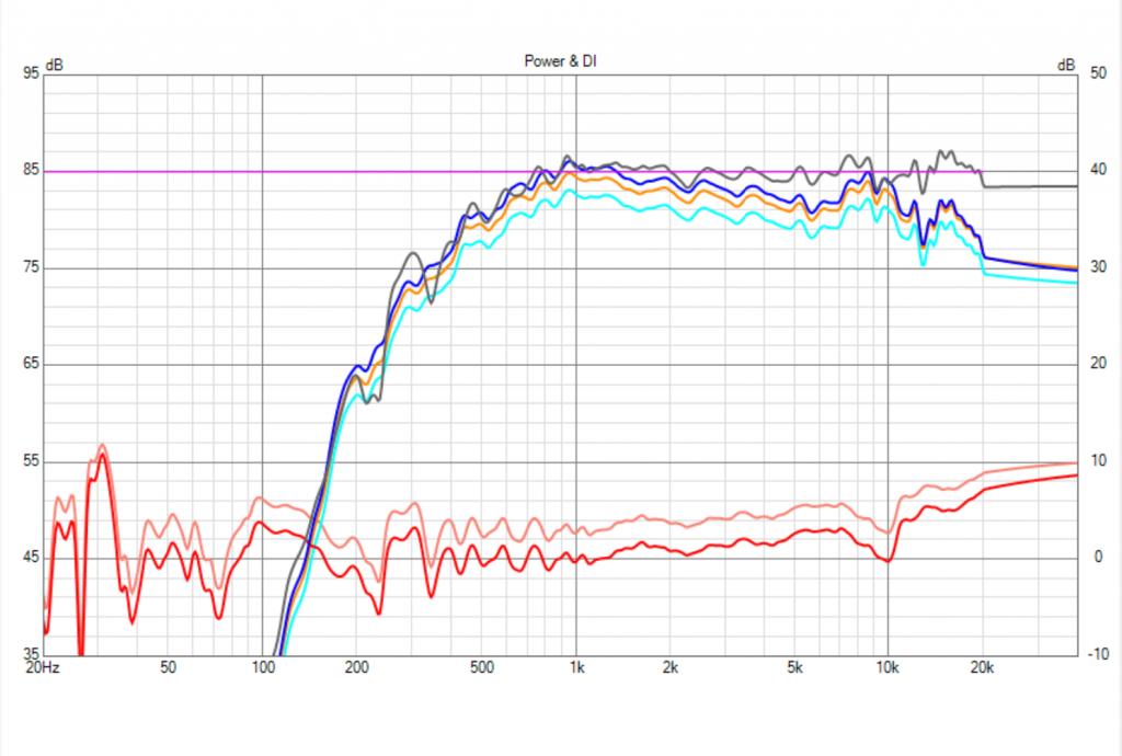

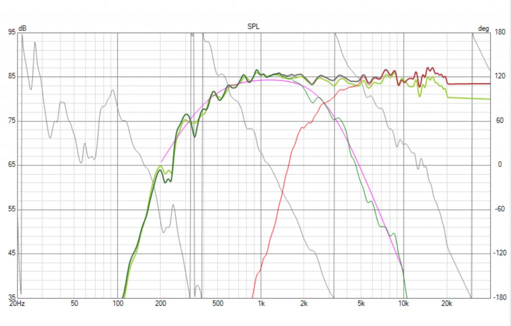

                      SPL graph with mid target
Name:	Planar SPL graph.jpg
                      Not shown, the null was very deep and symmetric.
                      Power and Directivity
Name:	Planar Power-DI graph.jpg

                        A while ago I saw a video on these with the main designer. He was talking about the drivers they were designing. As usual there was a large dose of audiophool marketing gumph that make your eyes roll but, one thing is for certain, the drivers are not basic Tymphany stuff like the Kii uses. They looked pretty advanced from what I remember.
                          • 1678
                          They are sub drivers

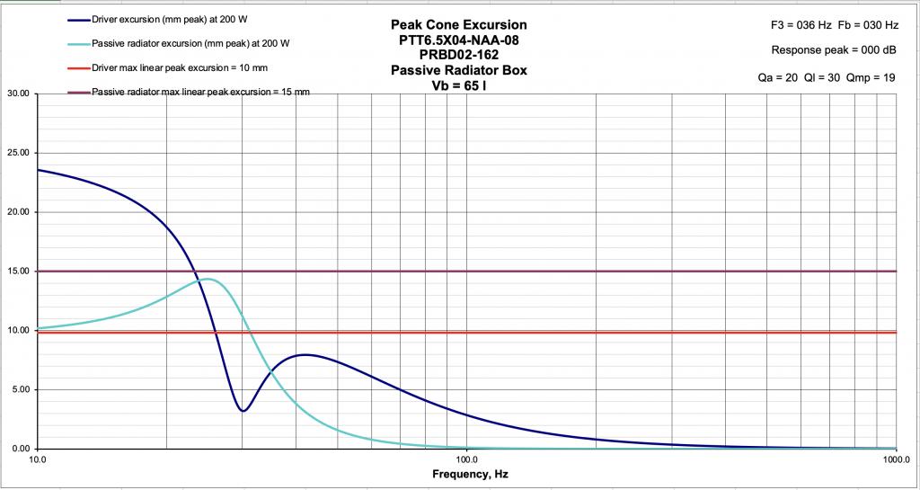

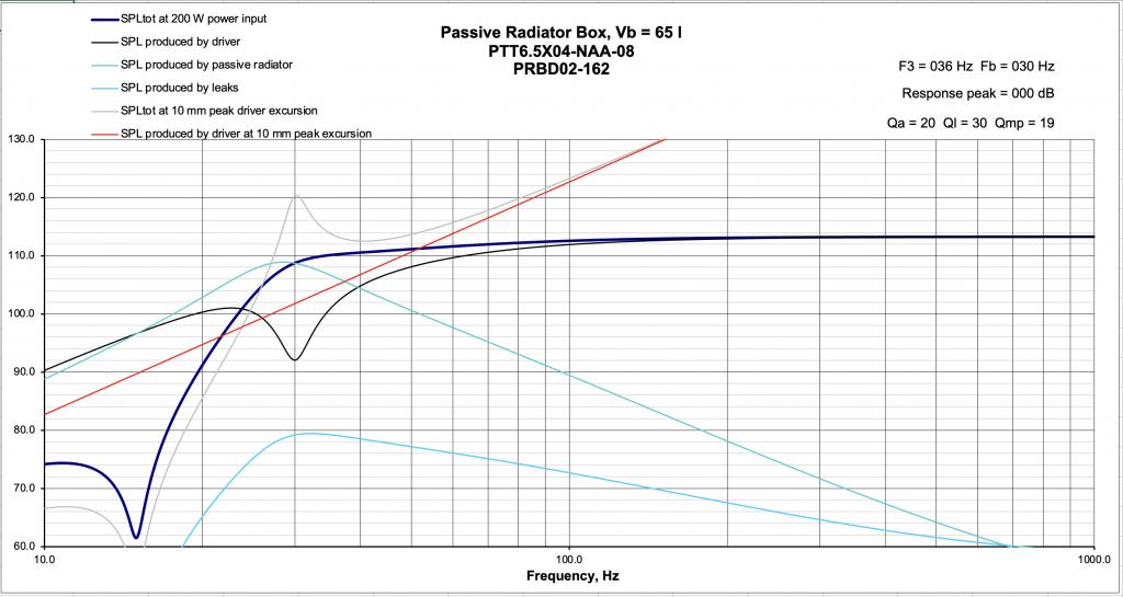

                              OK, just for fun, let's stir the pot a bit...
                              We have some new requirements... cut the LF enclosure volume in half. And since that's not going to be easy, don't worry too much about driver cost. Let's just see what we can do performance wise. The system I was originally working on with 4 8" woofers and 4 10" PRs was working on the concept of optimum performance relative to driver cost. Enclosure size was not a controlled parameter, except for the purpose of hitting performance goals.
                              Now it is.

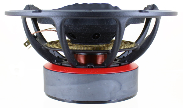

                              I tried a few other combinations of woofers and drivers, but kept coming back to the concept for the new Modula PWB. Which is just a relatively small two way...
Name:	PTT6.5X04 Excursion.jpg
                              The high performance, but rather pricey, duo.
                              For curious minds that would like to know, that's about $1650 of woofers per cabinet, and $680 of passive radiators. Hmm, $2,330 per cabinet.
                              For reference, 4 RS210HF-4 comes to a bit under $600, and 4 RSS265-PR to about $450.

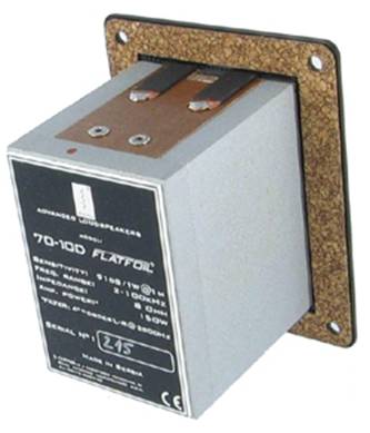

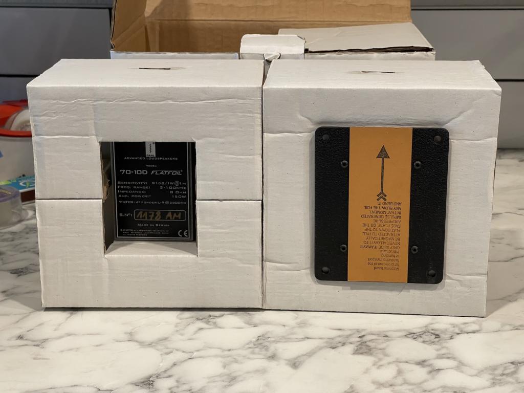

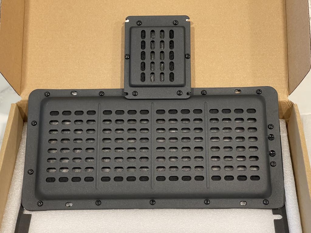

                                  A couple of members have PM'd me about whether I've measured the 70-10D, or if I even had them yet!
                                  (you know what they say about the internet- if there aren't pictures or video, it's not real...) (and even then, you have to be careful!). :rofl:
                                  Well, like all RAAL ribbons, these babies are a bit delicate physically, and require some care in handling- note the magnetic protection strip which AFTER installing in the cabinet, one gently slips off the side- NOT peeling up direct from the front plate!

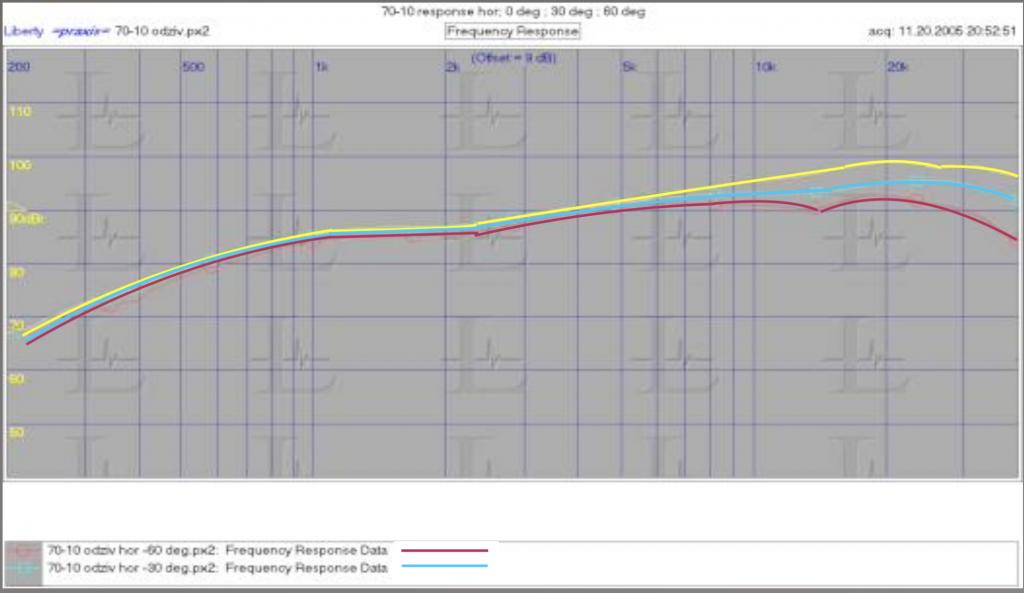

                                  I have measured and verified the factory spec for the impedance curve, but I haven't done any acoustic measurements yet. In fact, I plan to have a basic test crossover in front of these at all times to protect from low frequency overload.
                                  The built in transformer for the 70-10D is intended to be the final shunt indictor in an LR4 network, targeting 2.8kHz, so the actual electrical network is 3rd order. RAAL has a recommended range of values, but of course recommends to test in the application and adjust as needed. But is a flat LR4 going to do the trick? Both the published data (which is hard to read) and 3rd party measurements confirm the rising on axis response.
                                  Let's take a look at that- I've created an "Augmented" graph by adjusting the background shade a bit and tracing over the fairly illegible original curves at 0 degrees, 30 degrees, and 60 degrees.
Name:	RAAL_70-10D Horizontal SPL.jpg
                                  So, what is the "smart" thing to do with the network? I'm sure there are lots of opinions about that...
                                  My opinions that a detailed analysis (by measurement) will show the weight of the power response in the 15-40 degree off axis response, and being a few dB hot above 10kHz directly on axis isn't likely to be a deal breaker. For those of you for whom that IS the case, well, you know who you are. I have very good measured hearing for someone my age, but I'm not sweating it. Maybe my wife will...
                                  Given these points, my simple strategy will be to use an RC shunt network to tweak the impedance and divert some power from the primary of the transformer.
                                  I'll setup the initial test network first with the ability to switch the shunt network in and out. It will look something like this...

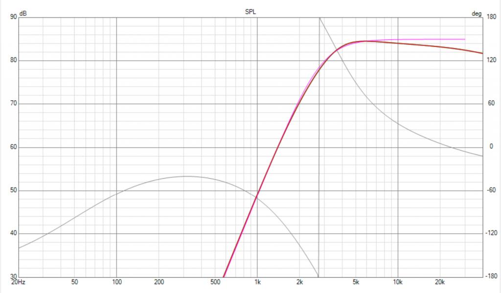

Name:	70-10D Test circuit XO-schema-1.png
                                  Here is VituixCAD's simulation of that, compared with the target 2.8kHz LR4 response. What I expect I'll want to do is pull the 30 degree curve down from what's in the spec sheet to being flat. This shows a possible attenuation curve for the network.
Name:	70-10D Test Circuit RC switched in.jpg

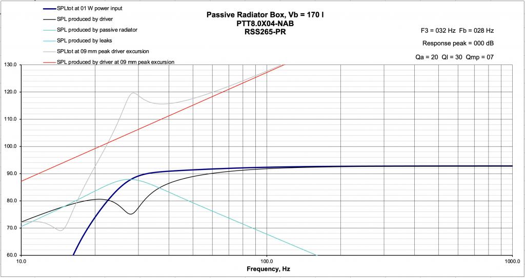

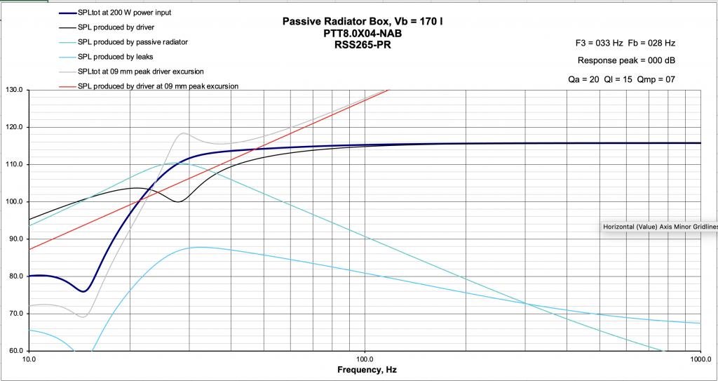

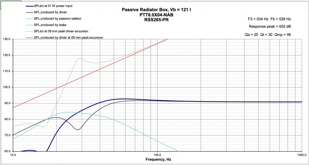

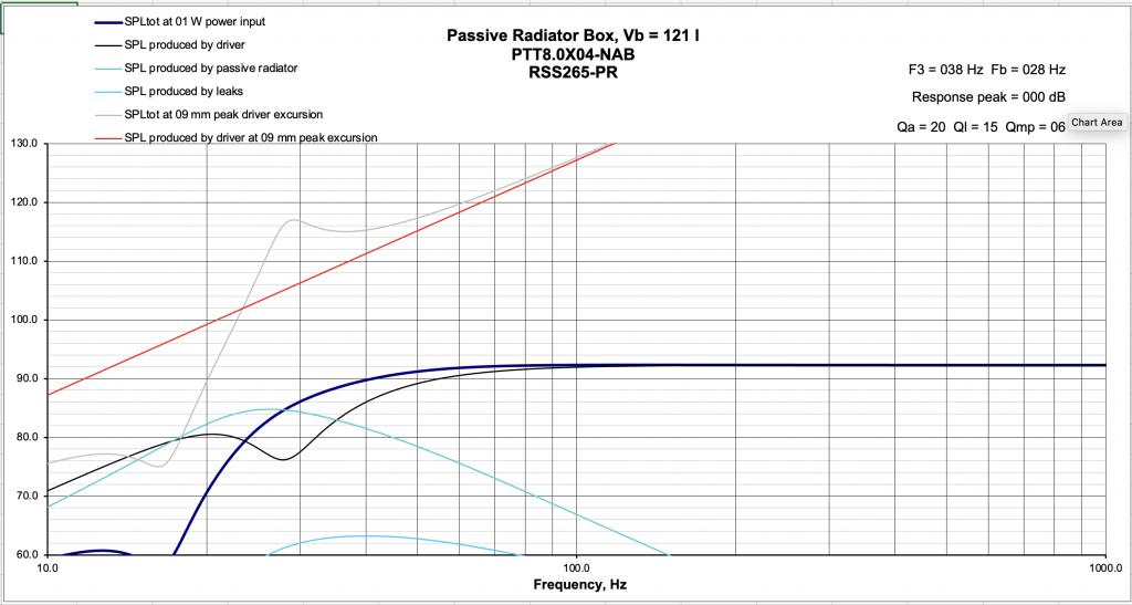

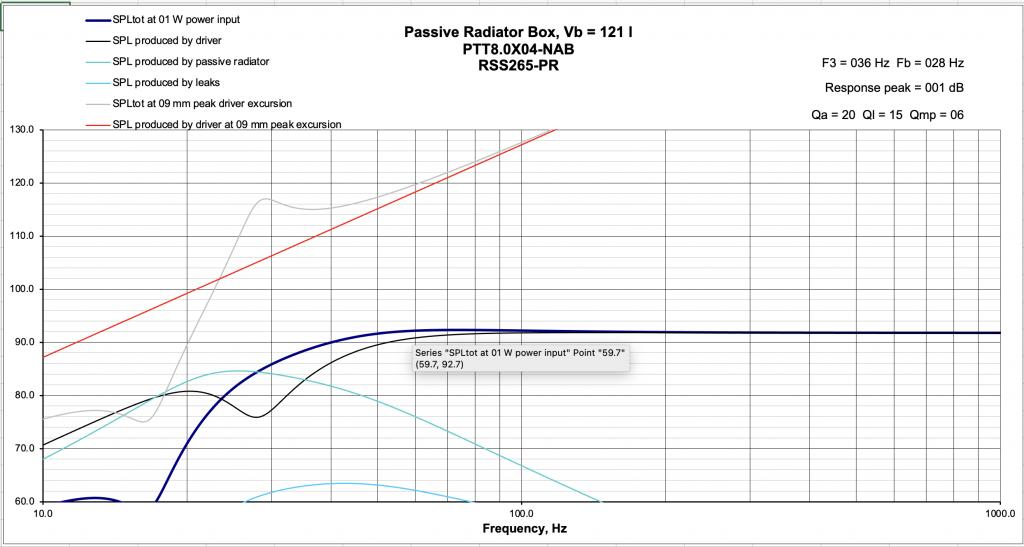

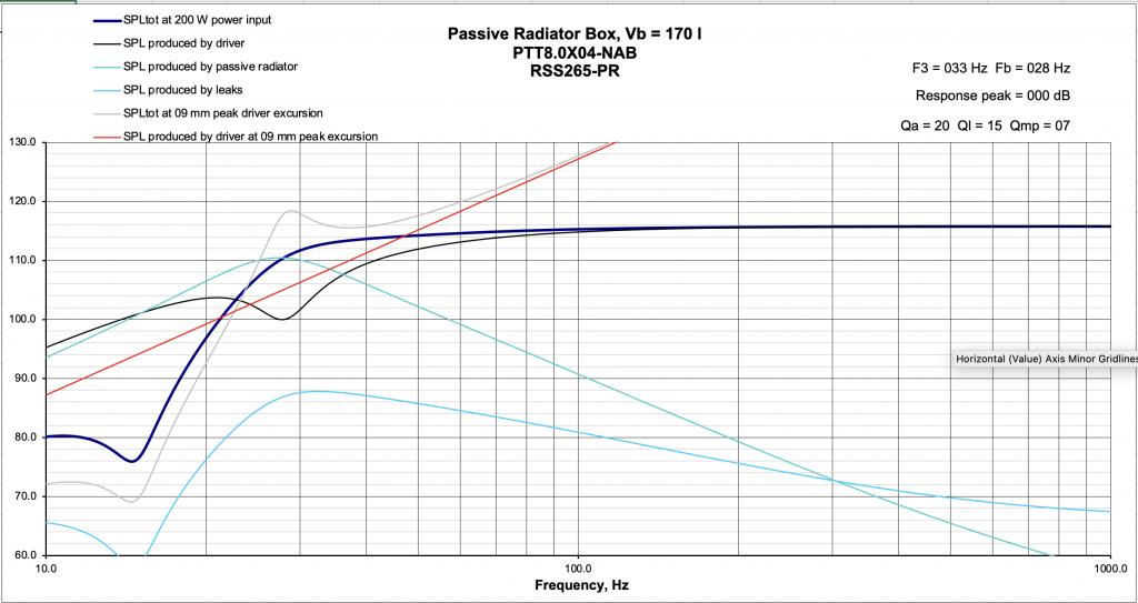

                                        PuriFi has shown their new 8" woofer, the PTT8.0X04-NAB-01 at the Munich High End show- and details are previewed on their web site.
                                        Naturally, this led to some curiosity about how the parameters work out and possible applications. A review of specifications and some enclosure calculations for this application seems to indicate they've taken a different tack with this driver- high compliance, relatively low cone mass for the size, and a baseline sensitivity of 90dB even with 9.3 mm Xmax. One might say it travels farther into the long throw woofer zone than the subwoofer zone, as compared with the 6.5" drivers, which are known to work well in rather small enclosures, as regards low frequency extension.
                                        Pursuing a similar alignment quality for 4 of these drivers as the previous examples, some notable differences emerge:
                                        • To achieve an Fb in the range of the free air Fs, a significaintly larger enlcosure seems necessary- 170L ended up meeting the mark.
                                        • Due to the interaction of driver parameters, to achieve a simlar target curve required doubling the nubmer of passive radiators. 350g total MMS still worked well, though a range of MMS and enclosure volumes were examined.
                                        • This is a higher sensitvity driver, and per Hoffman's iron law, to achieve a given cutoff requires a larger box- but with double the number of PRs, it's possible to get about 6 dB more output at 200W total power at the low frequency range.
                                        1 Watt total drive power
Name:	PTT8.0 SS265PR 1W 170L.jpg
                                        200W total drive power
Name:	PTT8.0 RSS265PR 200W 170L.jpg
                                        At this time I don't know what the asking price for these drivers will be- but with the need to double the number of passive radiators, and increase the enclosure size by close to 50%, the cost impact would likely be considerable.
                                        Interesting to ponder, but probably not very practical.

                                            I did foresee one fairly obvious problem the new owner will have: those cabinets are SHINY and TALL, and even though they are black - light is going to reflect right off of the "inside" panels when watching video. Significantly. ops:
                                            A design issue I had (just looking at it) was *diffraction. 8O
                                            Anyway, cool thread and build! :T
                                            *speaking of diffraction the Q Acoustics Concept 500's modest semi-round-over might work well with the overall aesthetic??? (..particularly looking at the transition on the top of the Q Acoustics cabinet as it might relate to the round-over bottom of the PS Audio.)
                                            ..you can actually see the round-over a little better in this video:
                                            https://youtu.be/P27rz-6rL4I?t=305
                                            Good comments, Scott-
                                            • Even with a high gain screen designed to minmimize the off axis scatter like the Black Diamond I have in storage to install in the new place, you still might have issues. Of course, a big sheet of thin black felt and some double sticky tape could solve most of that, but I imagine the new owner would be loathe to "modify" his new babies that way...
                                            • Yes, I've read about backwave issues and different techniques with the planar midranges; we'll see if the ideas I have work out or not (tapered transmission line with heavy felt, and stuffed with long fiber wool)
                                            • Oh yeah, I'd expect considerable diffraction issues with the cabints as built... but I'm also wondering how the bevels at the tweeter and midrange are impacting that or the overall behavior. With bits I have, I can duplicate what they have done, or implement some variations on the theme; a good idea they had was removable surface front panels. A number of topics to explore and address.
                                            • I agree, the Q Acoustics 500 is a well executed system and do a nice job with the edge round overs. I'm inclined to think that is mandatory... and I have bits for that, too! Steve is the king of CNC, but I'm the prince of doing it the old fashioned way...

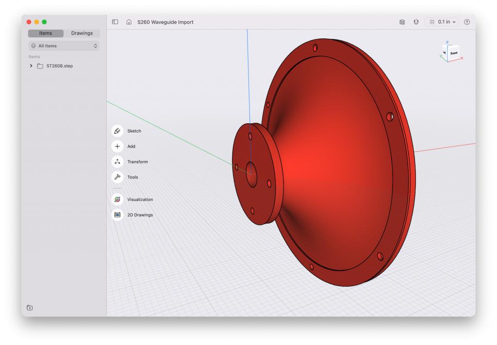

                                              Exploring some cabinet design issues with Shapr3D
                                              Busy weekend working on the domestic stuff, BUT, I managed to squeak in a few hours on the M1 Mac Mini exploring some design possibilities for a "Klone Audio" concept build.
                                              But, first a little introduction about 3D CAD stuff I've used, and am currently using.
                                              Now, I'm generally a low budget queen (or king) when it comes to 3D CAD for speaker stuff, and have generally gotten good results with what I call a "family" of products that share a common heritage with the now departed firm "Concepts Unlimited". In fact, I have TurboCAD Pro on this computer, and have copies of Shark as well as ViaCAD (from Punch software) installed on other Macs. All of these have pretty decent modeling tools that I'm very familiar with; Shark is basically an upmarket version of ViaCAD, or vice versa, and they differ in things like rendering tools and some of the fancier file exchange capabilities. Of course, they differ in price too, with Shark being about 10x more expensive.
                                              I have also used Fusion360, especially for the Kurosawa Dai Katanna project; Steve Manning lives and dies by Fusion360, especially for the manufacturing file interface. their prices (yearly subscription) have gone up quite a bit (doubled for hobbyist), and with so many other financial must do's the last two years, I have let the Fusion subscription lapse. Possibly not a wise move, but I can always go back if I feel compelled to...
                                              Well, I have a sort of recent "benchmark" case come up- the ability to import a seemingly simple but actually complex STEP file. This is importing some of the STEP files generated in Fusion 360 by Marcel Batik, who does some very sophisticated yet elegantly simple work with waveguide/horn design.
                                              The ST260 is one of the earlier designs, along with the baffle mount version, ST260/B. It's a nice design for 1" drivers, and Marcel makes the data files and STEP files freely available.

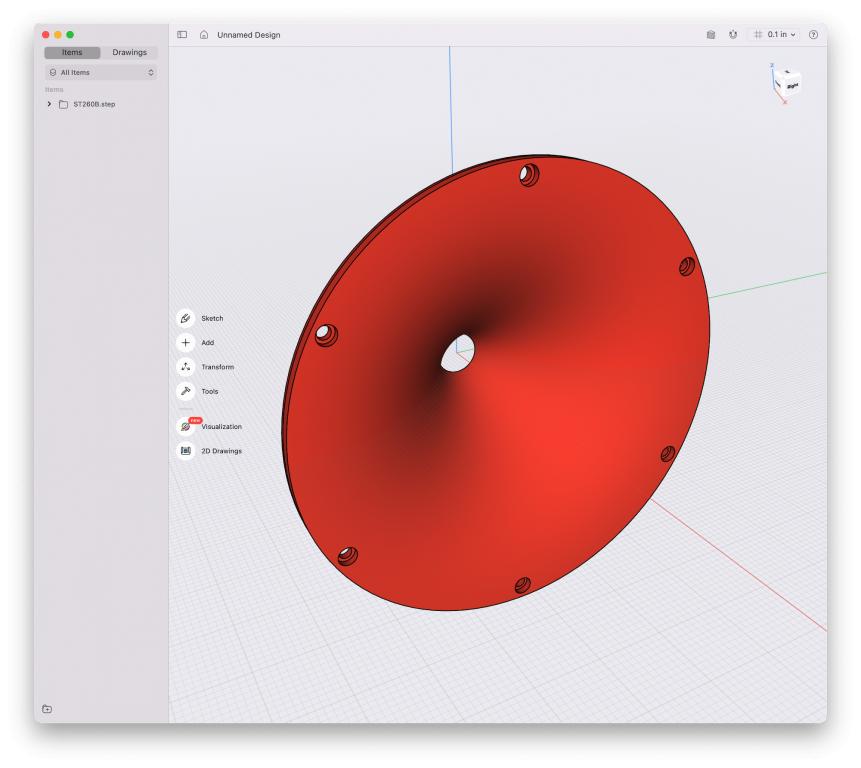

                                              Now, this file imports fine into Fusion360, and my copy of Shark on the iMac Pro can handle it, too. But every other relatively "budget" 3D CAD program just locks up and crashes. I think, probably too many data elements for how their code is designed.
                                              Enter, stage left, Shapr3D.
                                              This is something of a maverick program, developed by a small (but growing!) firm in Hungary- originally just for the iPad Pro. And to do this, and have a solid core, though the started out with a different (I.E., more affordable) 3D kernel, they ported the Siemens Parasolid kernel to ARM. Yes, the same kernel at the core of many top flight CAD programs like SolidWorks.
                                              They expanded this offering to M1 Macs shortly after their introduction (ARM based). Intel Macs can run it because of how Rosetta 2 works. And now it's out on Windows, also, though not quite with the full feature set- there's a LOT of very useful API's in MacOS that just don't exist on the Windows side of things, so they're working on writing their own code for Windows.
                                              Recently they restructured their sales tier- previously there was free with limited capabilities, hobbyist with more capabilities but missing some things like the higher end file export capabilities and 2D drawings, but at a pretty reasonable yearly pricing, and Pro with the whole enchilada.
                                              Well, they took the Hobbyist version and put in all the pro features, kept the price the same, but limited the license to running on just one computer. If you want to have two computers (at home or elsewhere) running it, you need to pay the low subscription rate for each computer. Then they have a multi-user license intended for commercial. My paid hobbyist license was automatically updated to all the big boy features, but if I want to install on my recent model Mac Pro, I need another license. Fairly reasonable, I think.
                                              Well, anyway, about the first thing I did with the Shapr3D demo, before I signed up for any plan, before trying any design construction, was importing one of Marcel's STEP files.
Name:	S260 Front.jpg
                                              Voila! OK, this got my attention.
                                              So, spending some time on learning the software seemed like a reasonable use of time.
                                              But think about this... the folks at Shapr3D completely rethought the 3D CAD process and interface- they had to, starting out with the iPad Pro and an Apple Pencil. They came up with a lot of clever stuff and innovations, like the adaptive menu system, for example, that just shows the commands and options available during any particular stage of work- this is a lot different from traditional 3D programs, so if you've grown up with them since the earliest days of AutoCAD (raise my hand...) this means there are a lot of mental habits and strategies to relearn. And that isn't necessarily easy. But it just may be worthwhile... juries out, but the case is developing in interesting ways.

                                                Concept options and constraints for the bass module cabinet.
                                                What I've been thinking about in spare moments lately is the options and possibilities AND constraints for the two piece cabinet design- particularly with my favorite materials, LBL boards and maple ply pin blocks from Vanda King.
                                                Another constraint that may have to be addressed is where to put the PR's... so many folks put them on the cabinet sides, sometimes even the front panels. I have this hang up where I find PR's on the sides kind of objectionable esthetically, and also, a possible issue when trying to move a heavy cabinet. Never say never, but for now I wanted to try to stay with PR's on the back.
                                                So, let's enumerate my view of the material constraints. YMMV, of course.
                                                LBL is easiest for me to source from Woodworkers Source, 12" wide boards 48" long, 3/4" thick, nice grain appearance, made from trips 3/4" wide. LBL ply is getting VERY difficult to source lately- at least where I live now (Idaho).
                                                My favorite other material is maple ply, easiest to source as piano pin blocks. My favorite is the 563D, 59" long, 22" wide, and 1-1/4 thick. This was used in the Kurosawa build and for my Ardent D build. I really like it for front panels, and rear panels if you need to put in drivers or PR's.
                                                The stuff is expensive, though, so using it efficiently is mandatory.
                                                A quick back of the napkin calculation (I find paper towels hard to write on...) suggests that considering making front and rear panels in a "relatively" cost effective way suggests making the width of the overall system modules the same as the venerable Wavecor Ardent- 11-1/2". Then, for example, a 11-1/2" front panel and a 10" rear panel or inner front panel can be ripped from one 22" wide maple ply board. This is assuming the inner front panel and the rear panel are surrounded by LBL on the sides (with an underlayment of BB ply), and maple ply top and bottom.
                                                Now, the use of PR's on the back is another constraint- this winds up dictating the minimum center to center spacing for the PRs and might as well do the 8" woofers the same way- my intention (if I proceed) is to put each pair wired in series in it's own sealed space with the corresponding PR's. The RSS265PR's are 10-1/2" in diameter, so I figured round it up to 11" for the CTC spacing.
                                                For the RSS210HF-4, the provisional 8" woofer selection (still looking, haven't found anything better yet that fits my selection criteria) we're looking at an almost 8-1/2" frame diameter (close to the SW223BD02, but a Dayton based Ardent with, say, a 5" SB ceramic/aluminum midrange is a topic for another day...), so the rebate diameter chosen was 8.5", with a pass through cutout diameter of 7.3" (will clear the 185mm requirement by a few hundreds of an inch...)

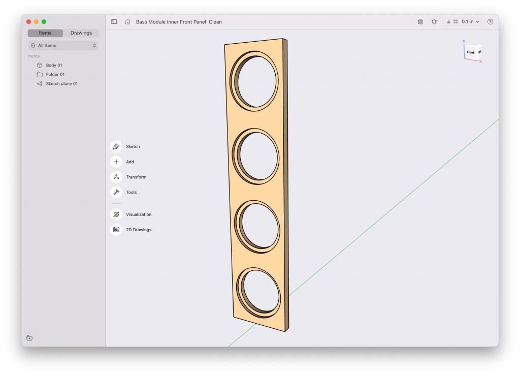

                                                Sketching out both top front panel and inner front panel resulted in a proposed 44" long panel for the "inner" front panel, and 46.5" for the "outer" front panel, which I envision (possibly) being bolted on to threaded inserts in the inner panel in multiple obvious locations.
Name:	Inner front panel.jpg

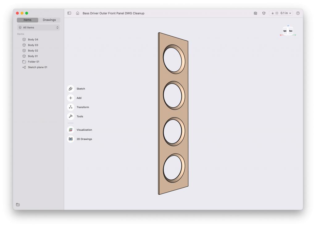

                                                The "outer" front panel concept drawing turned out like this:
Name:	Outer Panel Front clean.jpg
                                                And rear view:
Name:	Outer front panel rear.jpg

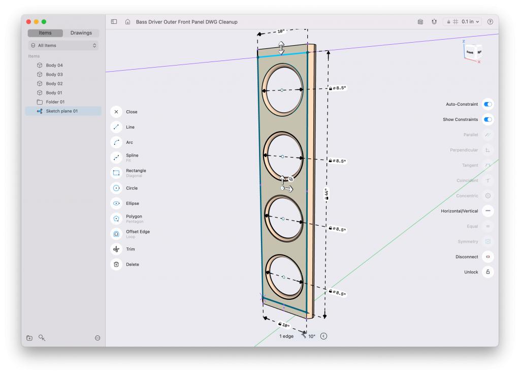

                                                Now, a few teasers about how different working with Shapr3D is.
                                                • Unlike other 3D programs, there are no layers. I'm used to putting construction guides and notes on a seperate construction layer. For Shapr3D, the construction lines are integral to the intial drawing and how it interacts. They can be deleted; these are somewhat "cleaned up" versions.
                                                • A lot of data on key items is intrinsic and available to veiew easily- for examle, here I've clicked on one of the initial linear dimensions, and most of the key dimensions are displayed; then hidden when you click in a blank area. The outer panel drawing was created from a version of the inner panel drawing as a starting point.
                                                • Due to the iPad heritage, direct editing of parameters is widely supposed by the datapad that appears in relation to any selected item. But full parametric design is also supported, and the full design history is maintained.
                                                • I decided to create duplicate versions of designs to use one as a revision step backup, so I wouldn't have to "undo" so many commands manually to get back to the same point. Different tools, different strategies.
Name:	Outer Panel Front with Details.jpg
                                                Is this the way to proceed with a potential build? I don't know, but it gives me things to think about.

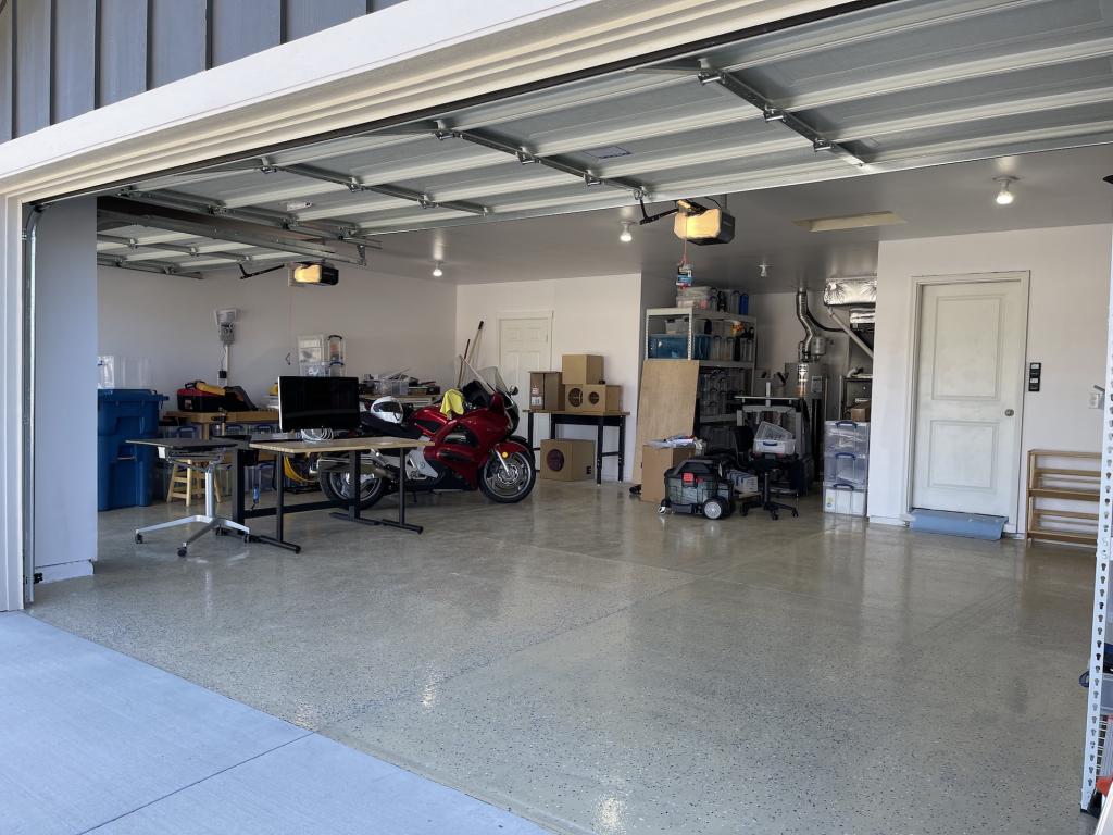

                                                                    We closed on the new home fixer upper in mid March. (new construction) but since have been putting in a lot of work fixing up stuff before moving in, like the garage, and some paint and tile work that my wife wanted to do.
                                                                    I've been sleeping still at the rental, Liubov at the new place for some time. Tonight is last night sleeping at the rental.
                                                                    Fixing up is stuff like the garage....
                                                                    I did an epoxy coat with hard clear coat on the garage floor, L-Bar on all the drywall bottoms, mudding the L-Bar and going over much of the original mud work, sanding (random orbital I use for cabinets, with vac hose!), two coats of PVA primer, two coats of Urethane Alkyd paint, and new lighting...
                                                                    A neighbor had a specialist come in and do their epoxy coat- I spoke with a guy from the company before they left... $5 per square foot. 600 sq ft. 3 man crew. Did it in one day. If you have the money to spend, that's the way to go, I suppose! We had a budget for the cash purchase of the house, and broke that slightly- still planned on some sweat equity items.
                                                                        Garage looks good, particularly the Garage floor - like a speckled ice skating rink.

                                                                                OK, let's look at what might be possible if I strike it rich under the sofa cushions, and just for shear bragging rights and ultra low HD3, what happens if we try to go with the the PuriFi PPT8.0X04?
                                                                                Well, I actually ran some base numbers back in mid May when the part was preview announced, and this might be a fairly "optimum" solution- from a performance viewpoint, but not from ease of implementation.
                                                                                170L, with 8x RSS265PR, using 350G grams MMS per PR, 200W total input power
                                                                                This results in a peak excursion of about 7.5 mm at 36-42 Hz.
                                                                                But, my, where would we put all those PR's, or the 170L enclosure? Can we set our sights a little lower and still come up with something interesting with ludicrously low HD3 between 150Hz and 1200Hz? What about incorporating a little bit of Modula Xtreme thinking into this?
                                                                                120L with 4x RSS265PR, 275g MMS per PR, net series resistance in crossover < 0.5 ohms
Name:	120L 0.5 Ohms 275g.jpg
                                                                                Still have a fairly good sensitivity and reasonable extension, but a softer roll off, still with Fb below 30Hz.
                                                                                Gee, what if we want to same some money on the LF crossover inductors... just for fun...
                                                                                120L with 4x RSS265PR, 275g per PR, net series resistance in LF crossover of 1 ohm...
Name:	120L 1.0 Ohms 275g.jpg
                                                                                Interesting...
                                                                                OK, just for the heck of it, let's take it to an extreme, explore the outer limits...
Name:	120L 2.0 Ohms 275g.jpg
                                                                                Still some reasonable sensitivity, but definitely more of a rock and roll alignment, as regards the overall balance. Still an Fb of 28Hz, so reasonable control of things.
                                                                                This sort of reminds me of Goldilocks and the three bears. But I think I kind of like #2.

                                                                                      4 PTT8.04 and 4 passive radiators. Sorry for any confusion
