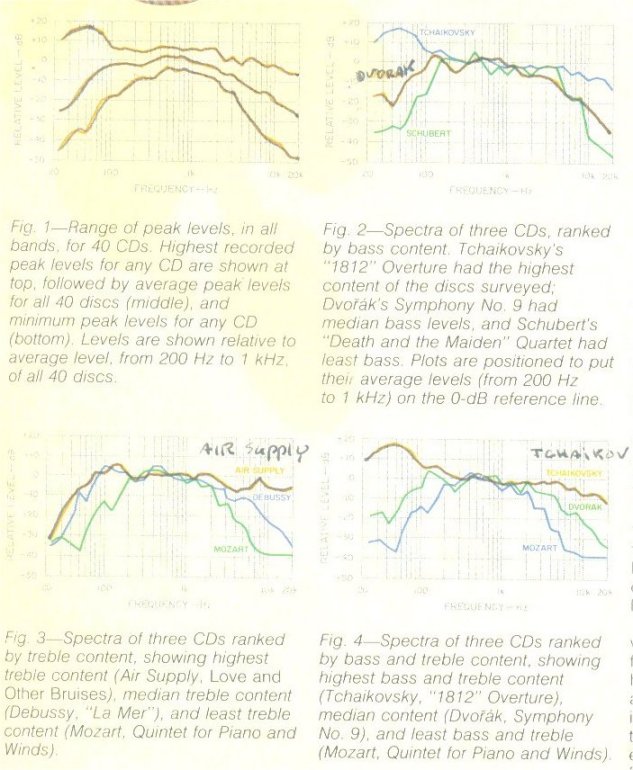

            One of the reasons I am so concerned about T's low end abilities is that, depending on the material played, there can be considerable energy being handled by T's in the range from 1K to 2K Hz. As an example see the attachment below which is from Audio July 1989. The graphs represent peak recorded signals vs freq. Obviously, if it is on the CD you would like to accurately reproduce the peaks on play back. And contrary to what is often commonly believed, there can be serious levels in the 1K to 2K region. 8O

            BTW if anyone is interested, I can post some more interesting graphs from that article. I think the article should be required reading for all who play in this arena.
