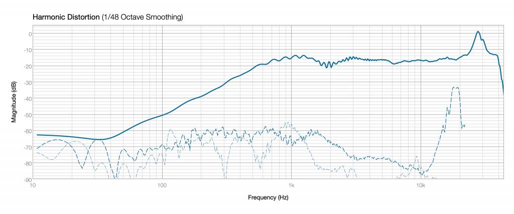

          You know, there's no substitute for measuring verification. The notch filter on the SMJ Calliope is a good example- totally cleans up the top end HD3 induced from resonance amplification as well as the frequency response. And the Q control can be a resistor in series with one of the reactive elements.
          Here's example measurements for the DA25TX, raw, and in the Calliope system
Name:	DA25TX00-08 0 deg Distortion.jpg
Name:	Ref Voiced Notched Disto.jpg
