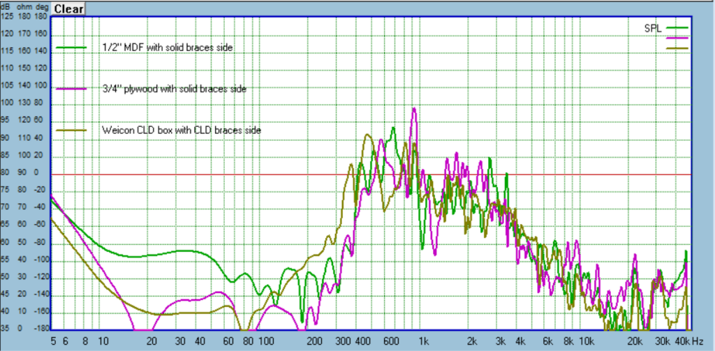

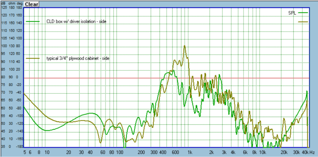

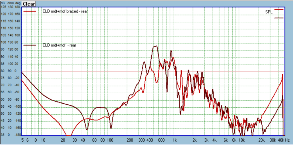

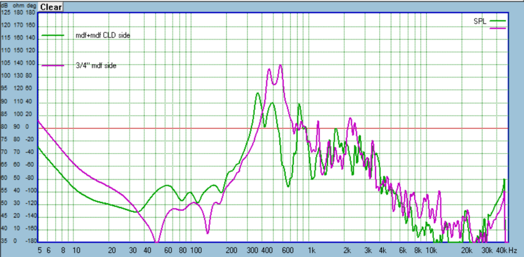

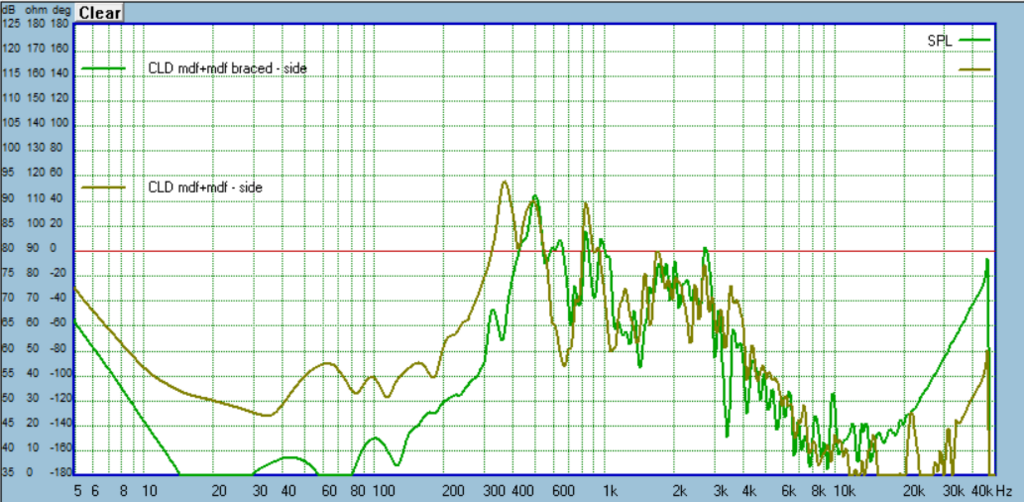

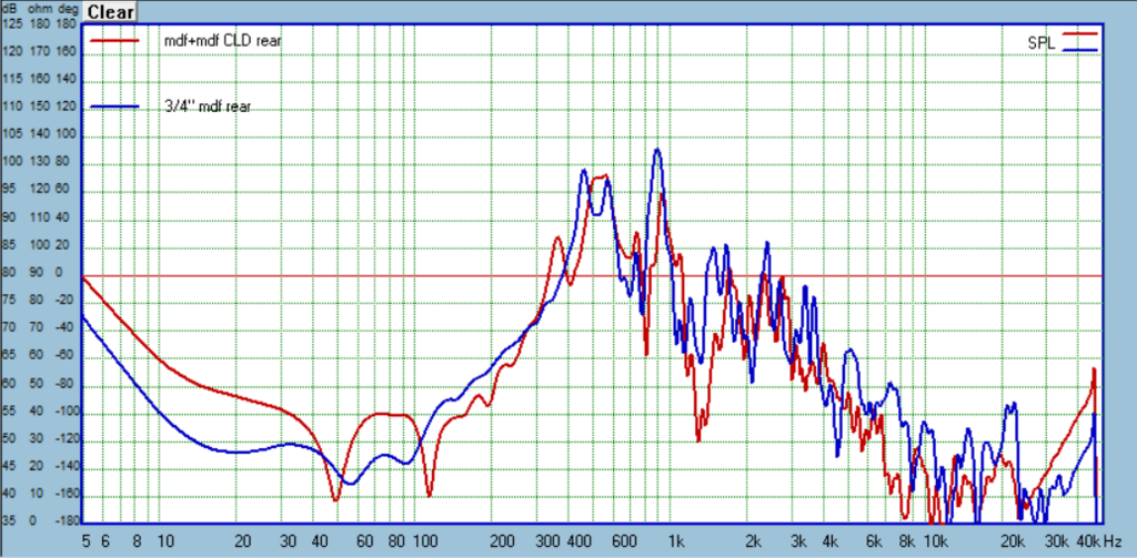

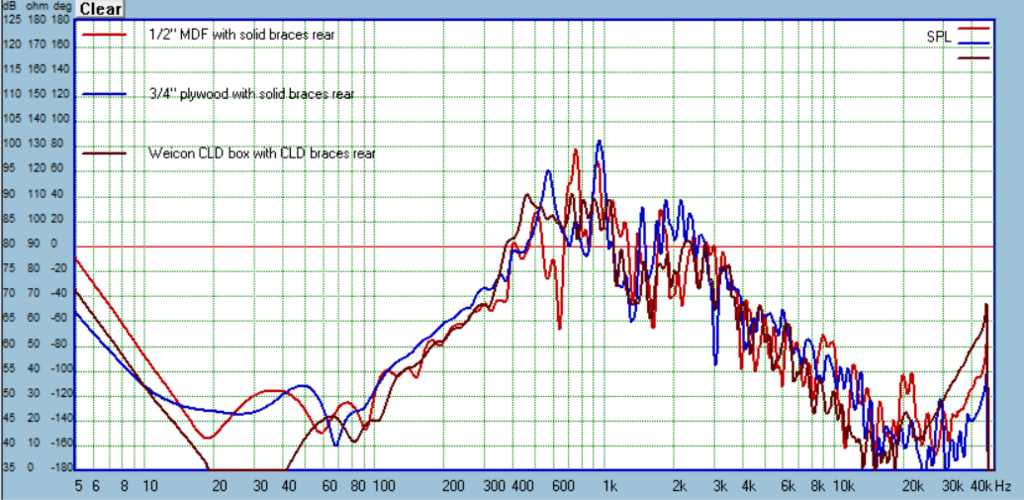

    It might be good to recap where my cabinet testing has led. I started measuring just simple materials, ply, MDF, in 1/2" and 3/4" to establish a baseline. Moving on CLD construction, I now used 1/4" MDF "skins" joined by either the adhesive under test, or with an additional layer of foam, cork, etc. in between. From this the Nidacore construction was probably best, but the simple 1/4" MDF glued together with Weicon 310M Flex was so close and so much easier and cheaper to make, I would use that in the future. From my bracing tests (prior to the results just posted above) the CLD with Weicon 310M Flex made a decent improvement over solid braces. The next question is whether adding those CLD braces to the simple Weicon CLD box would retain the benefits if both. The following is just such box, compared to a simple 1/2" MDF box with solid braces, and a 3/4" plywood box with solid braces to represent the typical DIY boxes.

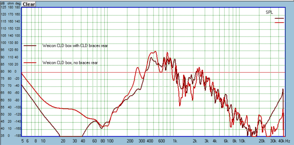

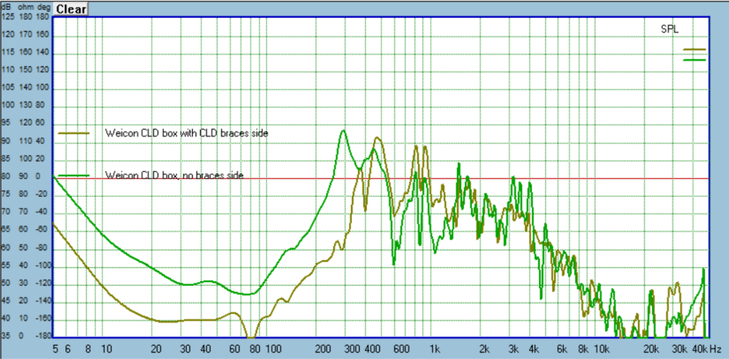

    I would say the rear panel measurement shows the Weicon CLD box to be superior to the others. The side measurement has it about the same as the MDF, with both being ahead of the 3/4" plywood box. I will say the addition of the CLD braces to the CLD box, didn't complement each other quite as I had hoped. Here is that CLD box with and without braces:
    You really have to match the construction method to the passband of the driver. If it was a (sub)woofer, plywood with a lot of bracing is perfect. For a pure midrange crossed at 300hz, I might go with the simple CLD box without braces. The real trick is when it's a 2-way. The choice isn't so clear to me at this point.
    Last edited by theSven; 30 April 2023, 20:44 Sunday. Reason: Update image location
    ~Brandon 8O

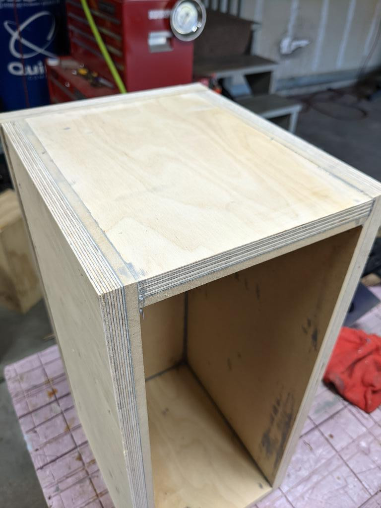

      I also wanted to try a version of the simple Weicon CLD box (no braces) but using 1/4" MDF inside and 1/2 plywood on the outside. The idea being that the two materials would resonate at different frequencies and thereroe damp each other. I also did a version using 1/4" MDF & 1/2" MDF. I also switched from "box-within-a-box" construction to gluing the panels up ahead of time, then cutting to size and constructing the box. See pic to see what I mean. These are not braced and glued with Weicon 310M Flex. BTW, the Weicon can be found here.

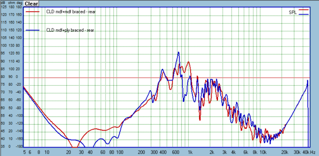

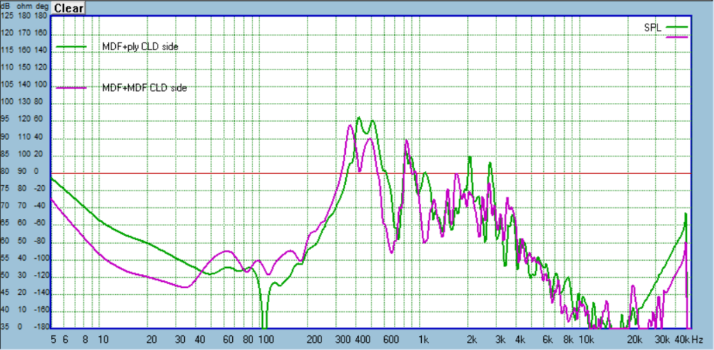

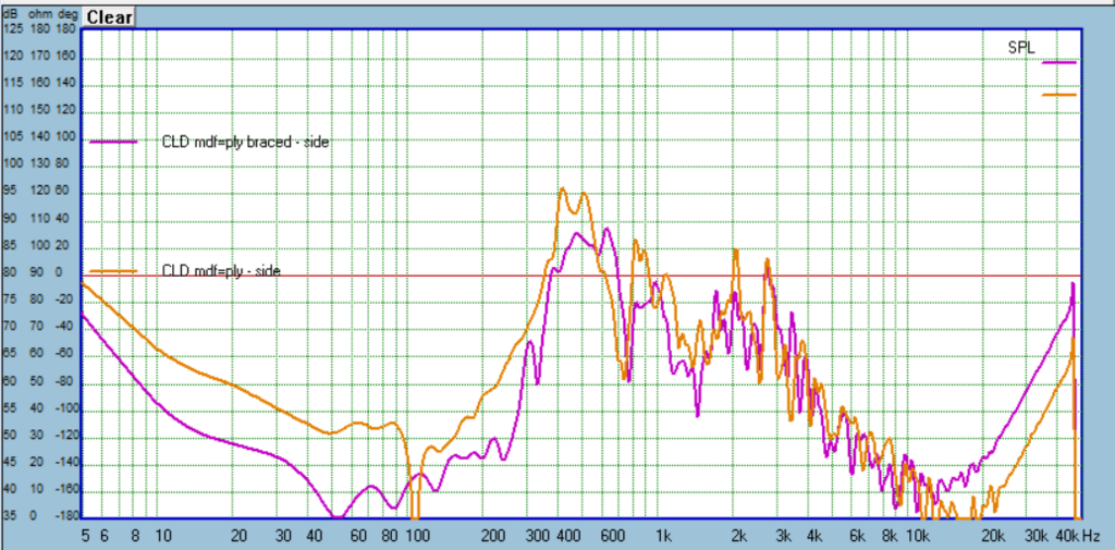

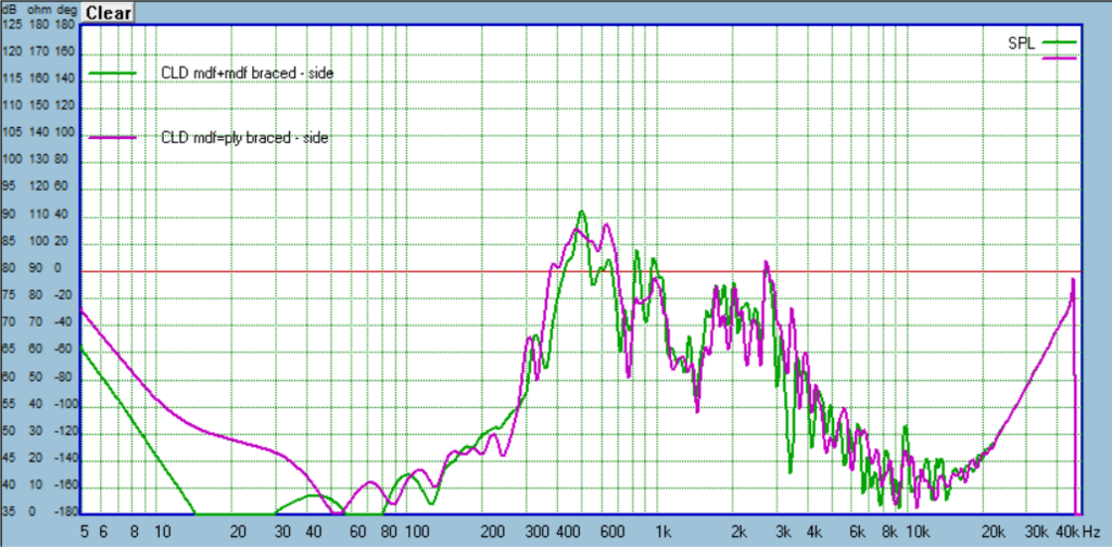

        Here is another comparison I find interesting. This is the CLD of 1/4" and 1/2" MDF glued with Weicon, versus solid 3/4" MDF. So same nominal thickness and material, but one is solid and the other CLD:
        Last edited by theSven; 30 April 2023, 20:45 Sunday. Reason: Update image location

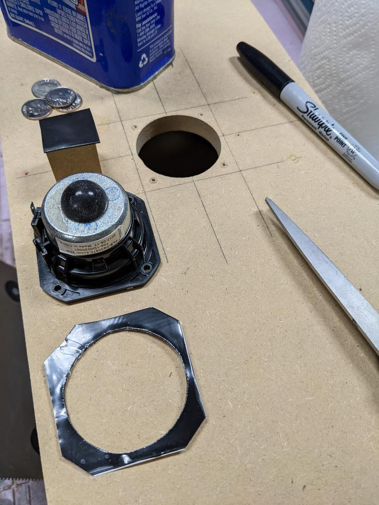

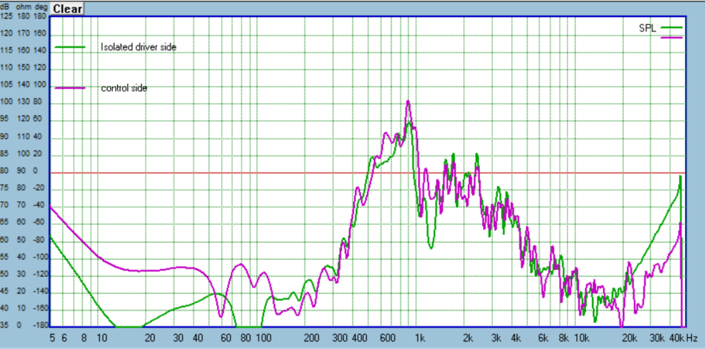

            I've been wanting to test driver mounting methods, so here is my first attempt. I used 1/16" sorbothane sheet between the driver and box. Then a stub at the rear pressed down on teh driver with a sorbothane button between them. So the driver is completely isolated from anything by sorbothane. I used the 3/4" plywood box with matrix bracing from the last round as the control.

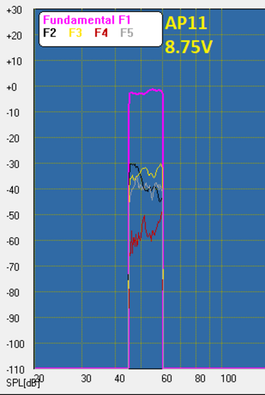

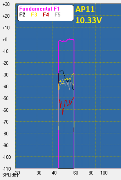

            That's a dang good result right there! Now how to scale it up and make it practical? Normal rubber will have to be used too, sorbothane is really expensive.

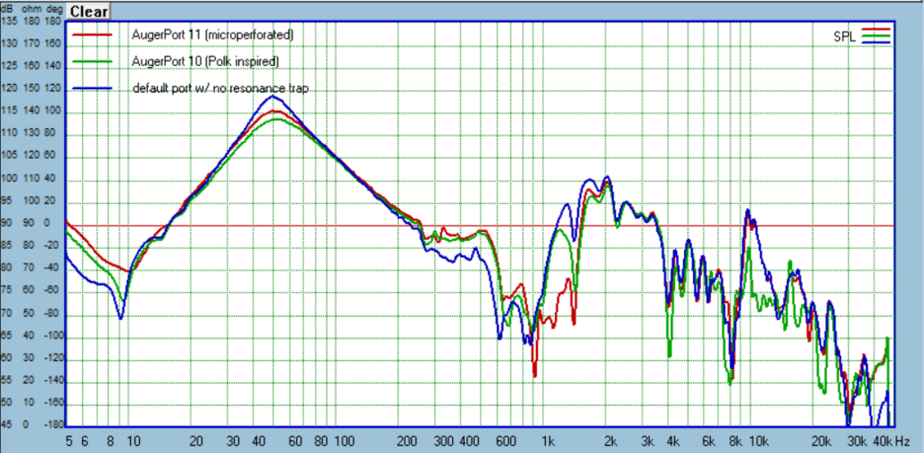

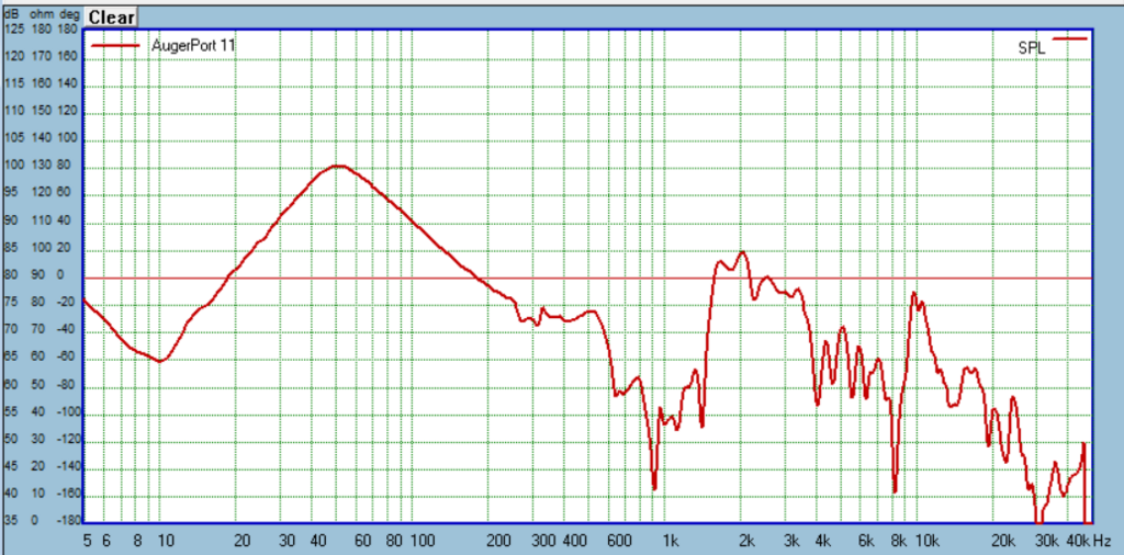

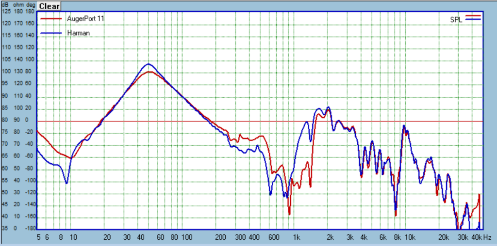

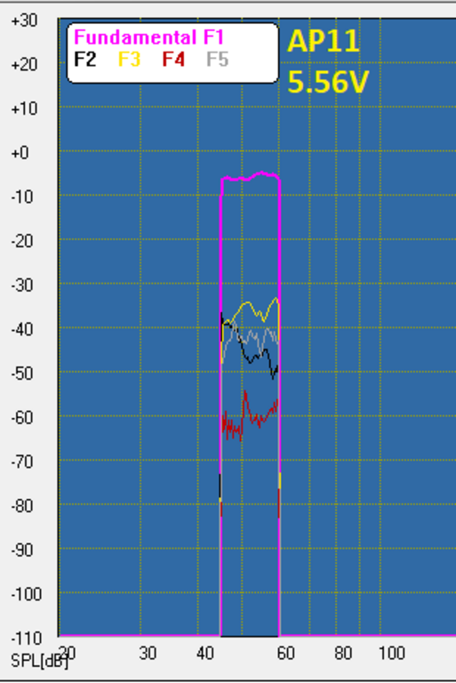

            Next, the newest version of the AugerPort. The second attempt at the Polk X-port inspired design hasn't made any improvement so I won't post those results. The other port is the microperforated one from the last round, but with 3 rows of holes instead of 5. I'm going to continue to work this idea.
            And compared against the Harman inspired port on which it is based:

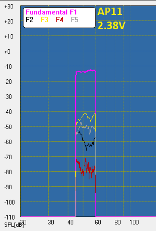

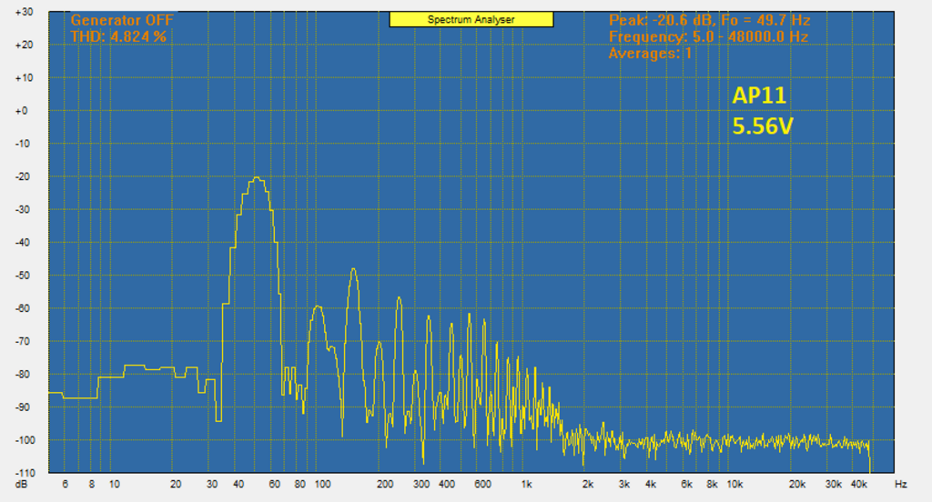

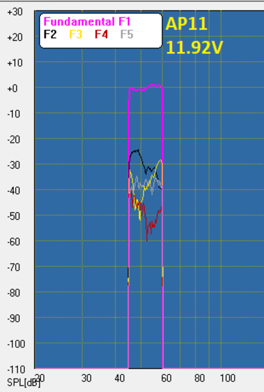

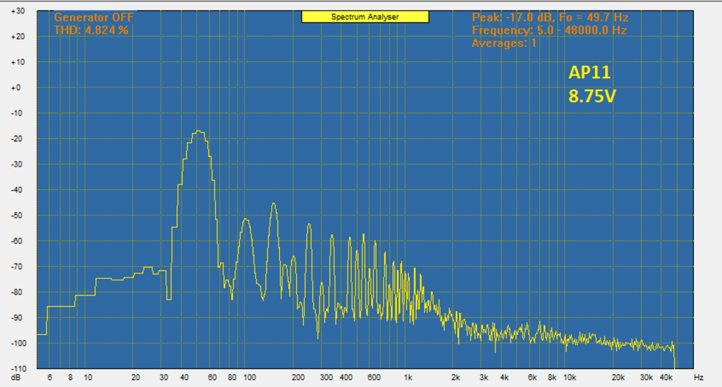

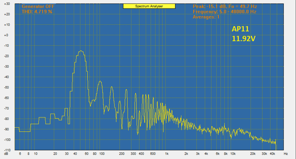

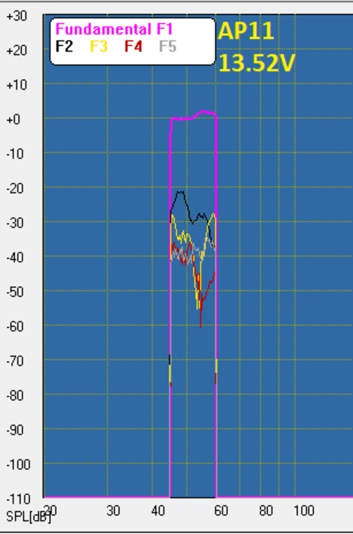

            And some distortion results:

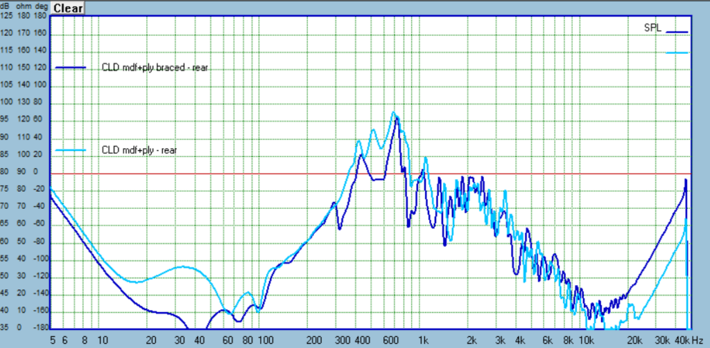

              • 1871
              #141

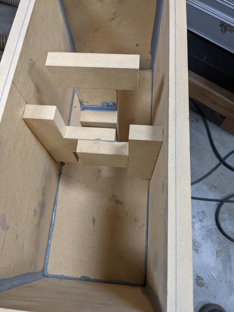

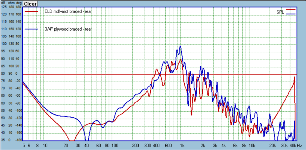

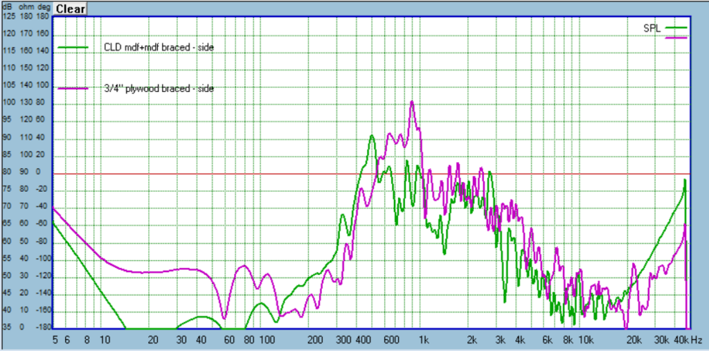

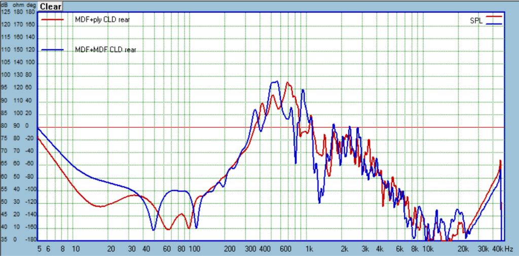

              I also took the CLD boxes from the last round and added CLD bracing. As a reminder, I made two boxes, both using Weicon Flex310M as the constrained layer/adhesive and using 1/2" mdf glued to 1/4" mdf, and the other box 1/2" plywood glued to 1/4" mdf. The following compares the box before and after the braces were added, then compared to each other, than compared to a typical 3/4" plywood box with oak dowel braces.
              Last edited by theSven; 30 April 2023, 20:49 Sunday. Reason: Update image location
              ~Brandon 8O

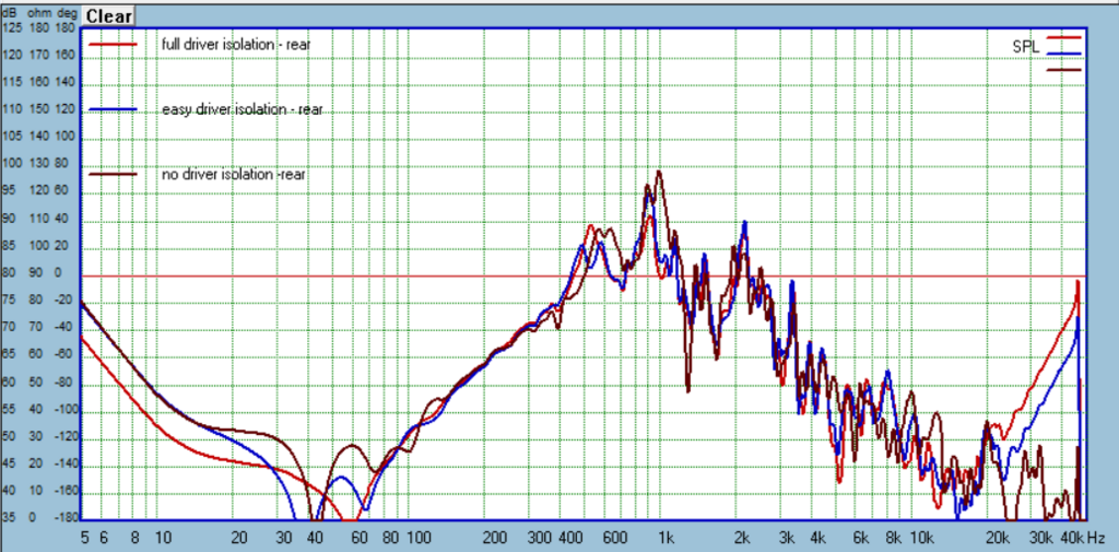

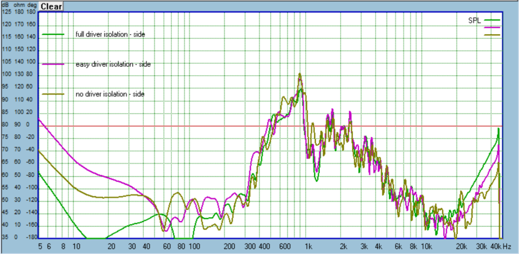

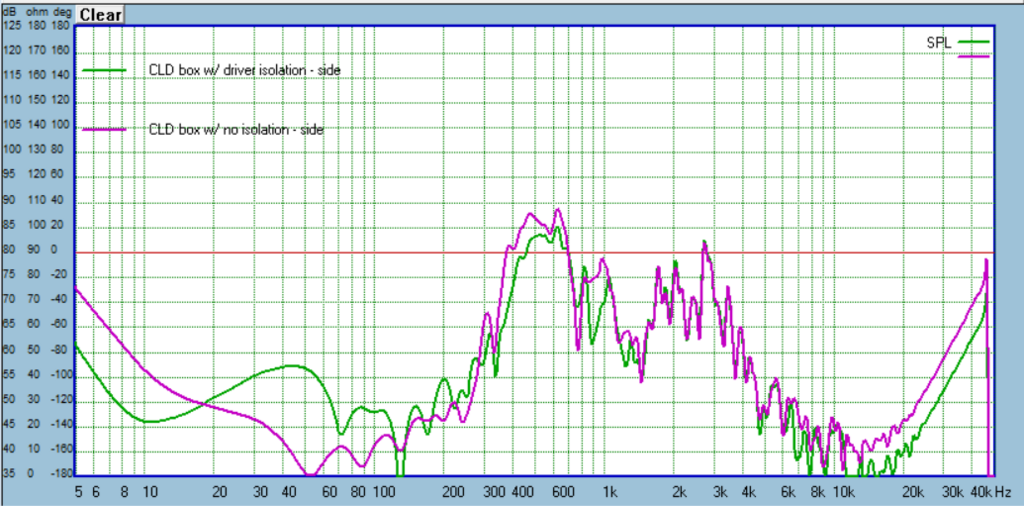

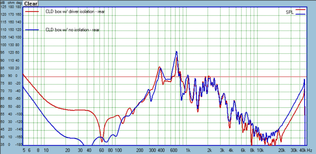

                Regarding the driver isolation results above, I wondered how just using the gasket and screws would behave, given that is the typical DIY mounting method. Through all this testing I was not using a gasket because I wanted this small driver to couple well to the cabinet so differences in construction methods would (hopefully) be more obvious. Leaving the sorbothane gasket in place and attaching the driver with screws was very nearly the same as no gasket at all. Clearly the screws were transferring energy to the cabinet quite well. So my next test today was to use rubber washers under the screw so it wasn't directly touching the driver frame. I label this "easy" below because anyone could copy this with hardly any change from typical DIy methods. I label the original experiment as "full isolation" because there was sorbothane completely isolating the driver. This would require more complex construction to pull off in a typical DIY design. I also compare these two results with no isolation at all, as in the above post.
                So the "easy" method is more or less in between the "full" isolation and no isolation. So that is promising given how easy this is to implement in any design.

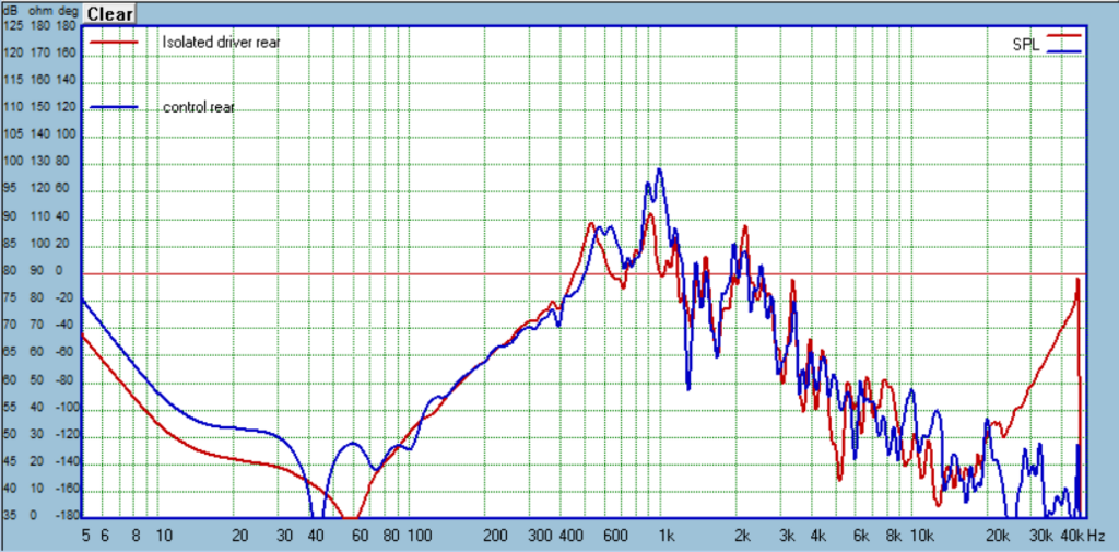

                Then I used the "easy" method on the CLD box from yesterday, the one that is 1/4" mdf + 1/2" plywood, and included CLD braces. I thought that with the CLD construction the addition of driver isolation might not be as obvious:

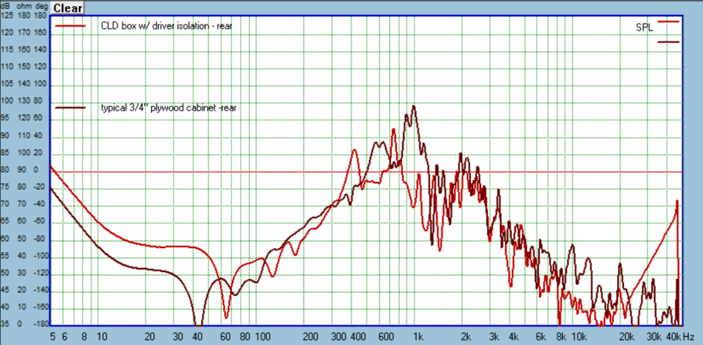

                Still looking better! So this might be a good time to take stock of where this testing has led. The plot above is pretty much the current state of my art: CLD box, CLD braces, and easy driver isolation. How does this compare to the typical DIY box made from the 3/4" plywood:
                Mission accomplished! And this is without even applying the Resonix which I would in a typical build.
                Last edited by theSven; 30 April 2023, 20:50 Sunday. Reason: Update image location

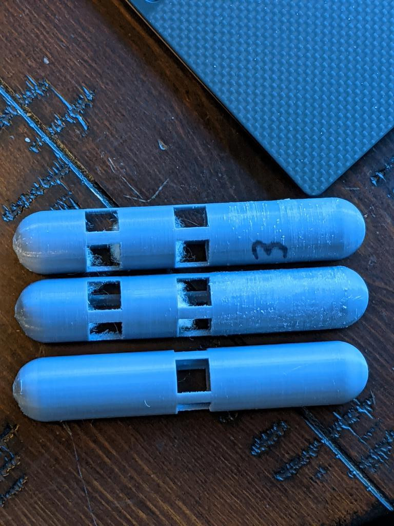

                      Here is a bit more info on the Polk-inspired port, so maybe I can get some help figuring out how to tune the resonator properly. I've used three resonators: one with a tap in the center, one with a tap in the center and 1/4 length (both taps sharing same air cavity), and another with a center tap and 1/4 length tap but having their own air cavity.
                      Looking back at the results it wasn't quite accurate to say they made no difference, there was a small benefit but less than anything else I've designed. Here it is compared to the port with microperforations and the original port on which all of these are based (Harman contour):
                      Thoughts?

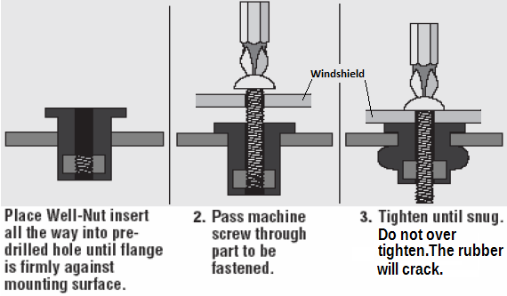

                        Not what you asked, but I’d be curious what kind of driver isolation you could achieve by affixing the baffle (or part of the baffle, or the driver) to the cabinet using well nuts, screws, and a gasket.
                        In theory the screws would act as an extension of the driver frame, baffle, etc. but be isolated from everything else by the well nuts. The back of the driver frame or baffle would isolated per the gasket (assuming conventional driver mounting).
                        You could mount the driver in this way on a partial baffle that was also mounted to the main baffle in this way for isolation^2. ��
                        Cheers!

                          Aren't well nuts metal?

                            Hopefully this works. If it doesn't just google rubber well nuts:
                            I've used rubber ones where the metal nut is embedded in rubber. It is inserted from the front side and tightening it compresses the rubber on the backside to pull tight.
                            They seem to be used in lots of applications- motorcycles, kayaks, windshields, etc.
                            Per this diagram, I make the top of the well nut flush with the top of the mounting surface so there is not a raised portion. Then a gasket can be laid flat.

                              I forgot I have some of those. Unfortunately they are too big to test because I'm using a really small driver.
