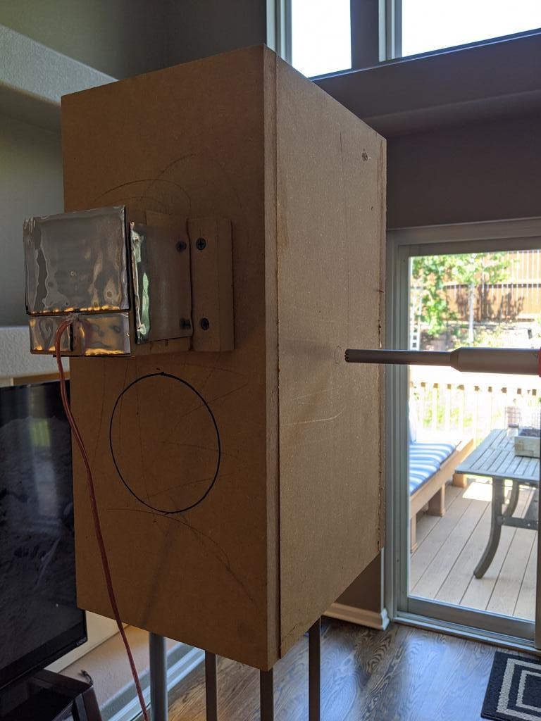

    A Monster Construction Methods Shootout Thread

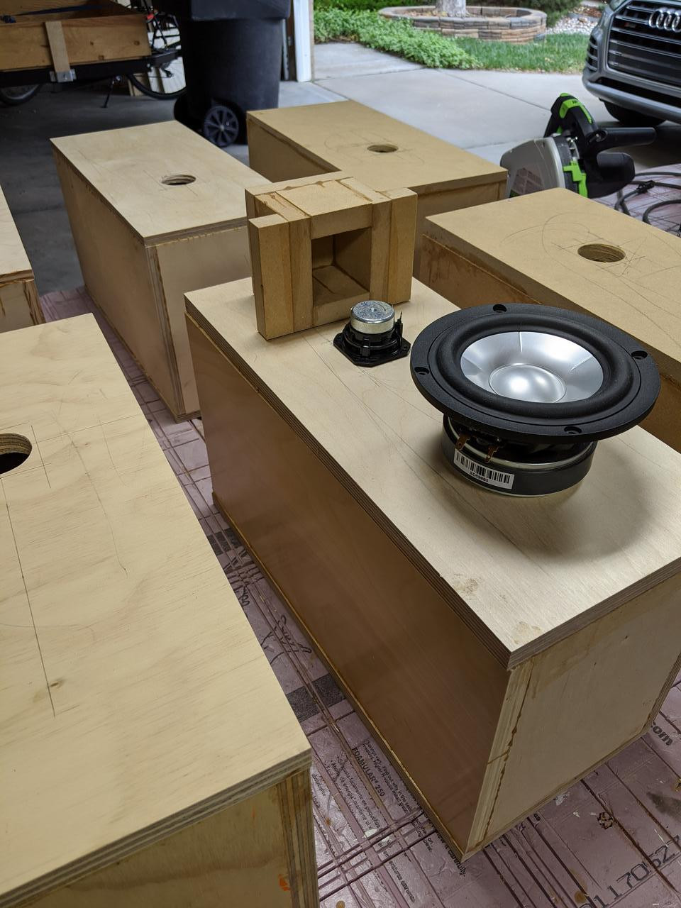

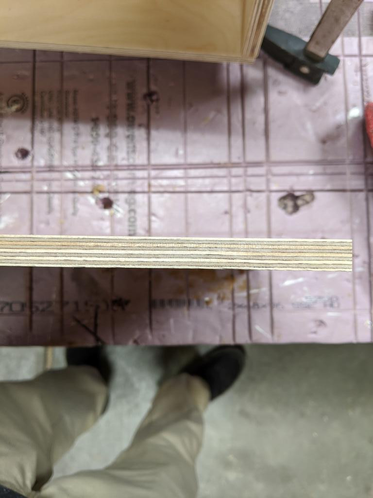

    Which wood to use? Which fill? What does bracing do? Is CLD best? I'm starting this project to start quantifying some answers to these questions. A lot of work has been done before in fits in starts by others (BBC, Kef, etc.) but they were often narrow investigations and you couldn't compare results because measurement conditions were different among the different studies. Some have cited manufacturer's damping specs, but I have no idea how that translates to the real world. Ditto on accelerometer data. So here I will be doing SPL measurements, that is after all, what we actually hear. The cabinet is ordinary, large enough for the panels to have some radiating area and magnify differences between changes.
    I will be using a Peerless 830970 firing into the cabinet using MLS signals. I have to test mic placement, but it will probably end up near-ish field, probably at a side panel. When I do the fill/lining I will mount the SB15 as a dummy woofer and measure what radiates through it. I intend to measure SPL, CSD, and THD. Any other recommendations appreciated.
    For the material test I currently have: high and low quality plywood in 1/2" and 3/4", and MDF in 1/2" and 3/4".
    For the fill and lining I have: SDS CLD tiles, AcoustX coating, denim insulation, polyfill, 1" thick dacron blanket (what the TL guys use) and Sonic Barrier.
    For bracing I will do: simple oak crossbrace versus oak crossbrace using CLD construction with Sikaflex 292i adhesive. I also have some microspherules to combine with the adhesive to see how that changes things.
    I would appreciate all suggestions on any other additions to the above. A priority will be that the materials must be widely available and reasonably priced, and the methods must be accessible to an ordinary DIYer.

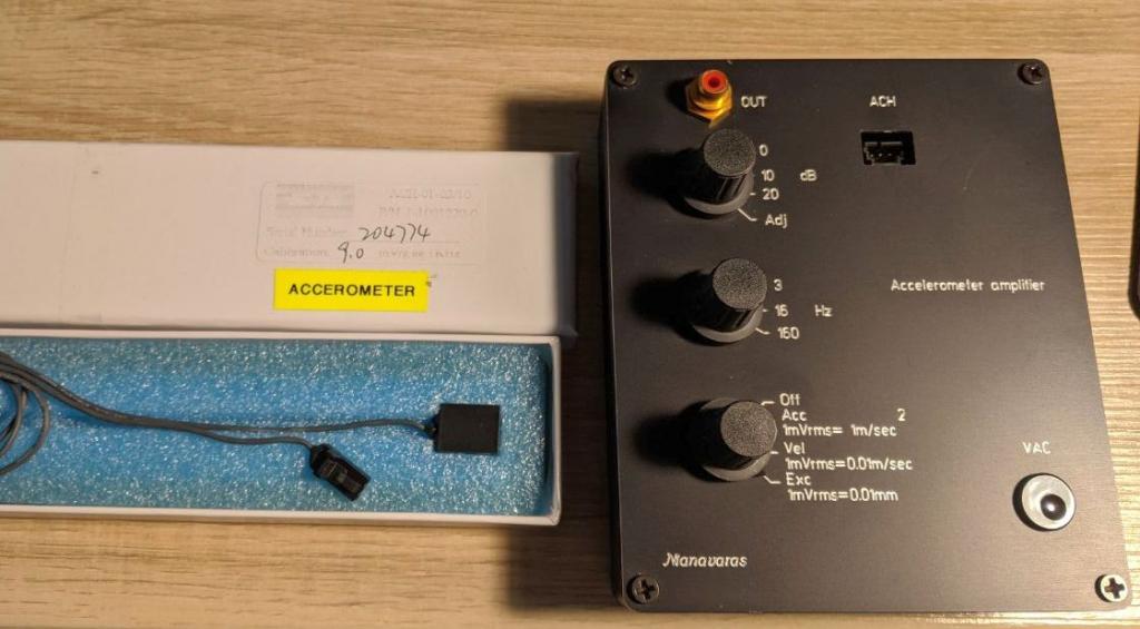

    Thats a great idea and not easy undertaking but would yield some very interesting data indeed.
    Depending on your timing I would be willing to post you this unit to try out and loan for as long as this project will need it

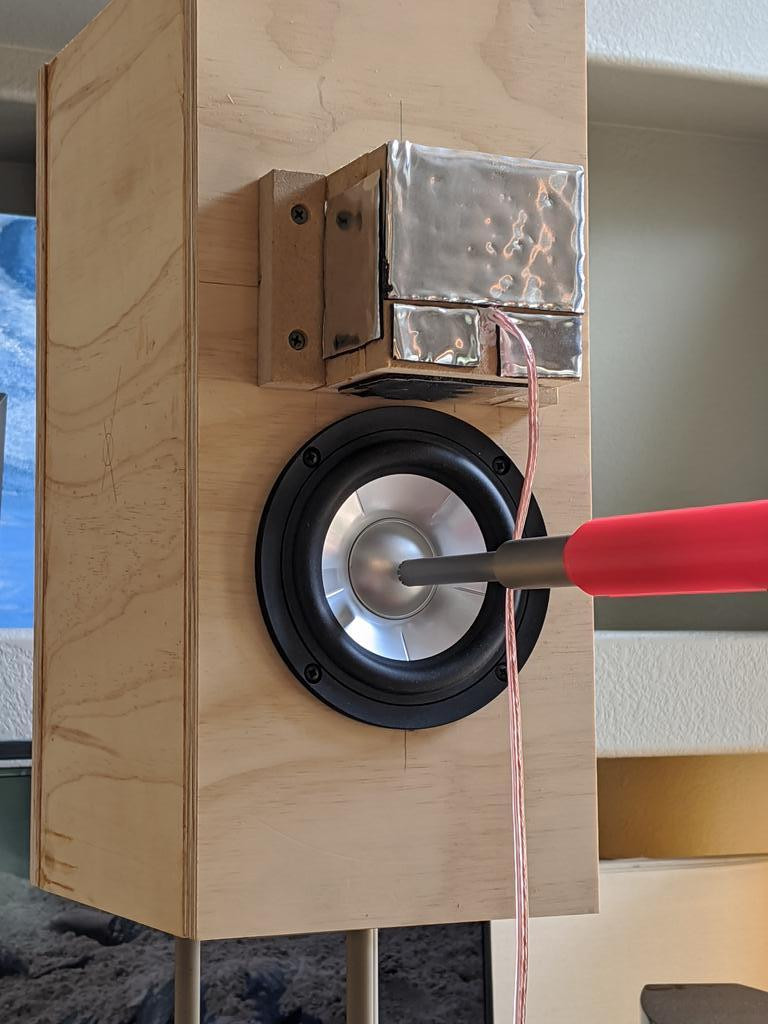

    George Ntanavaras describes the design of a system consisting of the ACH-01 accelerometer and a preamplifier with an integrated analog signal processor.
    Can be used with ARTA or REW and the sensor is small and light enough so attaching it with thin double sided tape or a drop of hot glue should work well. To release a hot glue attachment a spray can of "cold/freeze" can do the trick super easily.
    I bought this unit from George in Greece some two years ago, but only tried it briefly. So kinda feel bad it's not getting the use it deserves and that use is exactly what you are attempting and I have not had time for. So let me know if this offer interests you.

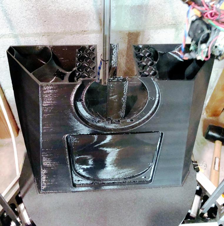

      Droid based construction for your consideration. Printed shell will be filled with a poured material; possibly carbonite, possibly concrete, plaster, etc.
      • augerpro
        • 1871
        Great idea! Let's flesh that out a bit. What sort of internal structure? What fill material?

          The baffle in that picture has gyroid infill. 2% fill for most of it and 10% for the center section so that the bolt holes have something to land upon as they are printed up layer by layer. A poured filling should flow into the gyroid structure so that I end up with macro scale composite of PLA and whatever I fill with. I would have rather had slightly denser infill in the whole thing but the pictured design was projected to use almost a full kg of filament and a normal roll is one kg.
          The current plan is to fill with El Rey Fiber-47 Sanded Stucco Basecoat. It's cheap, easy to source (Lowes and Home Depot), fiber reinforced, and no large aggregate so if should flow to small features inside the print. I'll likely add plasticizer to increase flow of the mix. I'll also make the mix fairly wet and hope it still hardens okay. Plaster would be a safer option for a successful pour, maybe add some fiber to increase strength (but its more expensive and my local Hobby Lobby only had one bag). Epoxy granite should be the ultimate choice for fill material (many readers may already know but for those who don't: common concrete is sand and gravel aggregate with portland cement as binder, epoxy granite is several sizes of graded granite aggregate and epoxy as binder). Some high end machine tool manufacturers have gone to epoxy granite for the base of the tools (from cast iron) because it is superior at absorbing vibration.
          I'm still debating if I'll print and fill the body panels or just the baffle. On one hand printed panels might be a bit of overkill on the 3D printing, might cost more, take longer, and perform worse than plywood+mdf panels would. On the other hand, there's no kill like overkill. If you want to go even farther down this rabbit-hole, a gyroid has two volumes, each of the "holes" on the top connect to either volume A or volume B but the two volumes are separate through the structure. So, you could pour one material in one volume and different propertied material in the other volume.

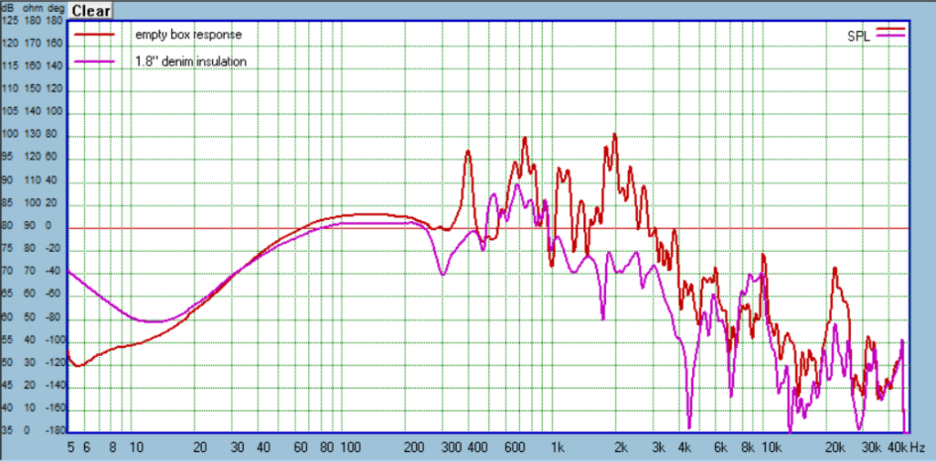

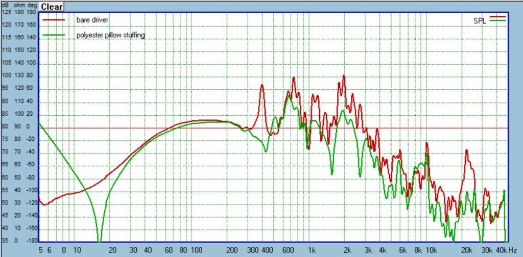

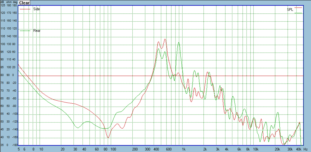

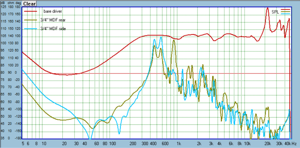

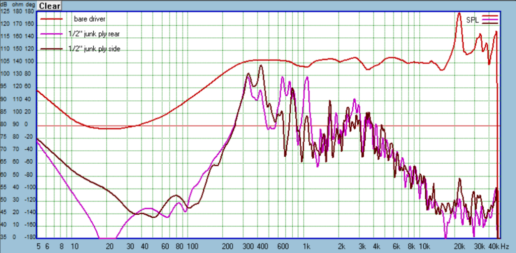

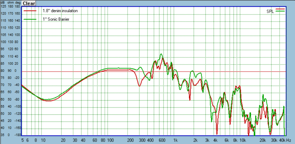

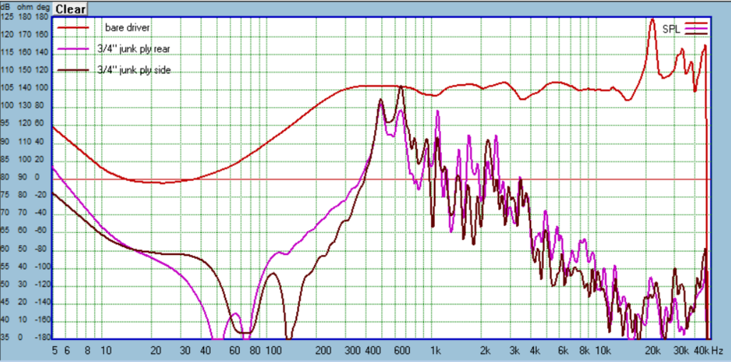

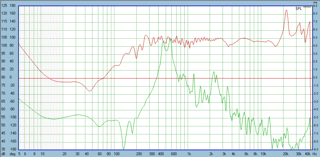

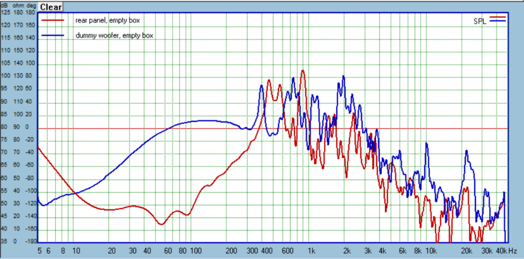

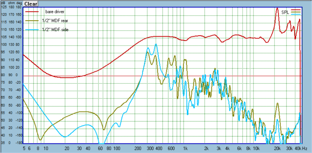

                                    Measurements have started, need some feedback. Below is a measurement of the side panel and rear panel. Any reason to do one over the other? I'd rather not double my work by doing both, if possible. Will probably stick with 50ms gate, 1/6 octave smoothed, unless someone would like more accurate but messier plots, I can always reprocess past measurements so this is not something I need to decide now. Also, since there was some confusion on my test setup, here is a pic when measuring different materials and build methods. For the lining/fill tests there will be a dummy woofer below the source driver, and the mic will be nearfield on that dummy driver.
                                    Last edited by theSven; 30 April 2023, 17:57 Sunday. Reason: Update image location

                                      I notice the second and third harmonic peaks are strongly visible for the rear panel but not for the side. Construction difference? Change in microphone position?
                                      Why not standardize on a 5ms gate to eliminate room reflections? We aren't seeing anything below 200Hz with this cabinet.

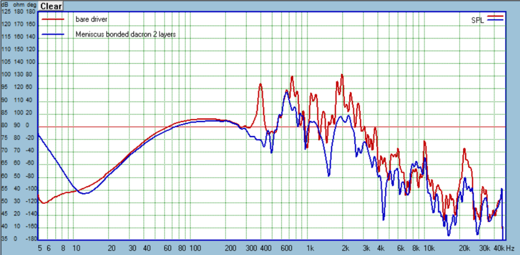

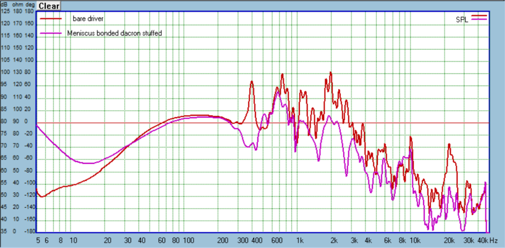

                                      I wanted to try the EAR C-1002 blue visco-elastic damping sheet material, been around for decades, bought some.
                                      It's very soft and stretchy - I never could figure a glue to bond MDF to it. West System epoxy might work.
                                      Small amounts are available from http://www.percyaudio.com/
                                      my experience
                                      I made test panels with MDF+BB composite and a relatively stiff 1mm thick visco-elastic sheet material made for car doors - adding the damping sheet had no effect at all!
                                      The same sheet did work well with MDF and thin bathroom tile as the constraining layer. So the relative stiffness of the materials matters.
                                      My current speaker cabinets use the MDF + bathroom tile construction.

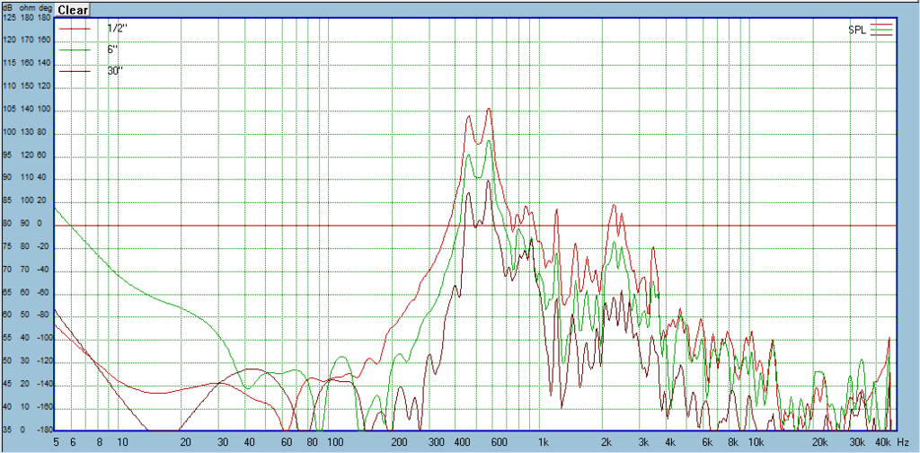

                                      • augerpro
                                        • 1871

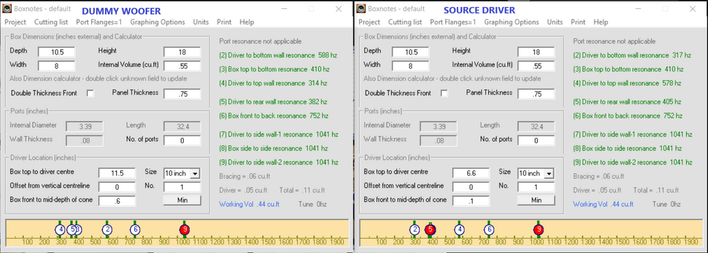

                                        Not sure on why those peaks are so different, but yes they do appear harmonic. Regarding gate, I wanted to do near field and longer gate to capture that low frequency behavior, just like measuring any woofer, but yes there isn't a lot going on down there other than normal low frequency rumble from the environment. Still, here is measurement of the source driver outside the box, from 33" away, same 50ms gate and 1/24 smoothing. I determined empirically the SPL difference between the two plots, so the SPL levels should be reasonably correct. I'll probably do a near field measure of the source driver as the future reference.

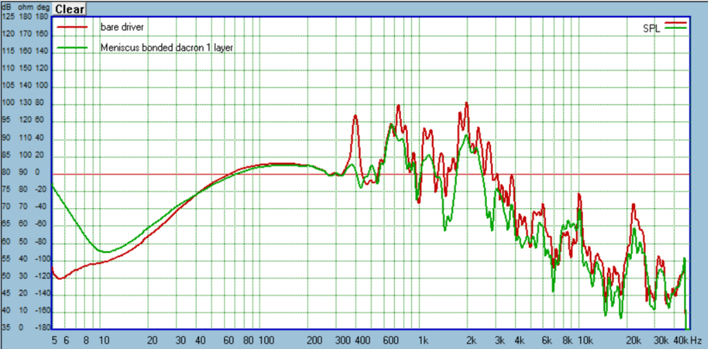

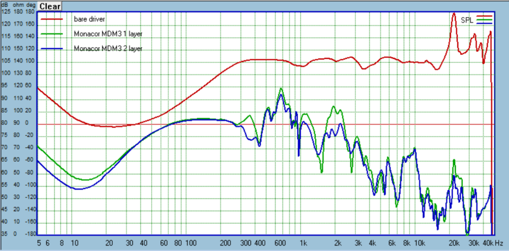

                                            • augerpro
                                              • 1871

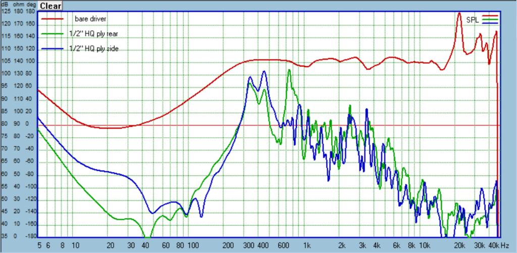

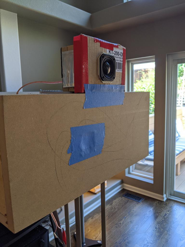

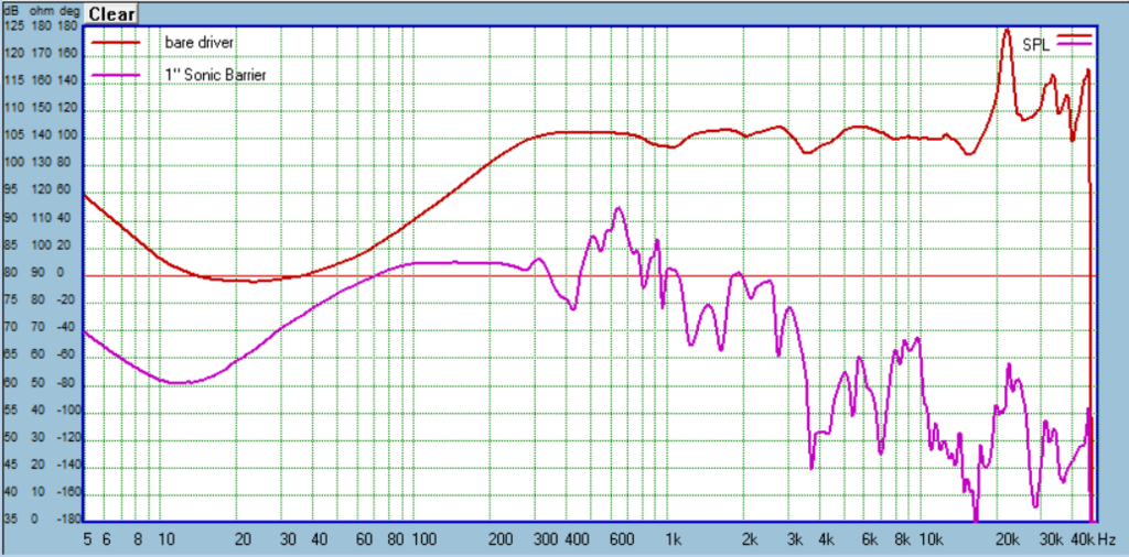

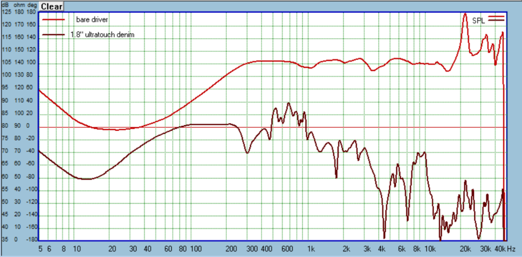

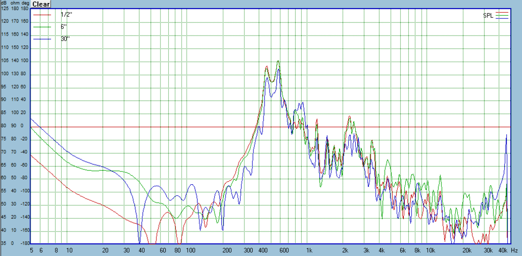

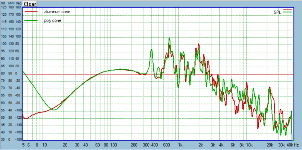

                                              BTW Jon, could use some feedback on the measurement conditions. Here is a comparison mic distance at 1/2", 6", and 30". First plot is raw response, second is *approximately* corrected for SPL loss with distance.
                                              Last edited by theSven; 30 April 2023, 17:58 Sunday. Reason: Update iamge location
                                              ~Brandon 8O
                                              DriverVault
                                              Soma Sonus

                                                Hi Brandon,
                                                Assuming that you’ve completely sealed the test enclosure(s) and you have no pressure leakage, then you are measuring pure deflection/deformation manifesting as sound pressure level. As such, the pressure level is resulting from the summation of all deformation modes, from all surfaces, and including the wholesale deformation of the whole cabinet in complex modes. Because you’re not measuring in an anechoic chamber, your microphone may only be able to pick up the direct radiating surface and nearest deformation mode(s) apart from ambient noise.
                                                However, as long as the geometry and dimensions are consistent from test enclosure to test enclosure, then your absolute comparison between the two is valid.
                                                I would base your decision on which results are more stark. Do you see a bigger and clearer difference in comparing the side or the back panel?
                                                My two cents.
                                                Cheers,
                                                Greg
                                                • augerpro
                                                  • 1871
                                                  Regarding box dimensions: I cut the panels so the outside dimensions would be the same. Internal dimensions and volume will be a bit different given the 1/2" vs 3/4" material. I'm not sure this was the correct decision, but even the internal differences would be very small, standing waves would probably shift a few Hz, same with panel resonances. Thoughts?
                                                  I'm going to do both side and rear panel measurements for now. The box is sealed, and I'm hoping the 3/4" MDF and SDS CLD tiles on the driver enclosure removes any radiation it might be giving off.

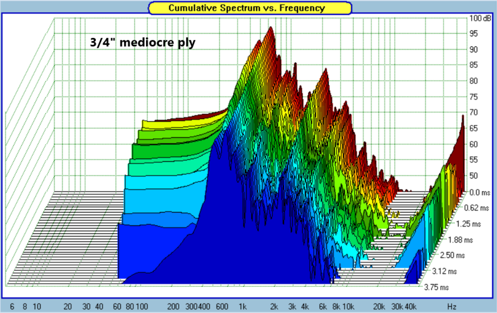

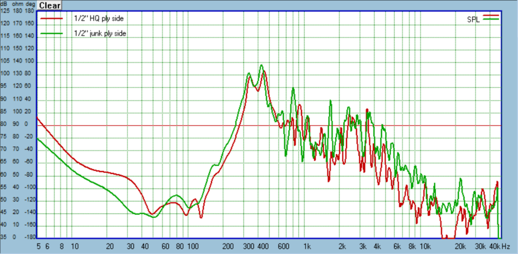

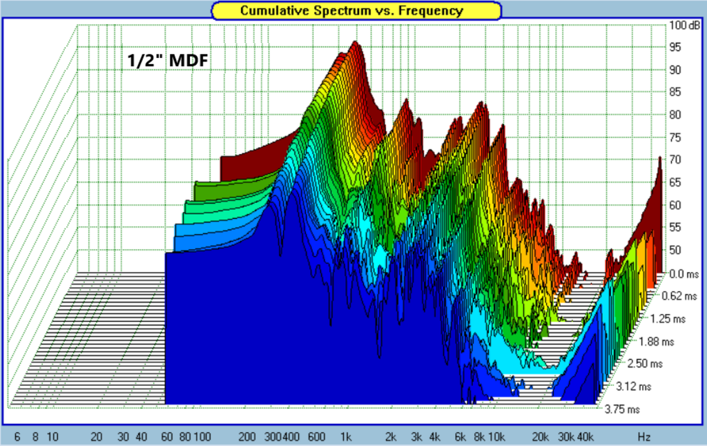

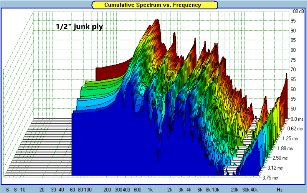

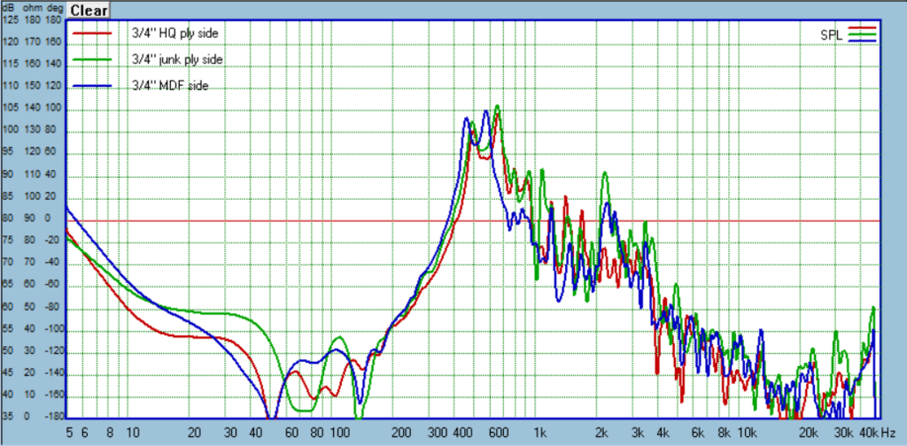

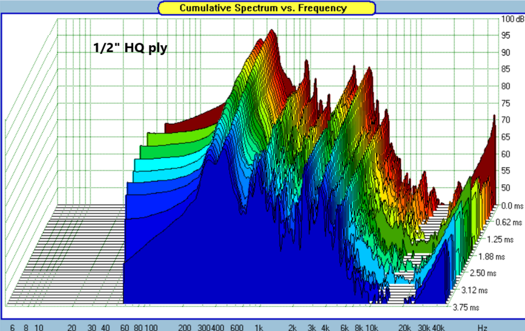

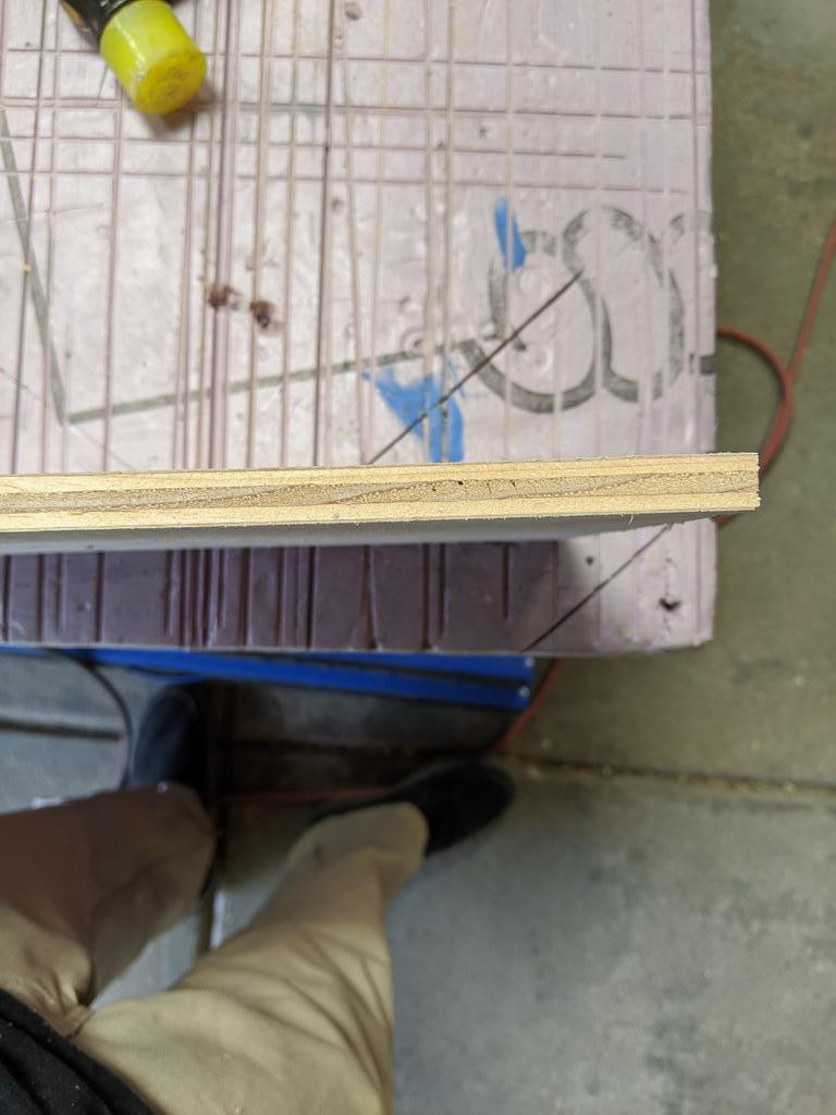

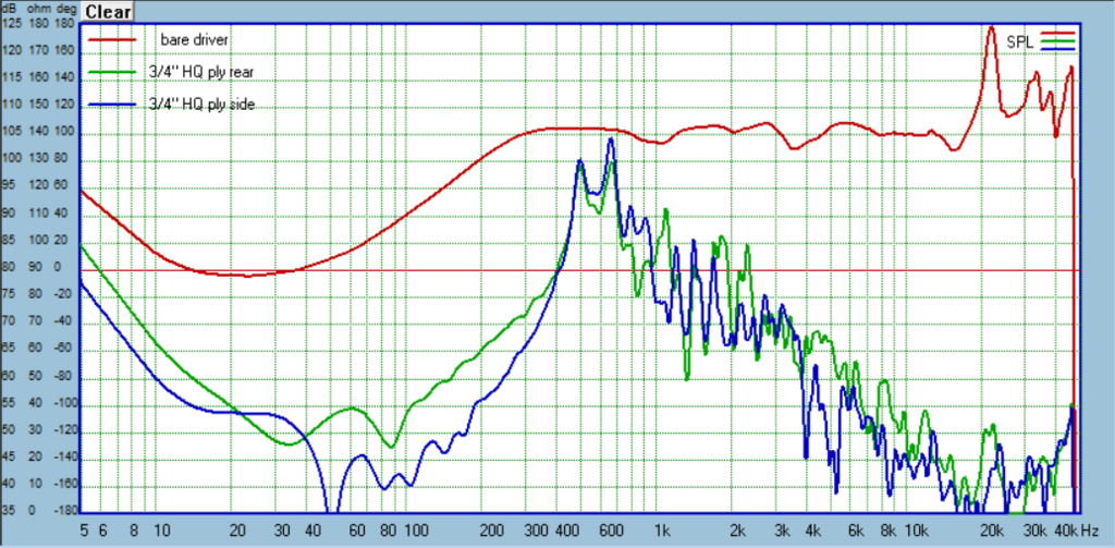

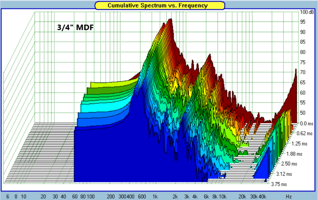

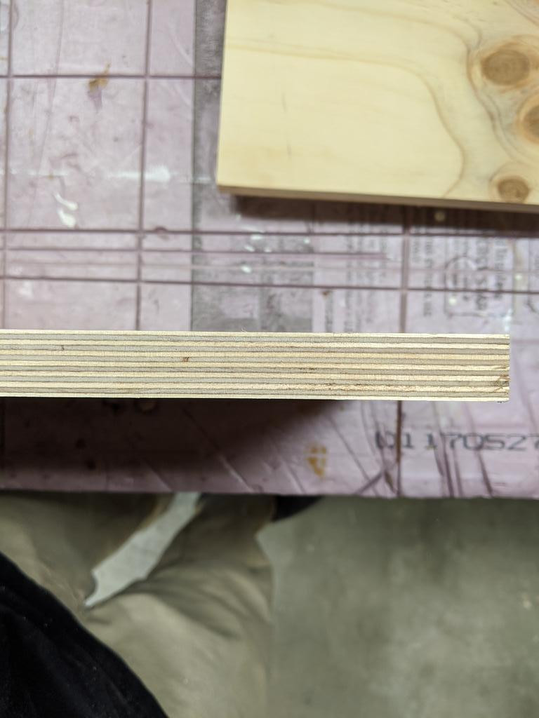

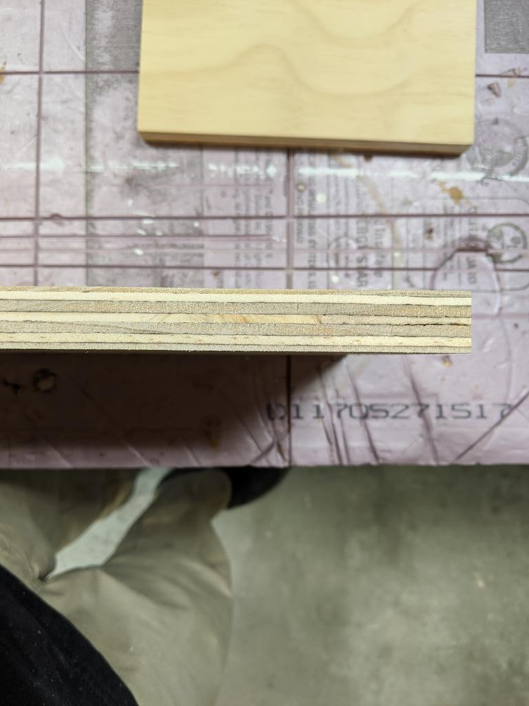

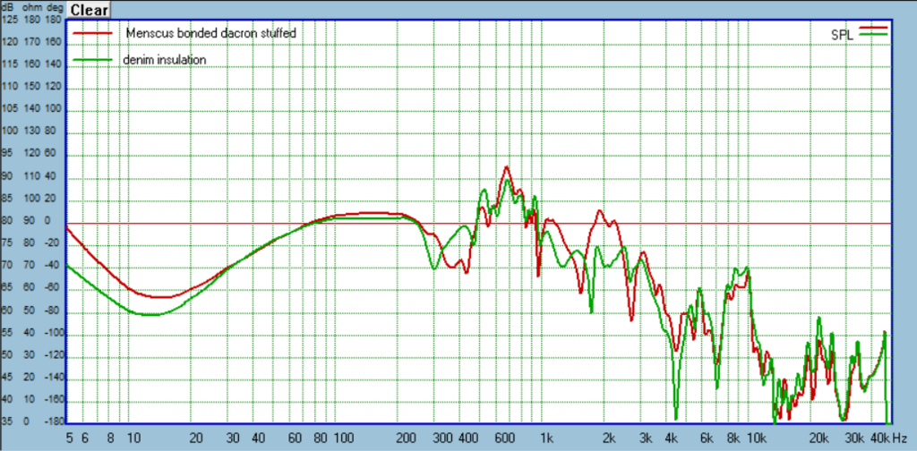

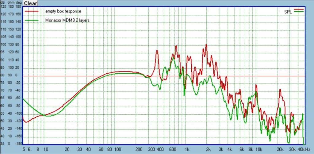

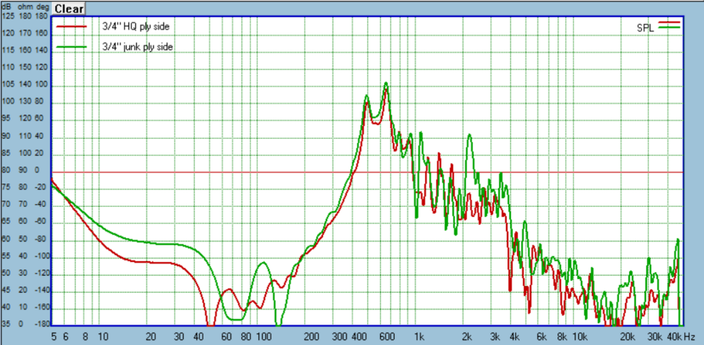

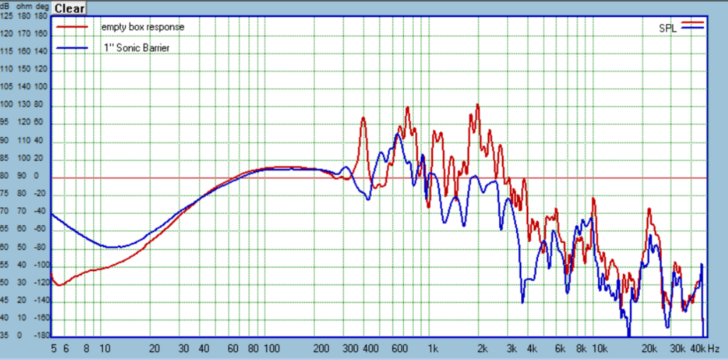

                                                    Here are some first results. For now, I'm measuring both side and rear panels. Mic distance is 1/2", 50ms gated MLS signal, 1/24 octave smoothing. Low frequency rumble starts showing up below 250hz, so ignore anything below that.
                                                    1/2" junk ply
                                                    Got this HD, looks like 3 ply plus veneers.
                                                    1/2" high quality ply
                                                    Also from HD I think, 7 ply plus thick veneers, birch ply
                                                    1/2" MDF
                                                    Typical MDF from HD

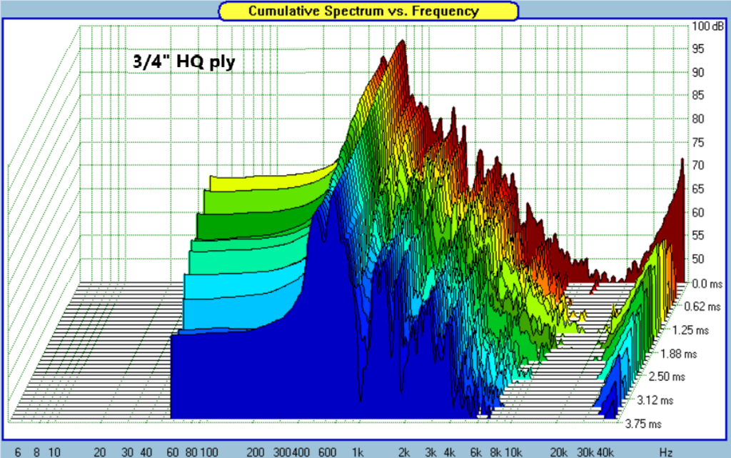

                                                    3/4" high quality ply
                                                    This is Russian birch from a local wood supplier. Very spendy. 13 plys.
                                                    3/4" mediocre ply
                                                    From HD, called A/C Radiata. 7 plys
                                                    3/4" MDF
                                                    typical MDF from HD

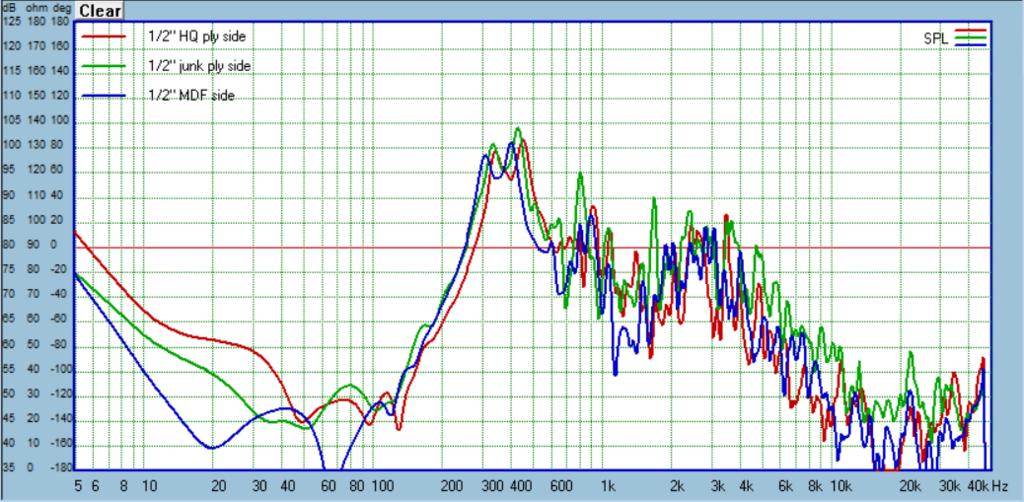

                                                    Comparing 1/2" sheets:
                                                    Comparing 3/4" sheets:
                                                    comparing 1/2" plys:
                                                    comparing 3/4" plys:
                                                    Last edited by theSven; 30 April 2023, 18:00 Sunday. Reason: Update image location
                                                    ~Brandon 8O
                                                    DriverVault
                                                    Soma Sonus
                                                    • augerpro
                                                      • 1871
                                                      Some thoughts. MDF does well. I need to decide on how to set up the CSD to see if there is anything more to learn there. It's really easy to GIGO those CSD plots.
                                                      Thicker is better. Crappy ply is crappy ply, but if it is thicker can be usable. I need to select a standard material when moving to the lining and bracing tests. I'm inclined to use the mediocre 3/4" ply, and maybe the 1/2" MDF for those future tests.
                                                      If anyone has some bamboo ply and can cut up a flatpack to send me asap, let me know and I'll send the panel dimensions.
                                                      ~Brandon 8O

                                                        Measured baseline for the fill and lining testing. Empty box, no lining, no bracing. Dummy woofer is an SB Acoustics SB15, terminals shorted. I had both the poly MFC and aluminum NAC on hand so measured both. I would have guessed the poly would pass less sound, at least at higher frequencies, but...
                                                        Last edited by theSven; 30 April 2023, 18:01 Sunday. Reason: Update image location
                                                        ~Brandon 8O
                                                        DriverVault
                                                        Soma Sonus

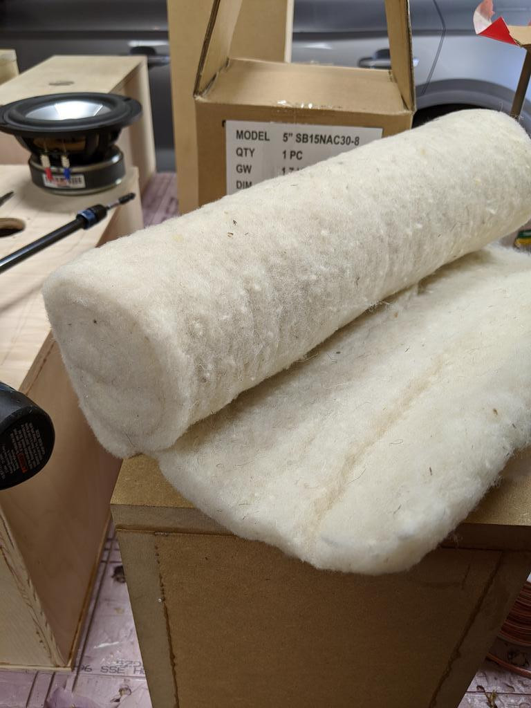

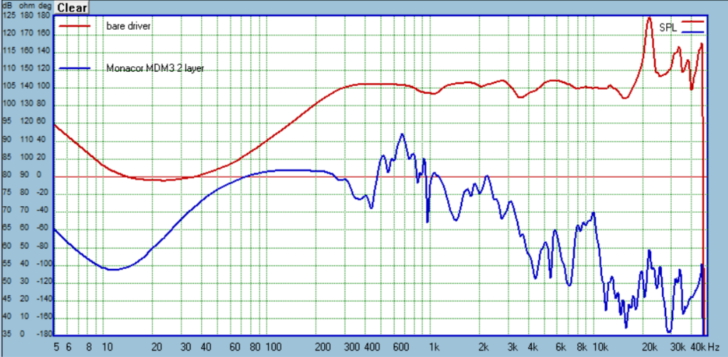

                                                          Initial box lining results!
                                                          Monacor MDM3 wool batting 2 layers
                                                          Looks like this isn't available anymore. About 1/2" thick batting of wool and IIRC poly. Given the performance of 2 layers (1") I would like to find a new source of wool batting, since my big complaint with the denim insulation is the amount of fuzz and fiber it gives off. Makes me worry it will get into the voicecoil of a driver.

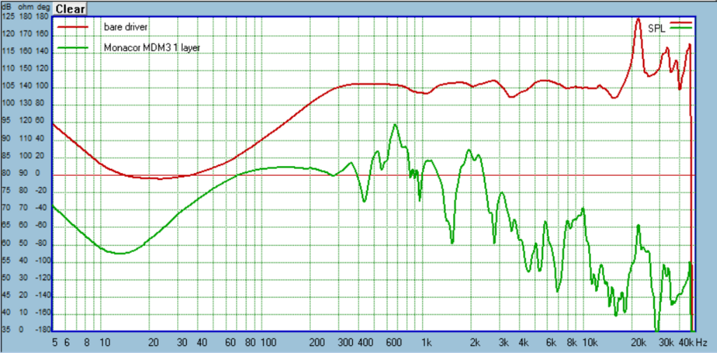

                                                          And 1 layer:

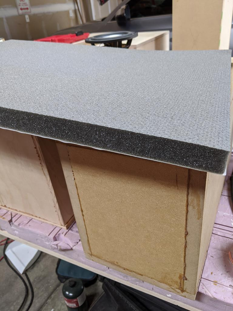

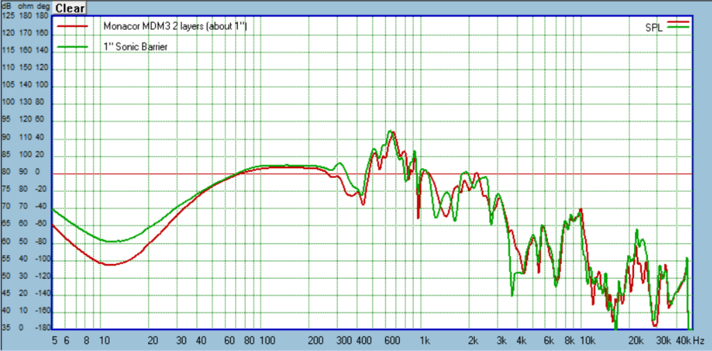

                                                          1" Sonic Barrier
                                                          From Parts Express

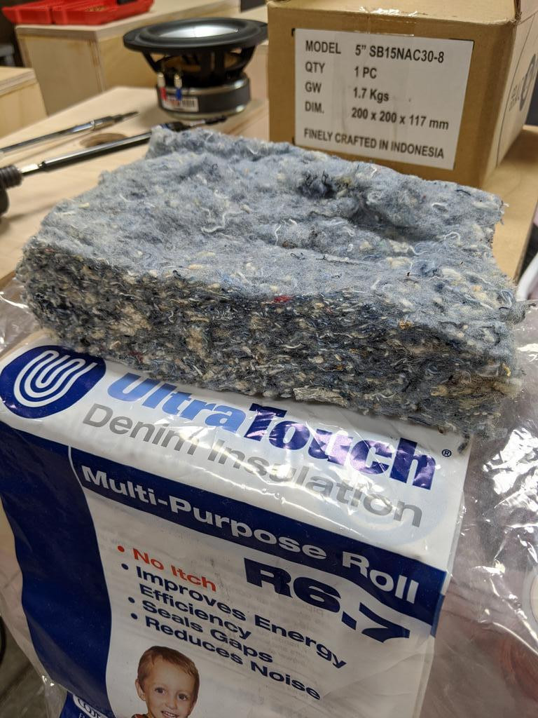

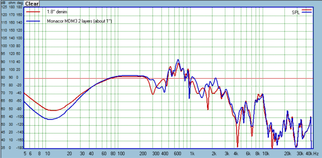

                                                          1.8" Ultratouch Denim insulation
                                                          Available at HD (and other places), reasonably priced, performs well. No wonder the popularity. Now if would just stop shedding so much stuff!

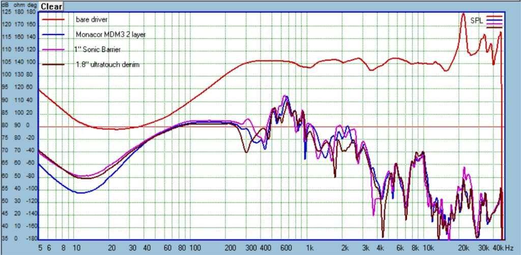

                                                          A comparo:
                                                          Last edited by theSven; 30 April 2023, 18:03 Sunday. Reason: Update image location
                                                          ~Brandon 8O
                                                          DriverVault
                                                          Soma Sonus
                                                            Thick is better
                                                            What I see is that the first lot of strong peaks are less pronounce with the thinner materials. It really does reinforce the idea that a thinner walled enclosure with damping might provide better results than thicker stuff. I guess it depends on what is considered audible.
                                                            The denim stuff gets a good rep and you can see why. Can't get it easily, like time I looked, in the UK, which is a shame.
                                                            • augerpro
                                                              • 1871
                                                              It appeared to me the main resonances were shifted lower in frequency with the thinner material, not so much lower in amplitude. Which makes sense if it is a function of stiffness. Same with MDF vs plywood. Plywood is stiffer (IIRC) so main resonance is shifted higher in frequency.
                                                              I think you are going to like the wool batting (for quilts) testing, should be easy to get in the UK. 3 layers of the above MDM3 would be 1.5", and I'm betting at least as good as the denim (1.8"). Wool batting for quilts is widely available, and I found a supplier who makes .8" batting, so two layers should perform well.
                                                              ~Brandon 8O

                                                                  From a response on another forum:
                                                                  Originally posted by hifijim
                                                                  Great work, Augerpro.
                                                                  The results at 400 Hz are a surprise to me. I would not have guessed that there could be a ~ 15 - 20 dB reduction at 400 Hz for all 3 of the stuffing materials. I would have guessed that a big 400 Hz peak for the empty box would have been a cabinet panel resonance, and stuffing would make little difference to a cabinet panel resonance.... but that is not what the data says. I don't believe this is a panel resonance, it is an acoustic resonance. This is why the stuffing materials have such a large effect.
                                                                  Notice between 650 and 800 Hz the bare box has a resonance, and this looks like panel resonance. The 3 stuffing materials have much less effect here... The MDM3 2 layer and the Sonic barrier foam are about 8 dB lower than the bare box, and the denim is about 10 dB lower. While this is more of a reduction than I would have expected for a panel resonance, it is far less than the 20 dB reduction seen at 400 Hz or at the upper frequencies.
                                                                  Another surprise is at 2 kHz. Here the surprise is the bare box... we have large resonance, it is the largest SPL resonance of the experiment. The magnitude of this resonance is as high or higher than the 650 - 800 Hz peak, which is shocking. I believe this is an acoustic resonance, because all 3 stuffing materials have a big impact. 2 kHz is in the region where most insulation materials have their strongest absorption. The foam and the MDM3 have a 20 dB effect, and the denim has a 25 dB effect.
                                                                  The fact that the data revealed 3 unexpected results shows that value of empirical data.
                                                                  Great analysis! I'm only right now going over the plots. Here is something to chew on, rear panel response (empty box) and dummy woofer response (empty box):
                                                                  I also modeled these in boxnotes. I now realize I'm not quite sure what the assumptions are for this program. Is the standing waves generated by the driver at the specified location in a given box, and the response measured (if you could) at that same spot? So looking at the boxnote of the source driver, would you necessarily expect to measure those resonances at the dummy woofer location? And the dummy woofer boxnote wouldn't be relevant at all because it is not creating sound?
                                                                  Last edited by theSven; 30 April 2023, 18:04 Sunday. Reason: Update image location

                                                                    Am I reading it wrong then that the 1/2" MDFs main peaks are about 5dB lower than with the 3/4?
                                                                    • augerpro
                                                                      • 1871
                                                                      huh, why yes they are at the primary resonance. I'll have to dig into this a bit more. Why would that be? I still see it in the plywood examples, but much smaller. I'm wondering if this might be a measurement artifact, specifically smoothing of the response to 1/24 octave, or even in the FFT due to the gate causing less resolution at lower frequency, so the peaks are smaller? I can process it with no smoothing and open up the gate.

                                                                        Hi Brandon,
                                                                        It looks to me like your boxnotes results help explain some of what is going on in post #33.
                                                                        The ~410 Hz resonance that is reduced with damping material is predicted by boxnotes to be a standing wave resulting from the inside height of the cabinet. The 410 Hz wave is 33 inches long and the inside height of the cabinet is exactly half that.
                                                                        I feel like your plot in post #18 also kind of bears this out. Although the frequency is shifted about 50 Hz forward, both the side and rear panel show a resonance here, but then differ elsewhere corresponding to the depth and width not being the same dimension.
                                                                        I also can't resolve in my mind how the panel resonances and acoustic resonances can be separated. There are only two mechanisms that drive excitation in the panels at their resonances: the first is the reactive force from the driver motor; and the second is the source signal creating standing waves at the acoustic resonances. Therefore we should expect some of the panel resonances to be addressed with damping as their genesis is an acoustic resonance, right?
                                                                        Awesome data so far!
                                                                        I'm still trying to wrap my head around all the conclusions we can draw from this as well.

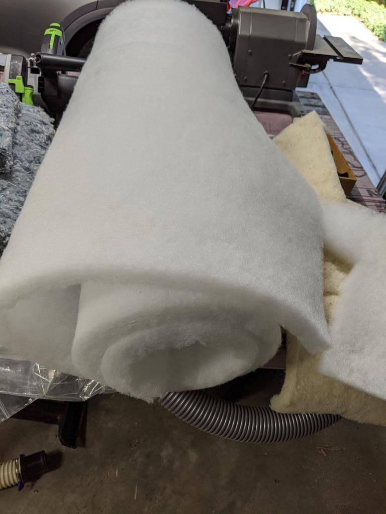

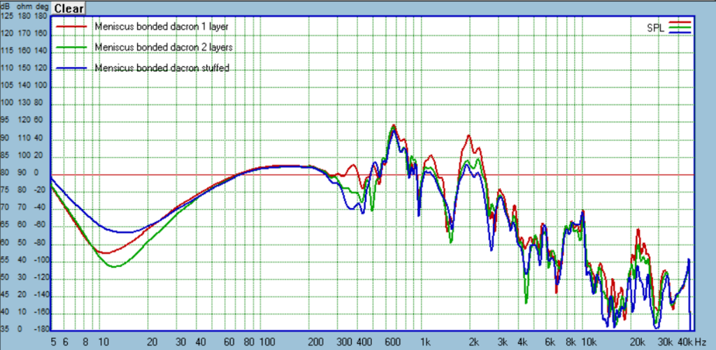

                                                                                Meniscus bonded dacron batting 1 layer
                                                                                2 layers
                                                                                Not great, but the reason I wanted to test this dacron batting was that it is very popular with the transmission line designers, who use it to stuff the first half of the line behind the driver, and this batting provides a consistent density. Here I stuffed the box:
                                                                                polyester pillow stuffing @ 1/3 of a pillow
                                                                                Last edited by theSven; 30 April 2023, 18:06 Sunday. Reason: Update image location
