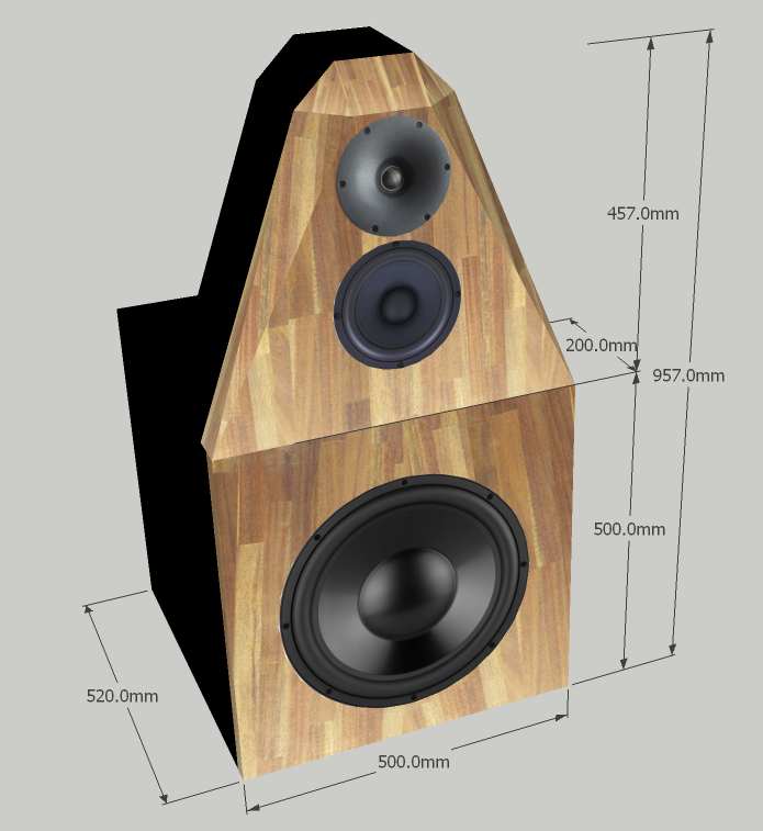

    I introduce The Cathedrals.
    They are an all sealed, active design. They are in the concept and planning stage but comprise the following:
    1 x Dayton RSS390HF-4 15" aluminium woofer
    1 x SB Acoustics SB17NBAC-4 6" aluminium as a midrange
    1 x SB Acoustics SB26ADC 1" aluminium dome tweeter
    The SB26ADC may be waveguide loaded, if the profile of the Visaton WG148R is suitable.
    Current crossover points are ~ 200hz and ~1900Hz.
    What I wanted over my current 3 ways:
    - Larger woofer. a 15" should move enough air.
    - Lower F3. The Dayton models ~32Hz in a 124L sealed enclosure. There's enough xmax and with an active crossover I can tailor the in-room response with xmax to spare.
    - Modular. I want to separate bass and mid/tweeter sections... such that I can replace mid-tweeter or have different options with the RSS390 filling in bass duties
    - Wanted to try a waveguide. This may not work in practice. I have a plan B if that is the case.

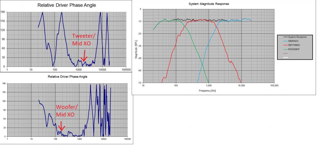

    - Try an active crossover. This will be using a Raspberry Pi, running ecasound LADSPA host and credit to Charlie Laub's Active Crossover Design tools to provide the ecasound filters.
    - An all metal design
    The relative phase graphs show the phase difference between driver pairs. I'm trying to get these <= 15 degrees at least 2 octaves either side of the XO points. More work required

        Interesting concept, the render throws me off a bit because of the scaling of the cabinets versus driver- 20" high woofer cabinet and 15" driver, for example!
          I have tested the SB26CDC in a few configurations, though not looked at it in a waveguide, due to adaptation challenges. In direct radiation, distortion does rise below 3.5kHz at 2.83 VRMS drive. A waveguide could reduce this... so could a DA25TX.
          Great spotting Jon. I accidentally got the diameter wrong! 264 somehow instead of 368. I also thought it looked a bit small!
          Thanks for the tweeter advice too
