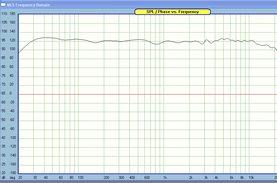

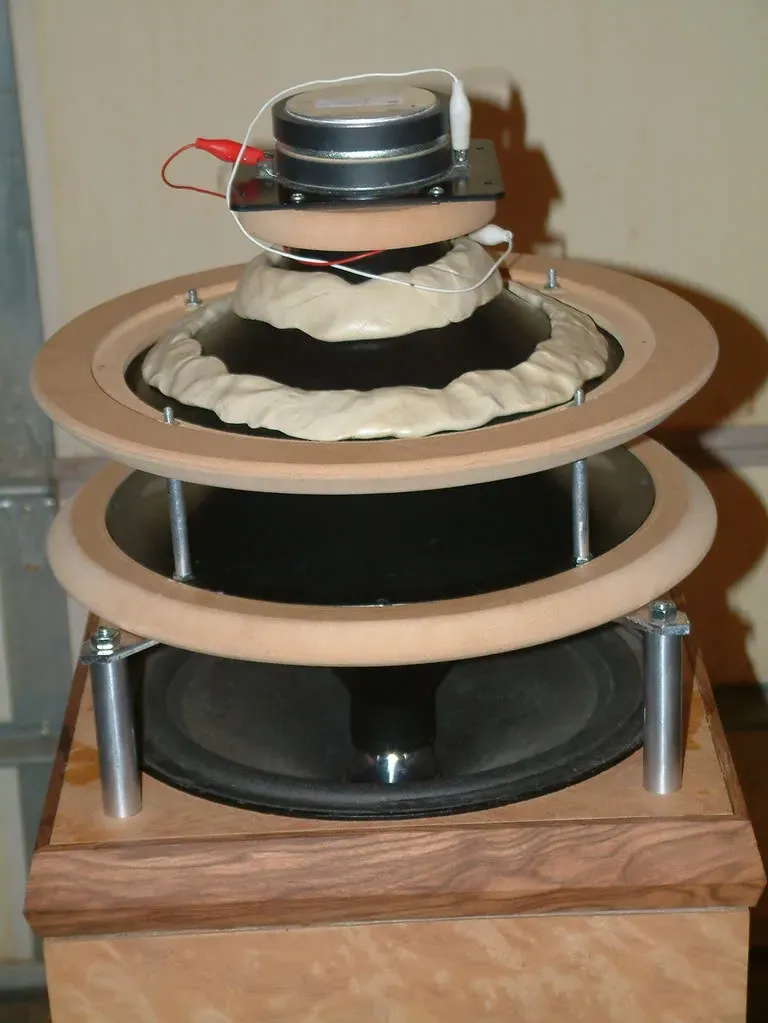

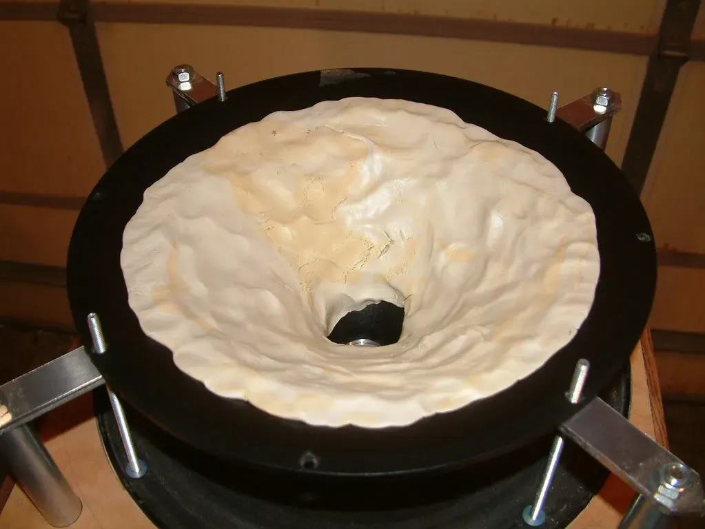

          I’ve been doing a little more on this design this weekend. First up, I tried out using plumbers putty for a dampening agent for the plastic waveguides. It is a sticky, soft, pliable clay-like material that is supposed to stay pliable for years. I applied nearly about 4 pounds of the 5 pound bucket to the two diffusers. I coated the inside of the diffusers with putty with between about 1/4” and 1/2” of putty over most of the surface. I have no measurement data, but it seems to do a great job of deadening the plastic so there is no ringing when rapped with a metal wrench and there is a significant lowering of the resonant frequency.
          Below is a picture of the inside of the bottom diffuser partially lined with the putty. I applied an equal amount to the top diffuser.

          The waveguide at the top will have a second waveguide set over top of it. In the photo below, you can see the recessed lip for the second waveguide. They are on backorder at PE until December 11th. In the interim, I applied some plumbers putty to this waveguide as well, though I’m not sure if this solution will work as a sandwich between the two parallel waveguides.

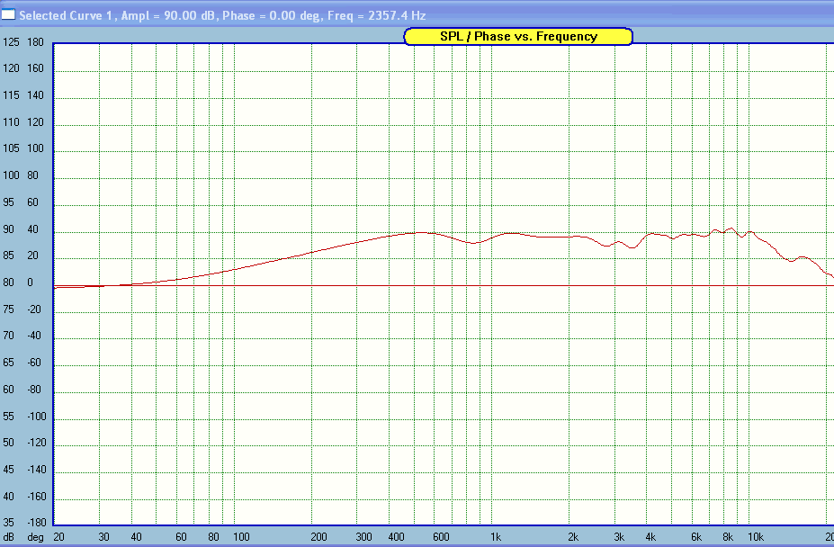

          I also did some additional crossover tweaking and as part of that effort, I wanted to see if I could find a way to lift up the drooping top end. This first graph is a farfield of the previous crossover that illustrates the drooping top end.

          The diffuser inside of the waveguide comes to a sharp point. It turns out, that if I place a little ¼” disc and place it over the sharp tip, I believe it acts like a phase shield and the result is a lifting of the top end. The graph below shows the improved top end. I think this can be further improved upon with more testing. I’ve also merged in a nearfield on the woofer and the port response here.

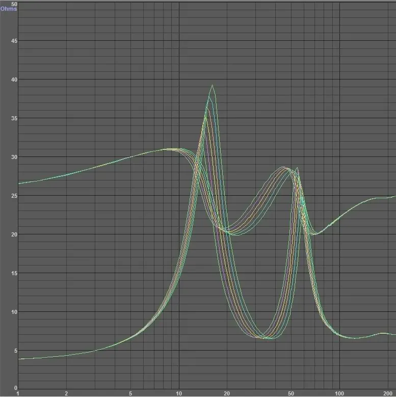

          Finally, I did some impedance measurements of the flexport to determine exactly the ranges of tuning available from port adjustments. This does not include the sealed tuning setting, since I had the cable that runs from the woofer to the XO going through the port, so it was not possible. The FB range available is from approximately 29hz to 39hz. These were taken in about 1" increments of length change.

                    Maybe counter-intuitive, but you might try a blunt diffuser that never goes below about 1/2" in diameter...or KEF style vanes.

                      Some nice looking curves there, Dan! Have you tried doing any distortion sweeps?

                        I have not done any distortion sweeps. Of course, these are very low distortion drivers to begin with, as you know and then equalizing the boost the waveguide/horn provides to the tweeter should reduce the tweeter distortion even more on the low end. However, I don't know how much distortion a horn configuration like this might impart in and of itself. Intuitively you would think there has to be some extra reflections going on, though it sounds very coherent.

                                Being a cabinet maker for a good part of my life, I've taken a few kitchens apart some old some not so old. Point being, plumbers putty usually dries up and crumbles/cracks after a few years so long term maybe not the best material for your purpose. Squid

                                    Dan, if you could find a way to seal it off from the air around it that would be great. I just had visions of chunks falling into the
                                    diffusers as it got older and dried out. There maybe another product with
                                    similar properties that doesn't dry out but dont know of one .

                                      Well, I can seal off the mdf with the finish to some degree. The waveguides are bolted to the mdf and I can use weather stripping to seal that interface. Perhaps that will be enough.

                                                I've been playing around more with the phase shield idea and I think this is about the best I can do with the top end. I've done a little more minor XO tweaking as well. The graph below is a nearfield on the woofer (setup in the sealed setting) merged with the farfield response of the combined woofer and tweeter.
                                                I started building the second speaker today. I don't think I can do any more on the crossover until I have a pair to listen to.
