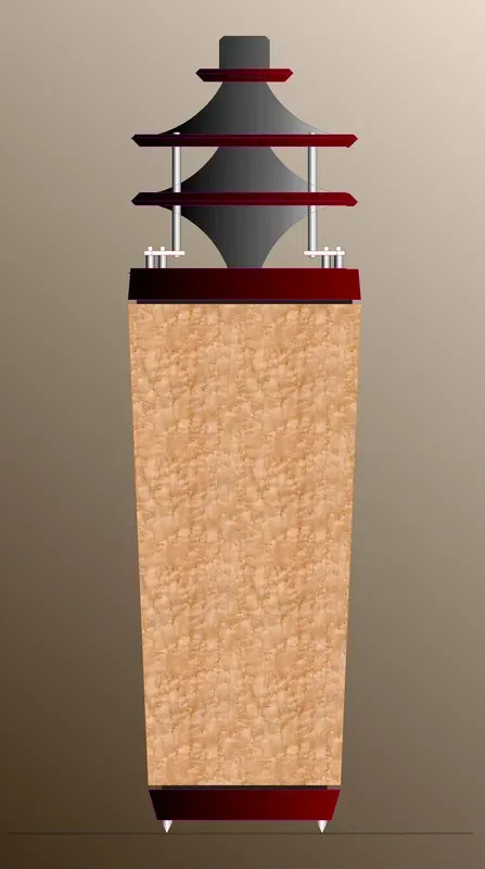

        Here is a conceptual of what I initially have in mind, though it could change.

          Almost looks like Asian architecture.
            • 1456
            My wife says the same thing. It's the pagoda look on top, for one thing. I may have to come up with an asian name!

              Looks pretty interesting- how stiff/steady do you think the deflector/waveguide assembly will be if the woofer is cranked up a bit?
                  It might depend on how much mass is added as I treat the waveguide/diffusers to ensure they don't resonate on their own. I'm leaning towards filling the bottom two diffusers solid. The top diffuser is probably going to be doubled up so I can fill the space between two of them stacked. I don't yet know what material to use for the fill, so any ideas are welcome.
                  As far as the supports go, I'll have to try all 4 of them to see how it feels. It may need something more solid. The prototype does not really seem to suffer and it is just sitting with the threaded rods warped a bit to fit into 4 of the woofer openings.

                  I have thought about making the rings larger and will definitely test it out. One concern is what happens to the response if the expanding curve of the waveguide/diffuser combo stops expanding and has a section with parallel sides. Some measurements should tell the story. My original intent was to thread the uprights into inserts just as you describe.
                  If I keep the current mounting system, I do plan to use larger uprights than those pictured. These just happend to be the ones I had at hand that fit without cutting them down. Larger dia. uprights will naturally increase rigidity and would look a little more balanced.

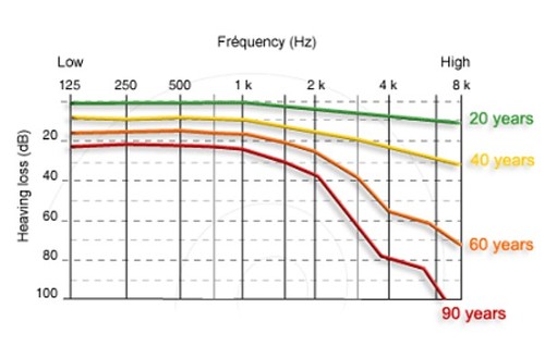

                                                                  Yeah that chart looks to be rather exaggerated, down almost 40dB at 8khz at 40 years old? I don't believe that for a second lol.

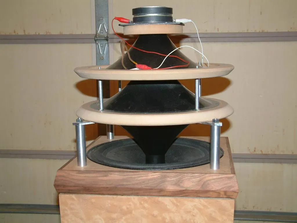

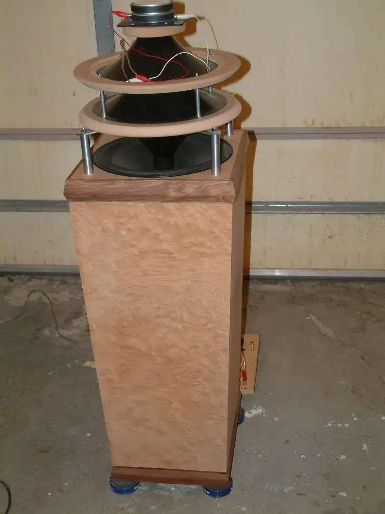

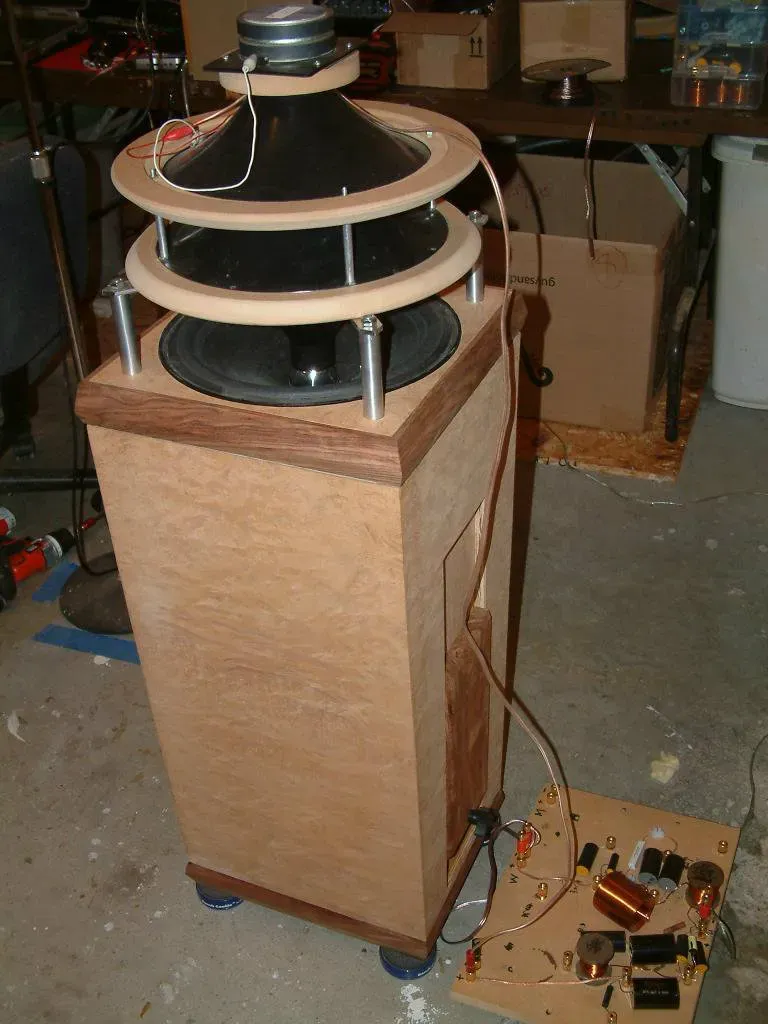

                                                                        I'm a bit behind on updating this thread. I decided to start building the final design since the waveguides are on backorder until 12/11 and I need another 4 of them to complete a pair of speakers (unless I go another route - more on that later).
                                                                        I got all the parts cut out for a pair, but went ahead and built one of them so I could take it to the Kentucky DIY event. It is probably 75%-80% done from a construction standpoint. I still have to do all the finishing and fix one mistake on the woofer box. The tweeter/360 horn is still in raw form, unfinished and without any resonance control in place for the plastic parts. I've decided how I want to mount them, which is shown in the photos below. I've included an adjustable flex-port like I used in the Chameleon's. You can this on the shot of the rear side. I still have a lot of little veneering to do on exposed edges before I get to sanding and finishing. The veneer is a burl maple with trim of Chechen. There is no finish applied at all so far.
                                                                        The crossover has seen numerous versions. I initially had a fairly simple XO and then went to a more complex version that added parts primarily to improve phase tracking. I discovered that the version I took to the Kentucky DIY had one cap of a parallel set on the tweeter disconnected. Seeing this, I just decided to start over and have totally reworked the design. It is sounding very good to me again after the change. The parts are just cobbled together from what I have on hand. I'll probably do away with the use of Pcores in the final version. Also of note, the Transducer Labs N26C-G I'm using will be changed to the new round faceplate version of it when they come out later this year, I think. The round faceplate will make it easier to integrate into the look of the speaker and the new version is expected to have increased sensitivity by a couple db. Currently, I have no resistor in the tweeter XO, so a little more sensitivity could be beneficial.
                                                                        I may end up having the entire waveguide/diffuser/horn turned from wood. Another PE Tech Talk member and I are discussing it.
                                                                        I didn't take any photos during the construction of the speaker pictured below, but intend to do so when I build the second speaker.
