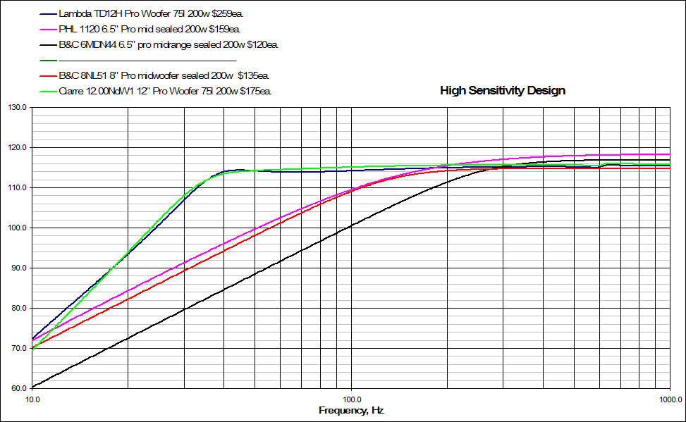

    Goals:
    My goals are to do a similar high sensitivity design, with open baffle mid (or perhaps open back mid as a second choice). The Salk speaker is quite large at 15” wide x 46.5” high and I would like to make a smaller front mass to the design as well (or my wife won’t let it stay in the main listening/HT room). I’m thinking a tapered design so that the mass of the speaker is lower in the box and less intrusive in the room (see mock up below). The concept design I have below has a 76L net woofer enclosure and the size is 16” wide at the bottom, with 5º tapered sides up to a width of 8.5” at the top. Of course, the baffle width on the open baffle mid will have to be sized as needed to work at the intended crossover frequency and I have not even begun to consider that. The height of the speaker is 43” and the depth is about 18” at the bottom. I envision an 8º sloped front baffle on the woofer enclosure, with a vertical open baffle on the mid/tweeter that is separated from the woofer baffle. This arrangement allows the drivers to be approximately time-aligned. I have also attached some preliminary drawings of the speaker(see the attached pdf). Depending on the tweeter chosen, I could possibly do a shallow waveguide mount for it, like I did in my Duo design and as proposed by Zaph for using the D26NC55.
    Drivers:
    The drivers of the Salk/Bagby design run in excess of $1100/pair, as far as I can tell. I would like to reduce that substantially, without losing too much in either sensitivity or sound quality. Here are the possible drivers I’ve come up with to consider.
    Woofers:
    Lambda TD12H 12”: $259
    Ciare 12.00NdW1 12”: $175
    Midrange:
    PHL 1120 6.5”: $159
    B&C 6MDN44: $120
    B&C 8NDL51: $136
    Speaker parts, woofers, drivers and crossovers for replacement or upgrade. A complete line of products for DJ’s, Bands, and Sound Reinforcement. Repair your old speaker systems with Genuine Eminence Parts. A better product for less.
    Tweeters:
    Seas 29TFF/W (H1318), 92.5db: $44
    Peerless HDS 810921, 93db: $78
    Peerless DX25TG05-04, 93.5db: $28
    http://www.madisound.com/catalog/product_info.php?manufacturers_id=149&products_id= 1591
    http://www.madisound.com/catalog/product_info.php?manufacturers_id=143&products_id= 1744
    It’s unclear on the availability of several of these drivers. I have attempted to make email contact on the Lambda and have not heard anything back. The Ciare is listed as available at Assistance Audio, but I have not confirmed that. The Peerless DX25 and HDS are listed as not in stock at Madisound, though the DX25 appears to be avaialable at PE under the old Vifa name. Below is a graph from some quick modeling in Unibox with the woofers and mids at 200w input. The Ciare is at xmax at this point and the Lambda still has a lot of room to move, however, we are at over 114db spl at this point and for HT you really need a subwoofer to handle below 40hz with either of these drivers. I’m leaning towards the Ciare since it is appears to be comparable in performance, yet would save $168. The PHL mid might be hard to beat. The B&C 8NDL51 seems to be well thought of, but I’m not sure if it can be crossed in the 2.5-2.7khz range needed to work with a dome tweeter at high spl. The 6MDN44 might work, but I have not read of anyone who has used or measured this driver. I’ve not used any of the tweeters listed, but was looking for models with relatively low distortion, but with high sensitivity and these are what I found so far that were less expensive than the Morel. If the drivers selected were the Ciare woofer, PHL mid, and Seas tweeter, the driver cost will have been reduced to about $754/pair, which is a very good savings, if SQ is not compromised to significantly.
    Ok, I’ve presented my thoughts and ideas and I’d like to hear from others what they think of the concept, the drivers or others they might suggest, etc. What do you all think?

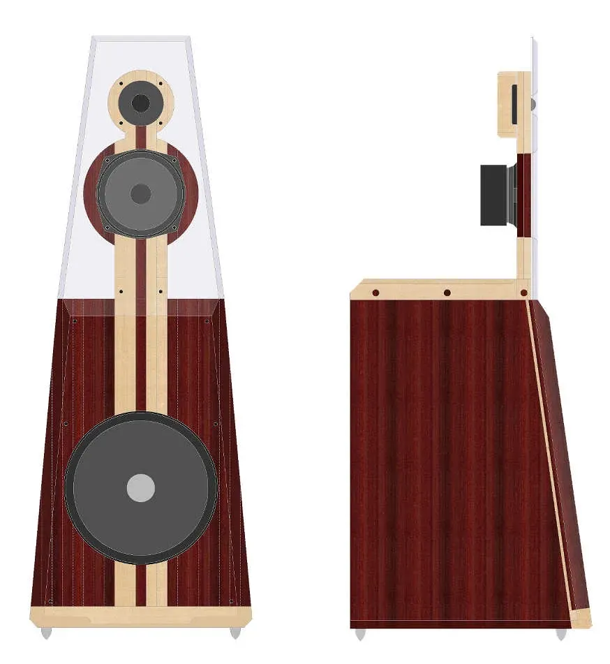

    This was edited to show the final concept version below:

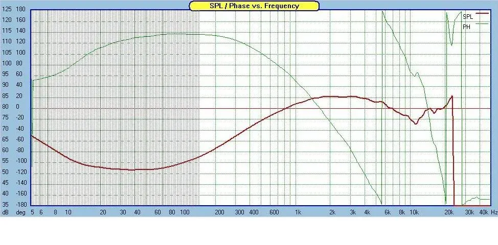

                                                                  Could I get a little crossover education? I'm looking at the frequency response of the PHL driver and an RS180:
                                                                  The RS180 is pretty flat up to 2-3khz, it makes sense to me how to design for this driver (at least I think I understand it). While the PHL has a big hump from 500hz to 1700hz, but is then fairly flat to ~3k. How do you deal with that big hump in the midrange?
                                                                                    Click image for larger version  Name:	PHL%201120%20near%20FR.gif Views:	0 Size:	14.2 KB ID:	941059
                                                                                    Click image for larger version  Name:	DaytonRS180MLSSS.jpg Views:	0 Size:	47.3 KB ID:	941060
                                                                                    The measurement you posted for the PHL says it was made at 1" nearfield. measurements above the low bass range are not accurate at this nearfield distance. My PHL's measured nothing like the response shown here. I work with measurements referenced to one meter, which are much more applicable for crossover design. The RS180 measurement on the other hand is at one meter, but then again, it needs to be taken on the baffle to show the baffle effects included so those can be dealt with in the design. I am working with the RS180 right now in a pair of powered studio monitors for a friend's recording studio, and the PHL is much flatter than the RS180 in the range I used it in.
                                                                                    Jeff B.
