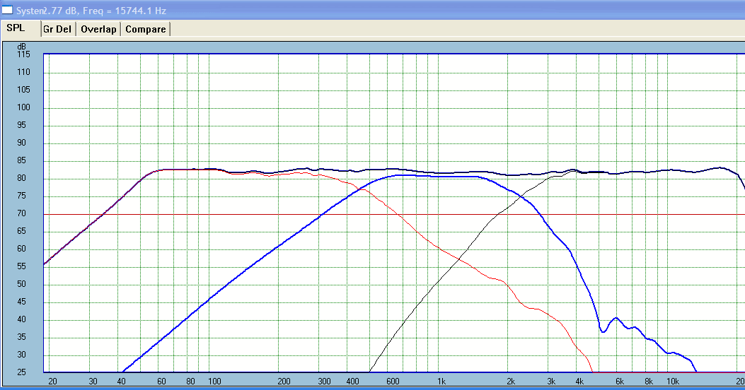

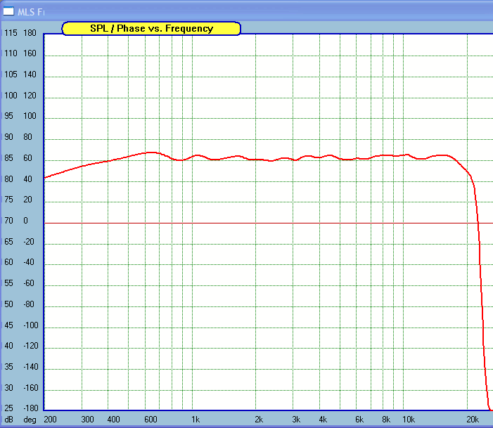

                            Here is an update to my progress. I now have a pair of prototypes with crossovers and I'm starting the "voicing" process on the design with the B&C mids. They are now in my living room to be used for both music and HT for tweaking purposes. This is the room they will eventually be in. I will still be looking at the Lambda mid as well.
                            Below are a few graphs illustrating where the design is at. It is using the 1/2" deep waveguide with a 1/2" roundover on the tweeter. The plot showing all three drivers is the on axis simulation in SoundEasy. SPL levels are not calibrated to real world levels. The single plot you see is the measured FR with a 5s gated window at about 8', so anything below 600hz or so is not accurate, in fact there is a bit of first relfection anamolies showing up in this plot. This is a plot at 15º off axis, which is the intended design axis, so they don't need to be toed in too much, if at all. Also included is a measured plot of the impedance/impedance phase.
                            Dan N.

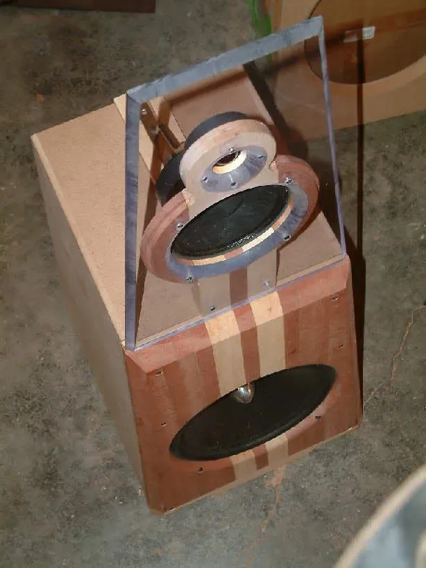

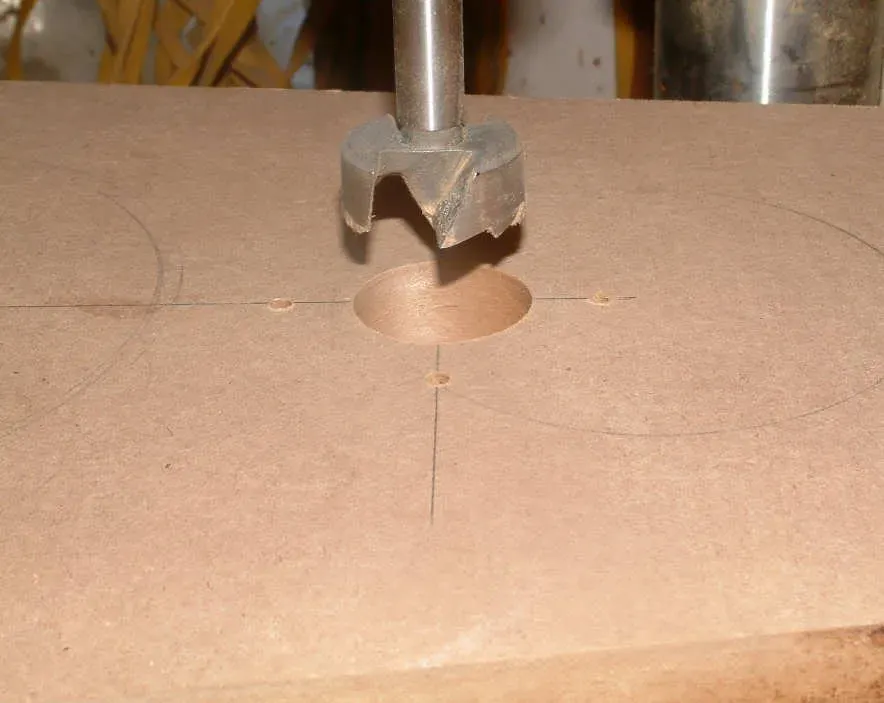

                                      Here are some photo's of implementing the rear mounted Peerless HDS in my ptototype mdf baffle, with the front screw mounts. I used the removed tweeter face plate to mark holes for the screws to go through the baffle and into the tweeter body. Here are a series of photo's:
                                      Double sided tape on the tweeter face plate to hold it in place. Disregard the circles drawn in pencil on the mdf. That was the old tweeter position, which has been moved 1.5" closer to the mid to improve vertical lobing.
                                      The for holes for the tweeter mount were drilled, then the center hole was located by connecting lines through the holes and a center hole drilled for using the Jasper guide.
                                      Jasper circle guide used, to recess a hole for the tweeter at the back of the baffle at a 1/16" depth for an 11/16" deep waveguide. The center of the recess is left intact at this point for the 3/4" roundover bit that will be used in a later step. A simple 1/4" width slot is cut at the tweeter body dia. to form the outside of the eventual full recess.
                                      1-5/16" dia. hole drilled through the mdf, using the center hole as a guide to form the sides of the waveguide, using a forstner bit.
                                      This is shown for the midrange hole, but the same process is used for the tweeter waveguide. The depth of a 3/4" roundover bit is deeper than 3/4" to the bearing, so you have to have a equivalent size hole in a dummy piece of mdf, mounted behind the finished piece to act as a guide for the bearing of the roundover bit to run along. I again used double sided tape to stick the two pieces of mdf together and provide the guide for the bearing. The same process was used on the tweeter hole, but with a 1-5/16" hole.

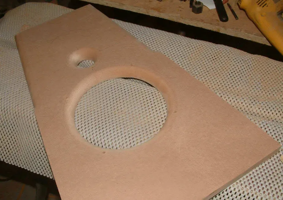

                                      Next up is a shot of the front of the baffle after both the woofer hole and tweeter waveguide 3/4" roundovers were completed:
                                      Here is a shot of the back of the bafle with the full recess removed for the mid and tweeter. The mid was roughly done here for the prototype. I would use a template in the finished version. Note the additional recesses drilled for the tweeter binding posts.

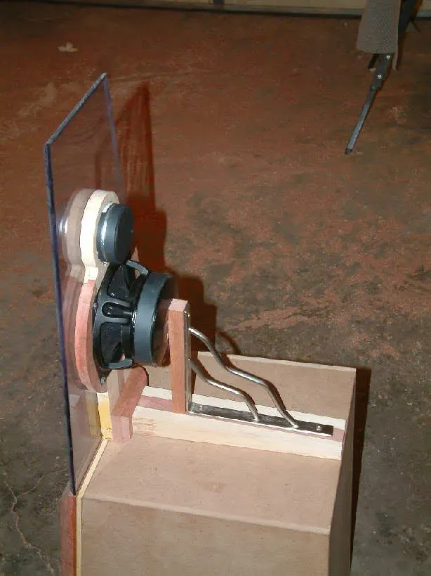

                                      Drivers mounted:
                                      Finished prototype baffle, tweeter moved 1-1/2" closer than previously, both drivers mounted from the rear at a depth of 11/16", with a 3/4" roundover. Counterbores were drilled for the screws to recess them below the baffle. In the finished version, this will allow for 7/16" of Lexan, backed by 1/4" of hardwood for an 11/16" depth on the drivers. That is the reason for the 11/16" deep mount in the mdf. The result will be that you will only see the driver opening from the baffle side and none of the tweeter or woofer flange will be visible through the Lexan. Also, as you can see, I'm thinking of doing a combination of 3/4" roundover and a chamfer at the baffle edge. I will also be testing a chamfer for the midrange hole, rather than the roundover.
                                      Last edited by theSven; 20 June 2023, 06:30 Tuesday. Reason: Update image location
                                      Dan N.

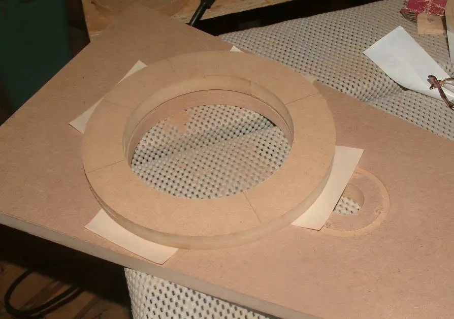

                                            Wow, good work. How did you make the PHL woofer routing, you write you did not used a template. How do make the template?
                                            Lexan baffle? How do you plan to mount this on the bas bin?
                                              • 1456
                                              #382
                                              Well, I didn't know how to make the template, but I figured something out that worked. Its kind of hard to describe, however and thee me be a much easier way to do it. BTW, I'm using a B&C 6md38, not the PHL, but it has that same odd shape.
                                              Here is what I did to make a template. First I mounted the driver to 1/4" hardboard (or plywood, Luan, etc.). Then I taped up the driver openings on the back so dust could not get into it. I mounted a flush trim bit in my router table and with the bearing riding on driver frame, I cut out a piece of the 1/4" hardboard that was the size of the driver. Then I used that cutout and attached it to a piece of 3/4" mdf. I then used the smalles bushing in my router buching kit with a 1/4" diameter bit and using the cutout as a guide, cut out a template that was approximately 1/2" larger in diameter than the driver size. This was tedious and I only cut the template out at about 3/16" depth at a time in order to make it possible to follow the cutout with the bushing and not wander away from it. Once that was complete I now had a template about 1/2" wider than the driver cutout. I then used the largest bushing in my kit, with the same 1/4" bit to run along the 3/4" template as a guide to cut out the driver hole. I hope you can follow that explanation! pictures would have make it much easier, but I didn't take any of the process.
                                              The Lexan will be backed by 3/4" hardwood surrounds that the woofer and tweeter will be inset into from the back. The drivers will be mounted from the rear and the hardwood is sandwiched in between the drivers and the Lexan and bolted from the front, thought the Lexan and hardwood. There may end up being a couple other places where the Lexan is bolted to the hardwood backer. The hardwood backer will have legs attached to form the 86º inside angle (resulting in a 4º tilt to the baffle). The legs will be glued to the upright 3/4" wood section and may be augmented with a triangular wedge at the base of the baffle. You can kind of see this concept if you look at the latest color mockup I posted awhile back.
                                              Dan N.
                                                #383
                                                Sounds like you did what was described here (with pictures): http://www.exquisiteaudio.com/baffle.html
                                                Works great
                                                  • 1456
                                                  #384
                                                  Well, that is close to what I did, but that method is probably a little easier. Thanks for the link. I will try it that way next time. :T
                                                  Dan N.
                                                  • TacoD
                                                    • 1080
                                                    #385
                                                    Thanks for your explanation! It looks like it takes some fiddling .

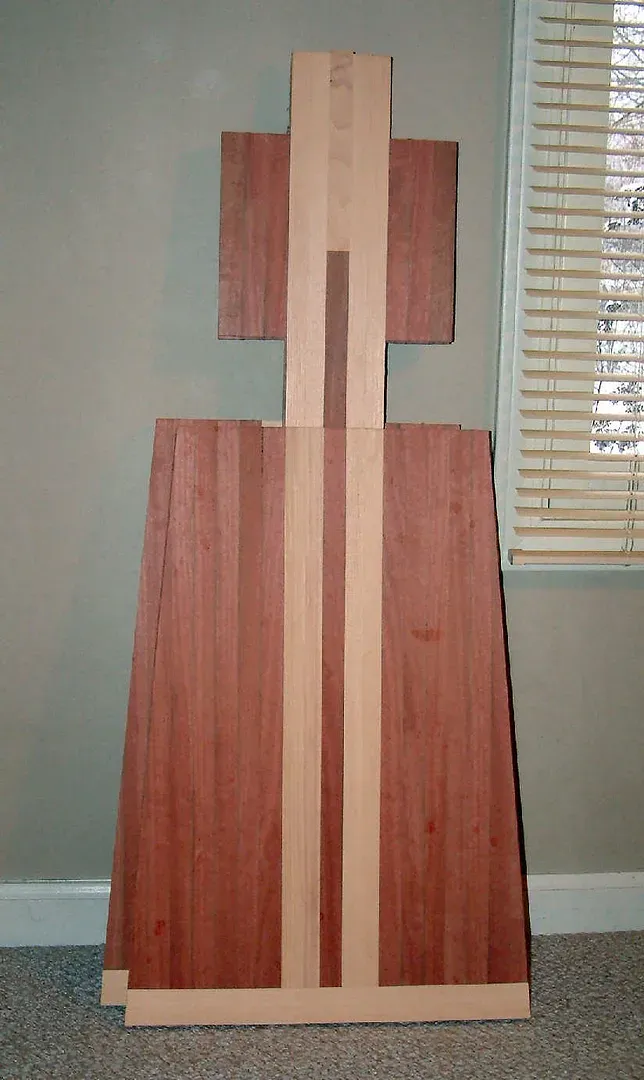

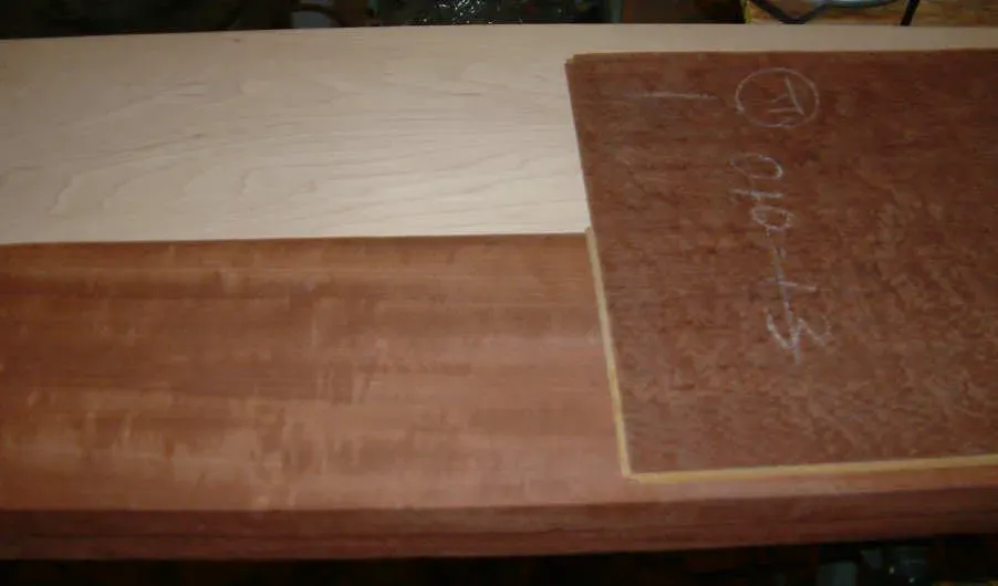

                                                      After a 5-6 hour round trip to Shawn's neck of the woods, Union City Indiana, I now have the hardwood I will be using and the veneer.
                                                      I visted Frank Miller Lumber, which is a hardwood lumber company that has a great selection of hardwood and also hardwood plywood, all at very reasonable prices.
                                                      I took three samples of veneer with me to see what matched best, Burl Maple, Curly Walnut and and unknown darke red veneer that looks to be a Pomelle, all wood backed. After talking to the guys there and comparing the veneers to the hardwoods, we determined the dark red one to be Makore Pomelle. To match up with that veneer, which will be used on the boxes, I purchsed some Makore and Hickory. Below is a picture of the three together. These boards will be ripped and laminated on edge, so you won't see this side, but the egdes when the baffle is glued up. The bass bin baffles will be laminated to 1-1/2" thick and the hardwood portion of the open baffle 3/4" thick, making it about 1-1/4" when you include the Lexan on the front. I was warned to absolutely wear a respirator (not a dust mask) when working with the Makore (or just about any exotic). I got 10bf or Hickory and 12bf of Makore for about $100. Try getting something common like walnut, cherry or maple at Lowe's or Menards, etc. for that price!
                                                      So, Hope to start on the hardwood baffles for the bass bins and the hardwood/Lexan open baffles soon, perhaps next weekend.
                                                      Last edited by theSven; 20 June 2023, 06:33 Tuesday. Reason: Update image location

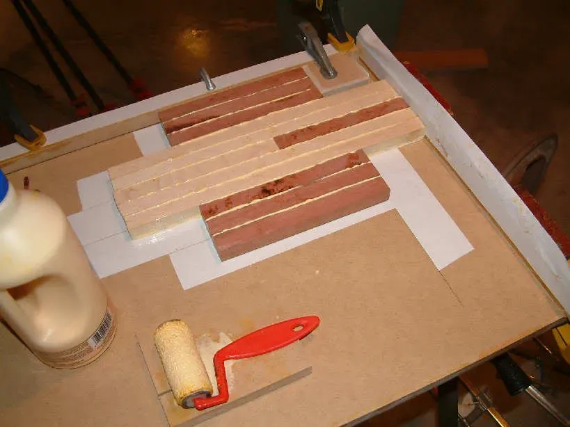

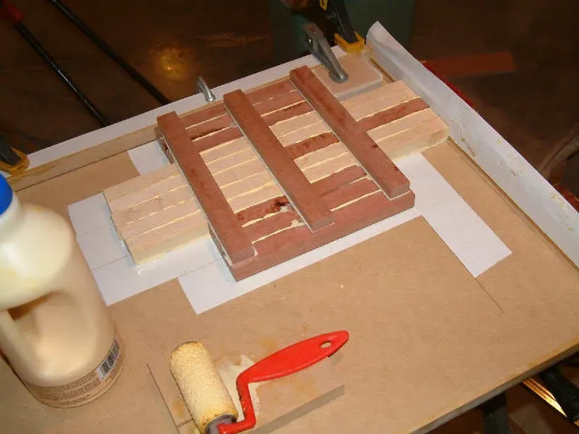

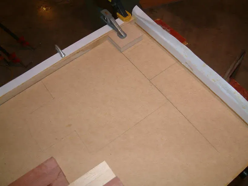

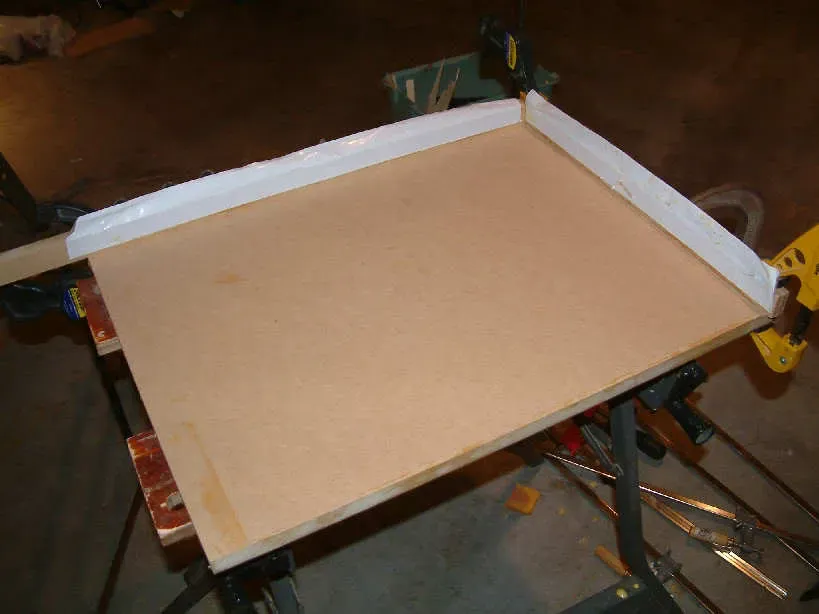

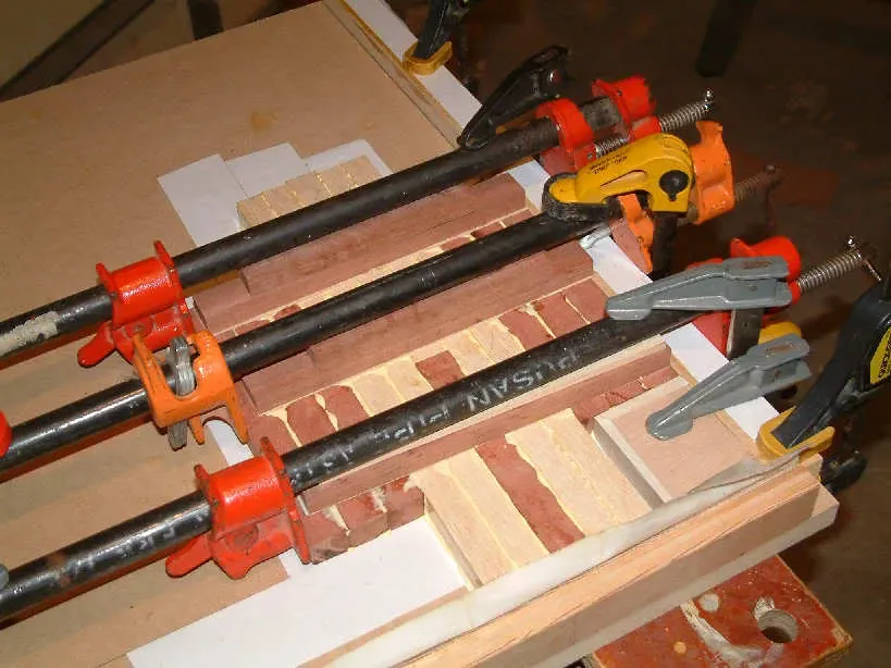

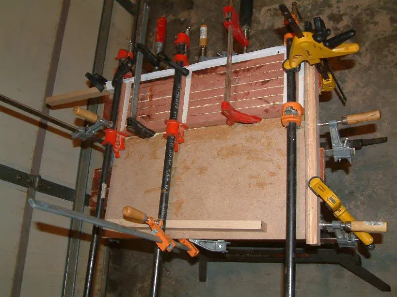

                                                        I’ve been working on the laminated panels for the bass bins and MT section. I didn’t want to take the time and trouble to do a bazillion biscuit joints so I created a little base to allow me to do a simpler edge glue up, using a combination of bar clamps and c-clamps. The bass bins use a ¼” hdf backing and 1-1/4” ripped stock, edge glued and glued to the ¼” backer, for a total of 1.5” thick. The MT section is ¾” ripped stock, edge glued only. Here are a series of photos showing how I set it up and some of the bass bind baffles. I will follow this post with a step by step for the MT baffles.
                                                        Up first, I used a piece of ¾” mdf and clamped side pieces to use as stops to forming the laminated panels. Double sided tape was placed on the side boards so glue would not stick. The side pieces were ripped a little smaller than the laminate depths.

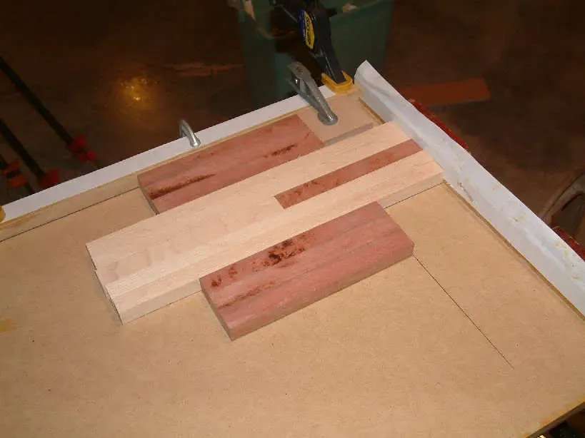

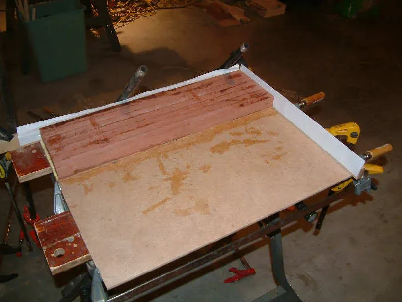

                                                        I started with the bass bin baffles. I decided to do them in 3 sections because I was concerned glue would start to set before I got all the pieces in place. Here is the first section glued and clamped. The jaws of the bar clamps are too deep, so spacers are used between the bottom of the bar clamps and the laminated pieces (w/double sided tape on the bottom of the spacers). The spacers allowed c-clamps to be used on each side of the bar clamp to press the laminated pieces flat and against the ¼” hdf backer.
                                                        Here is the first section dried, the clamps all removed and some of the excess glue removed.
                                                        I did not take photos of the other two sections being added, but the same procedure was used. Once they were glued up, I cut them to an oversized shape of the finished baffle and glued the two bottom pieces of the baffle on. You can see this in the final pic in the next post.
                                                        Last edited by theSven; 20 June 2023, 06:34 Tuesday. Reason: Update image location

                                                          Here is a more step by step for the MT baffle. In this case, there is not backer piece, so they are only edge glued. I added a stop block inside the side pieces to allow me to correctly space the varied sized pieces of the baffle correctly in relation to each other.
                                                          Next the baffle pieces are placed to allow me to determine the outline of the baffle and draw pencil lines around it.
                                                          The pencil lines were used as a guide to place double sided tape on the base so that the laminated pieces would not adhere to the mdf.
                                                          Here the laminated pieces have been edged glued.
                                                          Here the spacers were again added to allow the bar clamps to be clamped down on each end so the laminated pieces would glue up flat.
                                                          Here are the clamps all in place.
                                                          I decided to make it easy on myself and once everything was glued up and dried, I took them to a local hardwood mill and had them sand them down to smooth out any irregularities and remove any saw burn marks, etc. Here are the sanded results. The bass bin baffles were sanded on only one side, the MT baffles on both sides. I will mount the bass bin baffles to the box and probably trim them to size with a flush trim router bit.
                                                          Last edited by theSven; 20 June 2023, 06:38 Tuesday. Reason: Update image location

                                                                              We have a speaker (almost)
                                                                              Here are some updates photos. It's starting to come together nicely.
                                                                              Last edited by theSven; 20 June 2023, 06:40 Tuesday. Reason: Update image location

                                                                              • Jed
                                                                                • 3621
                                                                                #399
                                                                                Words can not describe the beauty of that one Dan... keep the pics coming.
                                                                                  • 1456
                                                                                  #400
                                                                                  Thanks, Jed.
                                                                                  One question I'm still considering is whether to leave the cut and/or routered edges and roundovers on the Lexan rough or try and smooth them out. Right now they are unsanded. I'm sure they could be smoothed out if sanded and perhaps there is a way to polish the edges.
                                                                                  I've experimented with heating some scrap edges with a propane torch and it essentially melts it slightly and makes it smooth and clear, but it is very easy to overheat and make it bubble.
                                                                                  Dan N.
