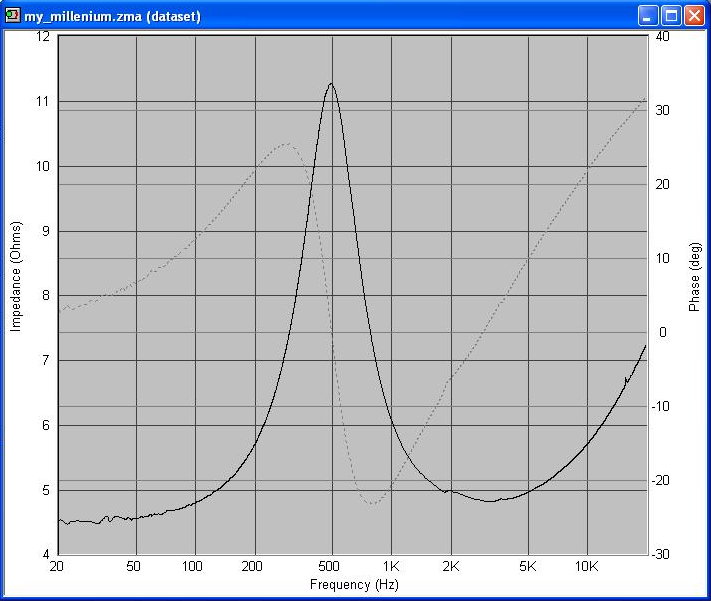

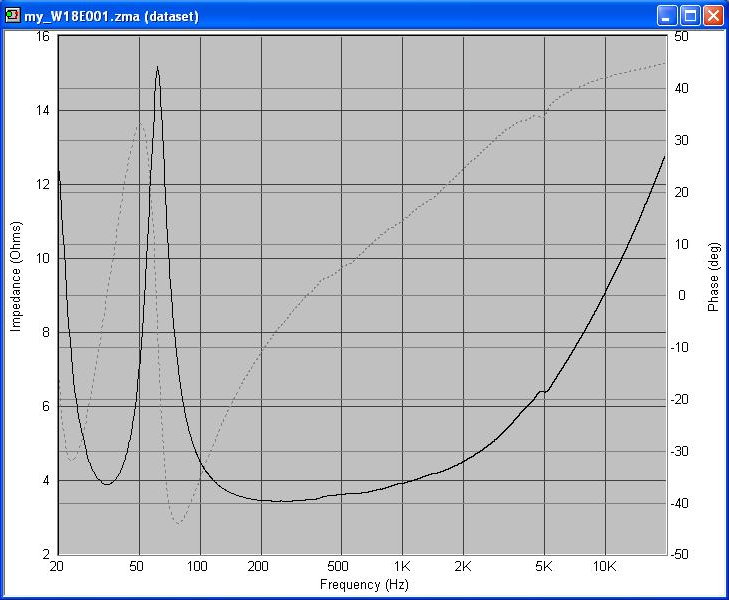

                                            Here's the measured impedance for both the millenium and the W18 pair in my 1.2 cu/ft box tuned to 35 Hz, with polyfill.
                                            If you don't want to measure yourself, I can also get you gated FR measurements after next week. I'll be on vacation starting tomorrow. My baffle width is just shy of 10 inches so I believe it's a tad wider than your's so there will be a small amount of baffle diffraction error relative to your boxes. Again though, it would be ideal for you to get measurements of your particular drivers in your transmission line box.

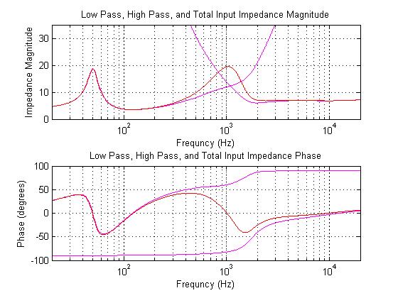

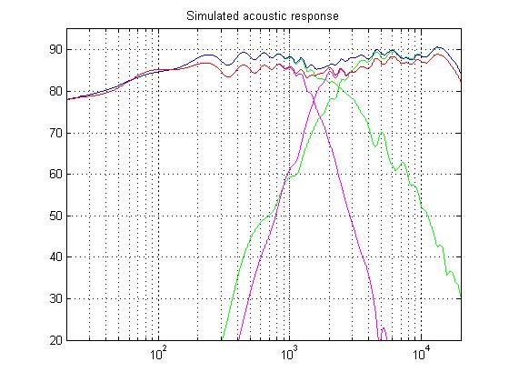

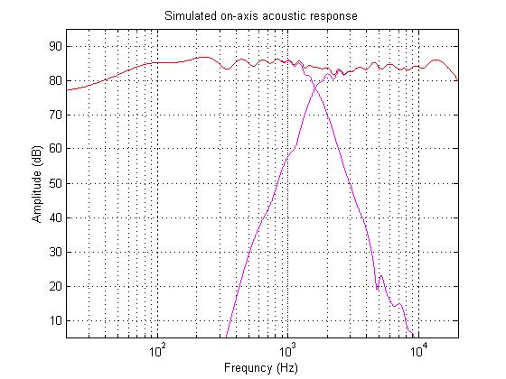

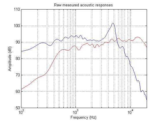

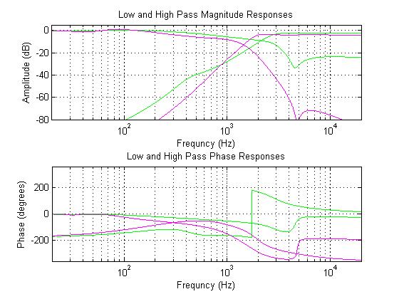

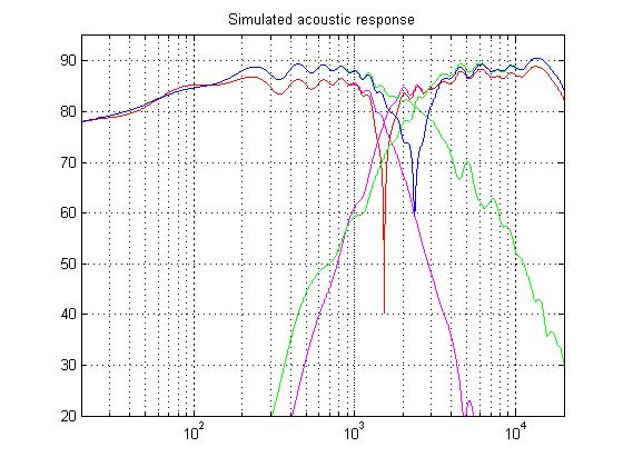

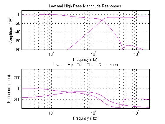

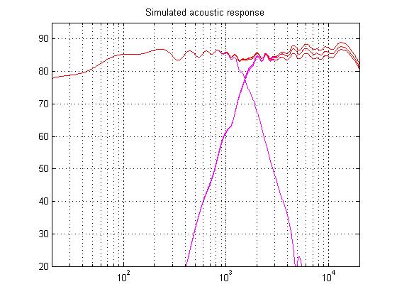

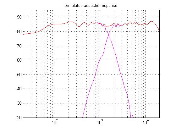

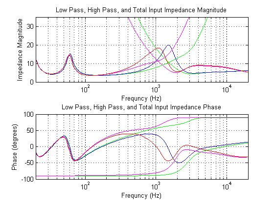

                                                I've finally measured my Odin's and designed a crossover topology. I did all the measurements using ARTA/LIMP software, using Behringer 802 preamp and ECM8000 mic. FR measurements were done in gated impulse response mode. The design was done using Matlab with the imported FR and impedance data.
                                                The attached jpg images show how my design compares with the original Odin/Thor design. In the impedance, electrical response, and acoutic response graphs, the blue/green traces are the original Odin responses and the maroon/red traces are my new design.
                                                I've crossed at about 1500 Hz with high Q fourth order acoustic rolloffs, increasing beyond fourth order as the attenuation increases. The woofer circuit is third order with an additional 4.8 kHz notch circuit. The tweeter circuit is fourth order electrical. The metal cone breakup at 4.8 kHz is now 60 dB down. I've designed for a full 6 dB baffle step.
                                                I'm using the ECM8000 mic uncalibrated. I believe it is up a couple of dB starting at around 5kHz, which is why the tweeter response looks like they do.
                                                The final plot shows how the tweeter level can be modified by changing a cap value in parallel with the tweeter. Values of 3 uF, 4.7uF, and 7 uF are shown.

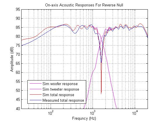

                                                  I've attached the text file containing the Matlab code for the design. The crossover topology is contained within.
                                                  I've also attached a final plot showing the reverse null for both the original Odin crossover and the new design.

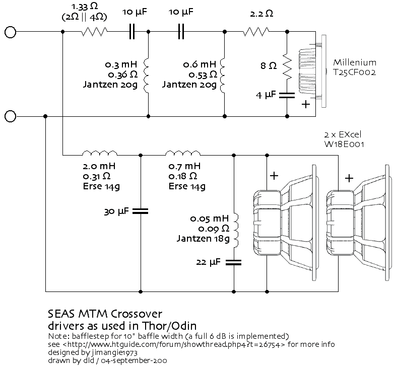

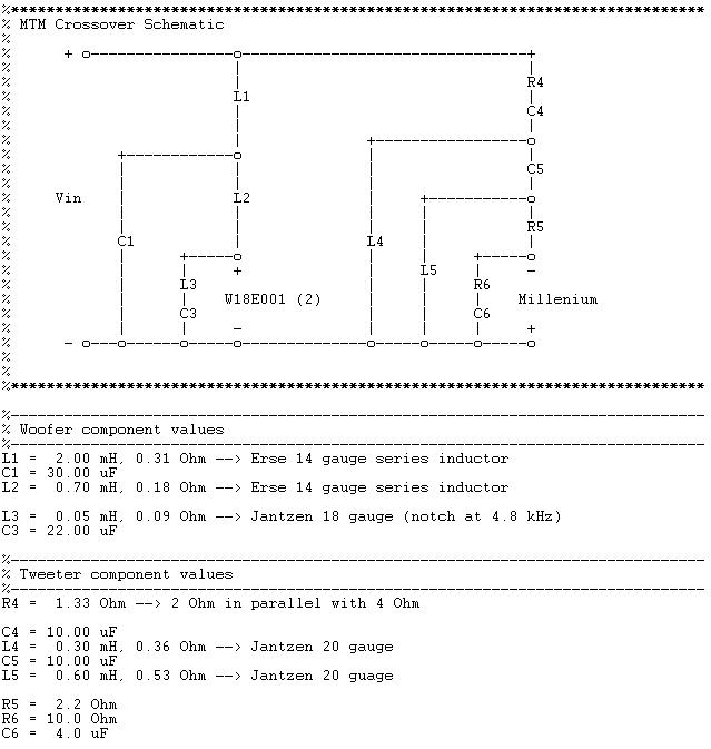

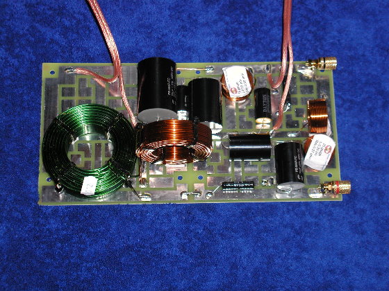

                                                                  Well I've got one crossover completed and have done some simple tests on it. Frequency response, reverse null, and woofer response all look good. It sounds decent as far as I can tell with only one speaker. Hopefully I can get the other build tonight. I've attached a picture of the crossover assembly on the Madisound double matrix board.

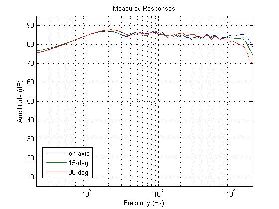

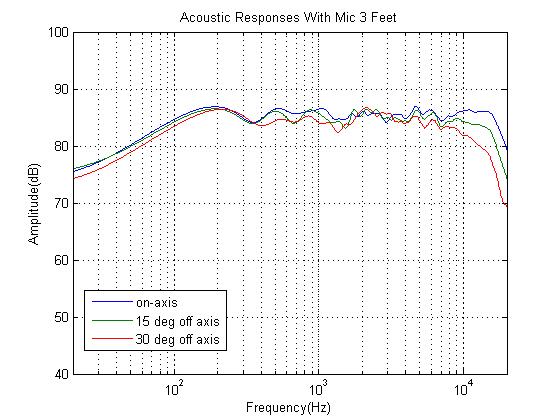

                                                                    I've attached frequency response measurements for the current crossover. I did the measurements with the mic at about 3 feet.
                                                                    There's a couple dB rise in the 30 deg off axis response at about 2 kHz where the tweeter takes over. They sound very good currently but I need to to some extended listening to determine if I need to pad the tweeter low end slightly to compensate for this rise.
                                                                    The reverse null plot shows the phasing is good.
                                                                    I will post the crossover schematic either late today or tomorrow. I know it works with my drivers. I have no idea what the driver tolerances are so I can't assume it will be optimal for other runs of the Millenium and W18E, older versions for example.

                                                                        Attached is the crossover schematic.
                                                                        The crossover frequency is about 1600 Hz.
                                                                        The value of C6 can be changed depending on how much top end, or airy, response you want. Raising the value will reduce the top end and vice versa. 4 uF would be good if you want a warmer sound, not my personal preference though.
                                                                        Thanks TacoD. I'd be interested in seeing the lowpass you designed for the W18EX if you can locate it.
                                                                        Edit: I'm still messing with the values of the tweeter shunt RC (R6 and C6). The listed values sound good, but I'm playing around with a small BBC dip for a slightly more relaxed sound. I will update these values if necessary.
                                                                        2nd Edit: I've settled on C6 = 4 uF and R6 = 4 Ohm. This is about a 1 dB BBC dip, which gives really nice detail with no fatigue.
                                                                        Last Edit: To completely eliminate the off-axis peak just above 2 KHz, I had to add a series resistor to the tweeter circuit to make a voltage divider. The values of the resistors have been changed as a result. The on axis response has a 2 dB or so BBC dip and the power response is now smooth. No cap or inductor has changed. Schematic is updated. Tweaking is complete.

                                                                        • Brian Bunge
                                                                          • Nov 2001
                                                                          • 1389
                                                                          Jim,
                                                                          That looks pretty good! I can't wait to give them a listen! I'm sure they will sound great.

                                                                            Thanks Brian. I want to hear those Microbes you're building!

                                                                                      • planet10
                                                                                        My 1st post here. I am one of the guys over on diyAudio responsible for the rework of the Thor. I am stoked to see that someone has talked an XO modification.
                                                                                        Joe was certainly not at his best when he designed this speaker (proving everyone is fallible), if you take the time to wade thru the diyAudio thread you can see where he made a couple big mistakes. A number of people have re-built theri cabinets & found that this immensly improves them. The XO is another piece in the puzzle
                                                                                        Jim's XO deserves a better drawing and i have attached one i whipped up.
                                                                                        dave
                                                                                        Edit: 4-sep-07 XO updated to reflect Jim's comments

                                                                                          Thanks Dave for the nice schematic. Did you get my PM? Note that the 10 Ohm in parallel with the tweeter has been changed to 8 Ohm.
                                                                                          Here's simulations and measurements for the final crossover. I've optimized for a smooth power response, using listening tests as a general guide. I'm really happy with the sound. It is very transparent with no listening fatigue at all. Hopefully Brian will be able to make it over soon to listen and review them.
                                                                                          One more thing, I closed up the rear port to make it a sealed response. The impedance plot reflects this. The W18E001s work perfectly in 1.2 cu ft sealed. The bass was a bit too prominent with the port. IMO, a bigger box is needed for ported with the rather high Qts of these drivers.
