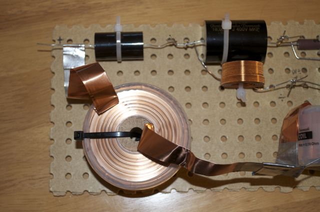

                          Time to add something new to this old thread.
                          Sometimes it takes longer than we think to change something as simple as a crossover.
                          I'ts been 1 1/2 years now, no sense rushing into things. :roll:
                          I had been using a DIY cat 5e speaker cable (7 braided) but wanted to try something new. I bought an AudioQuest Gibraltar which has separate solid core wires for bass and tweeters. So I split the crossover into 2 crossovers which only share the negative line at the amplifier, not at the crossover.
                          I've only got one side finished now, but I'll report my review after they both are installed. The caps were burnt in for over 1 week each.
                          There is a Lexan cover on the box that is very hard to see because it is so clear, but it's there.
                          Ron

                            Finished both today and had my first listen.
                            First impression is full sound from instruments and good voicing of female vocalists. The speed and attack of instruments has increased but that could be due (in part) to changing speaker cables at the same time. They are now single to bi-wired AQ Gibraltars. Different gauges of wire for Bass and Treble. They are NOT broken in yet.
                            The high tartness/sharpness that was there with the original (premium component) crossovers is gone and a crisp high end has taken it's place. Siblance is lessened somewhat as well.
                            Bass is full without being boomy, this could be due to the addition of ~1/4 cubic foot of Dacron stuffing. (pillow guts) or the new brand of capacitor in the crossover. Only time will tell with the further break-in of the caps/crossovers. But I like the new sound better.
                            Midrange sparkle and presence which was the hallmark of the original crossovers is gone! What the H3LL happened??? Has anyone else experienced this? It could be the driver tubes in my Preamp as they are new to me and I don't know their sound. (RCA 1950s grey glass 6SN7s) Tomorrow I'll change out those tube for a different set and see if they are the thief that stole my midrange......I may just eliminate the preamp and use my reciever as a pre-out. PITA to take my equipment out and shuffle components around. Ya know, you hate doing it too.....
                            In my instance I had to change many items at once so it is difficult, at best, to be certain which component has changed the sound. I know that this is not the way to do comparissions but it was unavoidable. I changed the CDP to the new OPPO Blue-ray BDP-83. Very cool player.
                            I'll change some stuff back and test then report later. I'm open to ideas about the midrange if anyone has any....

                                                                                    A few pics of one of the assembled xovers. Does the coils polarity have any difference? Have used the outer end as plus, and inner end as minus.
                                                                                      No, the coil direction does not matter. Your assembly looks fine.
                                                                                      What are the resistor values? Looks like you are doing the 8 parallel 9. If there's not enough treble, you can lower this to 4 or slightly lower.

                                                                                        the resistors are 8 in paralell with 9 (4+5). Will get to test with both of the new xovers later tonight
